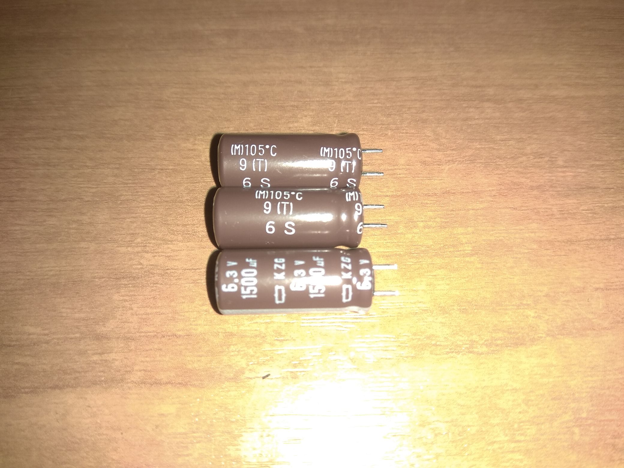

    neither of those are suitable because kzg is a very low esr series and FL is an ultra low esr series like FJ. kzgs are also a defective failure prone series unless their date codes are later than 2007 or 2008.
    Correct... though probably both will work fine, since the 3.3V rail uses a mag-amp and generally is OK with slightly lower ESR. That said, I'd pick the Panny FL caps, since KZG is known to have problems (at least the older ones.) So to avoid any gambles, go with FL.

    Originally posted by zunasthegreat
    3.3V -> 2X 1500uf FL or KZG 6.3V
    5V -> 2X Nichicon HV 1500uf 16V
    12V -> 1X Nichicon VY 3300uf 16V
    I'd probably do it more like this:
    3.3V -> 2X 1500uf FL 6.3V
    5V -> 1X Nichicon VY 3300uf 16V + 1x Nichicon HV 1500uf 16V

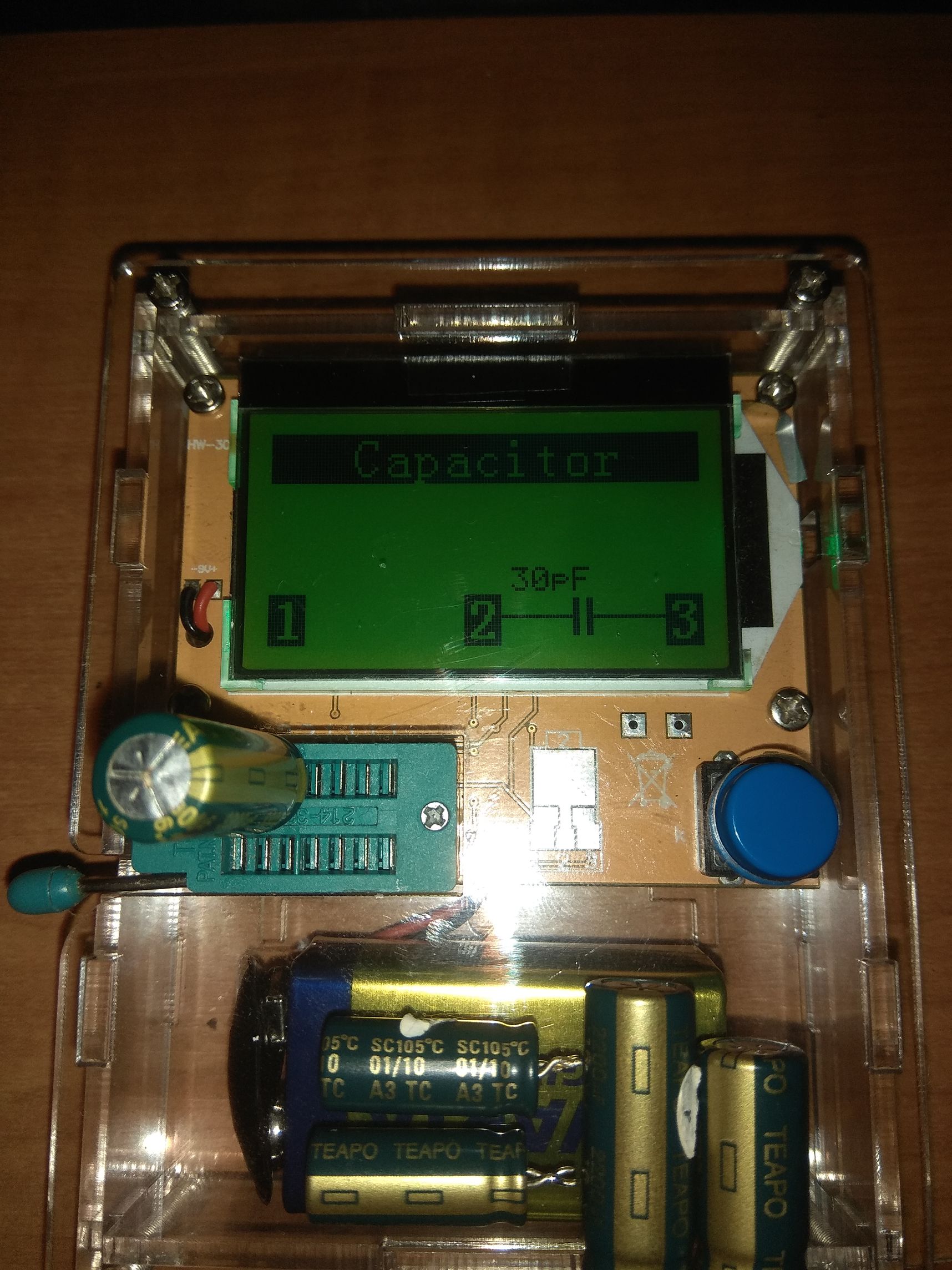

            I have another PSU that will probably need care soon, all filtering caps are from TEAPO. I don't think it will look good.
            If they are all Teapo, just check them on the ESR meter. If still in spec, probably OK to leave them... unless those Nichicon HV caps you have match the capacity and/or voltage too on some of the Teapos.

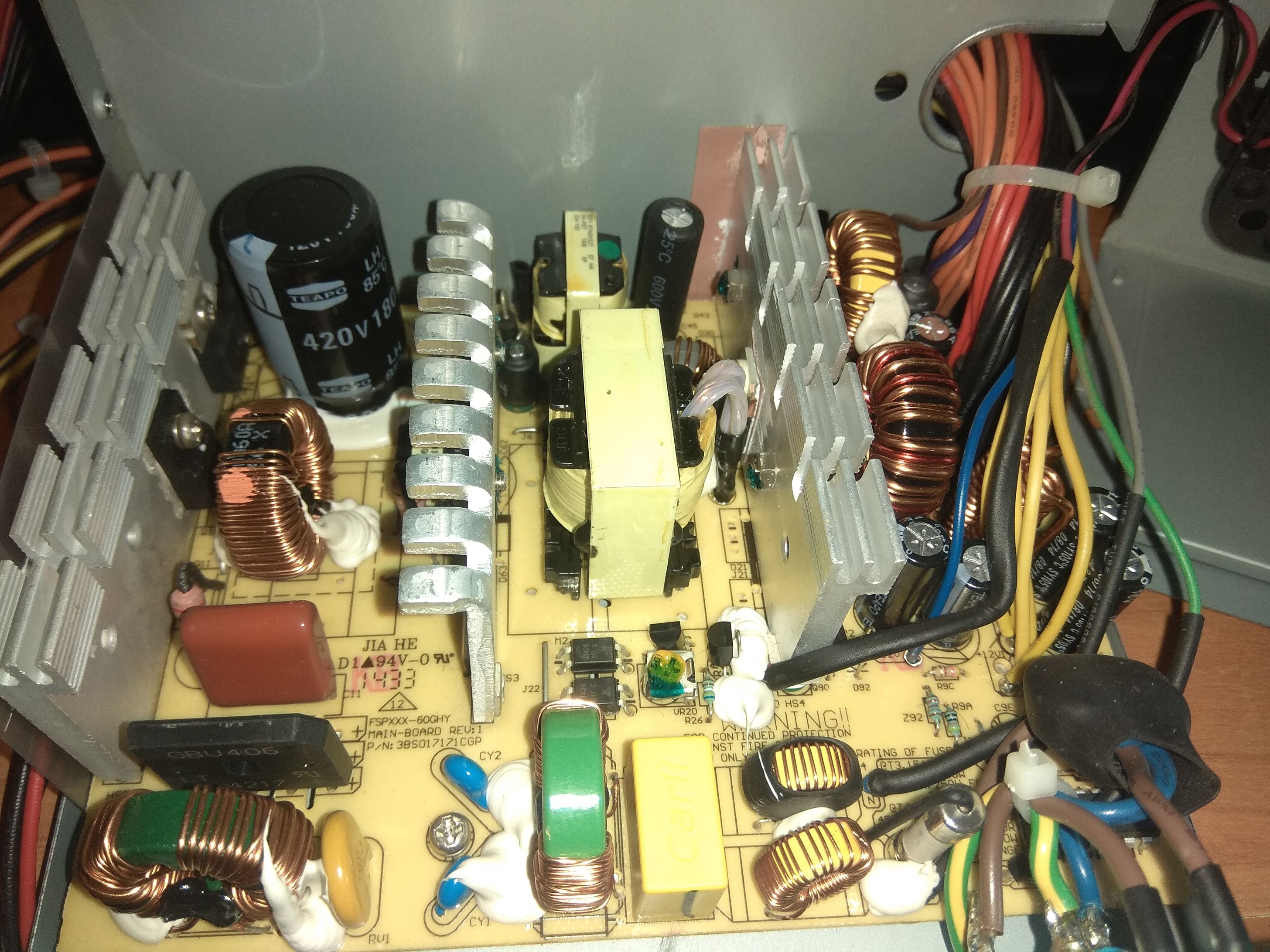

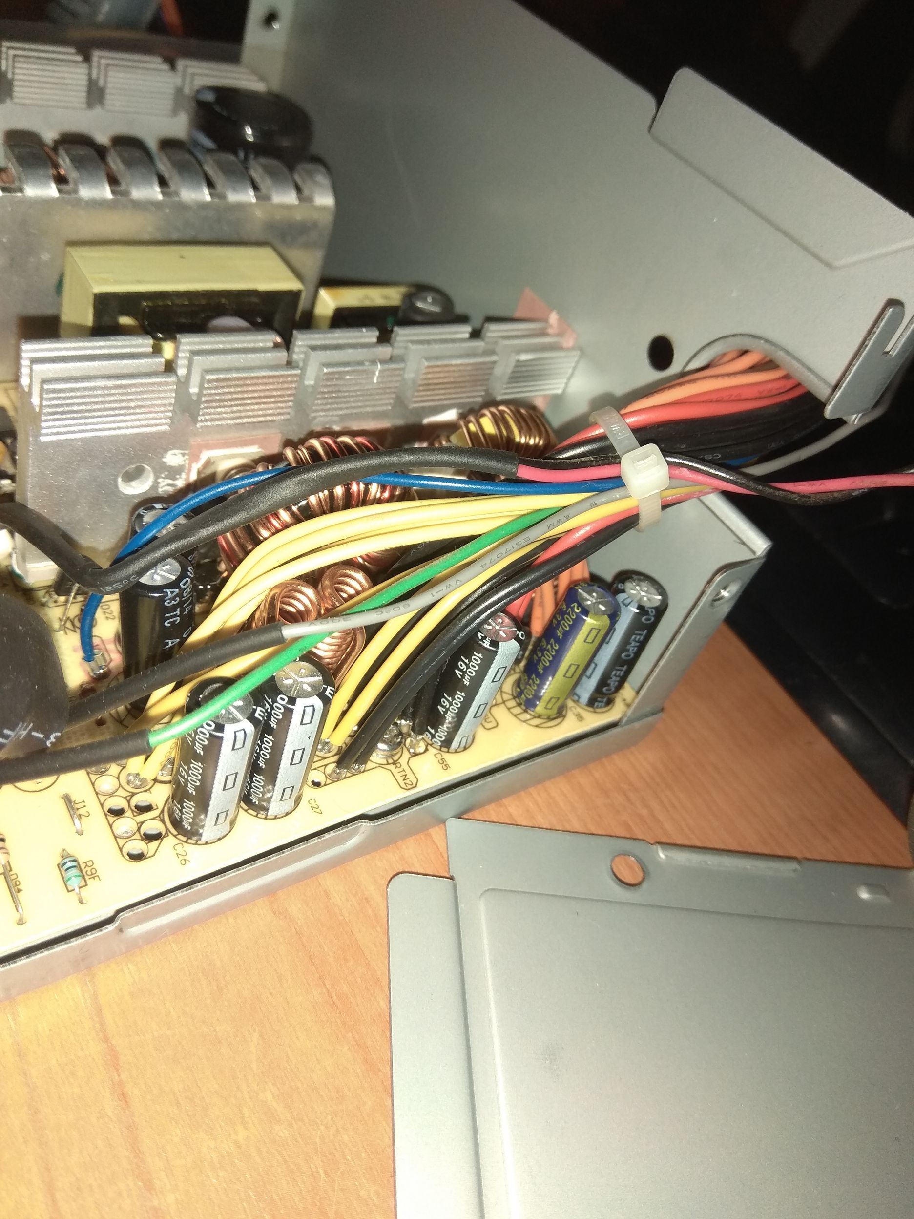

                  Here is the FSP 300W I talked about earlier, all caps are from Teapo and two of them are inside heat-shrink tube. It also seems that each 12V output V1/V2 has 2 16V 1000V caps. I don't think it needs any improvements atm.

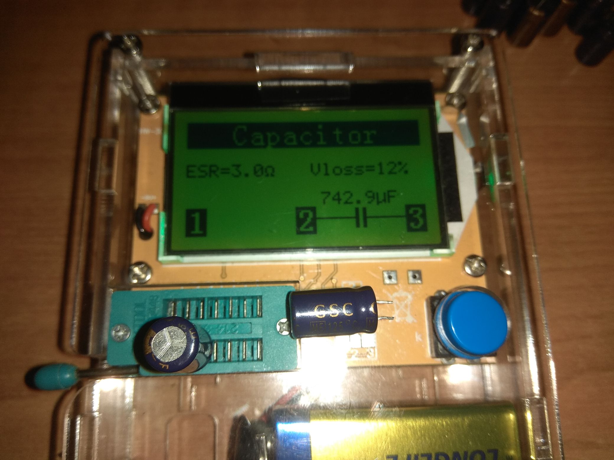

                    Another non-visible GSC c[r]ap from a P4 board. Dimm detection is dodgy so this might be an issue from the aging caps.
                      Yup, looks pretty good... though at 5-8 years old, you might want to check back on it again - that's roughly how long it takes for some of the Teapo caps to become problematic. Not all of them will, though. I also see this PSU has mostly black Teapo SY series, which IMO tend to be a little more stable than their green/gold SC and SM series. The worst ones are the blue/gold -colored SZ series, which I see one (6.3V 2200 uF) on the secondary side. Most likely, that will be the first one to fail... and then probably the 5VSB output filter after that (or around the same time.)
                      Primary input cap is also Teapo... which can be a bit risky with APFC PSUs (which this one is) after a few years. At least it's rated for 420V... though capacity is a bit low at 180 uF for a "300W" PSU. I'm sure the PSU will do its rated output on the label, but that primary cap is just borderline cutting it in with the capacitance. 270 uF would be a little better to see here.
                      But other than the cap choices, that's a pretty decent PSU that actually will do the rated power numbers on its label and not blow up.
                      Yup, I got a few failed Evercon caps like that too - not bulging and high ESR with high vloss. GSC/Evercon/Sacon really are some of the worst caps, right down with Rubycon-copycats, like Rulycon and Rudoycon.

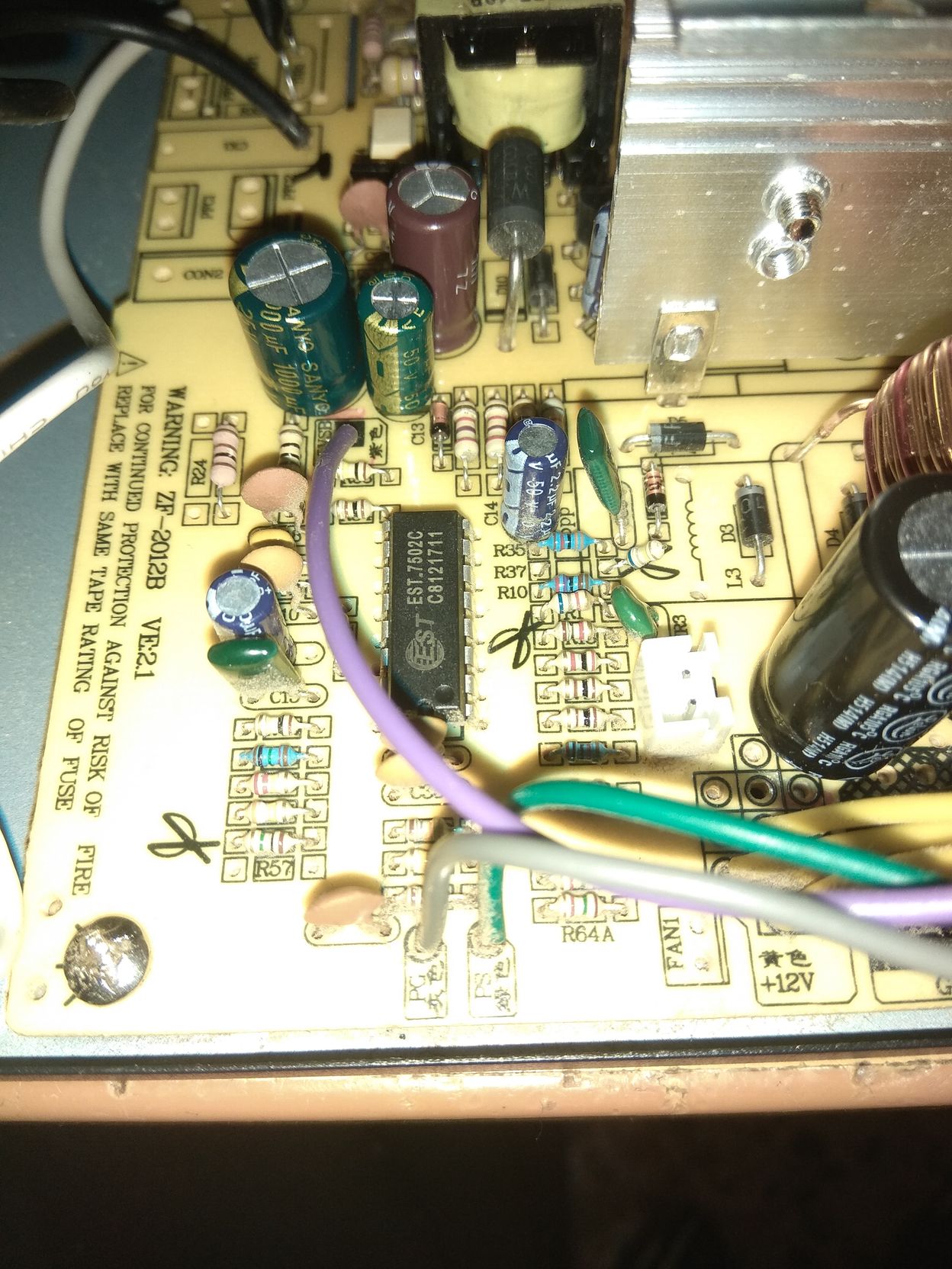

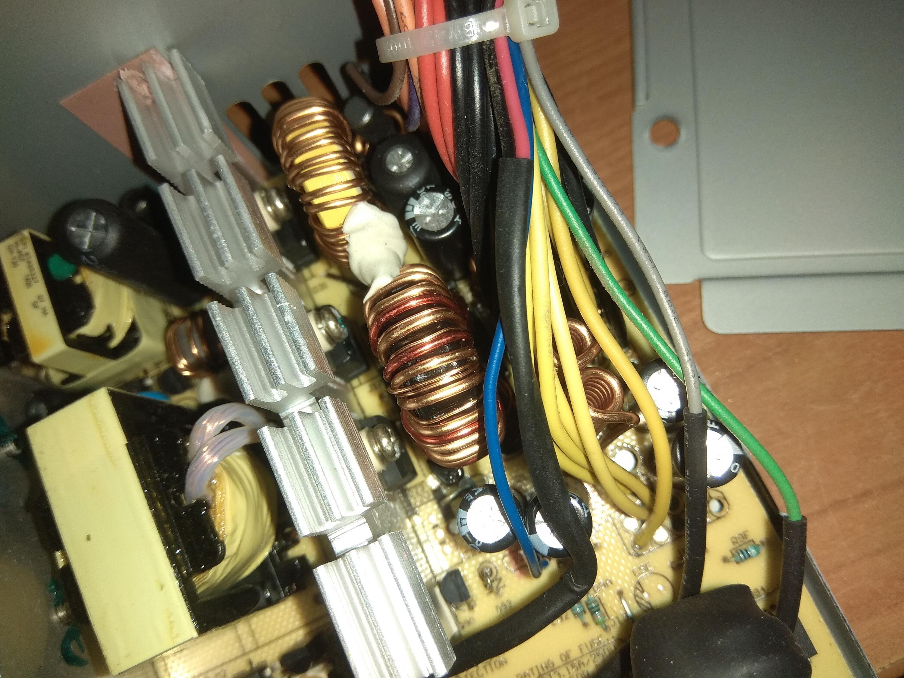

                              Another half bridge beast with special scissor marks on the pcb. The R37 680Kohm resistor is cut and has that scissor icon, any clue whats the deal with it ? PSU is a powertech brand without even the 3.3V coil plus next to that resistor there is marking with "OPP". I guess its an overpower protection ...
                              Upon using it on a testbed with a Soltek P4 board the 3.3V reading was ... 3.05V
                              Usual business with one F16C20C Mospec SBR for 12V. The laber markings are quite funny : 3.3V - 14A / 5V - 10A and 12V 29A (14+15)
                                    Yup, if that resistor was cut out from a section labeled OPP, probably they did that to either raise the maximum allowable power or lower it (depending on circuit design), probably according to the parts they installed in the PSU.
                                    In any case, I'm always a bit skeptical if the OPP would work properly on these cheapo PSUs. On some, it does. But just don't count on it.
                                    Regarding the missing 2nd 3.3V coil... PSU probably uses linear regulation for the 3.3V rail then. See what part on the heatsink connects to the 3.3V rail. If it's a MOSFET, 3.3V rail is surely a linear job (and likely taking power from the 5V rail.) This isn't a bad design, per se, but just a little more inefficient. On the plus side, the 3.3V rail does end up with very little ripple, even with crap undersized caps.
                                    Curious what they done goofed up to do that. I imagine this reading was with a multimeter and not taken from mobo monitor? If with mobo monitor, I'd disregard it.
                                    Well, you got somewhat lucky. A lot of cheaper PSUs come with a F12C20C - just barely enough to run a low-end CPU with an entry-level GPU without blowing up... like something along the lines of an i3 or low-end i5 and a GTX1030. It's all the same trash though, - these cheap PSU manufacturers haven't really changed their ways too much over the years.
                                    On the other hand, I still find it amazing that 40-year-old designs (namely, the half-bridge) is still able to run modern PCs.

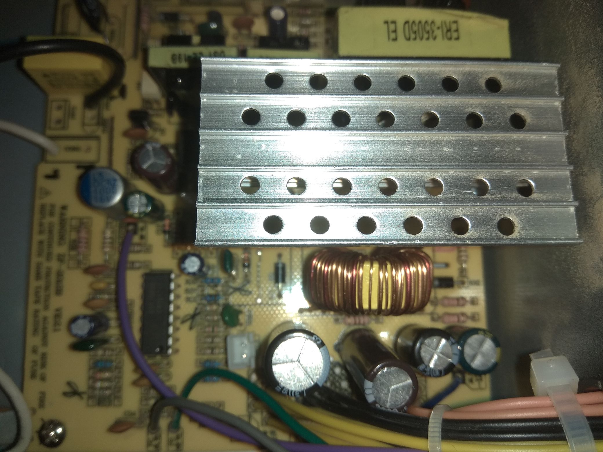

                                        Powertech got the Polymer care for the 5VSB it needed. Plus I've installed :
                                        5V -> 2200uf KY 10V
                                        12V -> Lelon RGA 3300uf 16V
                                        3.3 -> Lelon RGA 2200uf 6.3V
                                        5VSB -> 470uf 16V KY + OCRZ 1000uf 16V (polymer)
                                        Just left chengx masterpieces for -12V and an 50V 47uf near 5VSB cause they had decent Esr. The 47uf cap has like ~0.2Ω ESR
                                        PSU has very weak 3.3V (14A) / 5V (10A) btw, won't be a big deal for a Xeon 771 modded on a P31 with a HD 5450. System pulls most juice from 12V anyway

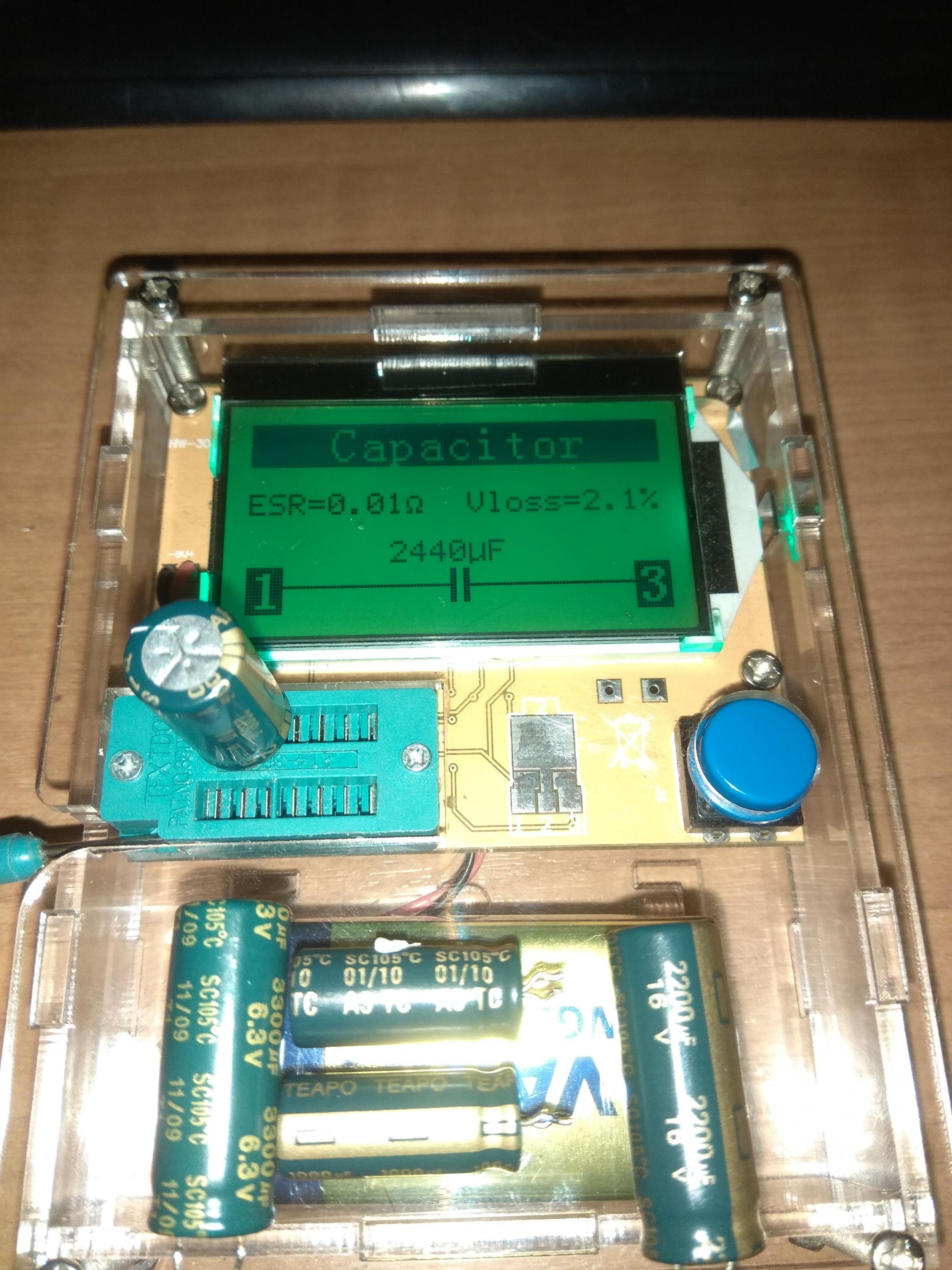

                                          Another nasty discovery upon cleaning a chieftec aps-500 (10y old PSU). One Teapo SC is bloated and others are starting to raise in capacity (pics bellow). The bloated one (3300uf) is filtering the 3.3V line, 5V and 12V lines use 2200uf caps and psu has 2 for each line. The very crammed area around 3.3V forced me to swap that cap for a 2200uf KY 10V as my other GP caps are Nichicon VZ 3300uf 6.3 and lelon GP. I choose some nichicon PW 10v 1000uf for 5VSB as the space is OK there. 5V line got a KY 2200uf 10V and 12V a Nichicon HD 16V 2200uf (12mm was hard to fit).
                                          Original Cap spec
                                          3.3V -> 2X Teapo SC 3300uf 6.3V
                                          5V -> 2X Teapo SC 2200uf 10V
                                          12V -> 2X Teapo SC 2200uf 16V
                                          5VSB -> 2X Teapo SC 1000 10V
                                          TEMP SOLUTION
                                          3.3V -> 1X Teapo / 1X KY 2200uf 10V
                                          5V -> 1X Teapo / 1X KY 2200uf 10V
                                          12 -> 1X Teapo / 1X Nichicon HD 2200uf 16V
                                          5VSB -> 2X Nichicon PW 1000uf 10V
                                          PSU is Group Regulated with proper equipment, nothing fancy.
