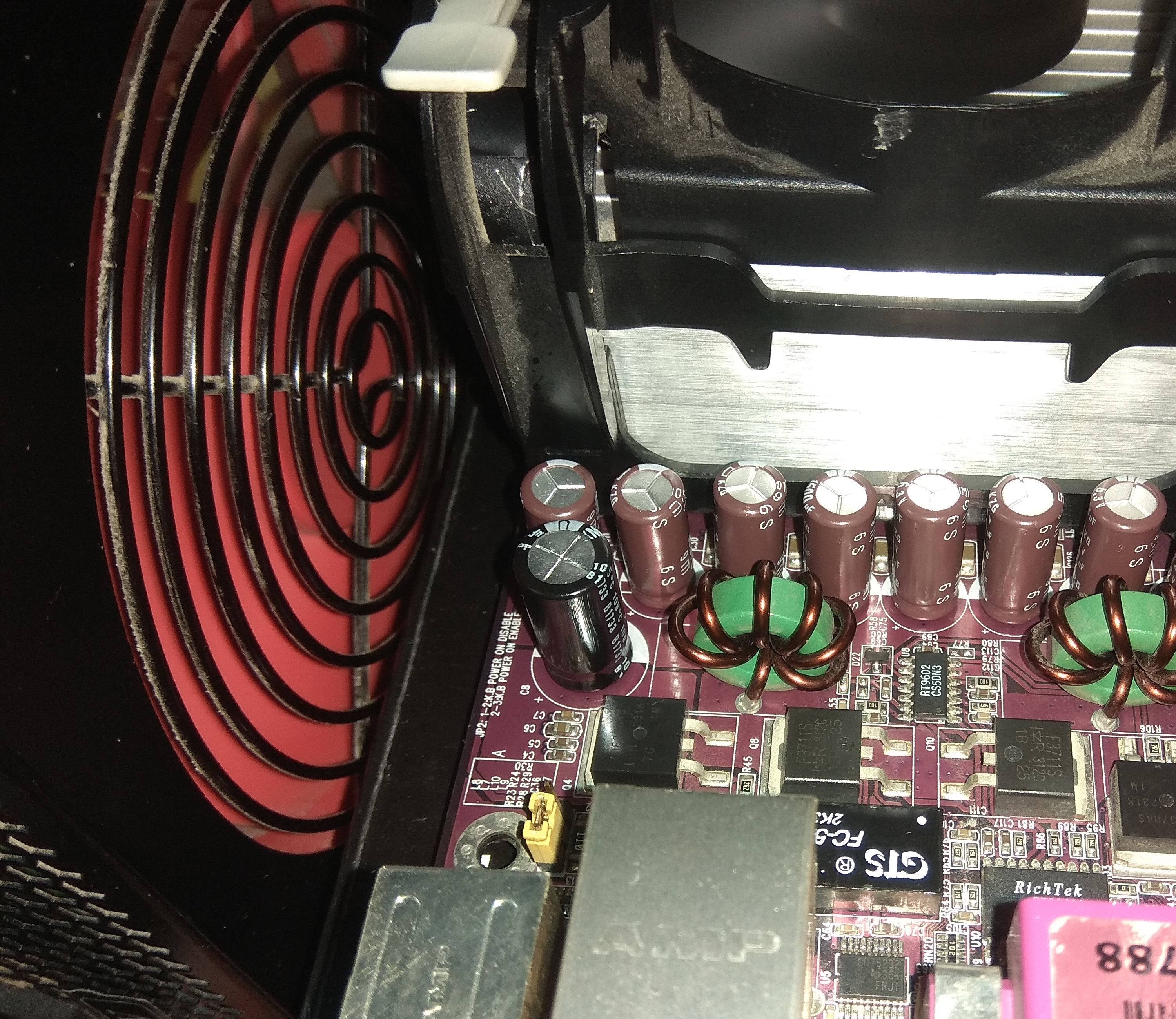

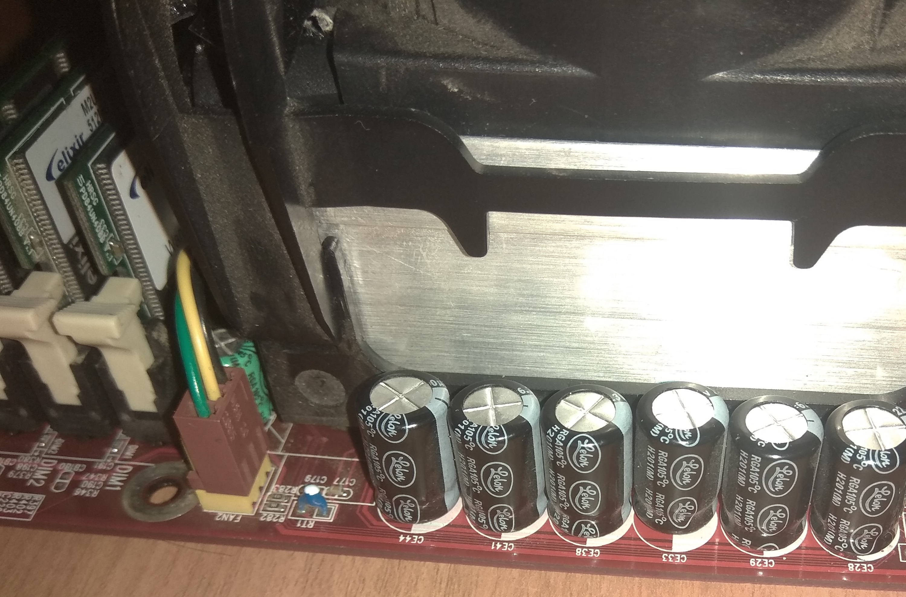

    Sorry for hijacking OP. Will the NCC PSA series 2.5V 680uf Solidcap work for the VRM area on a junky Jetway P4MDPT board ? Originals are "Evercom" 1500uf 6.3V and are crap, 16V Highside VRM has same Evercom 16V 1500uf that I'm gonna replace with some Nichicon HD series @ 2200uf.
    Re: junky Jetway P4MDPT board
    Looking at pictures of the board online... Most likely, I'd say the answer is YES.
    Given how many caps it has around the CPU, converting it to all-polymer will still probably give good enough capacity on the CPU VRM low side. This can be important for older boards (and especially budget ones like PC Chips and ECS) that used relatively low VRM switching frequency. But your board's CPU VRM appears as relatively medium frequency design, so solid/poly caps should work OK.
    That said, you don't have to go all solid or all wet electrolytic caps. You can mix and match too to get both higher capacitance and better ESR in the circuit. That's what I did with my Jetway N2PAP Lite, detailed here:
    https://www.badcaps.net/forum/showthread.php?t=63041
    In case of your board, you can probably do like 2/3b of the caps on the CPU VRM low side as polymers, and 1/3 or so wet electrolytic with high capacitance.
    Also, as "junky" as this Jetway may appear, notice they used a through-hole socket for the CPU. That actually makes the board quite bullet-proof, especially when subjected to the horrible warping from the stock Intel heatsink mounting mechanism.

          For lowside VRM cap bank I'll mix solid 820uf 2.5V (sepc series) + some nichicon 2200uf 6.3V. The 16V ones will be replaced with Nichicon HD's 1500uf 16V.

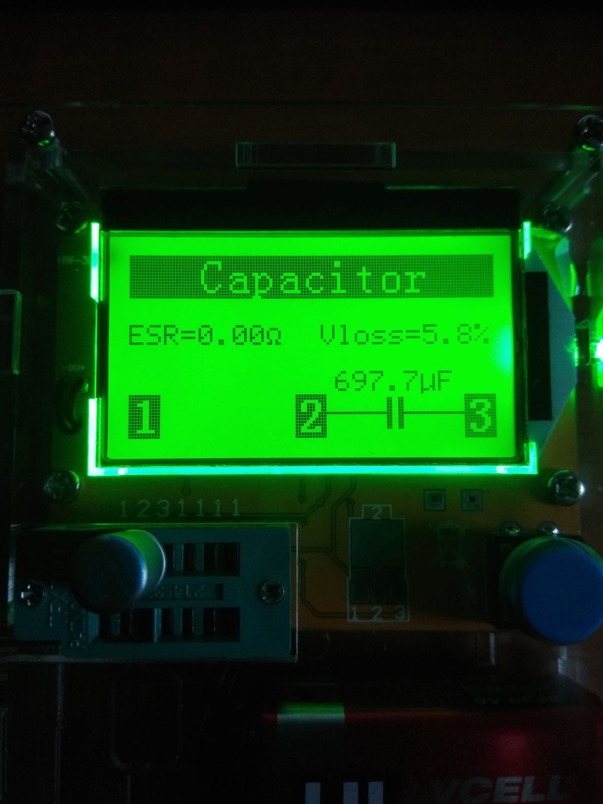

          *My cheap tester shows Vloss above ~5% on the NCC solid 680uf 2.5V caps.
          Crappy reading or whole batch of semi-working caps ? Other caps on tester show the usual 0.5-1% Vloss so I guess its not tester error.

            IDK, I think I've seen poly caps with high Vloss like that before. I guess just connect that cap to a 2-2.5V source and see if it holds voltage for, say, over 10 minutes. If yes, it's probably not as leaky as the meter shows. I honestly don't pay too much attention to Vloss on my meter, as some of my lytic caps (and I think a few polies too) easily show 3-4%.
            If you have a small low-voltage DC motor (like out of a CD drive eject mechanism or tape player or similar), you can also connect the charged cap across it to see if the motor spins for an instant. If it does, then the ESR and capacitance are probably reading correct and cap should be OK.

              KZG Job done ... 6.3V 1500uf and 3x Nichicon 1500uf 16V. Mainboard posts normal so far. The old GSC 1500uf caps are a mystery, 6.3V ones show very high Vloss on meter ~5% but their capacity is epic at around ~2600uf.
                Ah, classic GSC / Evercon failure mode before they start bulging. Looks like you caught them right on time!
                The high capacitance means their electrolyte is breaking down the aluminum foil layer and increasing the capacitance at the expense of decreasing the maximum voltage they can tolerate. As a result, their internal leakage current also goes up, making the cap more "lossy", especially when operated at voltages closer to the cap's rating. Eventually, this will keep getting worse until the cap "just loses it" one day and partially begins to conduct/short out, making it bulge and then leak.
                So again, you caught them on time.
                Though IME, GSC / Evercon tend to break down rather slowly over time, so they sometimes allow the device to continue working for quite a bit before they finally fail completely.
                On a related note, the GSC caps from the Jetway N2PAP-LITE motherboard I linked to above in post #2 have all started failing in the same exact way - extremely high capacitance and high Vloss... though none have bulged yet. I've used them as test caps in a few low-stress circuits, and they are just about adequate for that - but never going to use them permanently in anything again, because they will get worse further and further over time.
                That being said, if a capacitor is showing a capacitance that is more than 20-25% higher than what the cap is rated for, then suspect a possible near future failure. The old UCC KZG also actually fail in this manner (as do many other unstable caps.) So checking the capacitance of loose caps in your stock from time to time can sometimes tell you if any cap may be failure pending to happen.

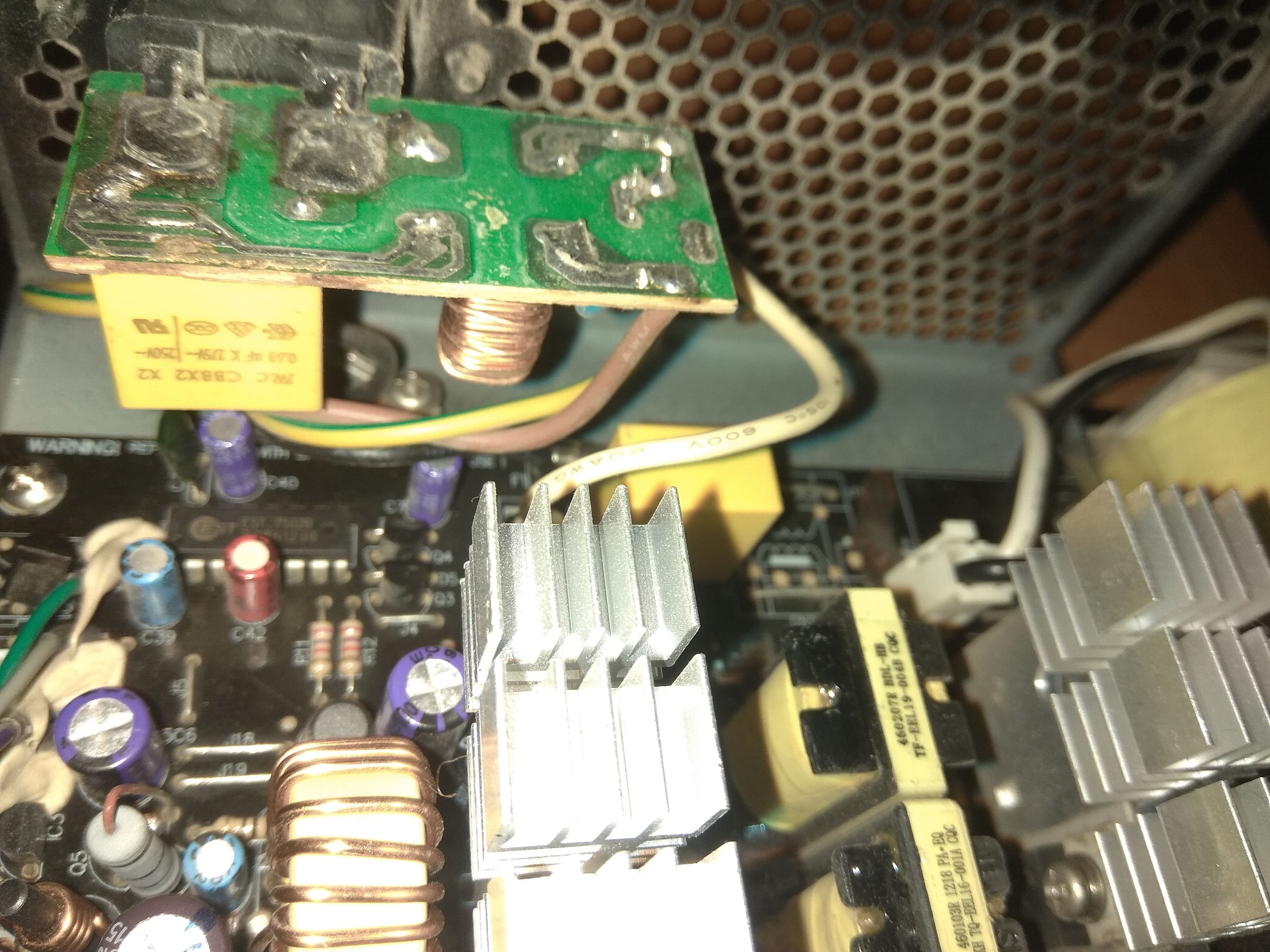

                  Great tips there thanks a lot. I recently tried to repair a very bizzare LC-8460BTX PSU that mad a horrible buzz sound, the amount of cost savings the maker did was just nuts. PSU had in total 3 filtering caps for 12V/3.3V/5V voltages, one each and half the pcb was empty. The 12V cap gave a reading of 35pF ...
                    I think I have a pretty good idea about the PSU you're dealing with. LC-84xxBTX is a model number for Solytech / Deer / L&C / Allied PSUs. Probably somewhat similar to these:
                    https://www.badcaps.net/forum/showpo...&postcount=491
                    https://www.badcaps.net/forum/showpo...&postcount=492
                    Sometimes they are total crap (many parts missing and PCB not having enough space to put decent parts), and sometimes they could be rebuilt with a few spare parts from other PSUs and also good caps.
                    They key, in general, to getting these cheapo PSUs working somewhat half-decent is to install 2x 2200 uF at least on each of the major output rails (that is, 3.3V, 5V, and 12V). 5VSB will do OK with 2x 1000 uF. There is also one or two 50V, 47 uF caps in there - those must be replaced too (one will be on the primary side, close to the 5VSB transfomer/circuit and is very important so that the 5VSB doesn't overheat and possibly take the motherboard with it.) If you add the above caps, the PSU should be a lot better, though may still need other work - for example, if the PI inductors are missing and replaced with jumper wire, it may be a good idea to install those. Likewise, the input EMI/RFI filtering components are also often missing on the cheaper units. Getting those installed should make the PSU passable (though not great by any stretch of the imagination.) Of course, only do it if you have the spare parts from other PSUs and electronics. It's probably not worth to buy all these parts for that cheap PSU (well, the electrolytic caps are cheap, but the EMI/RFI filter parts will not be, usually.)
                    On that note, I just finished rebuilding a somewhat similar cheapo PSU unit from another company (CWT). I've had it for a while and figured I can use it with some older PCs. Here's the thread with that:

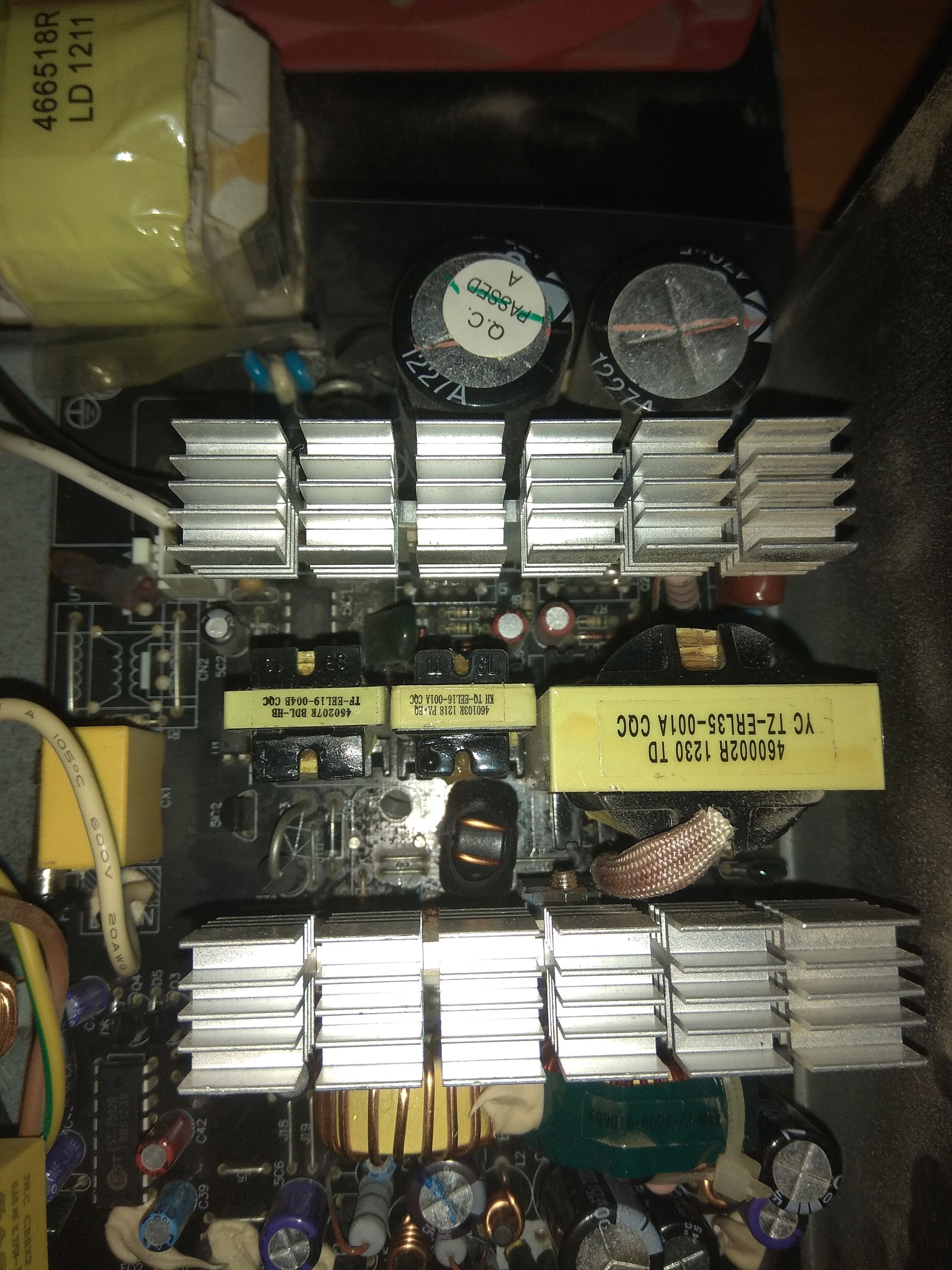

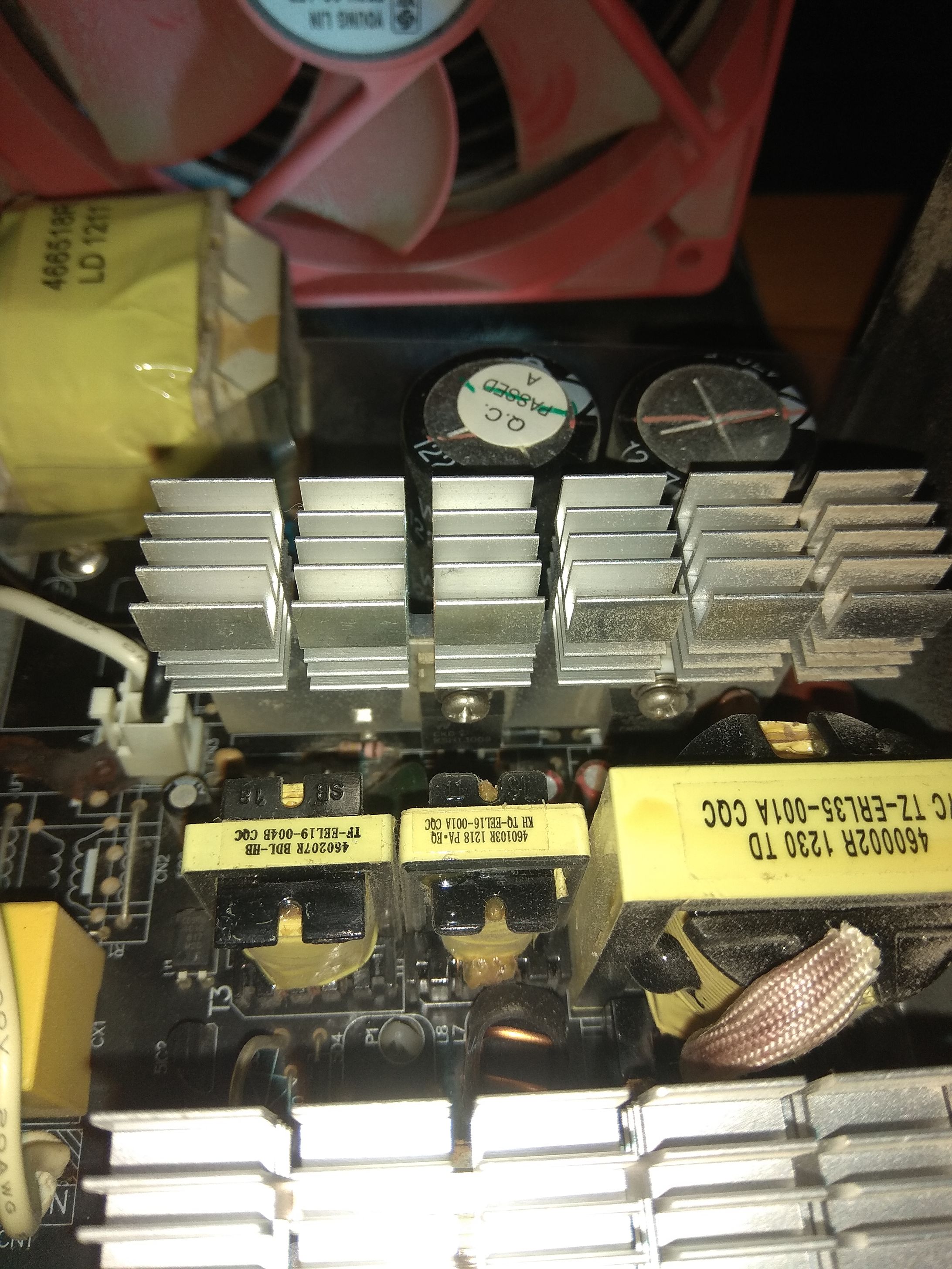

                          I opened up a Nitrox 550W psu with a bloated 16V 2200uf Nippon something cap, had to band-aid it for now with a Lelon 25V 2200uf. From the following caps which one is the ideal : Nichicon PW 2200uf 16V / HD 2200uf 16V or a leftover 3300uf VY 16V ? Rest 1000uf caps on the PSU 5V/3.3V rail seem fine although I'm gonna replace them with some spare nichicon VY 16V. PSU is group regulated and I guess has passive pfc.
                            Either the Nichicon PW or the HD will do just fine. Given the name of the PSU - Nitrox 550W - it sounds to me like a cheap PSU, meaning probably a half-bridge topology (as that's all the Chinese really do for those.) So I'd probably put the PW on the 12V rail and the HD on the 5V or 3.3V rail... or better yet, see if you can squeeze both of these on the 12V rail - that will give it better filtering for a 12V-heavy modern PC.
                            As for Nichicon VY - that's a general purpose 85C -rated only, so not really suitable for SMPS unless you really have nothing else and need a temporary fix (though, on an old half-bridge design, that VY may still last a few years.) Thus, if you can, try not to use the VY and use HD or PW instead.

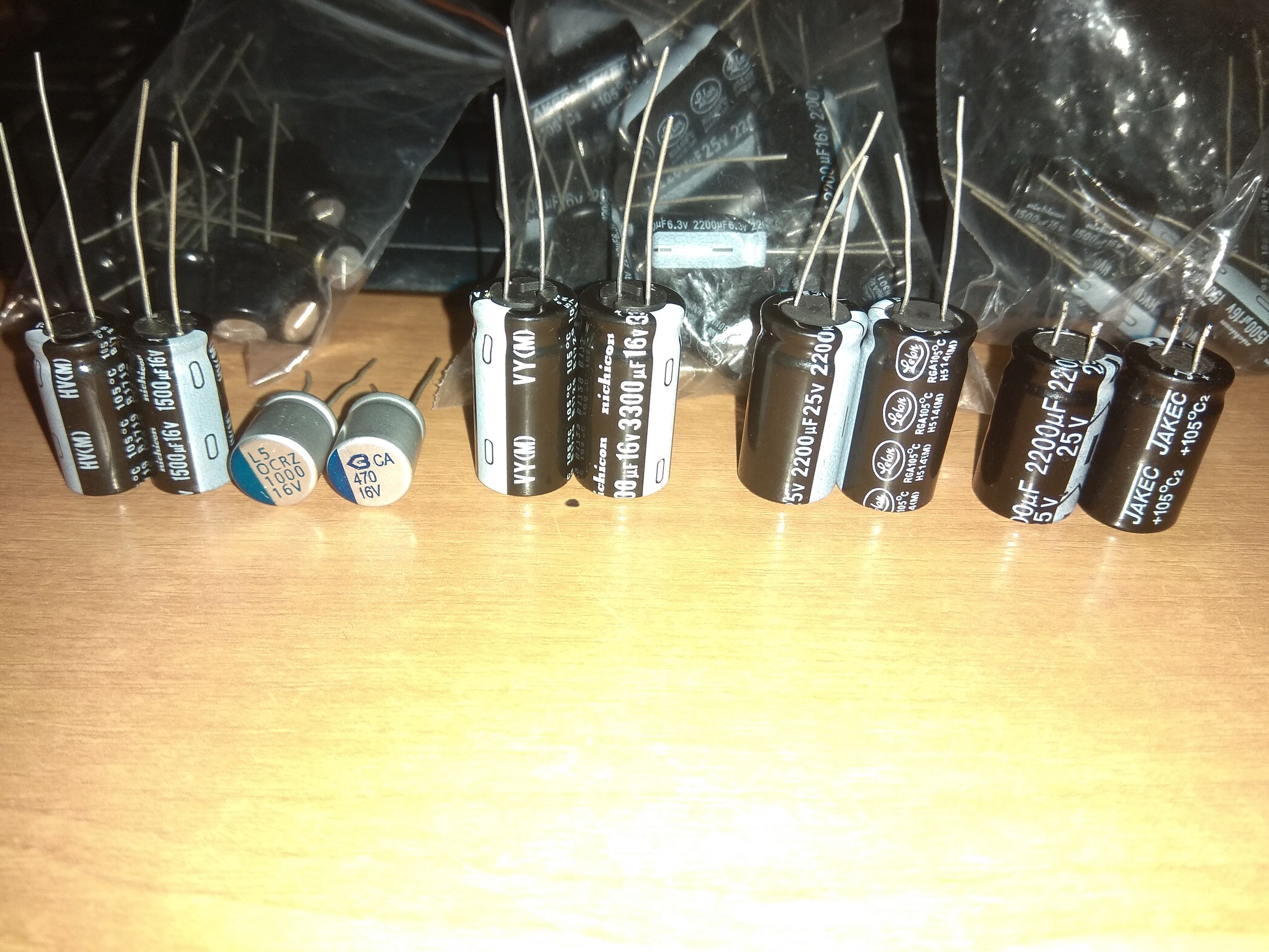

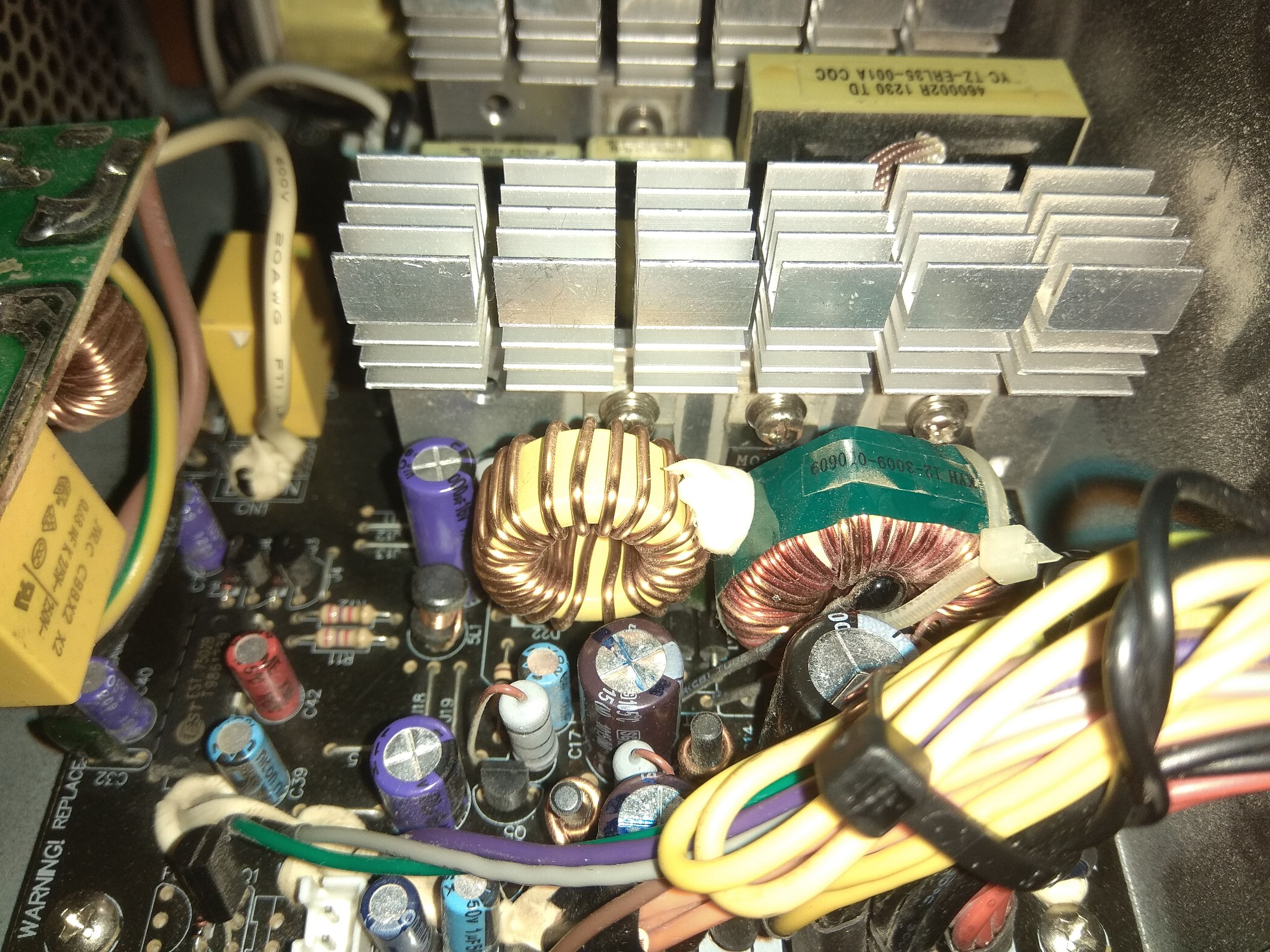

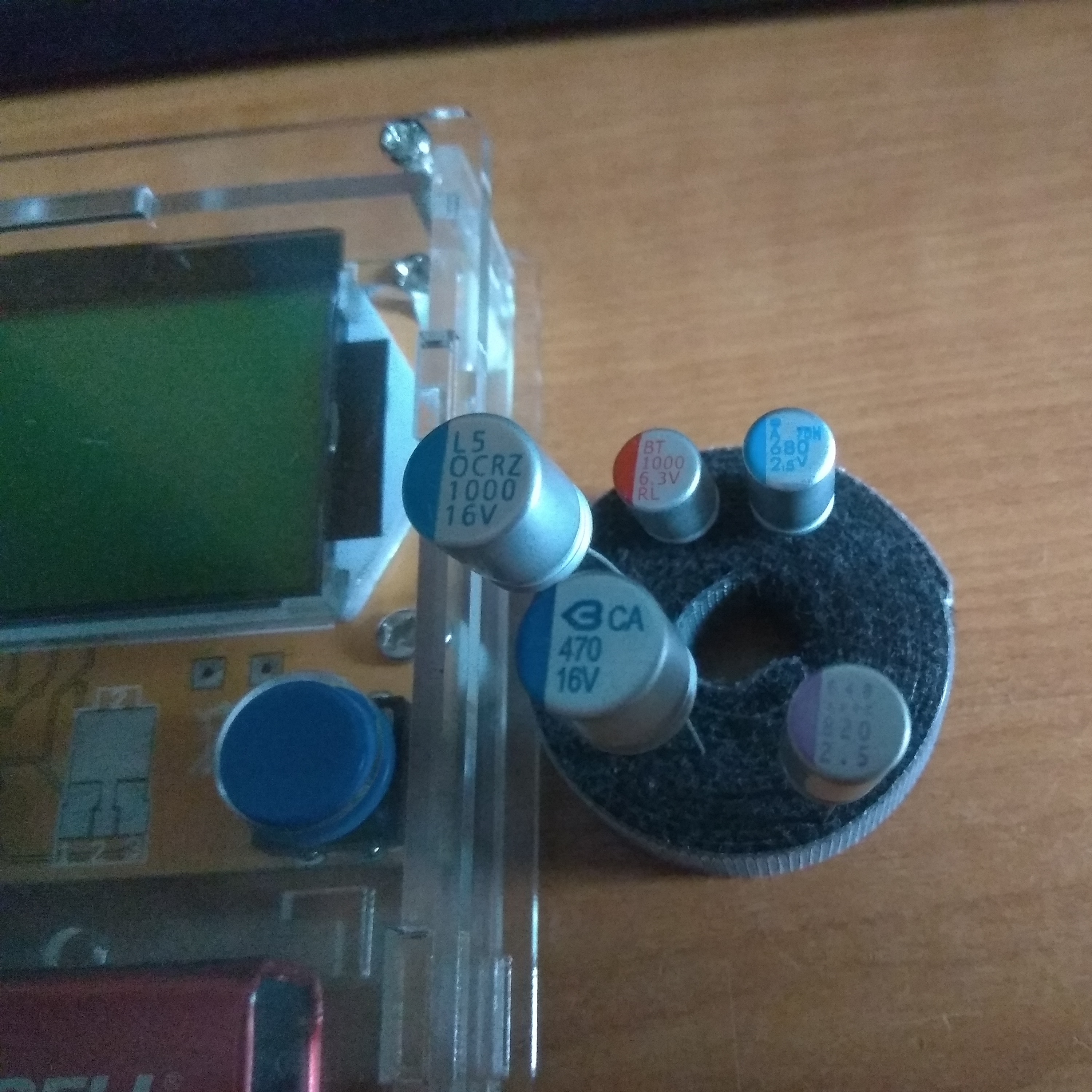

                              I forgot I had already done 3.3V filter caps with some Su'scon 10V 1000uf. The 5VSB seem fine atm, the PSU originally had "NICON" caps and a melted 4PIN CPU. I re-soldered an 8-pin EPS using AWG 18 instead of 20. Will polymers work for filtering ? Have a ton of polymers and really not great quantity of lytics. My HD/PW are not 2200uf, for the 12V line I can use ->
                              OCRZ polymer 16V 1000uf
                              Beryl polymer 16V 470uf
                              Nichicon (VY) 16V 3300uf
                              Nichicon (HD) 16V 1500uf
                              JAKEC 25V 2200uf
                              or keep Lelon 25V 2200uf
                                  Yeah, that's not going to do too well for filtering ripple. A lot of cheap crap PSUs come with just 2x 1000 uF on each rail (3.3V, 5V, and 12V), but that's *not* anywhere enough to filter ripple properly, especially because these PSUs are based on half-bridge design, which uses relatively low switching frequency and thus needs bigger caps on the output for proper filtering. Therefore, such PSUs need, again, *at least* 1x 1000 uF and 1x 2200 uF caps on each rail (so total of *at least* 3000 uF on each rail.) Any less, and the PSU will be spewing out abnormal ripple that then the hardware will have to cope with. This can lead to shortened lives of hard drives and motherboard components.
                                  Short answer: No
                                  Long answer:
                                  Polymers will likely make the ripple output even worse. Too low of an ESR, especially on these older designs, is a really bad thing - the combination of low capacitance and low ESR will produce a ton of ringing noise on the output rails (ringing is noise created by the filter itself due to it being an LRC circuit, naturally.)
                                  The only exception is the 5VSB - there you can probably use something like 1x 1000 uF and 1x 470 uF polymers or just 2x 1000 uF polymers. But even then, some PWM-FET controllers for the 5VSB (if the PSU uses one) may also not like the polymers too much or may not be compensated for it, so you may also get a terrible whining noise from the 5VSB too. So polymers and 5VSB: MAYBE OK. But polymers and the rest of the PSU: NO.
                                  To keep it simple, just remember this about recapping PSUs: you can always go up in the capacity of the capacitors, but never lower. On cheap PSUs that use the 2x 1000 uF cap treatment, just completely ignore what they had and go with 2x 2200 uF for each rail. ESR-wise, caps should be entry-level to mid-range low ESR. Ultra-low ESR and polymers are not recommended and may not work (or even make the PSU oscillate wildly and blow.) On half-bridge designs, polymers should never be used due to low switching frequency (typically under 30 KHz.)
                                  JAKEC 25V 2200uf
                                  Oh, I see you have Nichion HV series, not HD as you stated - those are actually very durable and dependable for PSU use. IIRC, a few models of the PS3 power supplies use them.
                                  How many cap spots does the 12V rail have? One or two? If two, go with 2x 1500 uF Nichicon HV or 1x 1500 uF HV and 1x 3300 uF VY. Do the same for the 3.3V and 5V rails if they have 2 spots. And if any of these has only 1 cap spot, go with the 3300 uF VY. Yes, I said VY are GP and 85-C only, but I honestly trust them more than JAKEC. And your Lelon is RGA series, which is GP 105-C - i.e. same stuff as the Nichicon VY, but rated for higher temperature... which probably won't matter much, because I still think Nichicon VY is of higher quality than any Lelon.
                                  Of course, if I had to pick between Lelon and JAKEC (or any other major no-name crap cap brand like JAKEC), then I'd surely pick Lelon.
                                  But clearly you have some OK caps on your hands. Both the VY and HV should do.

                                    Thanks for the help, unfortunately PSU has just one spot for 12V cap. I saw the cap mark on VY and also checked their site and it seems VY is a 105 C rated cap. The 3300uf VY might not be a bad idea at all.
                                    If sus'con 1000uf 10V are underrated or crap for 3.3V filter then what about KZG 1500uf 6.3V which I have in massive stock ? If 6.3V cap is OK I can even use Panasonic FL 6.3V 1500uf.
                                    3.3V -> 2X 1500uf FL or KZG 6.3V
                                    5V -> 2X Nichicon HV 1500uf 16V
                                    12V -> 1X Nichicon VY 3300uf 16V
                                    *Pretty sure even 100$ PSU doesn't use that kind of CAP anymore its just Teapo, ChongX, ASIA-X etc
                                      neither of those are suitable because kzg is a very low esr series and FL is an ultra low esr series like FJ. kzgs are also a defective failure prone series unless their date codes are later than 2007 or 2008.
