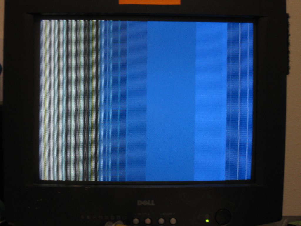

    This one's hard to understand but here it goes:
    I have run into two of these FIC K8M-800M Socket 754 boards with what appears to show the same symptoms, one from Everex, and another from eMachines. The symtom is a garbled screen (see attached image) that also freezes the computer and can happen from trying to do a simple task, heavy disk activity, etc... I've just about done everything other than replacing the motherboard caps and includes:
    No overheating, ALL caps look good
    2 known working CPUs (Sempron 3000+ and 3300+ rev. E6) (both pass Orthos Prime for over 10 hours)
    2 known working DDR-400 memory sticks (both pass Memtest86+ for over 3 hours)
    1 known working video card; motherboard has integrated graphics (screen goes black or freezes with no corruption)
    2 known working hard drives (including one brand new drive)
    1 known working power supply (brand new Hipro 250W PSU)
    2 Windows reinstalls (the actual installation never fails)
    This is driving me silly and makes me wonder if this is a widespread problem with this board.

    Hi! What brand are the caps? Just because they look good doesn't mean they are. Many brands (especially OST, Teapo and Chemi-Con KZG) fail without bulging.
      screwed north bridge(?)
