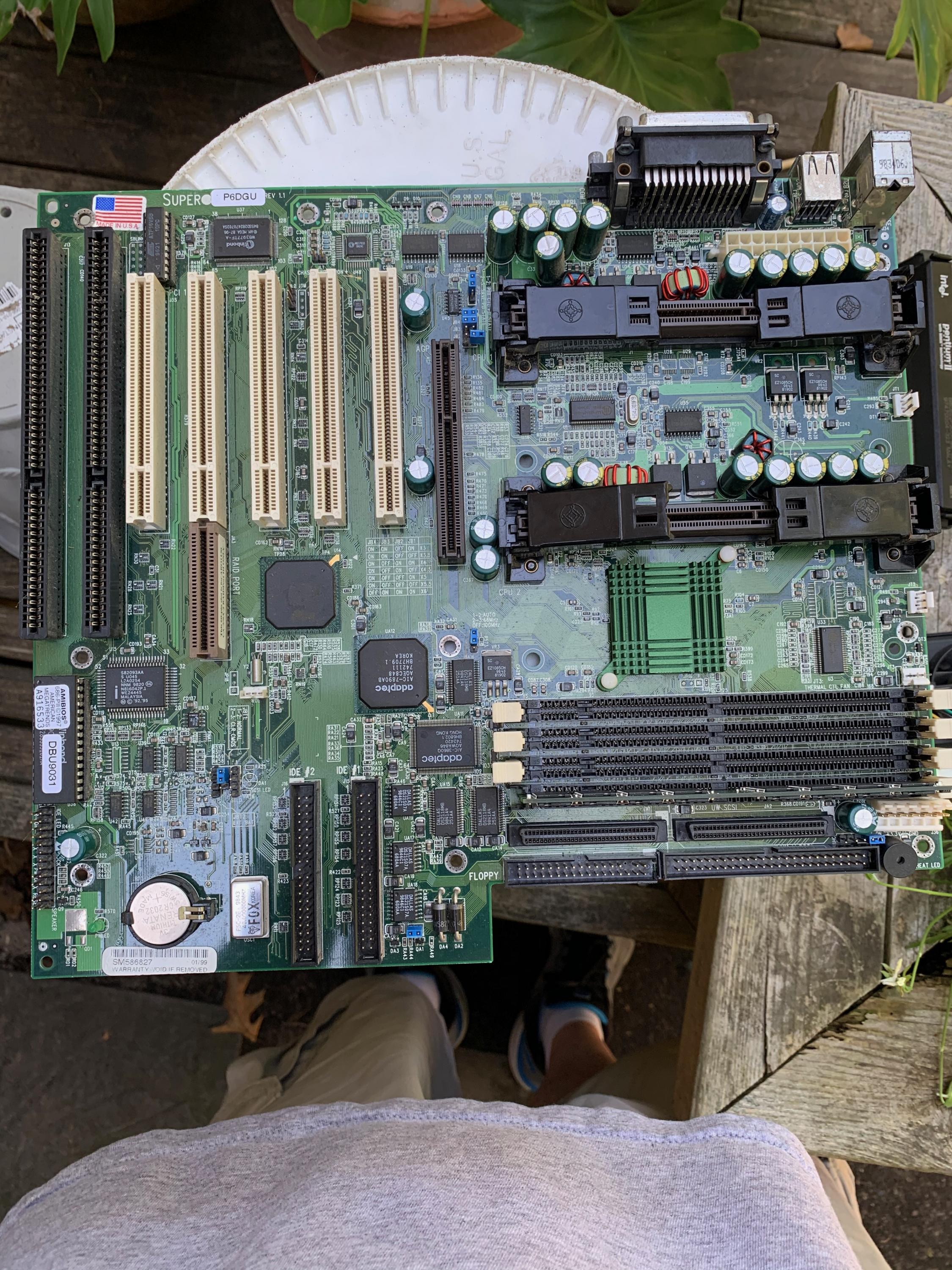

    I have a old PC with a Supermicro P6dgu board. Back in the day it was used as a Netware 4.11 server. It does get power but I don't get any video. I do understand it is old and outdated.
    I did try swapping PSU, graphic cards, etc.. but nothing seems to work for very long. If the video comes up it will go through the POST screen then stop because I don't have any HDs connected to it. There is no consistency. I can't seem to narrow it down to anything specific.
    For all I know it could be the power supply, board, AGP slot, graphics card....it could be any number of them.
    Any suggestions would be appreciated.

    Post some pictures of the board, especially around the capacitors

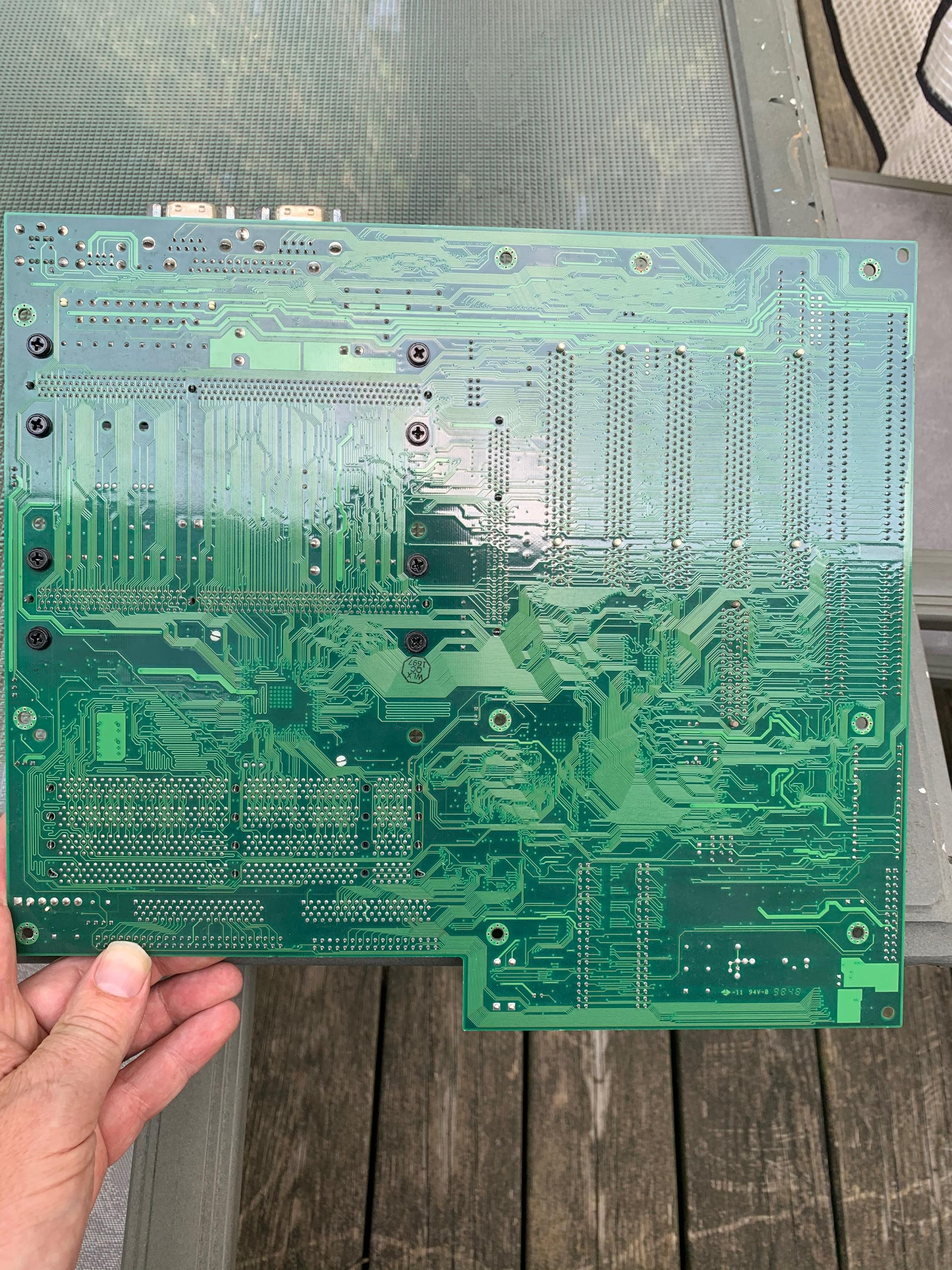

      Re: SuperMicro Board Issue
      Attached is pictures of the board.
      Again, getting video on the screen is hit or miss. Getting either PS/2 or USB ports to work completely is hit or miss.
      Another words getting video up is inconsistent and connecting either mouse and/or keyboard regardless of the port is inconsistent.
      Maybe someone can spot something on the board that is related to everything that is going on whether it is a bad CAP or something with the slots or circuitry.
      If anyone wants to see a close up of something on the board or a different angle then please let me know.

          Replace those six caps marked 'nrsy', they should be 1000uF 10v. They are junk. Yes, we do need to know a little more.... CPU(s)? RAM? GPU? Firmware revision?

            @Topcat- Can you tell where on the board where are these CAPS that you are referring to? Are these CAPS bad? What would be the benefit to upgrade or replace them with 1000uf 10v?

              They don't need to be 'upgraded', they'll be bad...even without showing it. SM was horrible for using these back in the day. There are 6 of them on your board, the culprits are marked with a red dot...see below:
              The remaining lytics on that board are Santo WG or SE series, and won't be problematic.

                How might I go about replacing the bad CAPS? I don't have the knowledge or resources ie... soldering gun or new CAPS.... to perform the replacement.
                Since you are not a fan of Powerman PSUs then which PSU would you recommend that works with this type of board?
                I am guessing those CAPS are the culprit of my issues with no video and inconsistency?

                    You'll need to find someone who can then. I can do it if you want to send it, I'd recap the entire board....otherwise you'll have to find someone local. You're just pissing in the wind until this is done.
                    Disregard about that, I had powmax in my brain for some reason.... Powerman PSU's aren't the greatest, but they're ok. You'll want to check its caps as well. Just to eliminate the PSU as an issue, try another that's known to be good.
                    Yup. Classic symptom.

                          Yep, Powerman / FSP / Sparkle aren't the greatest, but they are usually decent. The older units do indeed use crap caps and often have the tan/brown conductive glue. But once recapped and glue removed, they are pretty reliable PSUs.
                          BTW, the only thing I could find for Powerman FSP 300 was this:
                          https://www.badcaps.net/forum/showth...werman+FSP+300
                          I see crap cap brands in that one, so I concur with TC: check the PSU first and even test the PC with another one, just to confirm problems are not coming from there.
                          And regardless of that, it would still be a good idea to get rid of the NRSY caps and replace them. They are classic crap from the bad caps era. Unlike fine whiskey, these caps won't get better with the years.
