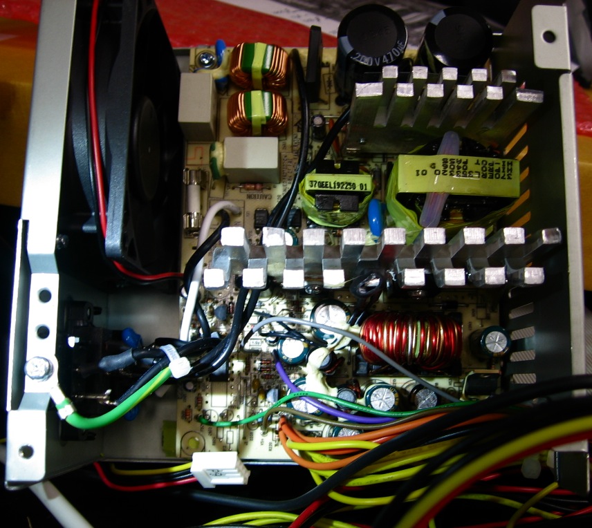

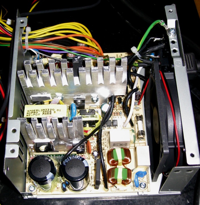

              I got a few minutes today before I left work to check on the PSU. I opened it up and took pictures, which I have attached. Visually, the PSU looks just fine--almost new, in fact. Although it is several years old, this PSU is nearly unused. It has less than twenty power-on hours. I've not used it in a machine; it came with a case but I didn't trust it in a server and installed a better PSU in that case instead. Testing my recap job is the only serious work it has ever done.
              The PSU seems to have Teapo caps in it from what I can see easily. The wires get in the way of seeing the smaller caps. I don't have an ESR meter to test them further. I'm going to try to find yet another IDE cable to test with, and also take a look at the power on the Molex drive connectors on the PSU. The new PSU I've ordered should arrive soon and then I can test the FB11 with it.
              kc8adu and PCBONEZ, you've made me feel more confident of the recap job. Do you think that perhaps having Nichicon PWs in the VRM is a problem?
              I hope the attachments come through in the post. I'm sorry that I don't know how to embed them in the posting.

                Press down the center of black center of the two black capacitors in that PSU do you feel any dome or "pip"?
                Reason I ask these black discs tend to bludge, pressing firmly test helps you to confirm.
                Also you may want to suspect the teapo capacitors as well.
                Cheers, Wizard

                  Wizard, when I push down on the black disks I feel just a flat surface beneath them. The black capacitors are Teapos. My PSU tester says the PSU is good, but there is no great load on the PSU while it tests.

                      Just FYI: Those black discs are just for insulation.
                      Matters in some applications those caps end up in where shorting other parts against the top of the cap might be a problem.
                      PSU looks like it's probably fine. [And better than average these days.]
                      Teapo is usually okay in PSU's.
                      At least one of your output filter caps isn't a Teapo though.
                      The one with the plain 'X' stamped in it. - What is it?
