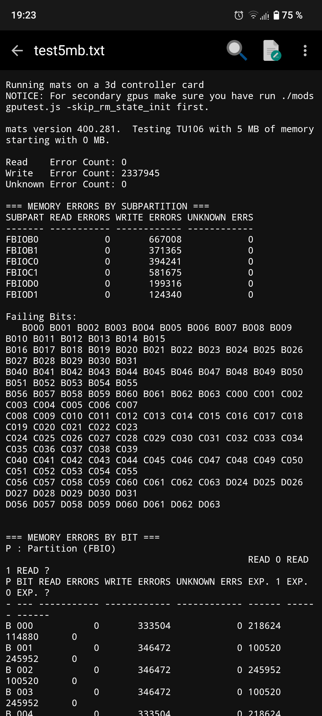

    ACER Nitro 5 AN515-55-774Z ((FH52M LA-J891P REV.1))
    Intel Core i7-10750H
    RTX 2060 6GB GDDR6
    There was a short circuit on the video memory power supply. Replaced all memory with new memory. The short circuit is gone.
    Now the laptop turns on and works. But heats up a lot. Turned on with external cooling. In Windows the video card is detected but after installing the correct drivers it gives error 43.
    In MATS test on 5mb writes a lot of errors on all memory channels on the record. (Attached report)
    When testing on 2mb of memory built into gpu memory writes pass - 0 errors.
    What should I do to determine the defect? Or is there 100% that gpu is dead?​
