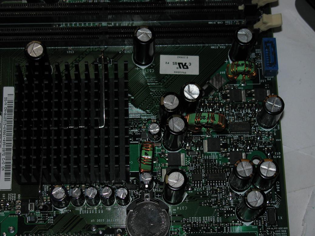

                      Well I just got it. Doesn't look too bad on the inside, only one cap oozing goop. It's one of the 6.3v 2200uF ones by the southbridge, Nichicon HM I believe.
                      Do you guys think I should replace everything (8mm and up)? I'm definitely going to replace the one leaker and all the others like it. And the Vcore, because I already ordered a bunch more of those Fujitsus for it. What do you guys recommend I do? I have the parts to redo the whole thing, so that's not a problem. Thanks!

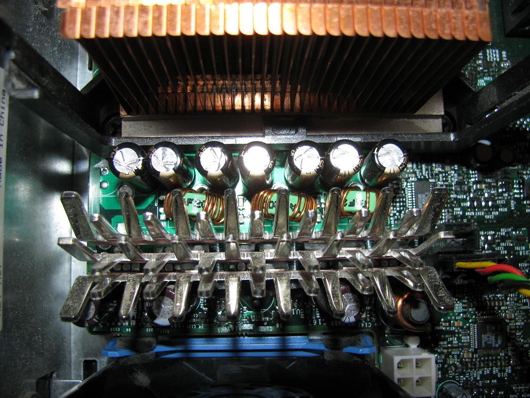

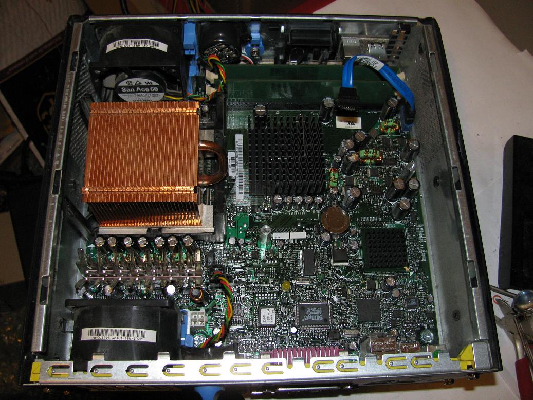

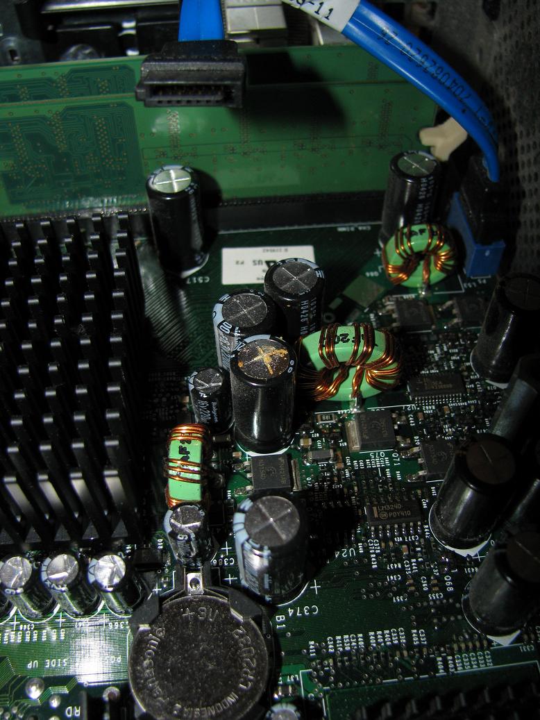

                          @PCTech - Yeah TC said that very rarely do the Vcore ones by the CPU go bad. This unit apparently has a Pentium D though, according to the badge on the front, and I know those run hot, and power hungry, so I was thinking of replacing them anyway. Current it has 10 Rubycon MCZ, all look fine. Do you (or anybody else) think it's worth it to replace these? There seem to be 4 empty spots for more, should I just fill those with the Polys and leave the Rubys?
                          When I try to power it on, the fans spin and I get the blinking yellow, which is probably due to the blown Nichicon. I took some pictures:
                          Overall:
                          Blown Nichicon and it's buddies:
                          VRM for the CPU:
                          I'm definitely going to replace all the nichicons. I can use either Rubycon MCZ or Nichicon HZ to replace them. Which would be better? I think the HZs are rated better. Should I replace the rest of the Rubys too? My plan for this computer is to fix it and then sell it, and I don't want whoever I sell it to to have it break again after a little while. But, I also don't want to waste a bunch of caps in places I don't need to use them. Any thoughts/suggestions? Thanks!

                            Those are great pics etnietering!

                              I can see most of a date code on one of the Nichicons.
                              It's H0425 or H0426.
                              That would be Year 2004, week 25 or 26 and it's during the run of defective HM/HN caps.
                              I would:
                              Replace all the HM/HN with the likes of MBZ or MCZ.
                              - [Panasonic FM for small 4&5 mm ones.]
                              If those 16v under the heatsink are KZG those should go too.
                              Upgrade any 85c caps that aren't Rubycon or Sanyo to 105c caps.
                              - And it should be good to go for a few more years. [If new owner keeps it clean!]

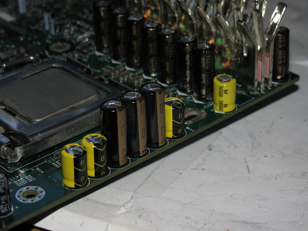

                                Yeah, all the nichicons are from 04, and as soon as I saw that I said they're going.

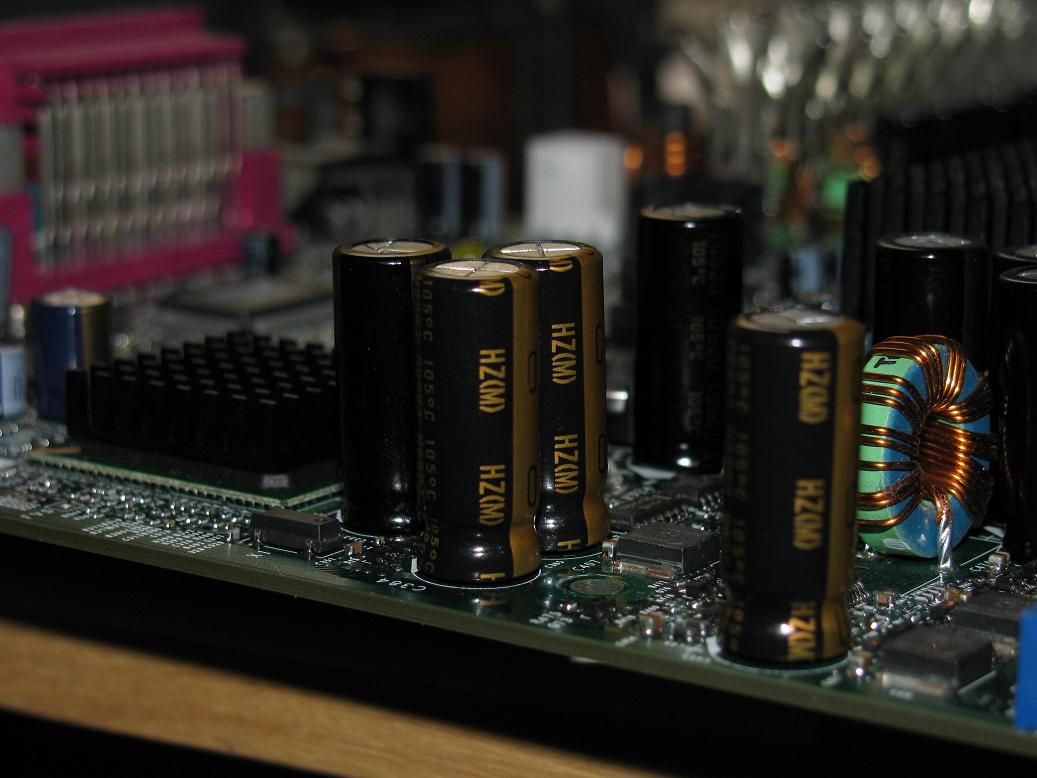

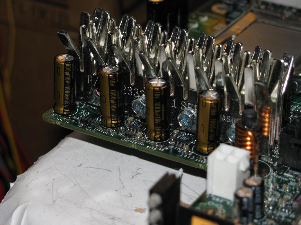

                                I've done the following replacements so far:
                                8x Nichicon HM 2200uF @ 6.3v -> 8x Rubycon MCZ 3300uF @ 6.3v
                                3x Nichicon HN 1500uF @ 16v -> 3x Nichicon HZ 1800uF @ 16v
                                3x UCC KMG 1000uF @ 16v -> 4x Nichicon HZ 1000uF @ 16v
                                4x empty spots -> 4x Fujitsu FPCap 820uF @ 2.5v
                                Oh and the CPU is in fact a Pentium 4 (The Pentium 4 520 if I remember right), so a previous owner must have just had an extra Pentium D badge and replaced the P4 one
                                And now, for the pictures!
                                After the first set - the nichicon HNs -> Rubycon MCZs
                                Here's the set of 3 10mm HZs that replaced the HNs
                                Here's the 4 HZs on the input side of the CPU VRM - These were a major pain! They're partially under the heatsink, so you have to put them in crooked...I got them in eventually though
                                And here's the Vcore caps, after the addition of 4 fujitsu polymers. I figure these will take over quite a chunk of the ripple, and should let the MCZs that were already in there be fine
                                @Bonez: So the rest of the rubies should be fine? There are 5 820uF @ 6.3v MBZs, a bunch of 220uF @ 16v YKs, and a 1 150uF @ 6.3v ZL. The other little ones are a couple nichicon 22uF @ 25v unknown series, and a single 100uF @ 16v, which is by a company whose logo is an R in a box. I don't have the parts currently to replace these. The 100uF @ 16v is rated for 85C, so I should replace that one. Do the nichicons need to be replaced too? They're rated for 105C. I'd like to only have to order once....
                                In the meantime though, I'll put it back in the case and put everything back together, and see if it works.....and if so, run prime95 on it until I either get more caps to put in, or somebody wants to buy it.
                                Thanks!

                                  Looks good so far. I would just replace all the 85c caps with 105c caps with how hot these ovens get.

                                    Well i threw everything together and got it running again. Took it a couple tried to get windows to load up properly, and i couldn't get any of my linux CDs to boot....they all had problems with the dells at my high school too, so I'm not worried too much. Ran memtest for about an hour (5 passes) with no errors. Now I've got prime95 going, it's been going for about 15 minutes with no problems, but I'm going to let it go a couple days, just to make sure.
                                    Also - does anyone have the dimensions of the little nichicons that I need to replace? I could open it up and look, but it's running and I don't want to interfere with the torture test. If somebody's replaced them before and knows the measurements and could tell me, so I know what to order, I'd greatly appreciate it
