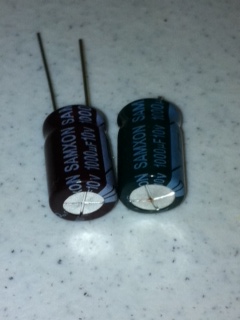

guys, this thread is money! replacing the same cap worked for me. I also saw the bulge but just needed more confirmation!
I've posted a link to this thread on samsung 260f avsforum thread to help other people out. Just fyi, I called in samsung and they gave me 90 bucks, even though it was out of the warranty period! Used 20 bucks for the replacement caps and soldering iron kit and the rest will go to further my other bad habits
