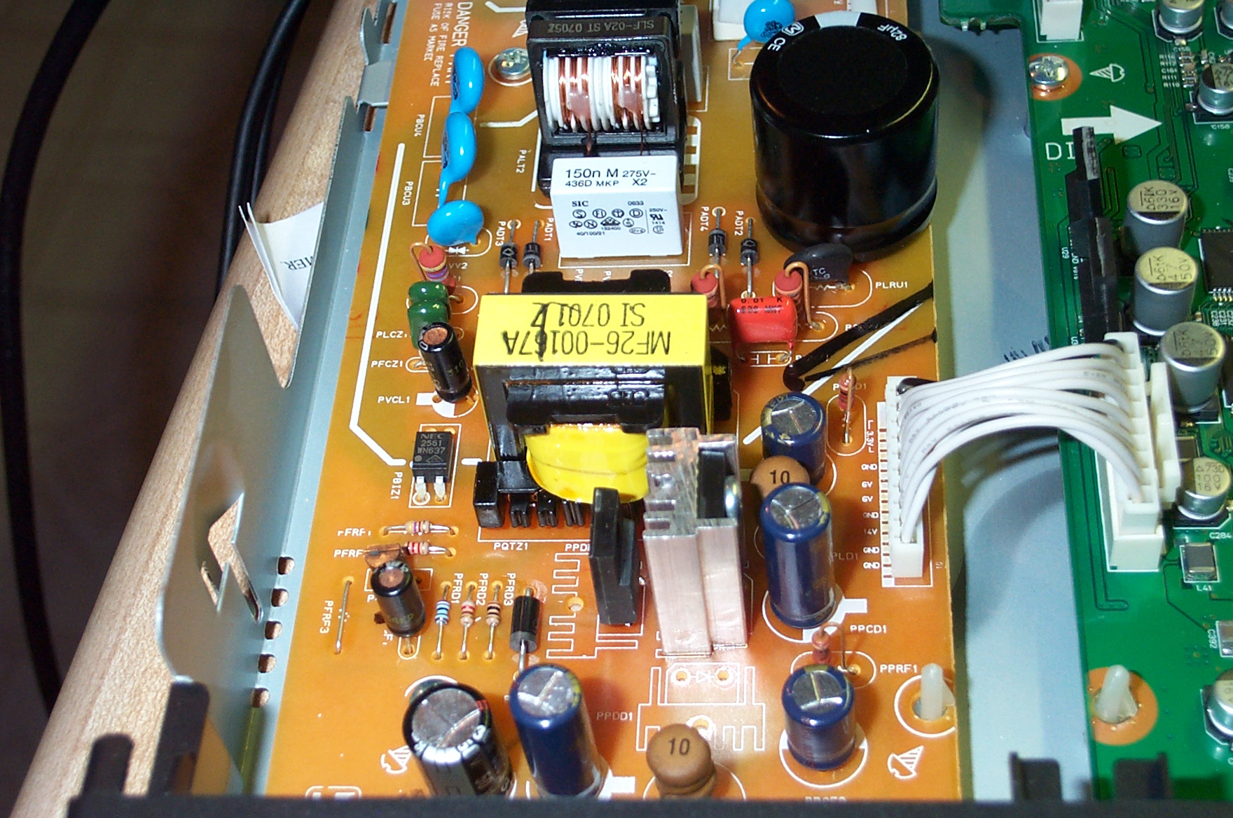

    I have a Samsung DTB-H260F HDTV Tuner that is not working. When the power button is pressed the blue power light comes on for 1/4 of a second and then goes off. Cracked the case open and found one bulged Samxon 1000uf 10v cap on the power supply board. Replacements for all the electrolytic caps on the psu board are on the way from digikey. Will update on the status of the patient once they come in. See attached image for the problem cap.
  • japlytic
    • Oct 2005
    • 2086
    Re: Samsung DTB-H260F HDTV Tuner
    If replacing this capacitor makes the set-top box work again, replace all of the capacitors on the secondary side of the power supply board with Nippon Chemi-Con KY Series.
      That poor samxon was overheated in that hot spot. Not the Samxon issue.
      Cheers, Wizard
      • Krankshaft
        • Jan 2007
        • 2328
        Nope it's not about heat that's Samxon GF series the series is pure crap they bulge regularly in hot LCD inverters. This is the Nichicon HM series of Samxon the one where they dropped the ball.
        Just get a decent series from any of the top companies like Panasonic FCs for example and you'll be fine. Replace any other GFs you find too.
        Better yet just replace all the secondary caps to start on a clean slate.
        I see you already order from Digikey as long as the caps are low ESR then you'll be fine.
        My Cablecard set top box PSU is full of Samxons too. I peep in through the vent holes regularly and see no hunter green Samxons (GF series) or bulging whatsoever so I'm exempt from the GF plague .
        This is why I still don't trust Samxon to the same extent I trust Panasonic, UCC, and Nichicon. They in my opinion are still new kids on the block.

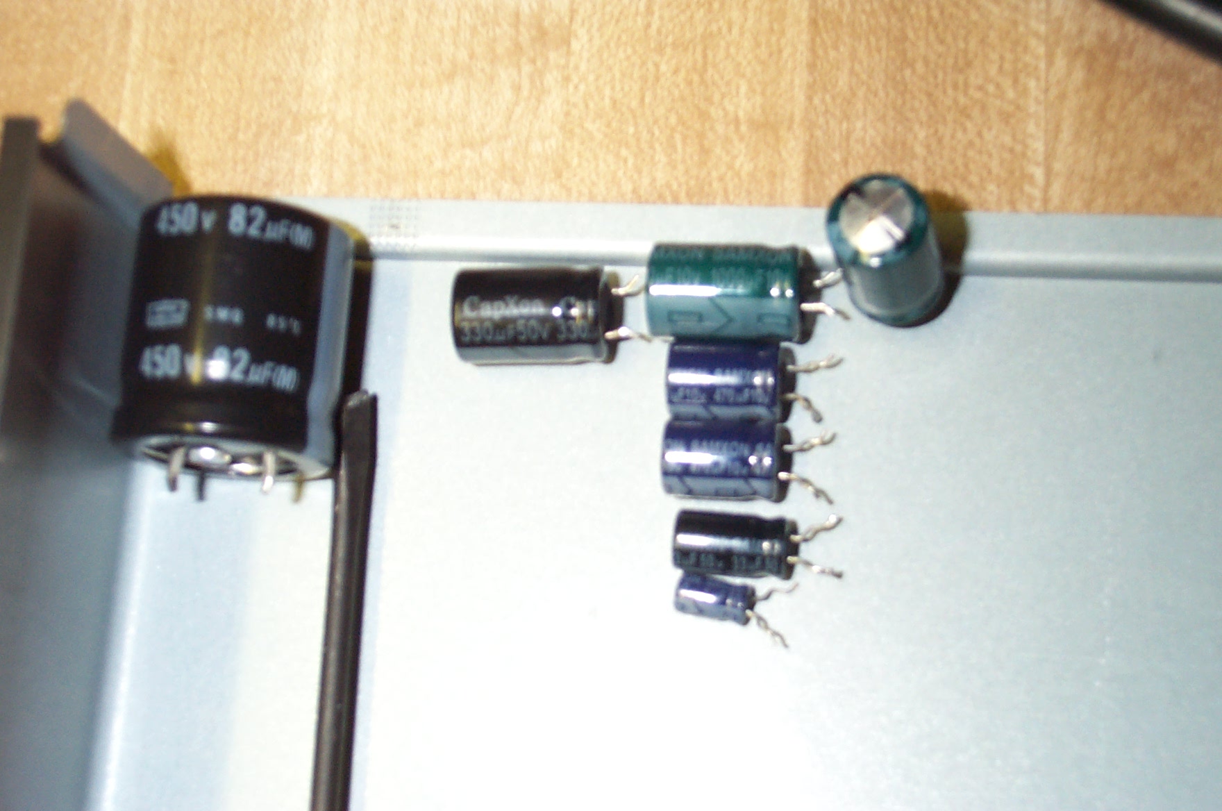

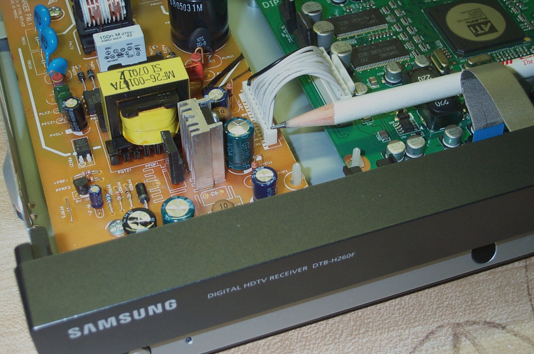

          • bluto
            • Oct 2007
            • 557
            Good news, the patient lives! Replaced the 1000uf and 470uf caps with new Panasonic FC caps and the filter cap with a Panasonic TS-ED series cap. The other three were replaced with some Panasonic NHG caps that i had lying around. Plugged everything in and it came right up. Another $200 device saved from a 10 cent cap!
            Thanks for the replies and thanks to TC for this great resource!

                • just2view
                  • Oct 2009
                  Thanks for your help. I'm an electronics novice but I do know how to use a soldering iron. With your information I was able to save my only high-def source by replacing the failure-prone 1000uf capacitor.
                  • bluto
                    • Oct 2007
                    • 557
                    Glad to see that my post is helping others fix their tuner. To make it easier to order new capacitors, here are the digikey part numbers for all the caps on the power supply.
                    All are Panasonic FC except the filter cap.
                    P10224-ND 1000UF 10V (qty 2) replace these two caps at the minimum
                    P10221-ND 470UF 10V (qty 2)
                    P11258-ND 330UF 50v (qty 1)
                    P10320-ND 33UF 50v (qty 1)
                    P10312-ND 1UF 50v (qty 1) polarity not marked on board, note before removing
                    P11695-ND 82UF 450V (qty 1) the large filter cap, replace this while you are at it
                    total cost should be no more than $15 with shipping

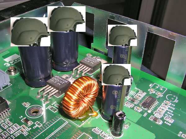

                              • Krankshaft
                                • Jan 2007
                                • 2328
                                I like the picture what kind of stupid engineer would put caps that close to the V regs?
                                Using the PCB ground plane as a heatsink to boot what a stupid design. Unless you're using low wattage SMT parts that won't generate much heat there's no excuse for this. At least a dedicated heatsink can have fins and more surface area.
                                • Wizard
                                  • Mar 2008
                                  • 2296
                                  Krankshaft,
                                  This two regulators are not linear regulator (LM2576) and have inductor coil for each and run cool. Some makers used poor capacitors that's all.
                                  http://www.national.com/mpf/LM/LM2576.html#Overview
                                  On this Samsung DTB.... box, these are not regulators, these are diodes. One have heatsink, while other one without.
                                  Cheers, Wizard
