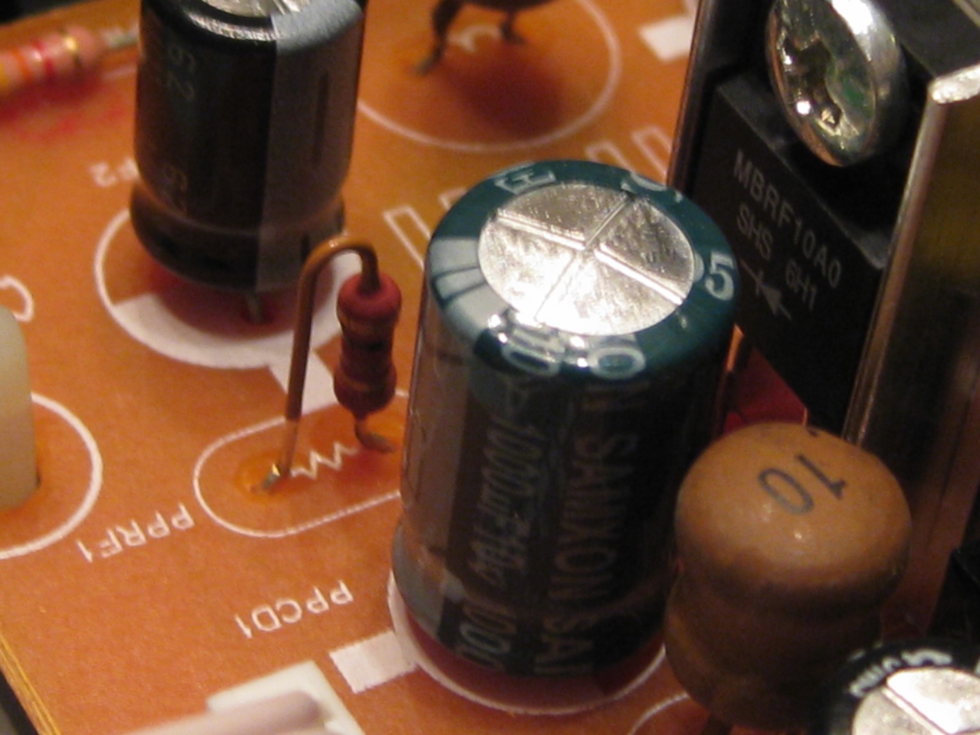

    Beware, the Panasonic NHG is general purpose, not low ESR. GP caps are not ideal devices for filtering a switching power supply output. They might not last very long in that application.

      Thanks for the tips. My tuner just died and the same exact cap bubbled. I replaced it with a Panny 1000u FC cap and it's working again. Fantastic!

          MJA28, did replacing the caps fix your problem? My H260 seems to be behaving more like yours than like bluto's. When I plug the tuner in, I get the 1/4 sec LED blink. Then when I press the power button, the LED lights for ~10 seconds before going out. I can't get it to light again unless I unplug it for a couple of minutes.
          None of the caps appear to have a domed cap, PPCJ1 has a bit of discoloring on the top but it appears to just be permanent marker.

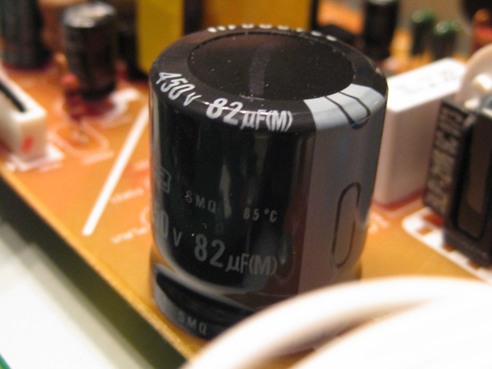

                                  mine is back to life too .I replaced only 2 caps.Samxon 1000uf 10v,and 450v 82uf. for sure the 1000uf was bad,but I wasn't sure about the 450v so i replaced it just for the heck of it(and easiest one to replace lol)
                                  reason i didn't replace all of the caps because my hands shaking issue(too much caffeine)

                                        Well, that's the thing. None of the capacitors are clearly broken, as far as I can tell. (Though I am new to this kind of thing.)
                                        The only one that makes me nervous is the big 450V cap, which looks a little bulged. So I'd like to replace it as long as I'm in there.
                                          if it's bulged then go ahead.I replaced the 450v just for the heck of it
