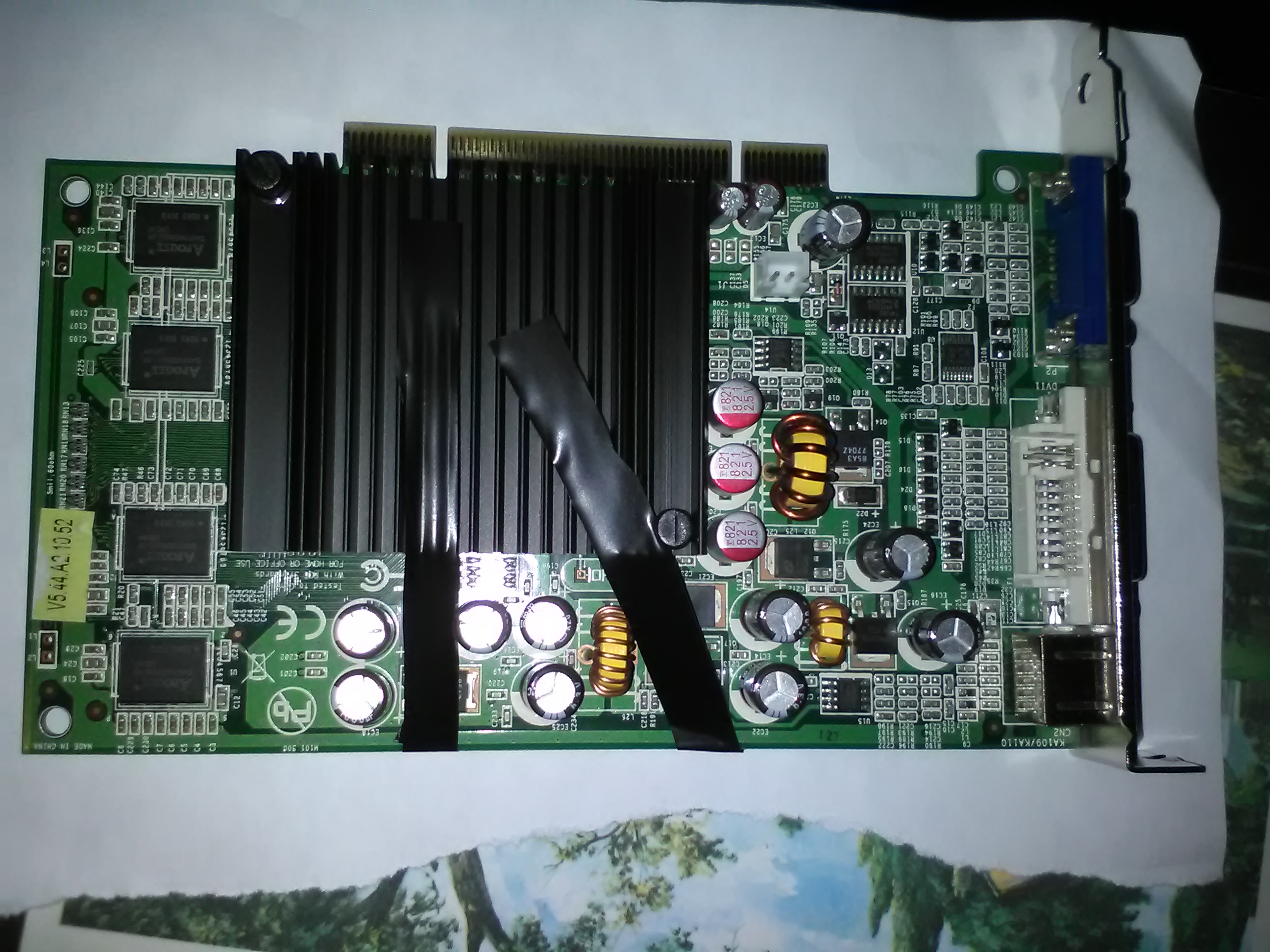

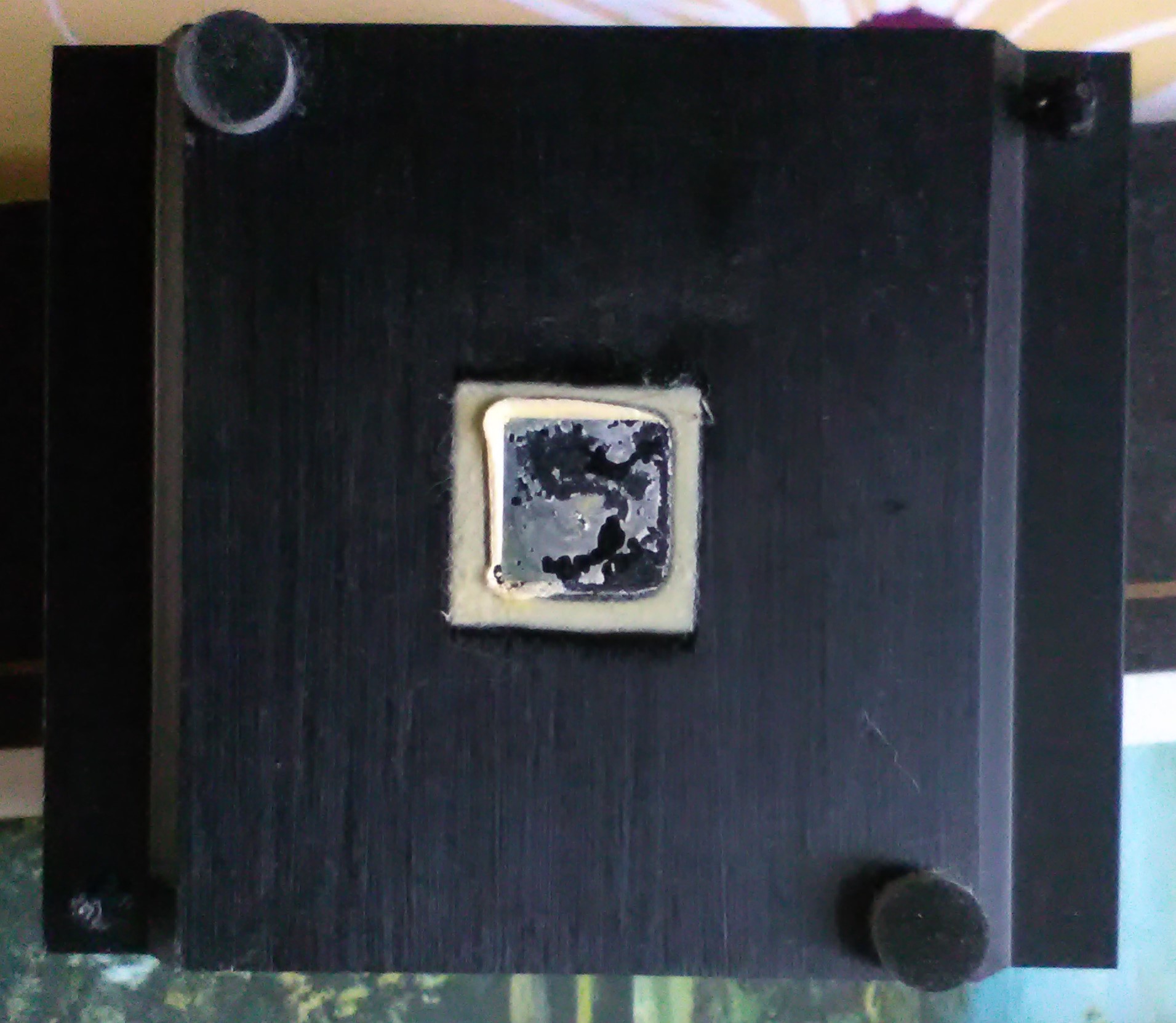

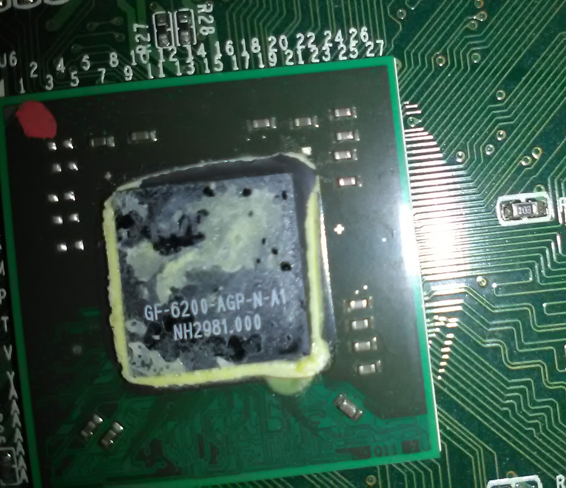

    I took the heatsink off to dry it out after cleaning the card, there was this thermal paste stuff what do I use to replace this with?
    There was numbers written on it. GF-6200-AGP-N-A1
    NH2981.000.
    Seem stuck when I first took it off.
    Is it thermal paste of something else.
    When I put it back it wobbles, it is not stable.
    http://www.ronstultz.com/knowledge/D...%20Freezes.htm
    Found this I got to use small wire to secure it ot the card.

      #42
      Re: PNY Geforce Nvidia 6200 256MB PCI only
      You need to replace the thermal compond.
      For example using Arctic Silver or Arctic Ceramique.
      But before you need to clean off the old compound.
      They sell a product for that too, called ArctiClean.
      P.S: I'm not a chill for Arctic's products even it sounds that way :P
      You can use any compound you prefer.
      And for cleaning isopropanol alcohol, or Aceton works too, with the latter just be careful since it melts plastic.
      Infact any citrus based product probably works, or in a pinch a citrus

        #43
        The heatsink wobbles when I put it back to check. How do I secure it there are two push pins.
        http://www.hse.gov.uk/pubns/indg305.pdf
        • Per Hansson
          • Jul 2005
          • 5895
          • Sweden
          #44
          It wobbles because of all the old crap thermal compound

            #45
            I know how to apply thermal compound on a cpu, I don't know how to secure it to a gpu. I have artic silver5 and the artics clean already.
            I might need washers or small wire to keep it stable.
            I am using electric tape.

              #46
              No no no
              Just leave the cooler/heatsink mounting AS IS. It wobbles, because the GPU die is fairly small and the cooler is fairly wide. It didn't do that before, because that old thermal compound is the gummy stuff that also acts as an adhesive. It was very popular back on older cards, including the Radeon 9700 and GeForce 4 TI line. Just remove all of it and apply normal compound.
              As long as the cooler balances flat on the GPU die (which will happen only if you clean all of the old gunky compound away from both the GPU and the cooler completely), ignore the wobble. You can also use a flash light to look between the cooler and the GPU to see if there are any gaps between the die and the cooler - there shouldn't be, unless your push-pin mounting is damaged somehow. I doubt you'll have any, but feel free to check.

                #47
                I applied some artic silver 5 on the gpu. Then added it to the heatsink, I washed it with water to clean it. Then dried it for one day.

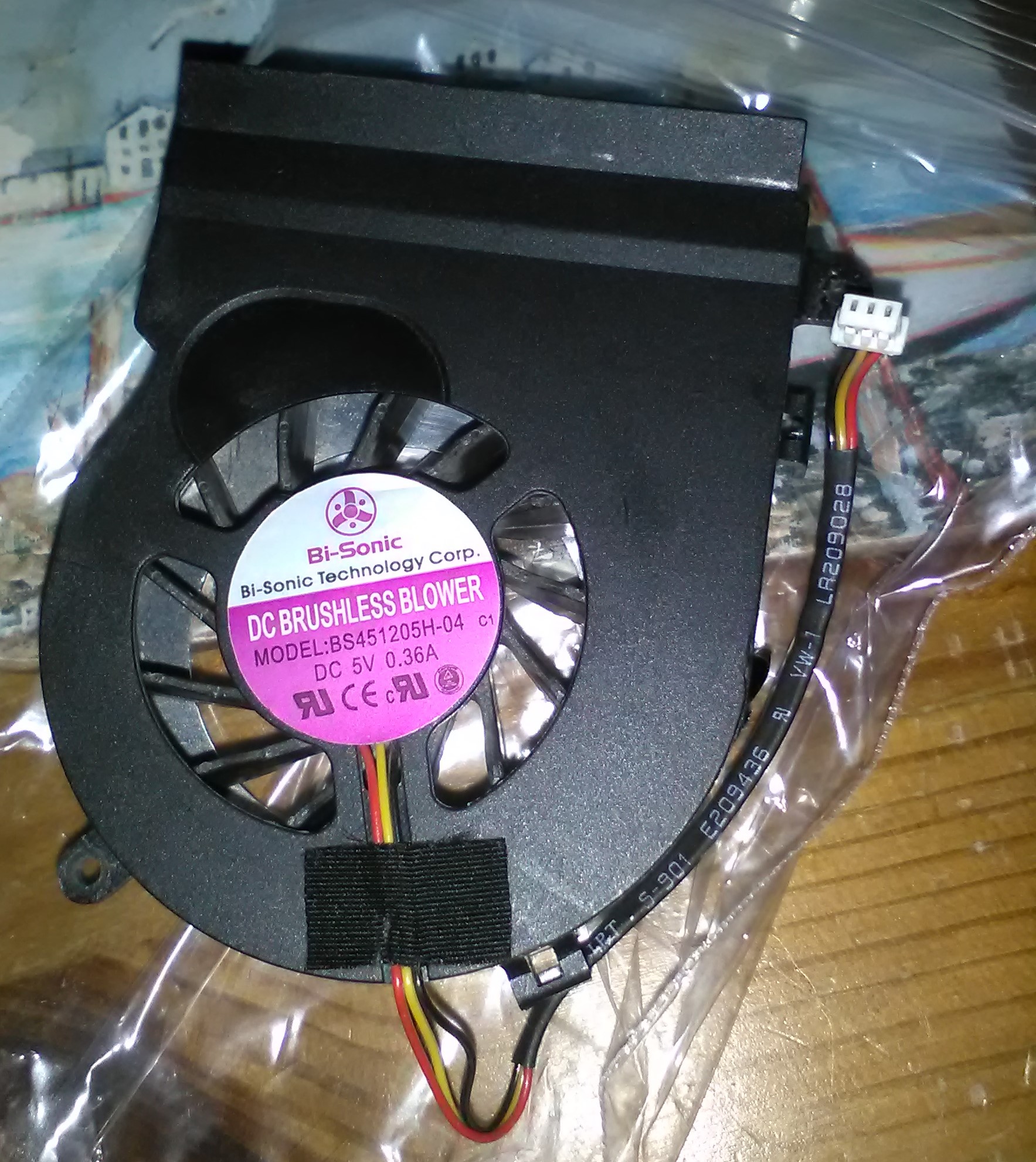

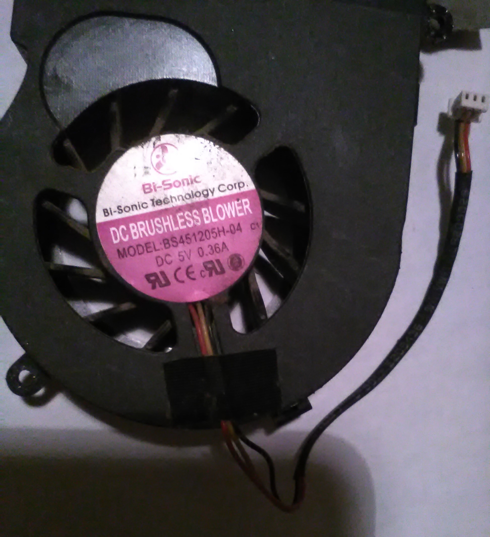

                                  #56
                                  Originally posted by momaka
                                  For gears, optical drive laser guides, and other sliding parts (particularly plastic, but not rotating shafts)... YES.
                                  For failed ball bearings... maybe (I tested silicone grease in a set of failed fan ball bearings, but they still sounded bad afterwards.)
                                  For sleeve bearing fans... Nooooooooooo!
                                  I've tried it it a number of times, all with different techniques and on different fans, in hopes of finding one that would work. But I always get the same result: fan goes back to the original (bad) condition after a very short time.
                                  A good cleaning of the sleeve bearing + light machine oil works the best.

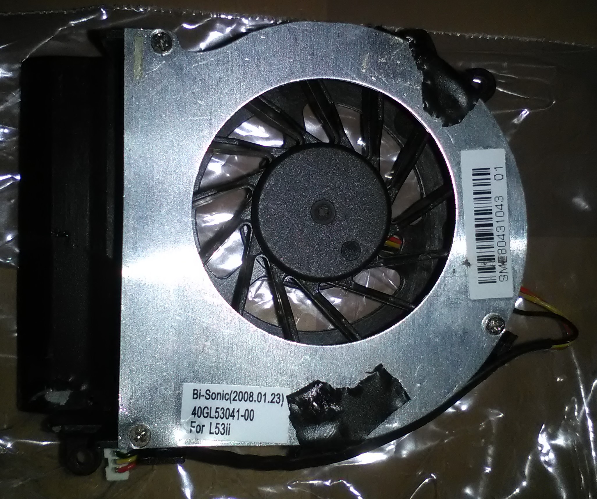

                                  How do you apply this to the optical drive, I took one apart and accidentlly removed some. How do you add it properly???
                                  Sewing machine oil can you add that to fans, how do you take them apart, I don't see how to do it.

                                    #57
                                    Some laptop fans can be disambled simply by pulling the blades, so in your case you can remove the screws that hold the metal plate and try to pull the blades gently.
                                    Or maybe it has a circlip behind the sticker but depends on the fan, some can't be disambled so easy.
                                    Be aware of cheap sewing machine oils they are bad, bad bad... like vegetal oil.
                                    That small fan may not work if you use grease because the grease is to heavy and the fan has not enought power be carefull on the amount of grease if you try it.

                                          #60
                                          The one you show in the pictures look like it came out of a laptop or other portable device. Sometimes those fans are sealed.
                                          Usually you have to get the fan out of the housing (if it is in one) and then remove the sticker on the back of the fan. If not, then just peel the sticker on the back of your fan. Then there should be a C-washer/retainer that needs to be removed in order to free the top part (the rotor / blade assembly) from the fan housing / stator / hub.
                                          That said, if you have a sealed fan, it's much more tricky. I finally figured how to take those apart (without damaging them) literally 2 weeks ago. And to do that, you have to do some drilling. If you haven't opened a regular PC fan, you might want to do that to get familiar with how PC fans are put together.
