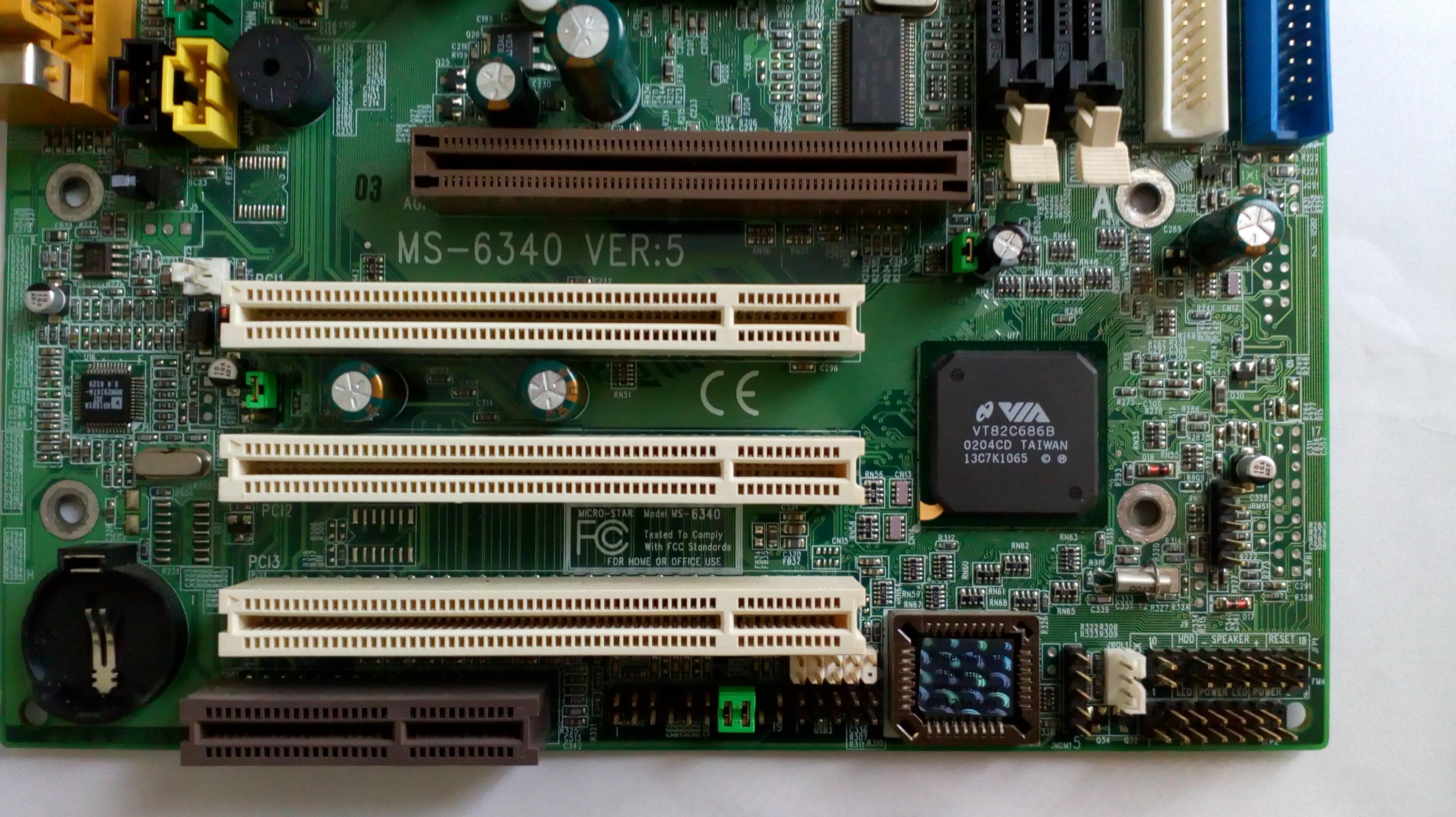

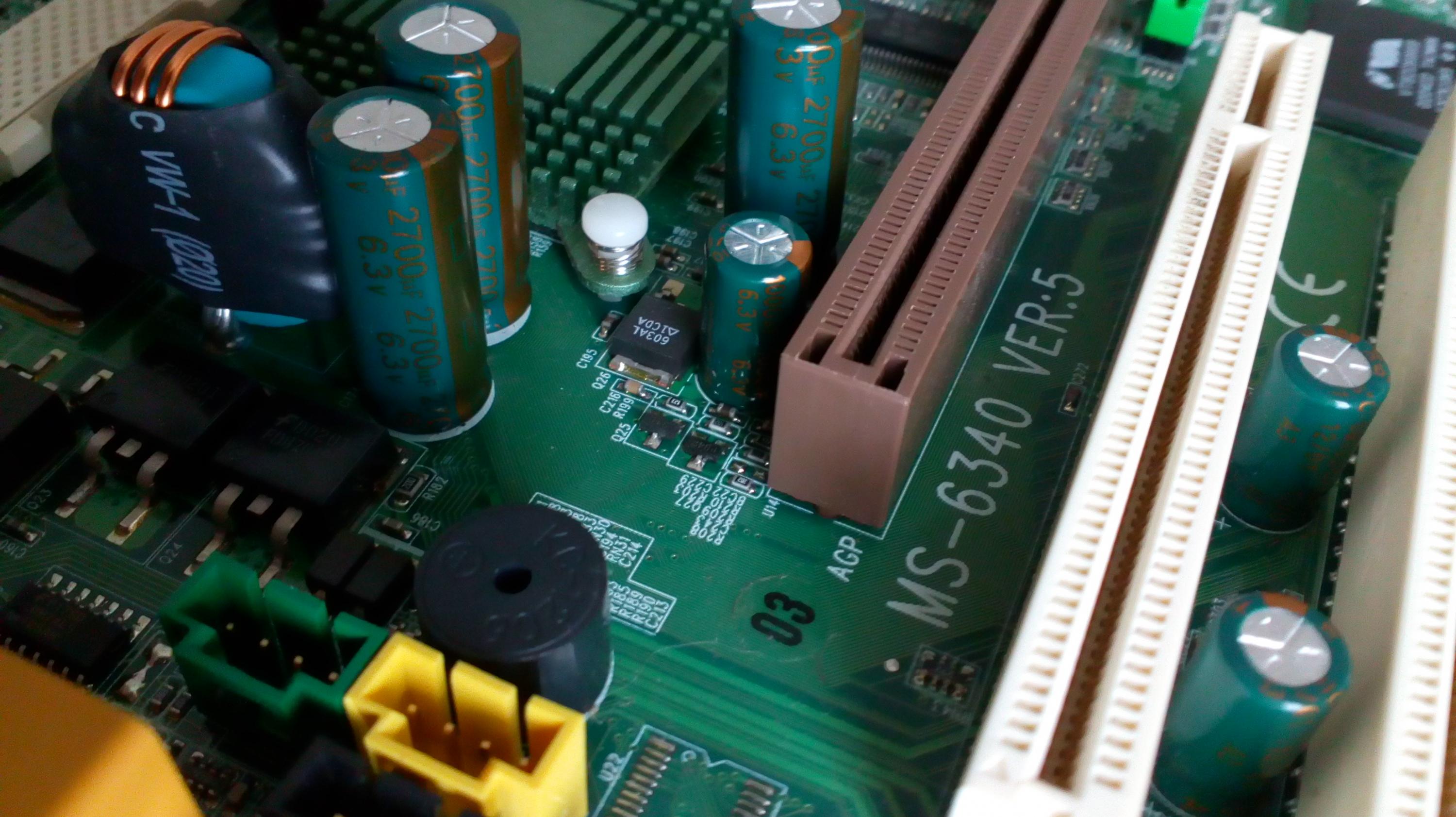

                          #72
                          Re: PNY Geforce Nvidia 6200 256MB PCI only
                          I'm back, I removed 3 capacitors on the motherboard ms6340( right side of the CPU and cleaned it up ) but some leads are stuck to the board and the holes covered over. I smelled my clothes and a bit fo flux smell in on them. What do I do now!

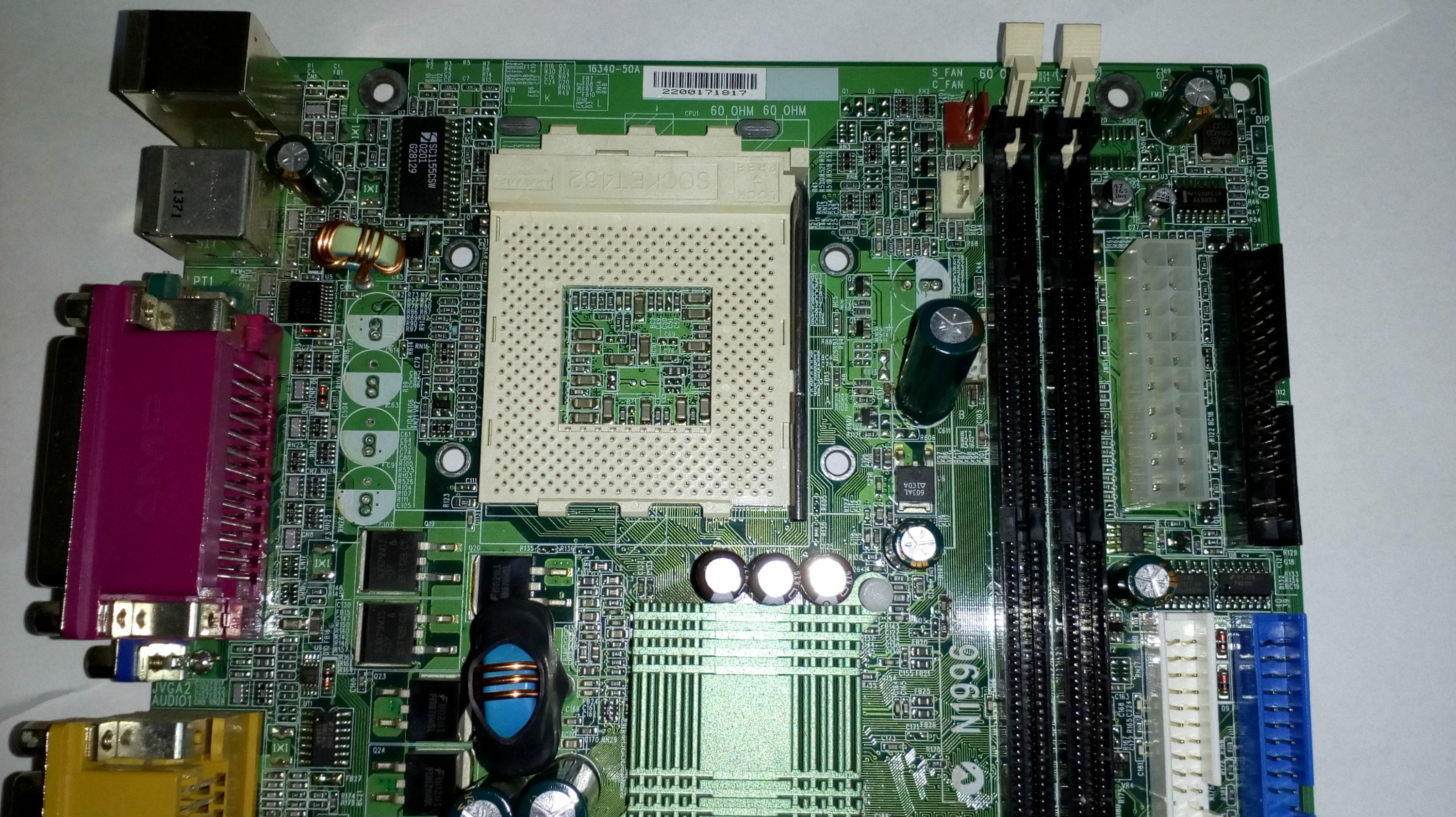

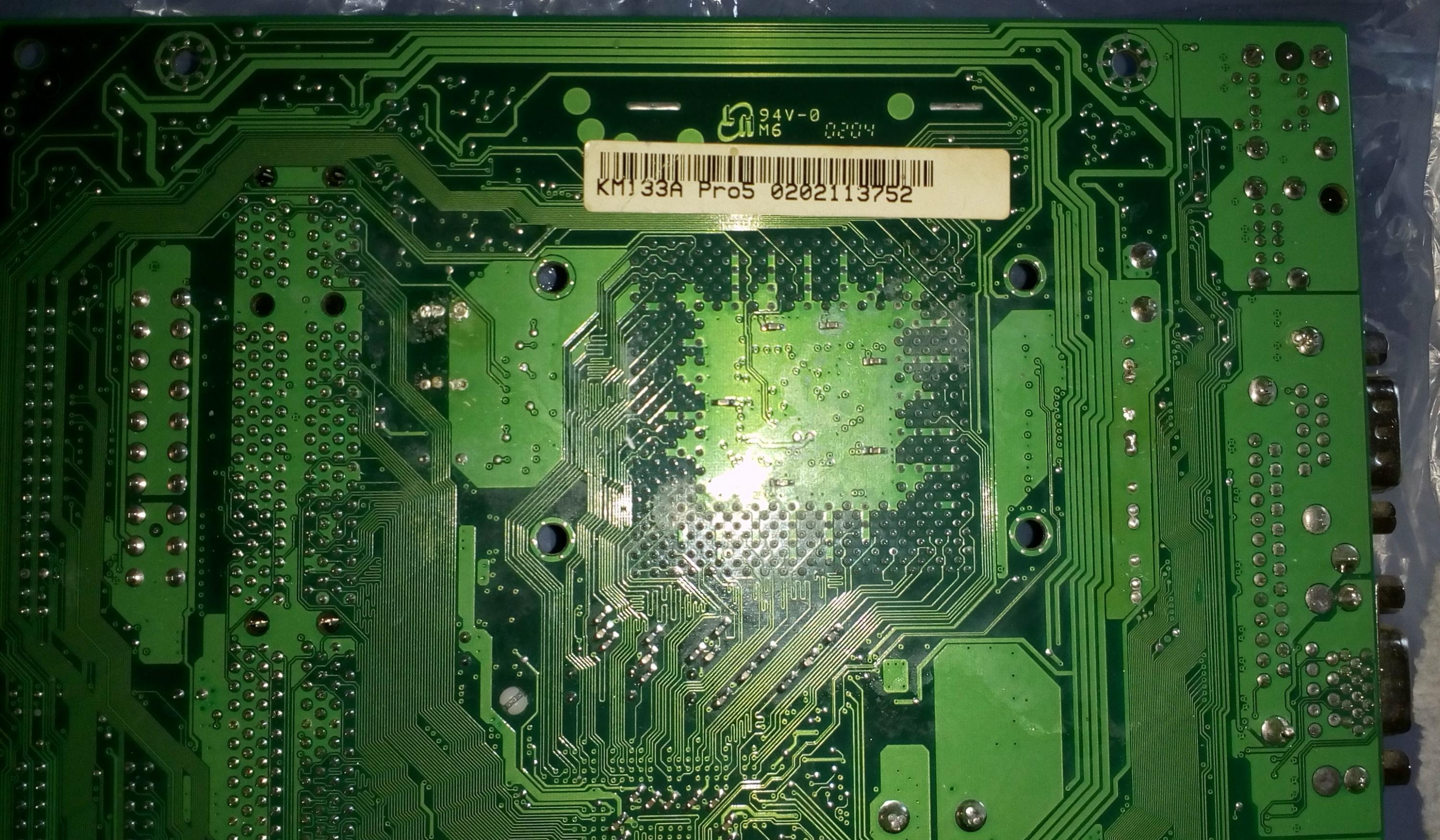

                              #74
                              I got some more pictures to show.
                              What does FCC mean on the board?
