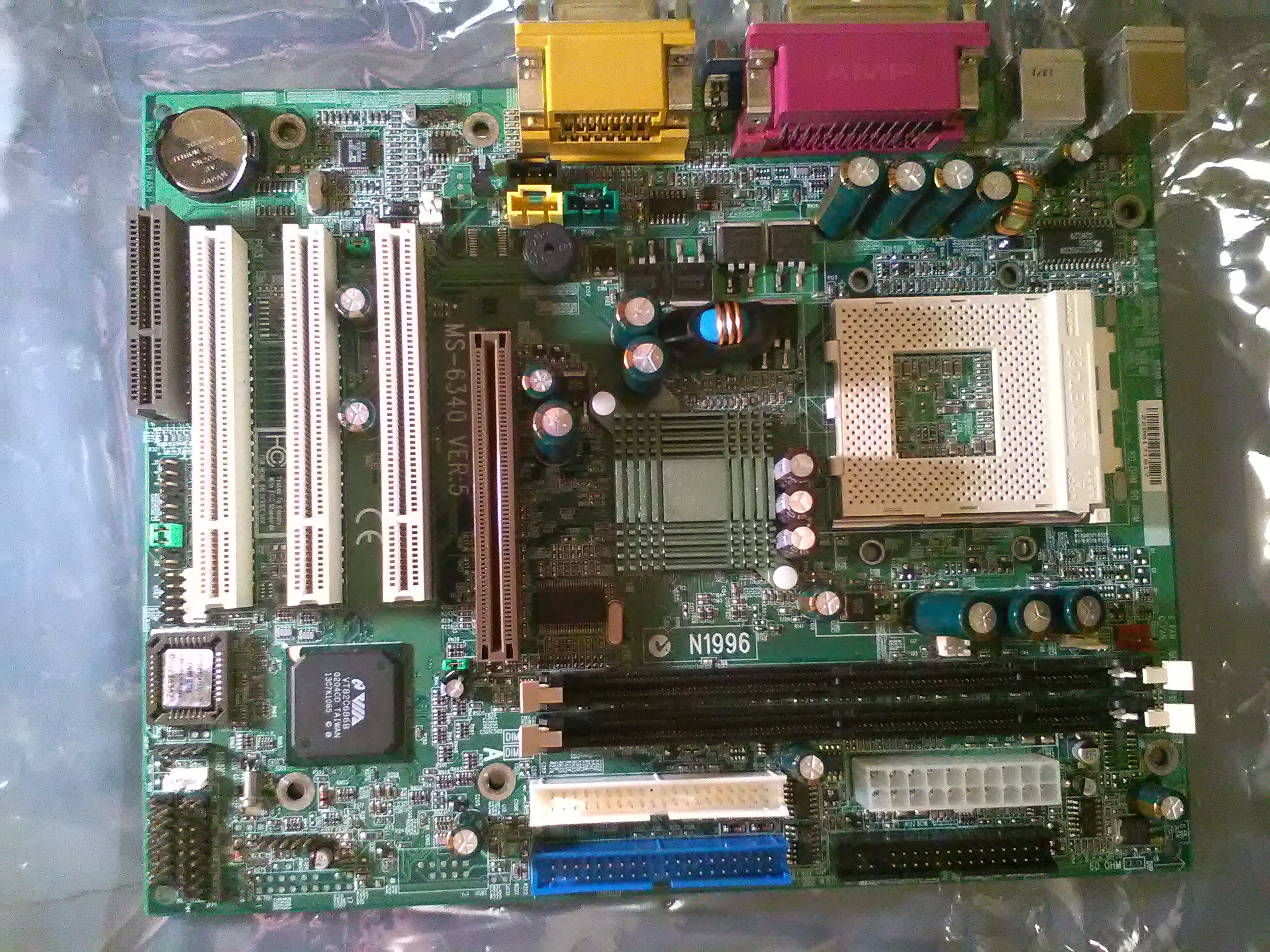

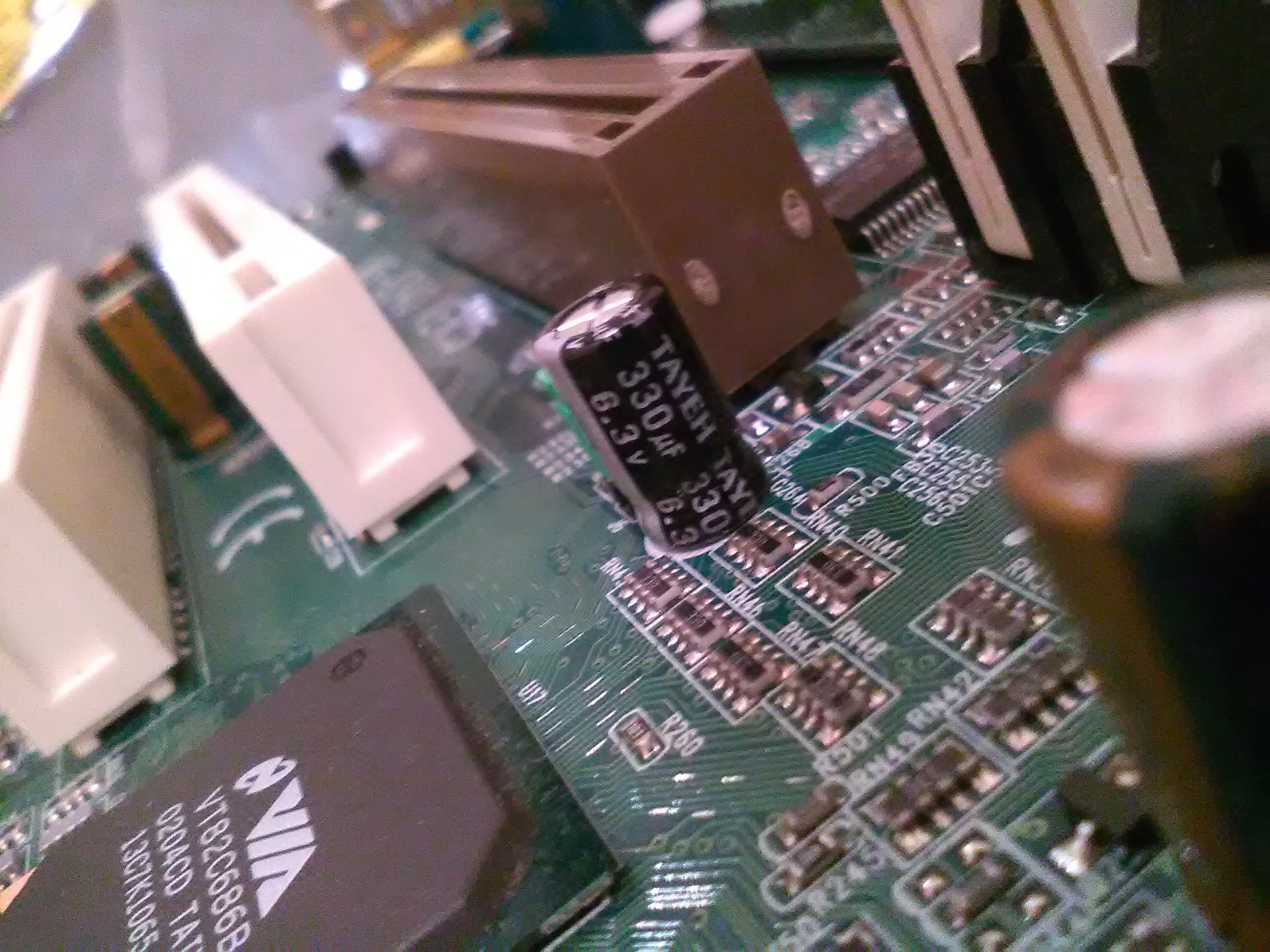

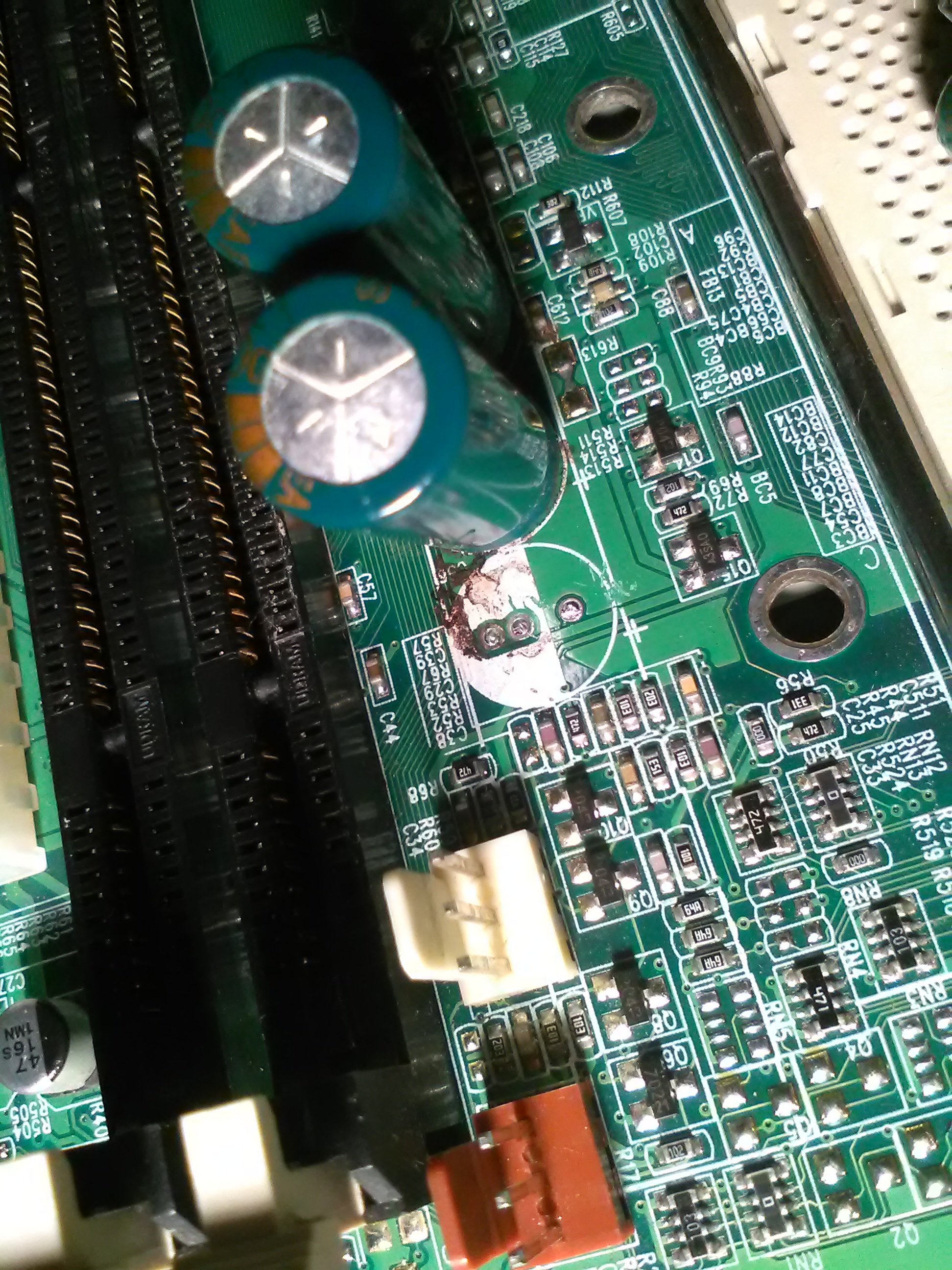

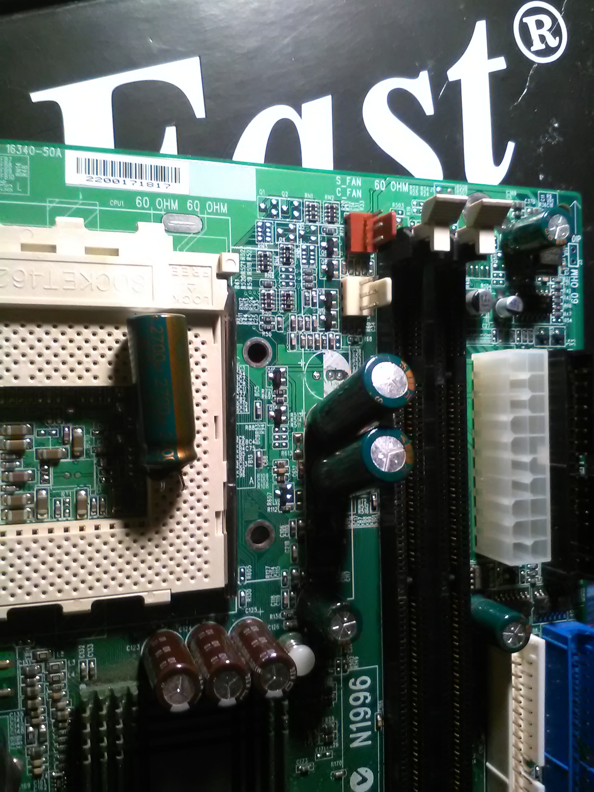

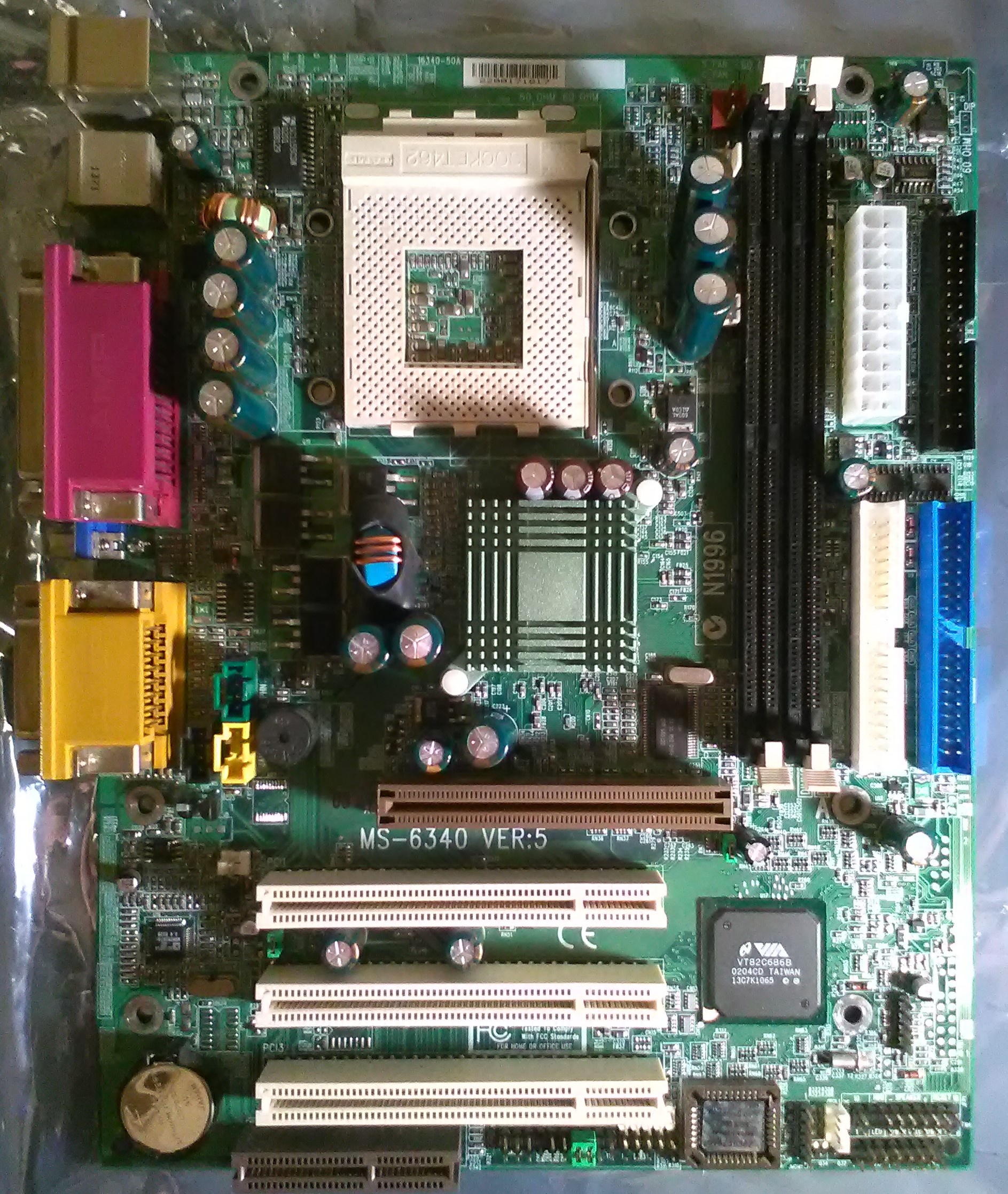

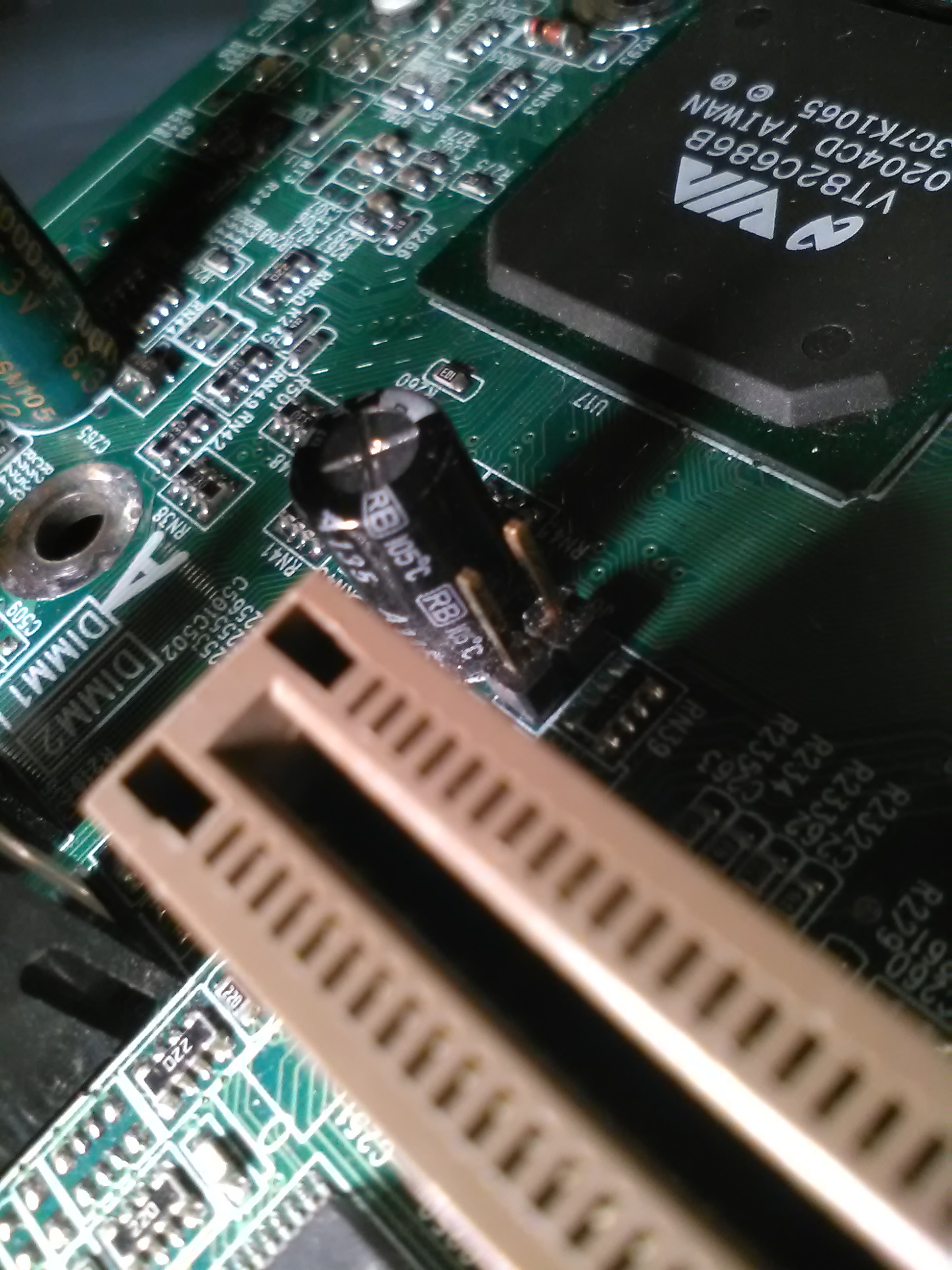

    Previously I got a motherboard 6340 ver5, I bought the correct capacitors and some of the one of 7 set had like sticky tape residue on top of them, like sticky tape left on them. ( I caught the sticky paper on top of them ).
    How do you remove that. I posted a picture on my 13th post.
    Also some solder is stuck on motherboard by cap sticks how do you remove it. A little round spot?

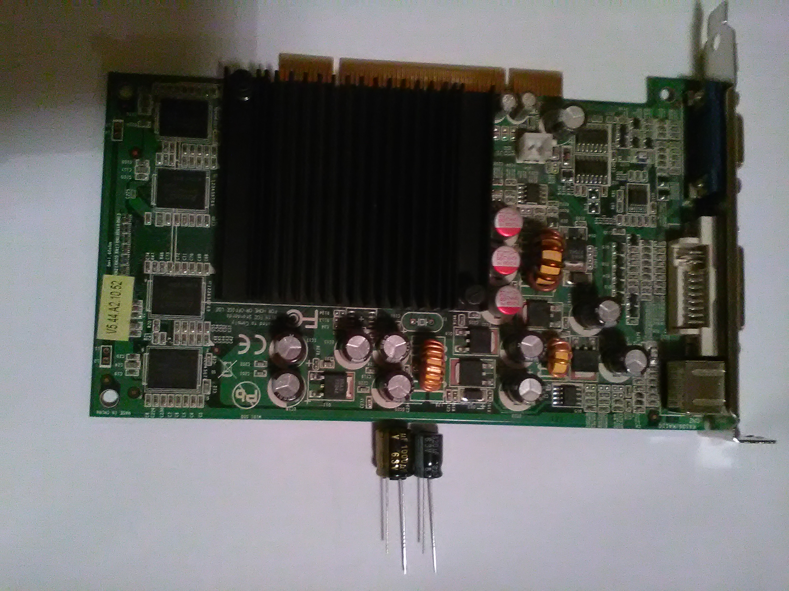

    These are the picture of the motherboard. Here are the specs of those caps.
    2700uf 6.3v SM105 12/01, 25mm height and 10mm diameter.
    Also I need one replacement cap
    Tayeh 330uf 6.3v 105c (RB) (A135) 10mm height 5mm diameter.
    I have the other caps.

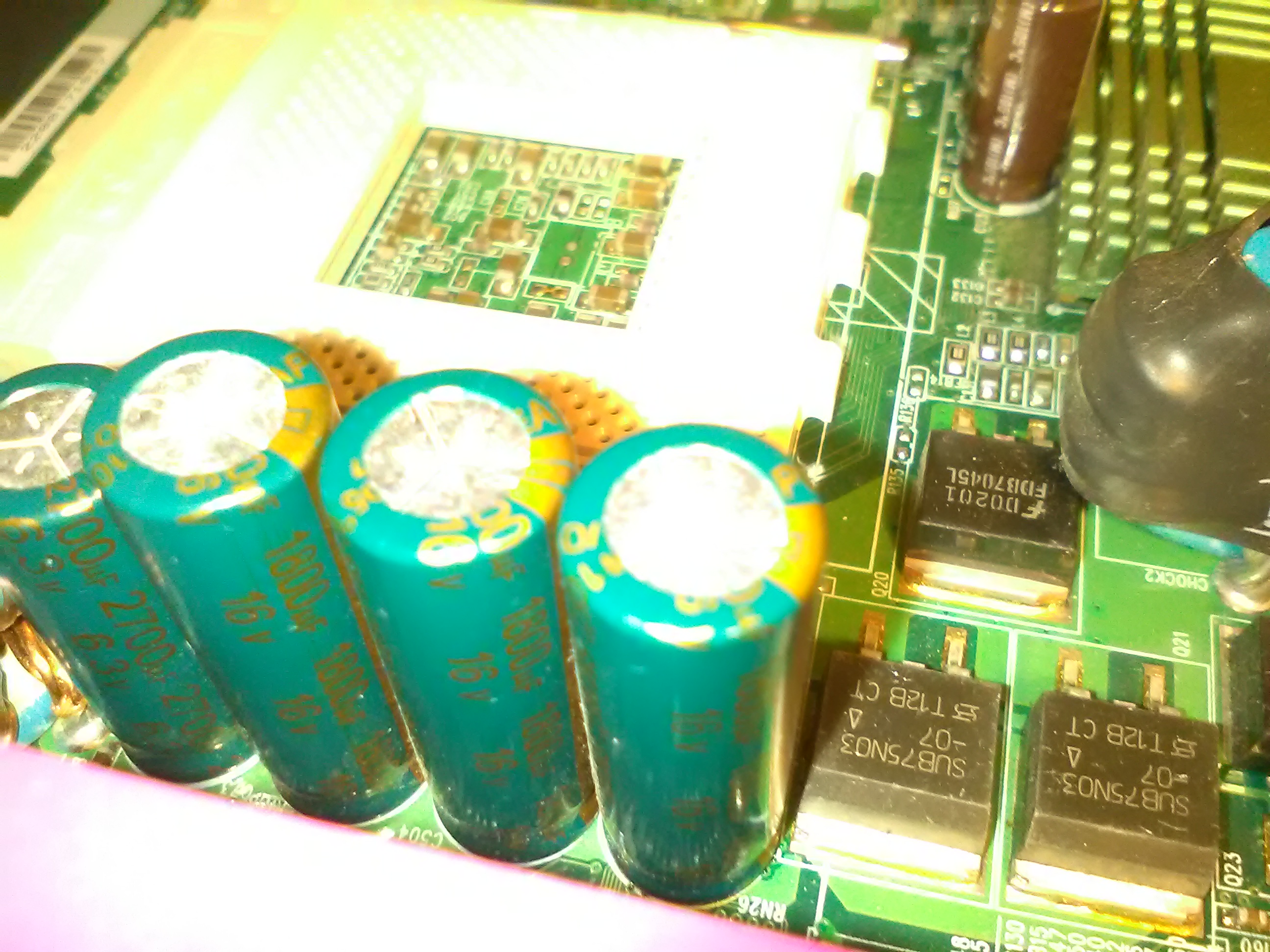

      Originally posted by momaka
      Meanwhile, caps like Rubycon ZLQ/ZLH, Panasonic FS/FR/FM, and Chemicon KZM are just a notch below Chemicon KZG
      Depends on the capacitace/size...
      in 6,3V/820uF the Panasonic FM are equal or superior to Nippon KZG, the only Problem is that they are way larger than KZG.
      With the bigger ones (like 2200uF or 3300uF), things are totally different and the ESR of most normal caps is far worse than KZG; so you can either increase the voltage rating, the capacitance, both or just go for "shitty" Polymers instead.
      The Kemet A750 series seems to be equal in ESR to KZG though way higher Ripple Current-

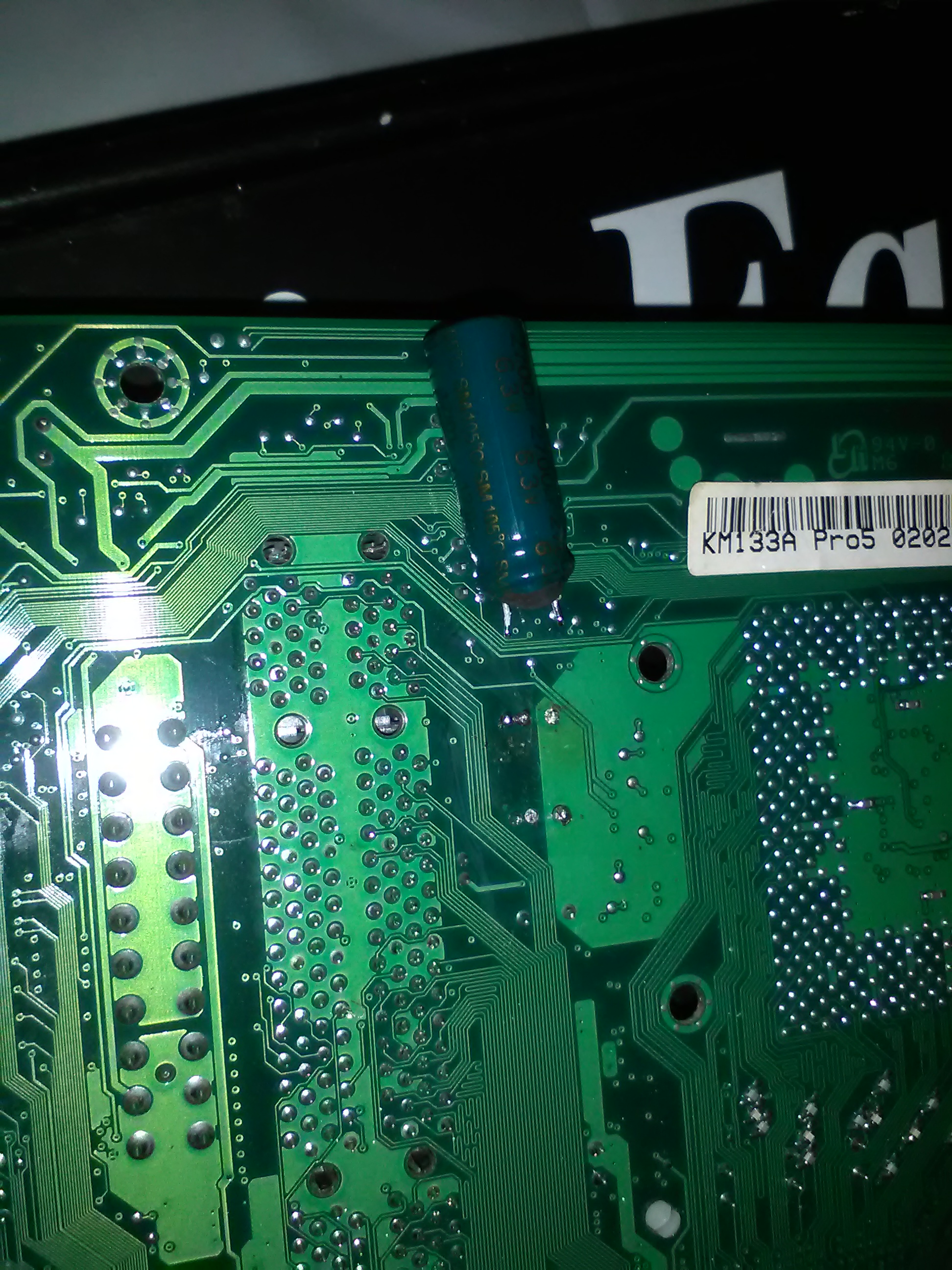

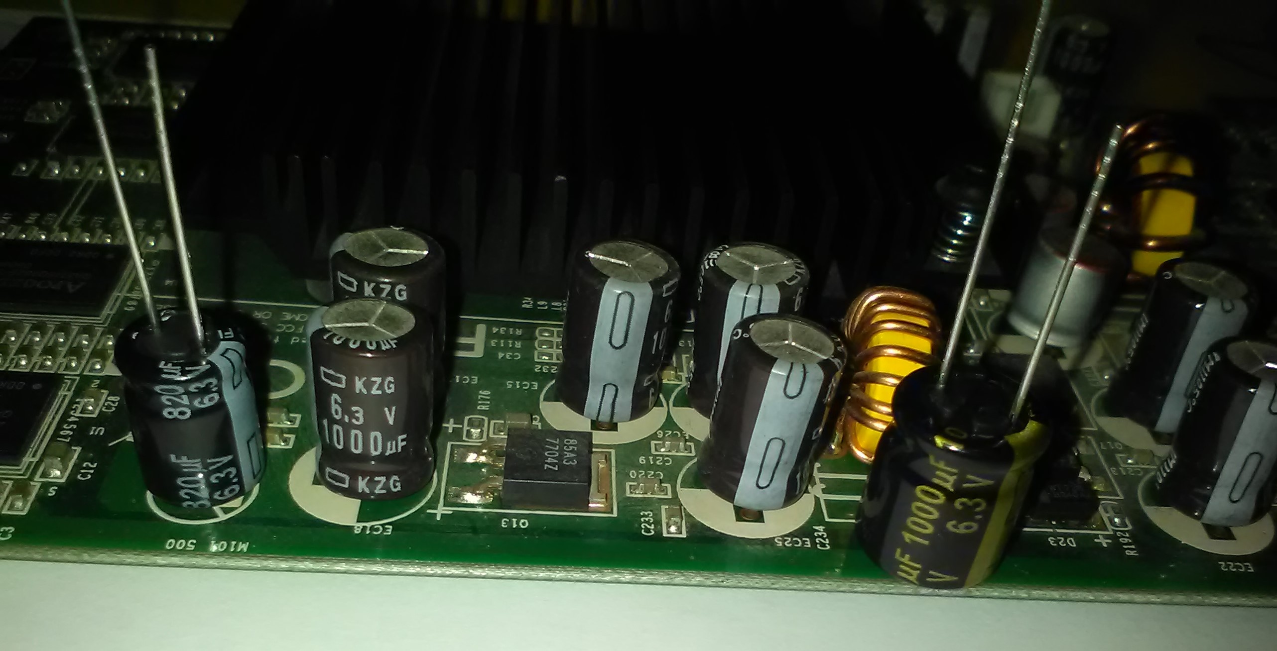

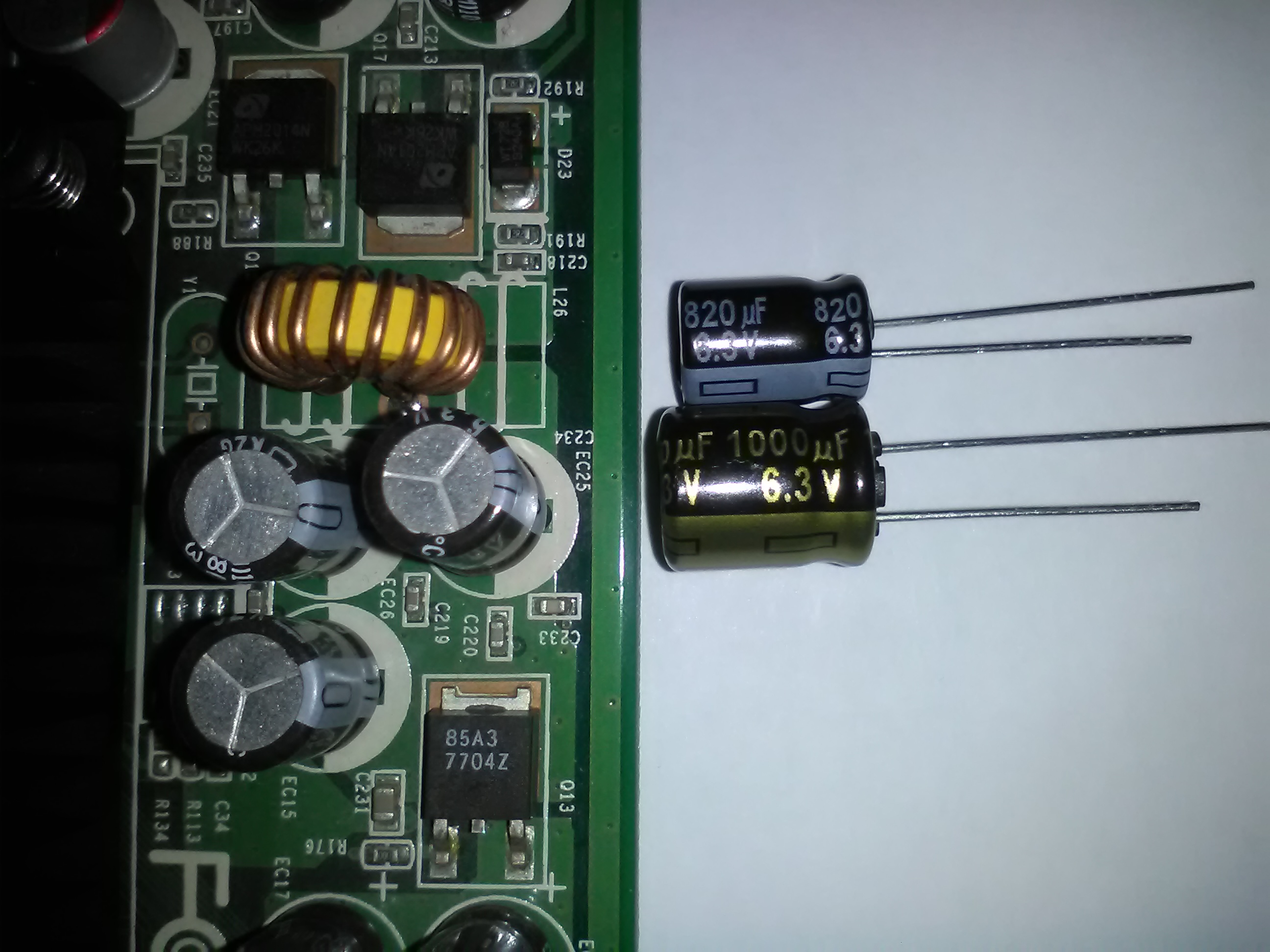

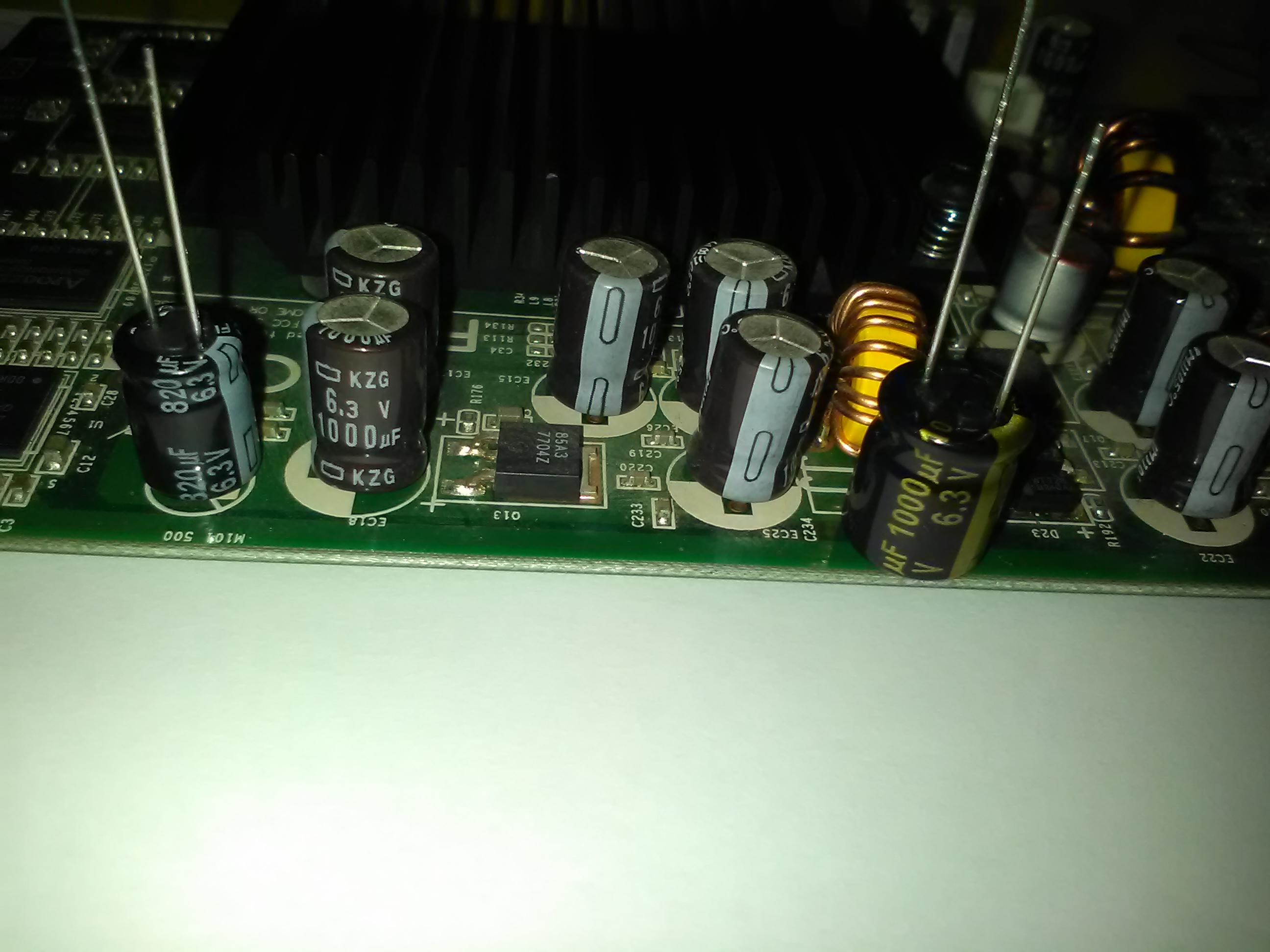

      Originally posted by Fast Alpha
      I made another photo of the capacitor, this is the height of it.
      I noticed on the other side where the legs stick out, the solder is very small, it does not take much solder on the board.
      If you want to replace them, I'd go for entry level Polymers because there is no other viable option.
      For that one you also might use Panasonic FM in 6,3V/820uF.
      BUT: that one is 8x15mm so way taller.
      A 1000uF one is not that tall but 10mm diametre.
      A Kemet A750 is only 8x8mm though ESR is about half the KZG...

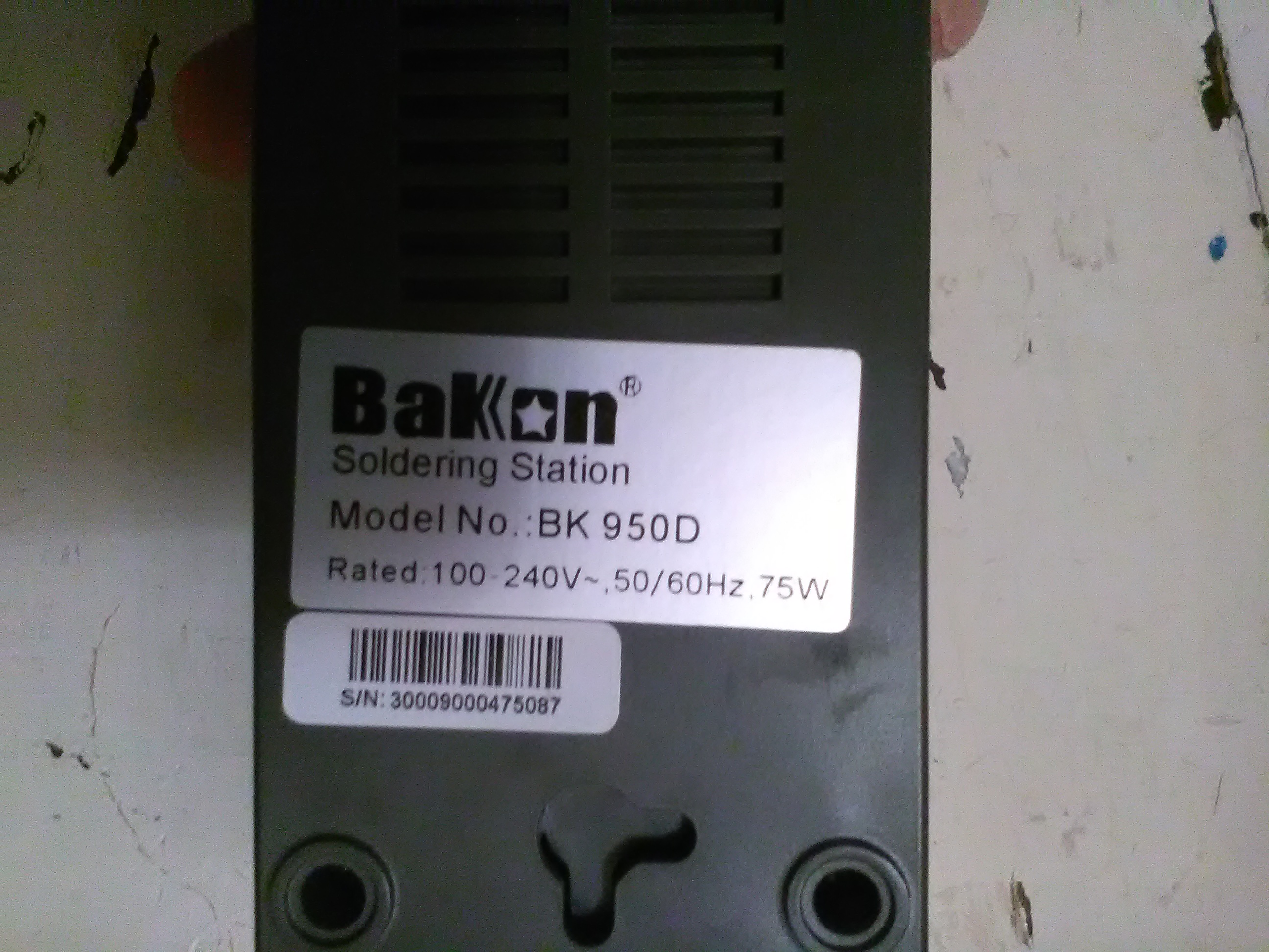

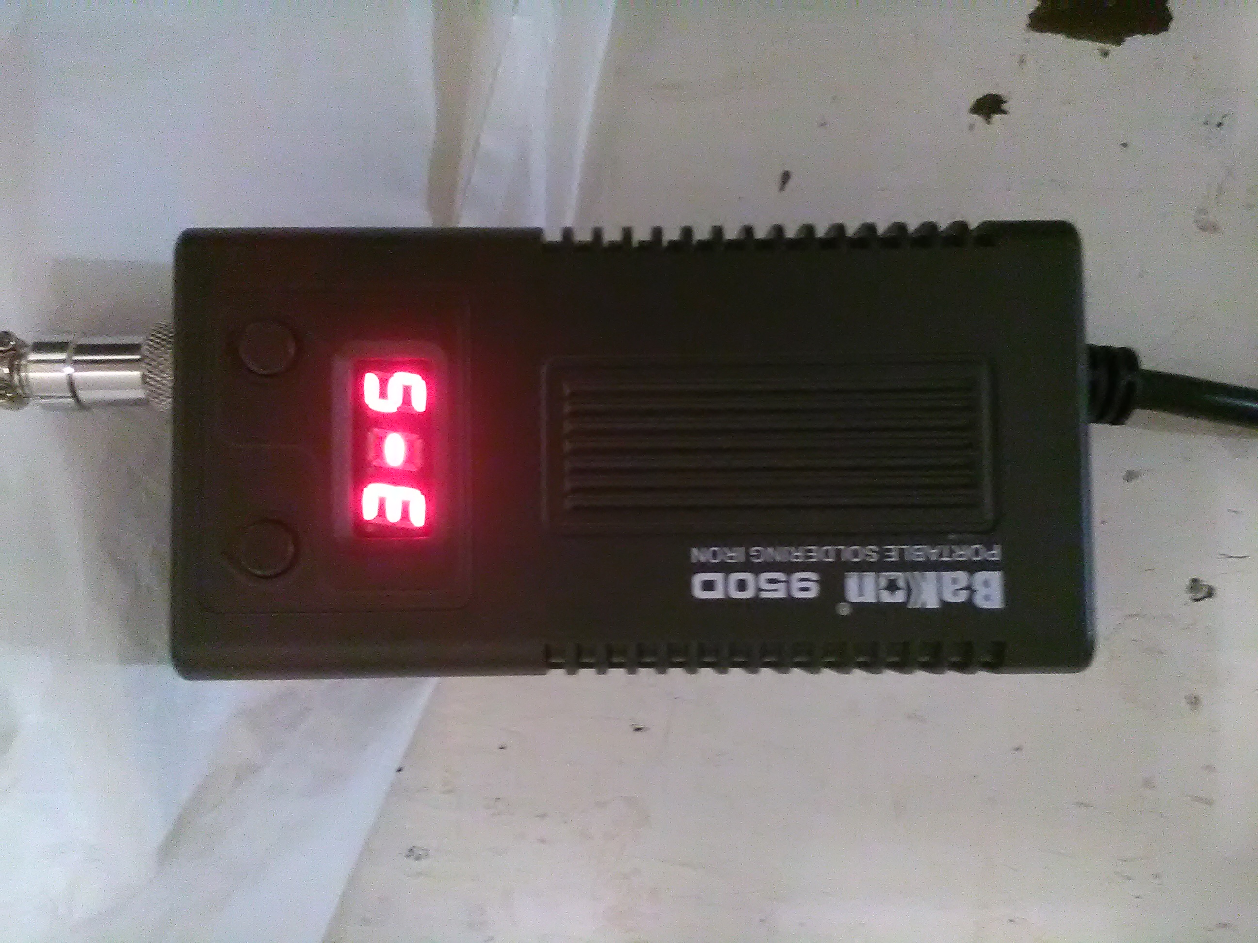

        I can't use the BAKON 950D 75W Mini Portable Digital Soldering Station with T13 Tip bought from Banggood.com, cause I get this error??
        It's Fucked up.
        http://www.hse.gov.uk/pubns/indg305.pdf
        • diif
          • Feb 2014
          • 6978
          • England
          Re: PNY Geforce Nvidia 6200 256MB PCI only
          That error has been explained to you more than once both in forum posts and PM.
          It clearly has worked, maybe it's burned out. No big deal they are £3.

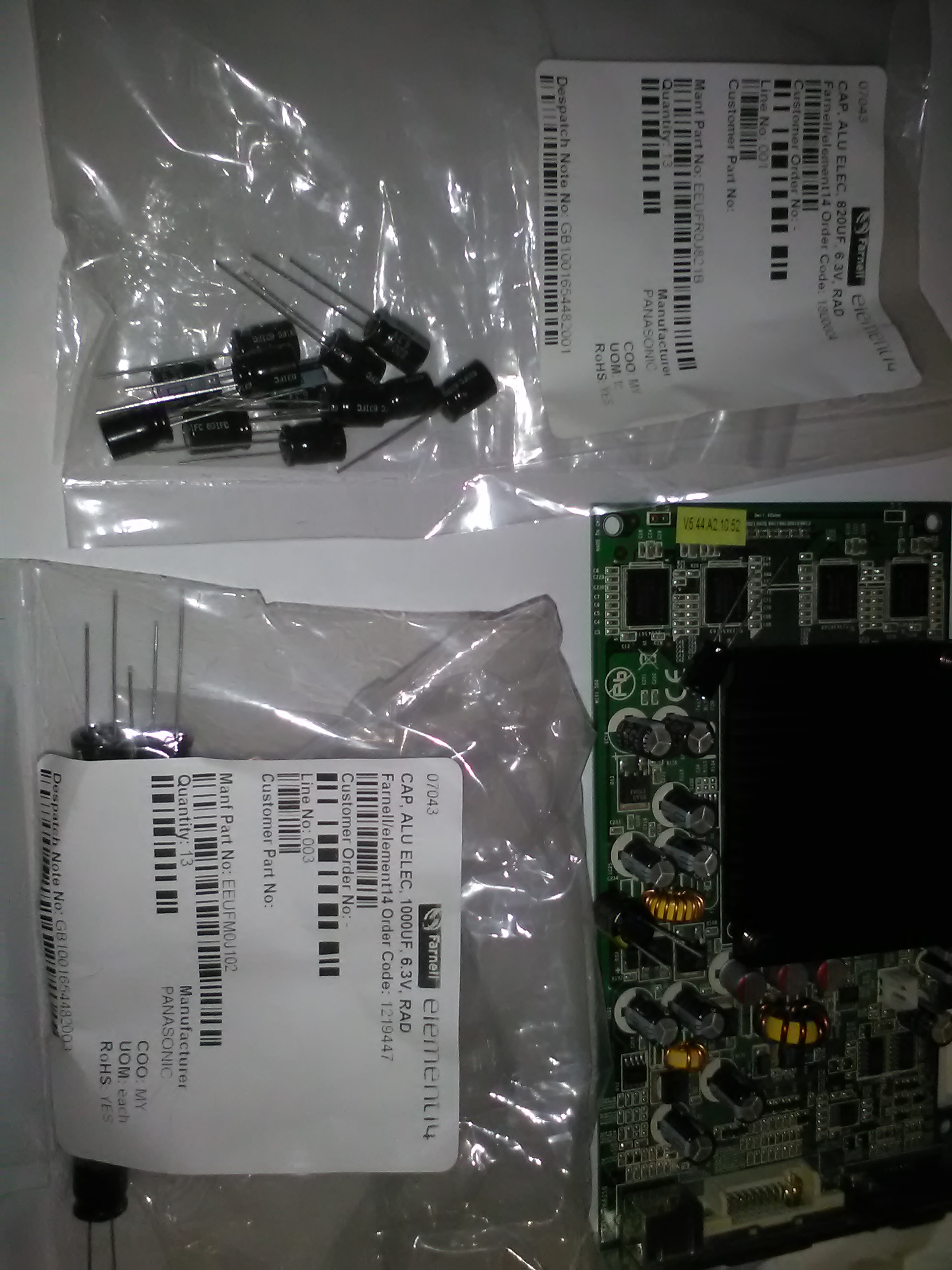

            I got the caps very quickly from Farnell. The 1000uf and 820uf, they look a little smaller and are a bit wider than the KZG. There are Panasonic capacitors series FR and FM.
              master hoarder
              • May 2008
              • 12176
              • Bulgaria
              Your Panny FM caps are 10 mm in diameter, that's why. Shouldn't matter, though. Your board has spots for both 8 mm and 10 mm, so you're good to go. Now, if you made that mistake for something that couldn't take wider or taller caps, you could be in trouble. So always check all specs of what you buy before buying it.

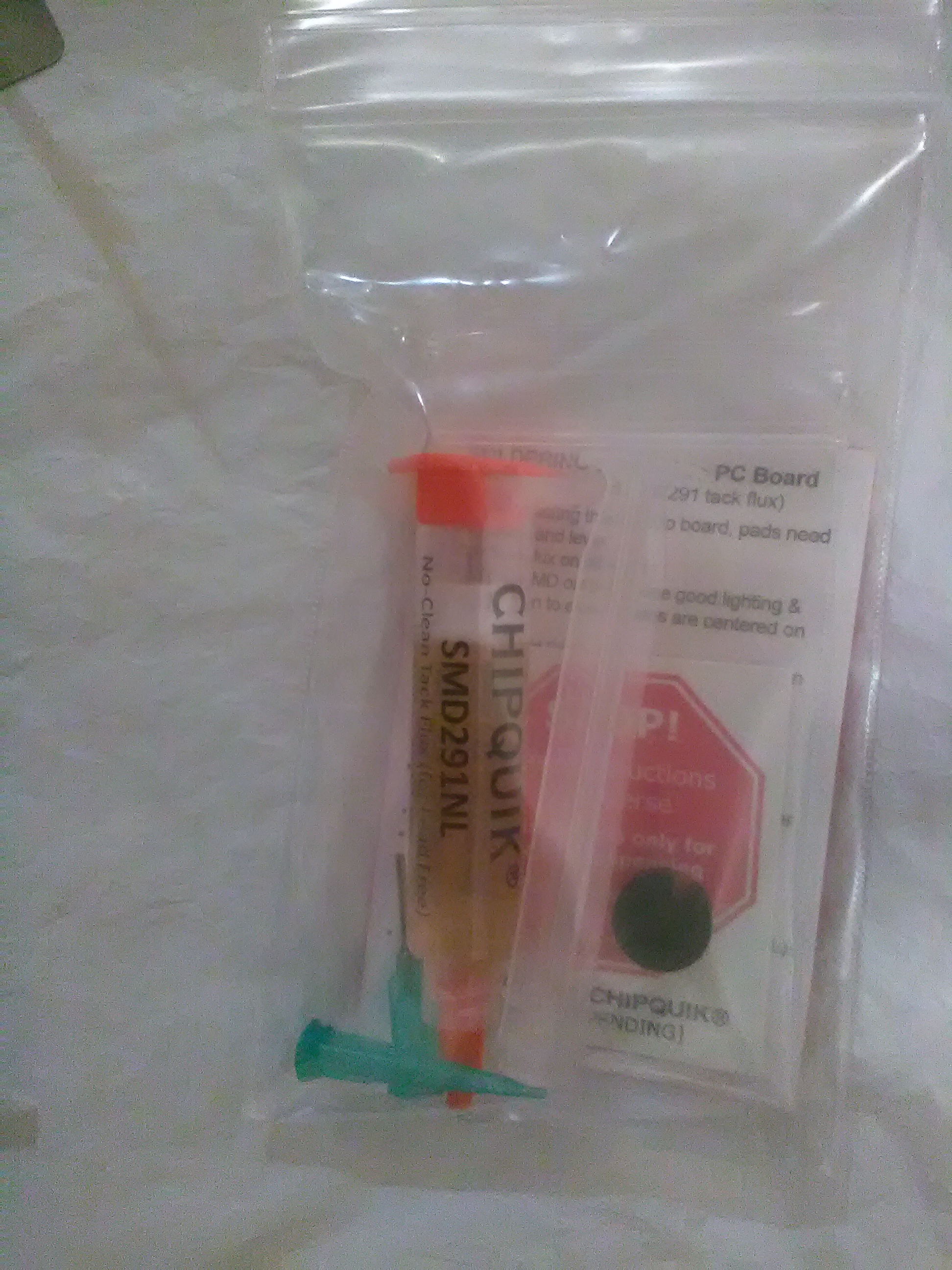

                One question some soldering iron say you need solder paste what is that ?

                  Soldering paste is pretty much a liquid form of solder + flux in one. You don't *need* it at all. But for SMD work - particularly small ICs (like SOIC, TSOP, QFN, etc.), it could be useful to have.

                    I have received the two tips and the soldering station works OK.
                    Stay tuned.

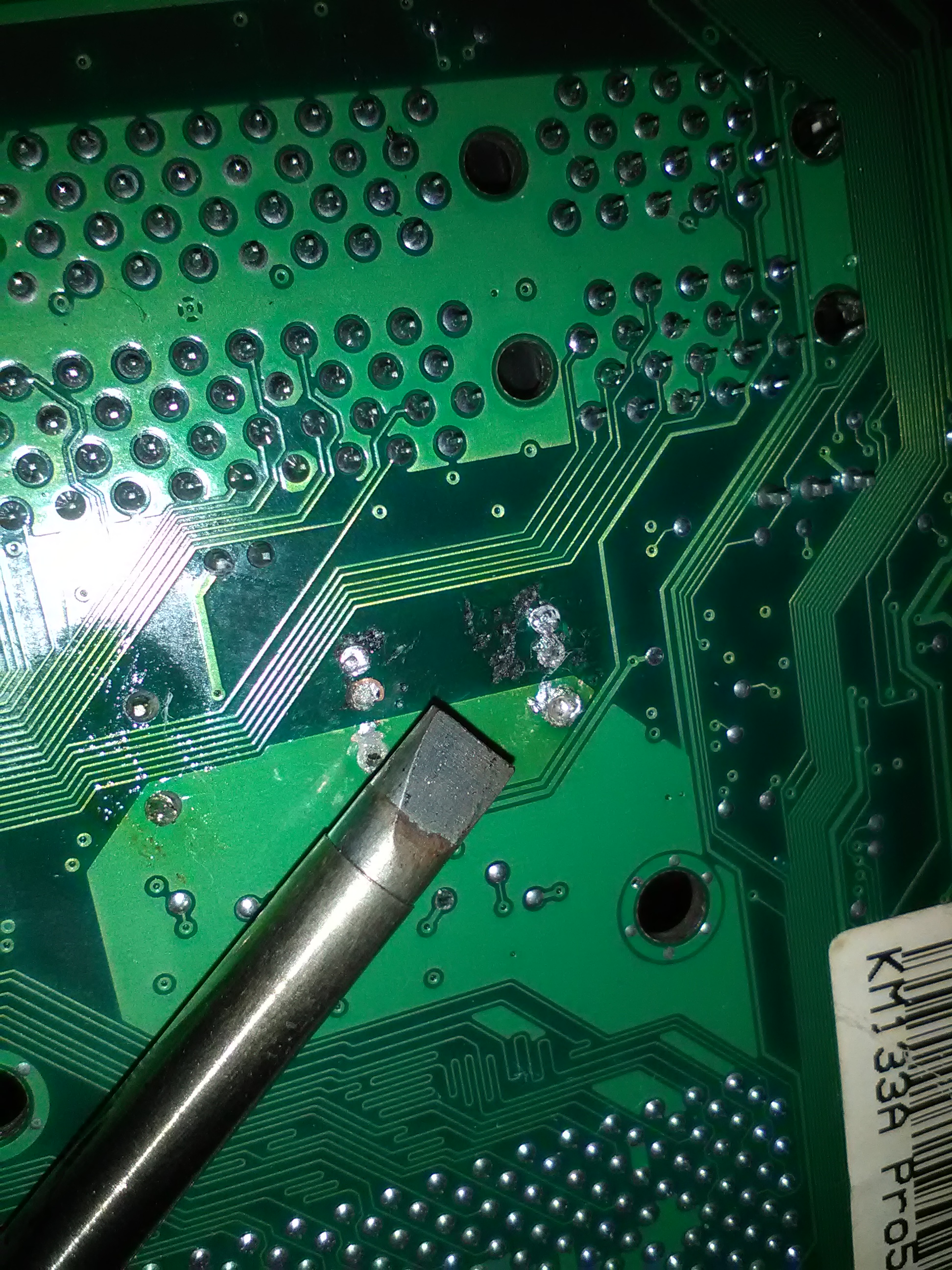

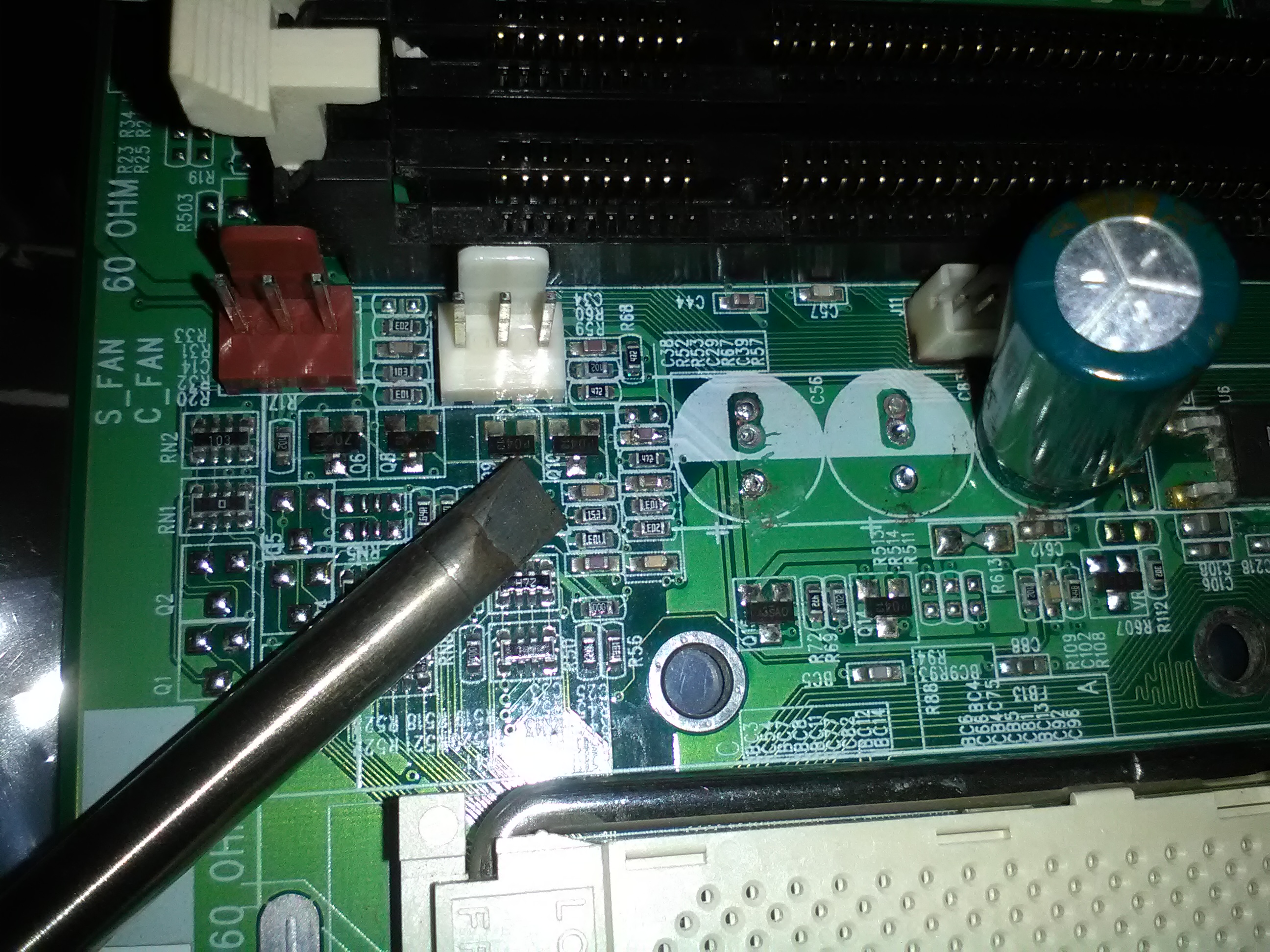

                      I removed one capacitor but the hole filled over.
                      Also solder bits are stuck on the board, I thought I burnt it till I used isopropyl alcohol.
                      • Fast Alpha
                        • Feb 2013
                        • 245
                        • United Kingdom
                        #31
                        There is bit of solder stuck to the board, I used a dental pick to make a hole.
                        Can't get the solder off though.
                          I feel I need to use leaded solder to fix these capacitors, and use a stainless steel needle to poke out the solder if stuck in the hole, I find that I heated up the hole and then stick a dental stick, a wooden one could help clear the hole. I also have a dental pick in this package.
                          What type of leaded solder should I use to melt and remove the bad capacitors.
                          It looks like some brown substance is on the board, I tried to use IPA on it, did not remove it.
                            If you can't fully clear the hole, then trim the capacitors' leads before installing them on the board and push them in on the board only as far as they go. Then heat the solder and "walk in" the caps all the way down.
                            Leaded solder is leaded solder. Any kind should work. Standard 60/40 or 63/37 are both fine. You shouldn't really need to do that, though.

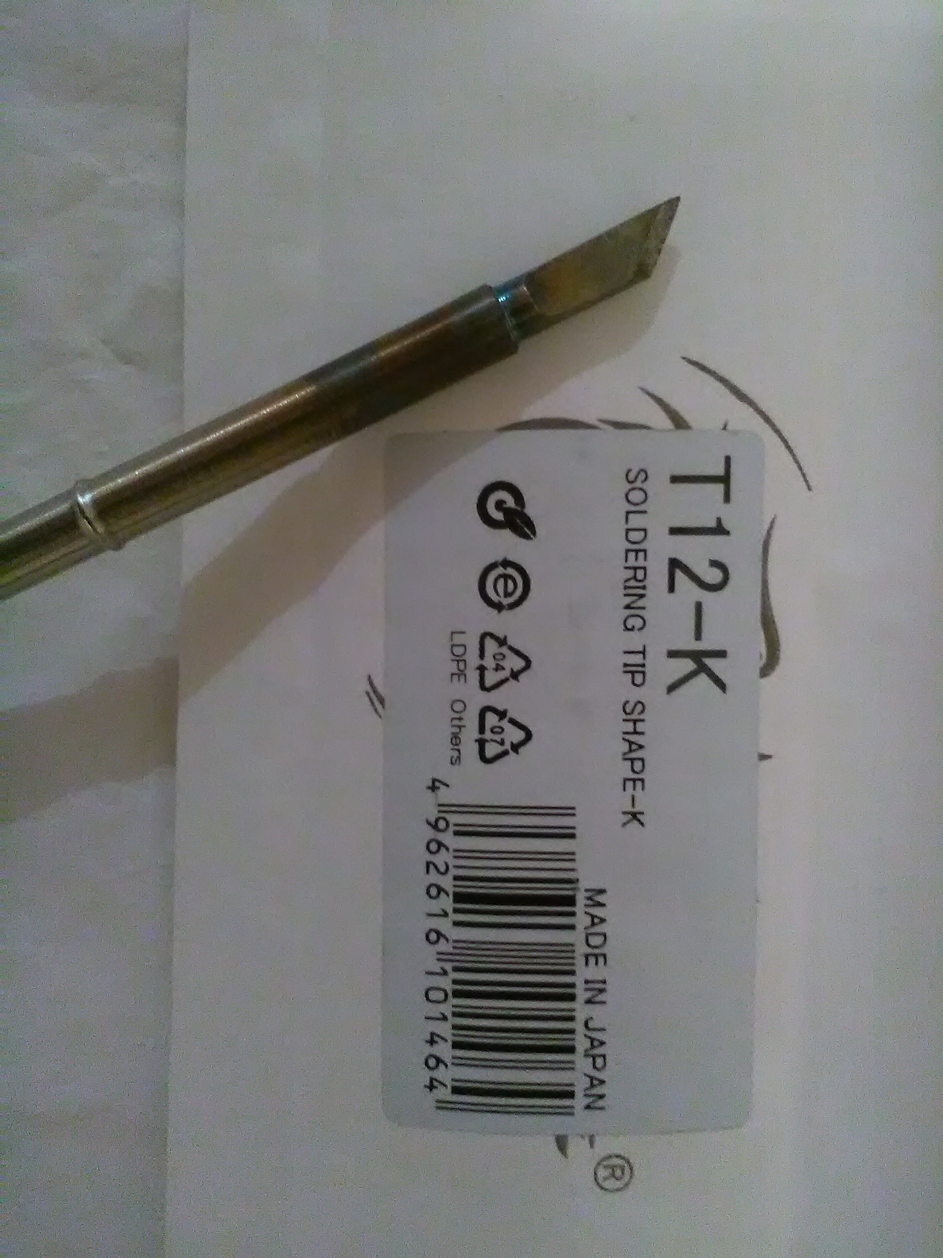

                              I ordered these tips, T12-D16 and T12-ILS.

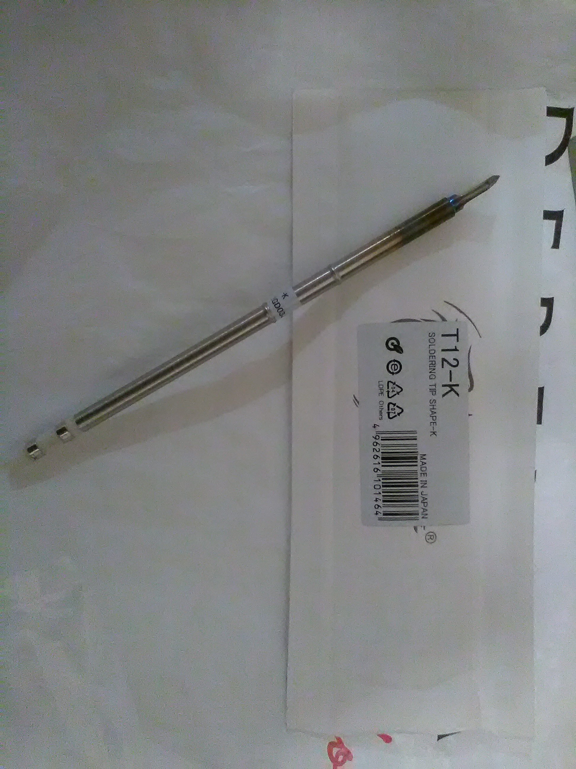

                                  Those are pretty small for cap removal work, especially the T12-ILS. You should use it only for SMD components and maybe soldering fine wires. Definitely a small tip for large stuff. The T12-D16 might be just enough, but honestly I would recommend that as your "general use" tip (i.e. anything that is not fine SMD work and also not cap removal/installation on motherboards and video cards). For large stuff, you should get a T12-D32 or T12-BC3 as a minimum - it will make big jobs a breeze. I mostly use my T12-D52 (it's like your D16, but only 5.2 mm wide) for recap jobs. Yes, she's a bit fat, but I like her that way.
                                    I got these two as well T12-D4 or T12-D52.
                                    The cap leads are small.
                                    I used a T12-D52 and it had trouble heating up the solder on the board.

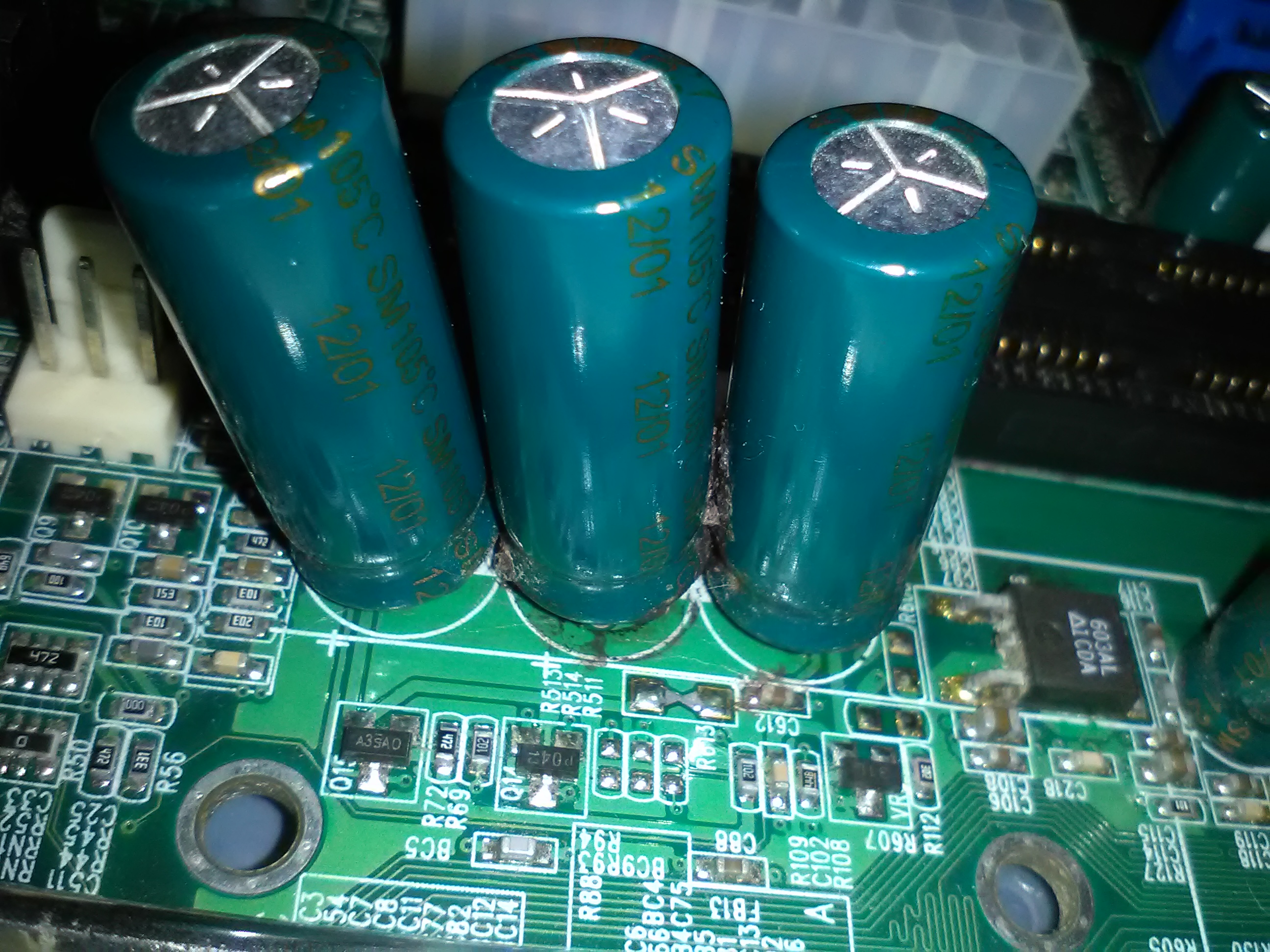

                                      My Dell PC has these caps Rubycon MBZ, Rubycon ZA and the pci modem G-Luxon 10uf 16v 510E(M) SM105c.
                                        Because you have no solder on your tip there. Like I said, you need to have a fairly big blob of solder on it and also add flux to your joints before trying to desolder. Otherwise you just won't be able to melt the solder on those joints regardless of what tip you use.
                                        That's irrelevant.
                                        You use a big tip for joints that connect to large ground/power traces. It's all about heat flow. Think of it as trying to fill a pool with water with a hose. But let's say you have the option between 1" and 3" hose diameters (and given same water pressure inside the hose). Clearly the 3" hose will fill the pool faster, because there will be more water flowing out of it. It's the same with soldering tips - smaller tips restrict heat transfer more than larger tips.
