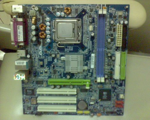

              Yeap there are 4 caps missing for sure. At least that is all I can see from the flux/scratches on the back of the motherboard. If they took off any other ones they must've been much neater than when they took off the first 4.
              I include a link to the pic of the board. Its a 10Mpix image ~2Mb. The spots where caps are missing are highlighted. There is a row of 3 caps and another 1 above them that are missing.
              http://img.photobucket.com/albums/v1...30193-edit.jpg
              Having seen similar designs my guess is they all must be 3300uF 6.3v types but I would like to be certain.

                swartz,
                Judging from your picture, it is a 4-phase VRM.
                So you are missing the input filters.
                Most input filters are like 1500uF-1800uF, 16V.
                You can browse other motherboard recap threads (llok for all Gigabyte GA-8 series) and you may see what other brand/models are using.

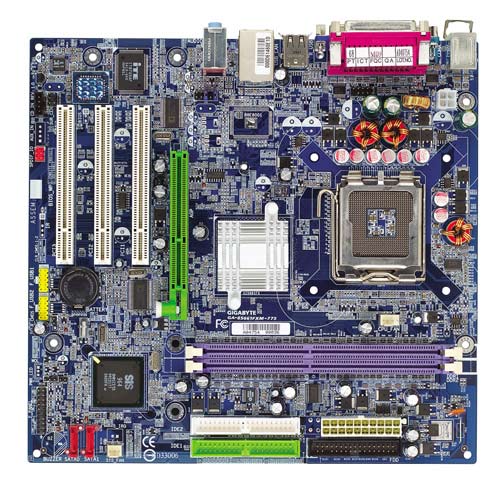

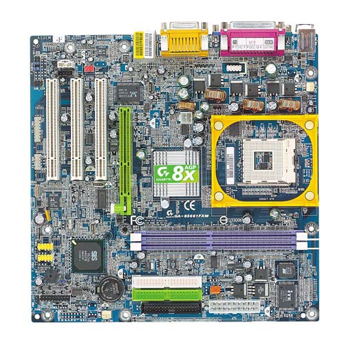

                  In gigabyte's website, the pic shows there are 3 VRM input caps:
                  I googled for other images and there is this one which shows 4 VRM caps which matches with what you are looking:

                    Definitively the same board.
                    I've seen those boards with 1800uf. The 3300uf I've seen were on AMD boards.

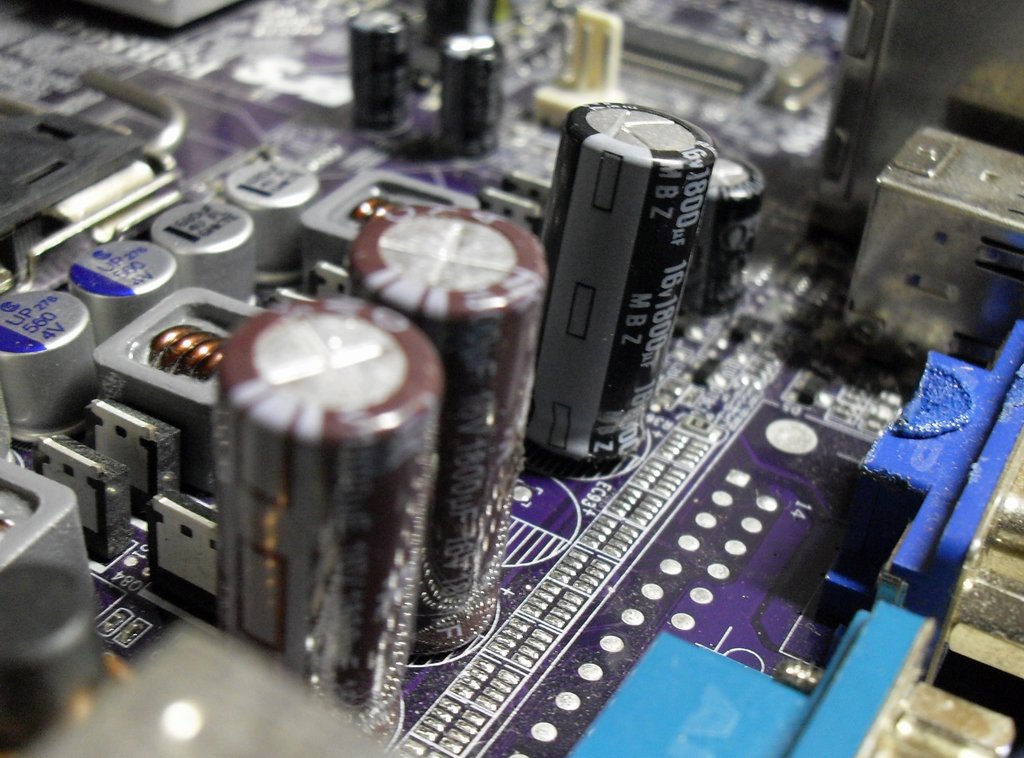

                          Here's a pic from a dead ECS I had :

                            I guess you need to pull out your meter to figure out if you need 16V caps or 6.3V input VRM caps.
                            My guess is 16V as there is that 4-pin connector from your p/s.

                                    Re: Gigabyte GA 8S661FXM No Post No Beep
                                    I have a GA-8IG1000MK here with 3x 1500uF Sanyo WG there.
                                    Individual ESR / Ripple is 0.013 / 2550.
                                    Total ESR / Ripple would be 0.0043 / 7650.
                                    If you take that as a minimum you should be fine.
                                    Fill all 4 spots eguevarae circled though.
                                    The MOSFETS in that 3rd phase are pretty distance from the other two phases and that odd-out cap is probably needed there.
