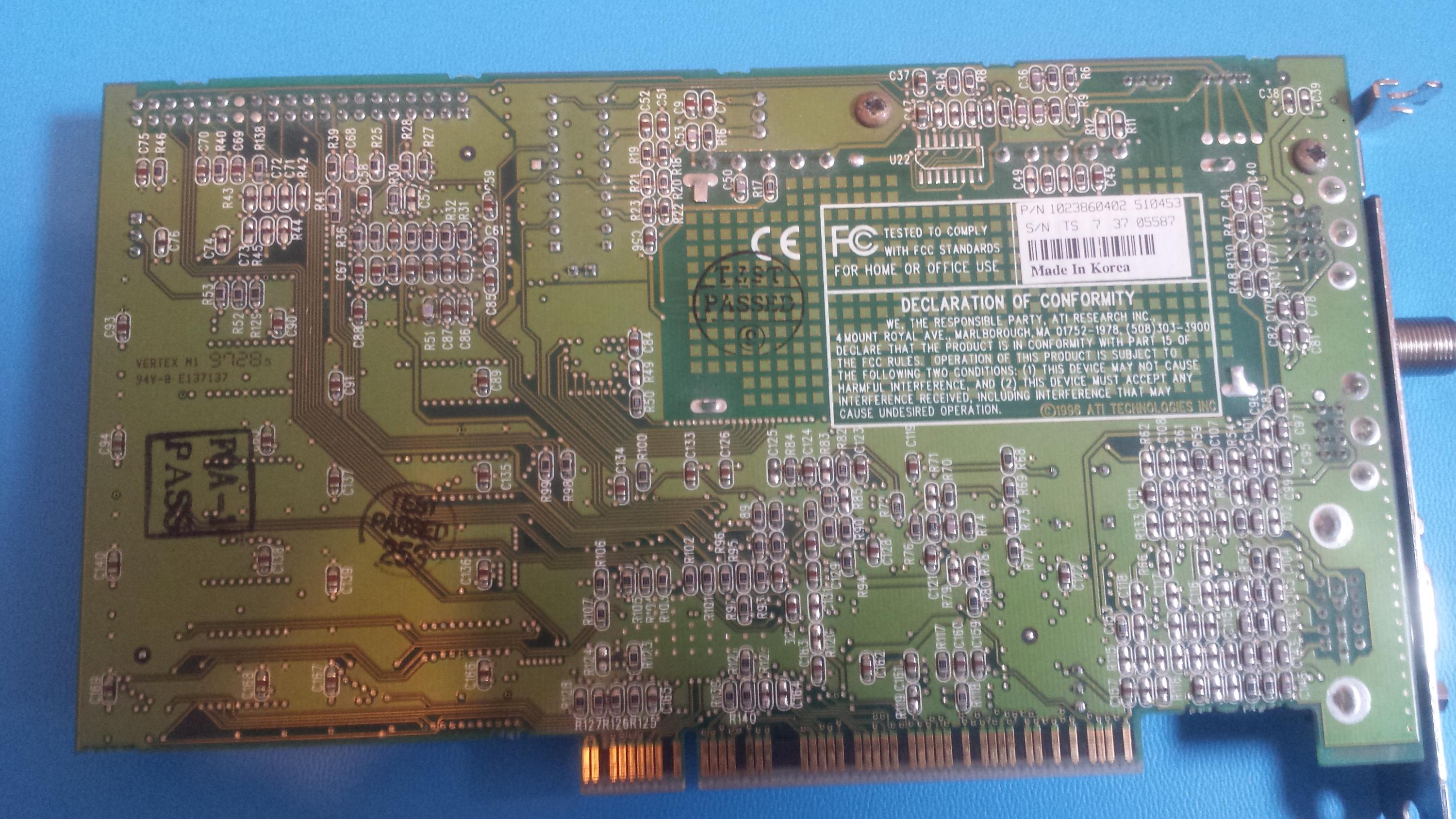

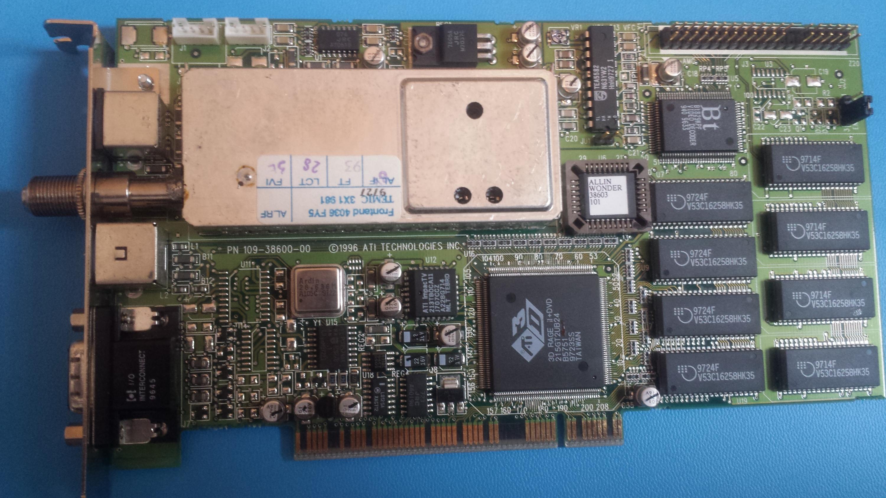

    Hey guys I have an ATI All-In-Wonder video in/video out card from 1996. I also have an All-In-Wonder Radeon 7200 from 2000 which I recently got set up and working. The original card from 1996 was in my Asus PII machine that got killed when the psu melted down. I am not 100% sure but based on the scorch marks some members of badcaps thought that it was a 5v stand by rail that went over voltage. I have yet to fix the motherboard but that is another issue on its own.
    The card is a standard PCI card. I plugged it into a working PC and it gave me 8 quick beeps which means bad video card. Bummer. I'm guessing that video cards have no protection and it fried the GPU? Or is there something simple that took the grunt of the over voltage? The sound card which was an ISA card still works fine.
    Any thought would be appreciated because I would love to have at least a few pieces of my first ever system live on.

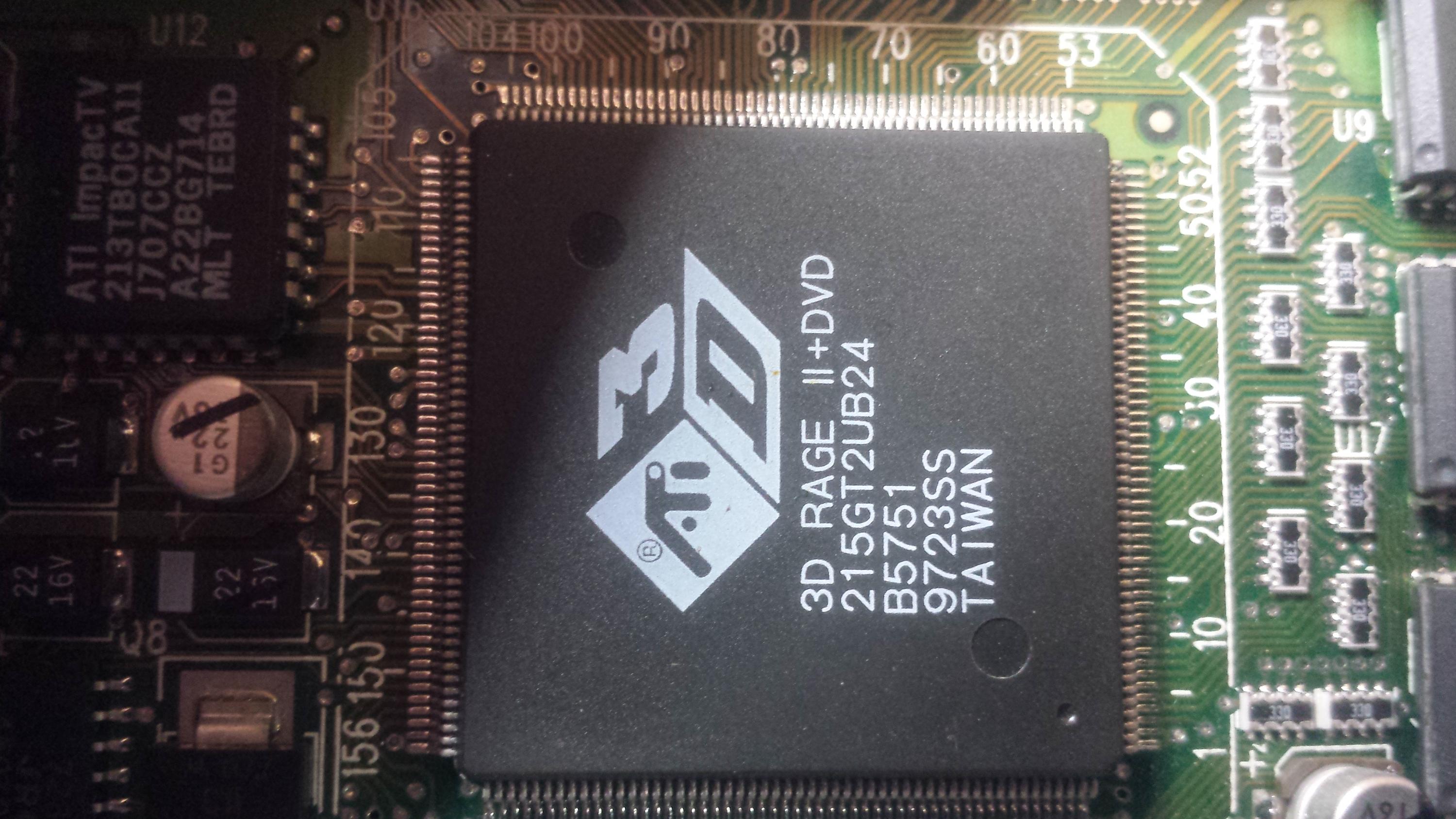

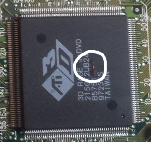

    the processor appears to have a crack in it.....the holy smoke has been released.

      Re: Dead Original All-In-Wonder ATI Card
      I saw that just after I posted. Looks like some old dried glue or similar. It scraped off very easily.

        one last thing u can try, i noticed the video bios chip is socketed. try to replace it. the flash could have been damaged by the overvoltage. if that doesnt work, im afraid its a goner. either the gpu is fried and/or the video memory is fried...

                You could check the 7805 for a bit of fun, but if the PSU blew up, most likely one of the important chips has blown, whether you can see visible damage or not.
                        Unfortunately the input is 12v and the output is a perfect 5v so that seems ok.

                          Are you sure there's no crack in the IC behind that "Glue"?
                              Ha, yep quite certain. Even under magnification I can't see any physical defects with the processor.
