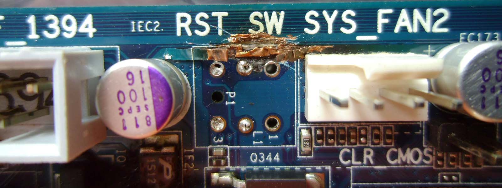

    Bought this cheap, described as "faulty. Does not post"
    Doesn't even power on actually, not surprising with physical damage pictured
    Board has everything, including "Quick Switches" so owner can easily Power on, Clear CMOS or Reset by pressing the appropriate button
    It's the Reset switch which seems to have been forcibly ripped from the board
    I've tried bridging the two big broken tracks pictured, to no avail
    I think this one's destined to join my junk board collection

    I think joining the big ones wasn't enough,seeing that a quite deep scratch is located just next to the broken tracks.

      And there is a thin trace between the two wide ones, I would also check the thin traces between the thicker trace and the edge of the board

        Unless your very good at soldering or can find where easy broken trace links to and bridge it with wires, this is going to be very hard to do.

          It looks like something shorted and the traces melted open (like a fuse). There is some discoloration around the break.

            There's also damage underneath the same area
            Thanks for your responses
            Unfortunately concurs with my thinking - win some, lose some, and this one's a loss
            Pity, rest of board's in impeccable condition
