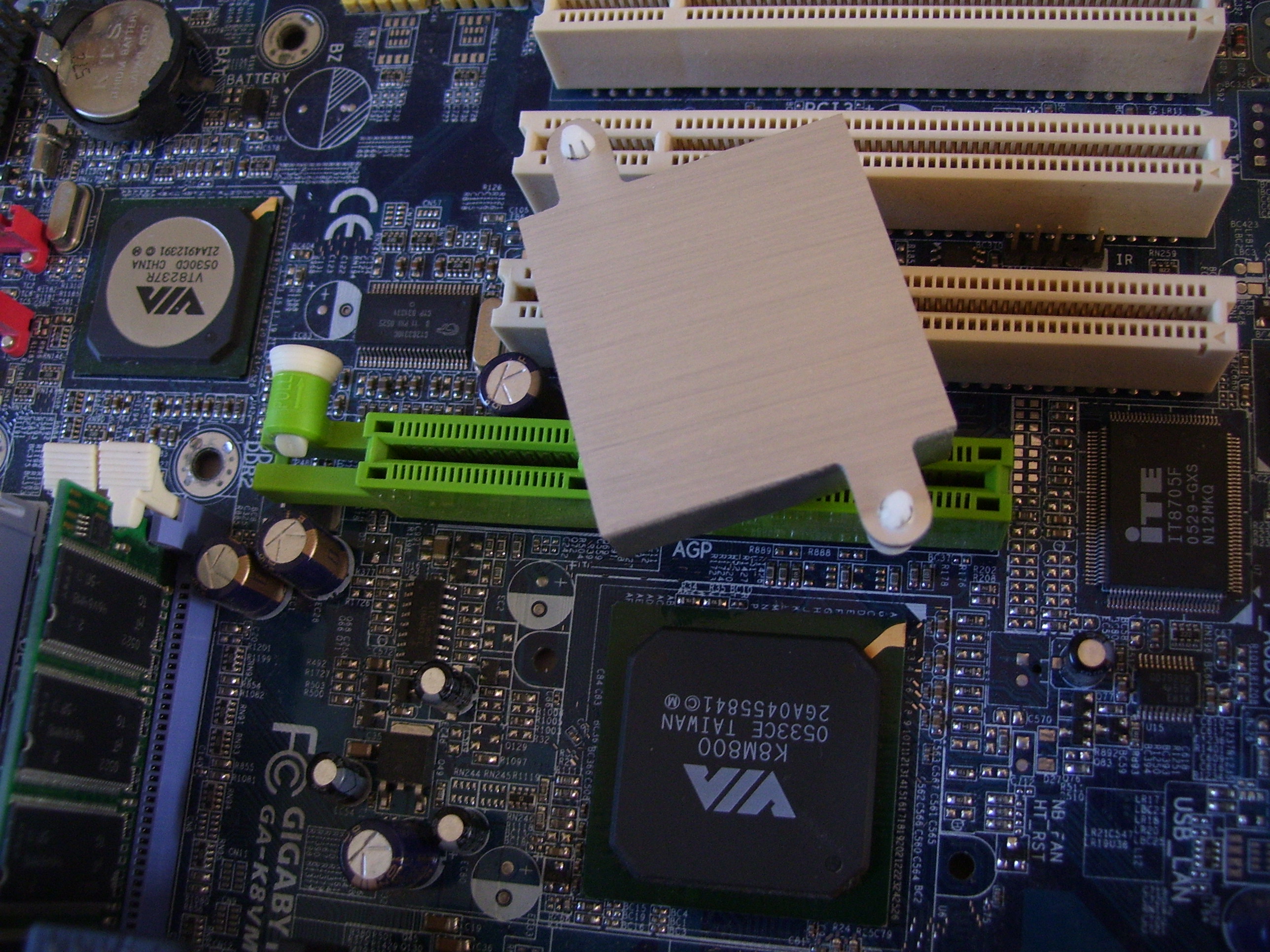

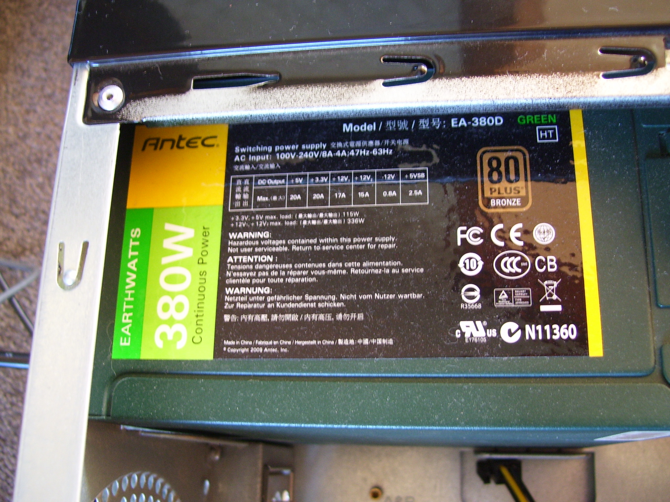

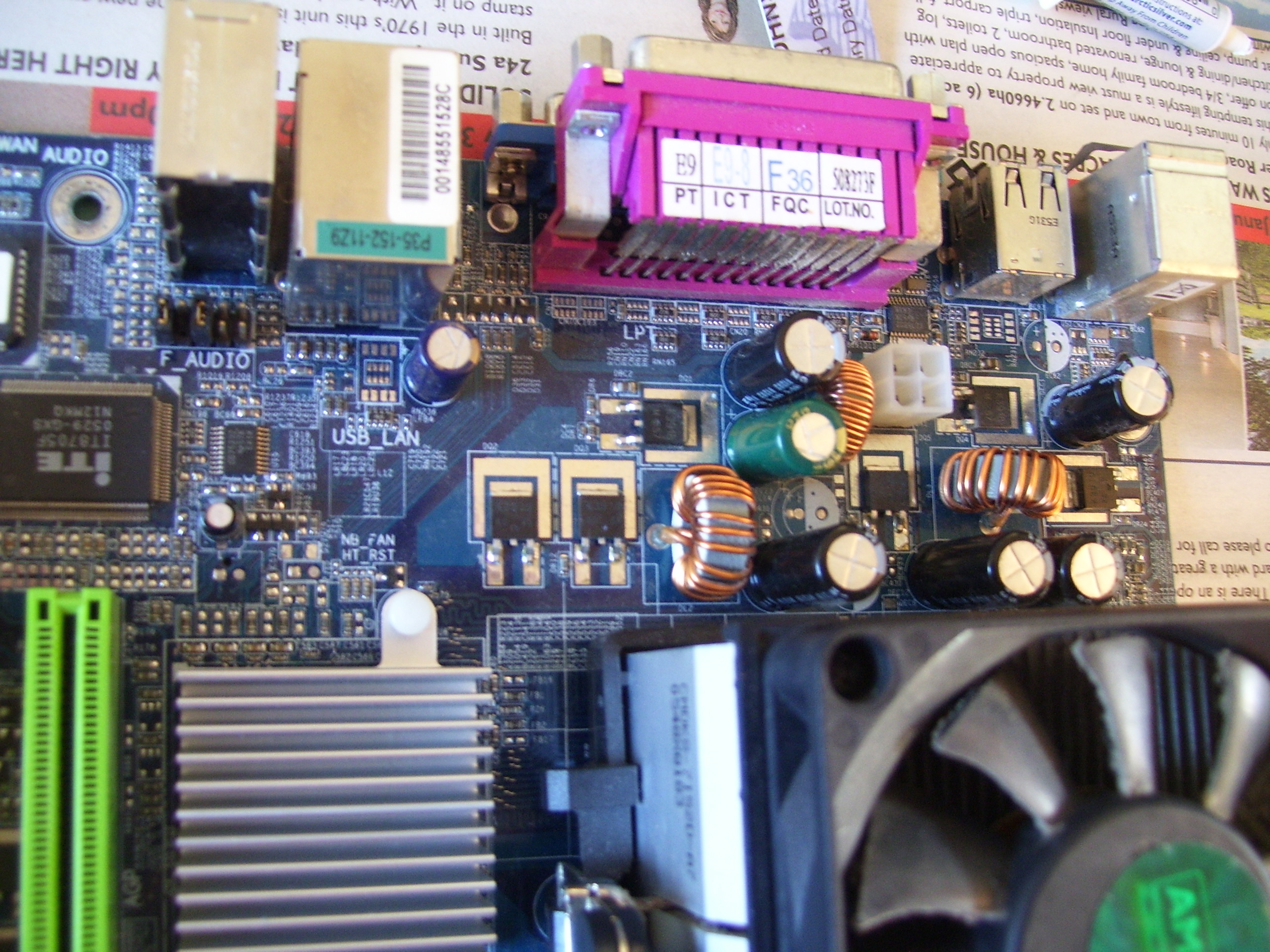

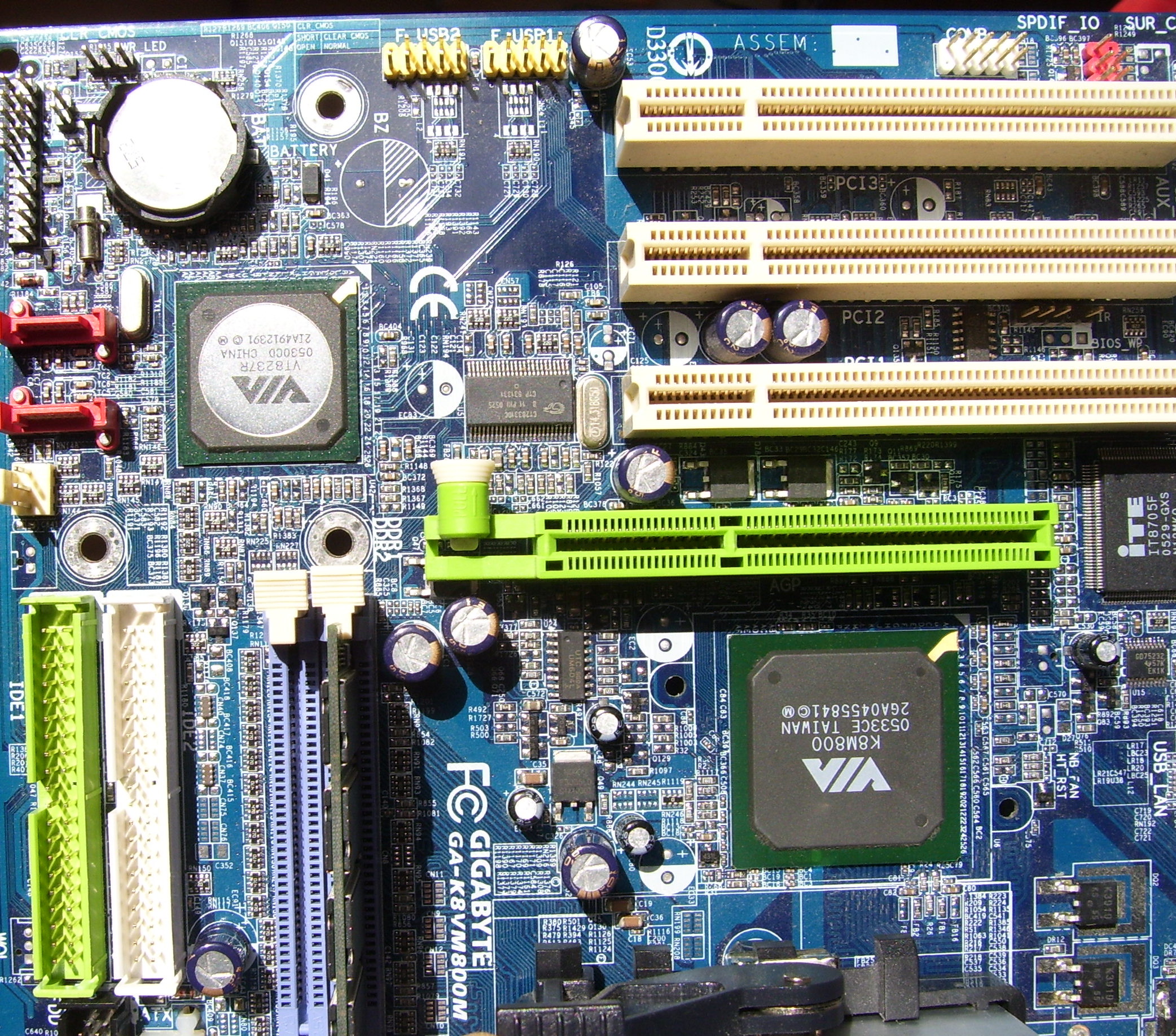

    Would it be possible to take some good close-up photos of the board and PSU? Troubleshooting blind is no fun if you know what I mean.

      Well, what is the verdict on the board, a solution on the horizon or chuck it?

        Re: Gigabyte K8VM800M - What's causing this video problem?
        No verdict has being reached, it's still in limbo
        And yeah, i meant parallel instead of series.
        Had some more challenging issues to address in the past week, so had to divert attention/energy to that.
        But i don't give up easily.
        So have taken photos.
        Removed the heatsink which had no TIM (so i also remove the heatsink from a other same model board that had damaged socket, and that also had no TIM)
        So i strongly suspect that these boards came out with no NB TIM from the factory, sine the chips only get luke warm.
        And just for the heck of it, i gave it a nice thin coating of TIM and also replaced the last KZG input cap with a Sanyo WG (both capacitors tested good on the ESR meter)
        Then put it back in the case, and now it wont even boot from the SATA DVD drive - after the usual several attempts to get it past the "Boot from CD/DVD" message and on to the "Press any key to boot from CD" and then pressing any key, nothing happens.
          Please retest the motherboards outside of the cases.
          What kind of media are you using in the optical drives to boot from?
          Antec is known to have used cheap caps in that line of PSU.
            Tested outside of case - same result.
            It's not the PSU - because i have tried two more and checked the voltages
