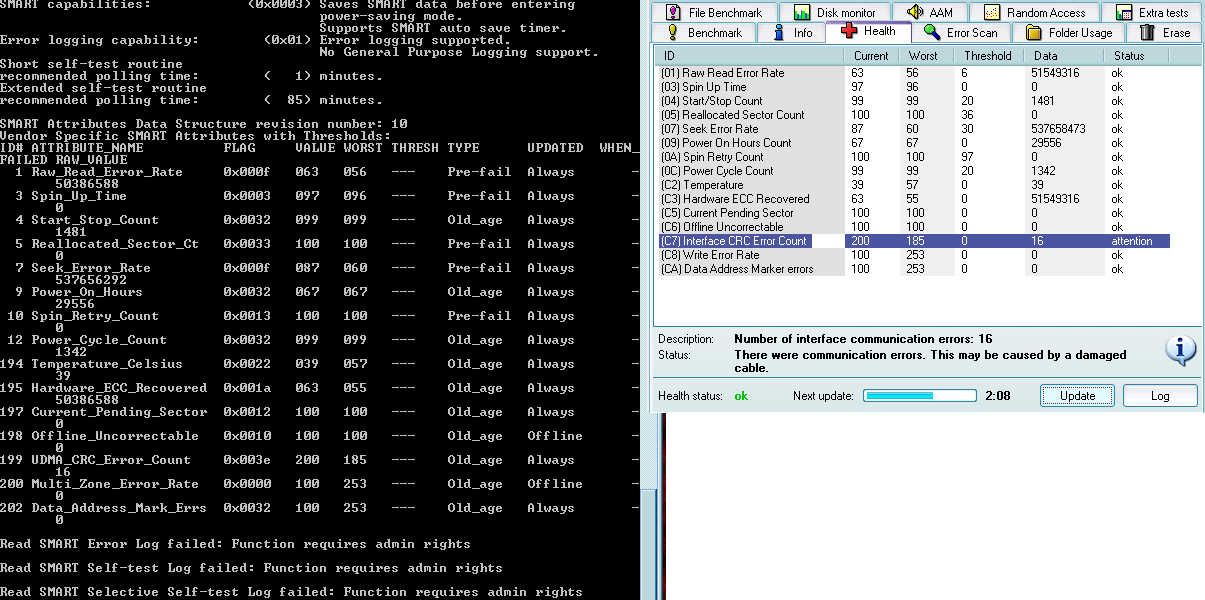

                    I think that, at least part of, the IDE problem is related to the cables (and also whenever the cable is swapped the LBA selection was wiped from the BIOS and had to be reset - which i figured out after some time)
                    Have tried 3 different Cable Select cables. (and yes, the jumper is on CS position)
                    Can't see any blown SMD caps (the only one that i've seen, an another board, made a crater)
                    Yeah, the traces from the memory slots are going to the CPU.
                    Booted from BartPE DVD, and ran the same checksum app on those two video files and the video went faulty (tried this several times)
                    Booted from a LUbuntu DVD and ran 2 full passes of Memtest - no errors were detected.
                    Rebooted into LUbuntu (Live), and the video faulted while changing directories in the terminal window, but after rebooting it played video for half an hour until i stopped it.
                    Have attached SMART info below, and note that there is errors in the Ultra DMA CRC error count that you mentioned
                    Consequently, just had a good idea! - i'm going to replace the PATA drive with a SATA drive and perform the same checksum procedure - If video doesn't fault then that would pinpoint the fault to the South bridge and it's IDE output. And if it does fault, then that might also mean that there is a problem with the SB or before it?

                      SMART info:
                        So that means likely you do really have a bad cable and/or connection from SB to IDE.
                        I am also going to guess with some confidence that your HDD is a Seagate. Normally, Hardware ECC recovered could suggest drive problems too. But on Seagate drives, Raw Rear Error Rate, Seek Error Rate, and Hardware ECC recovered are Seagate-specific parameters that always show high values.
