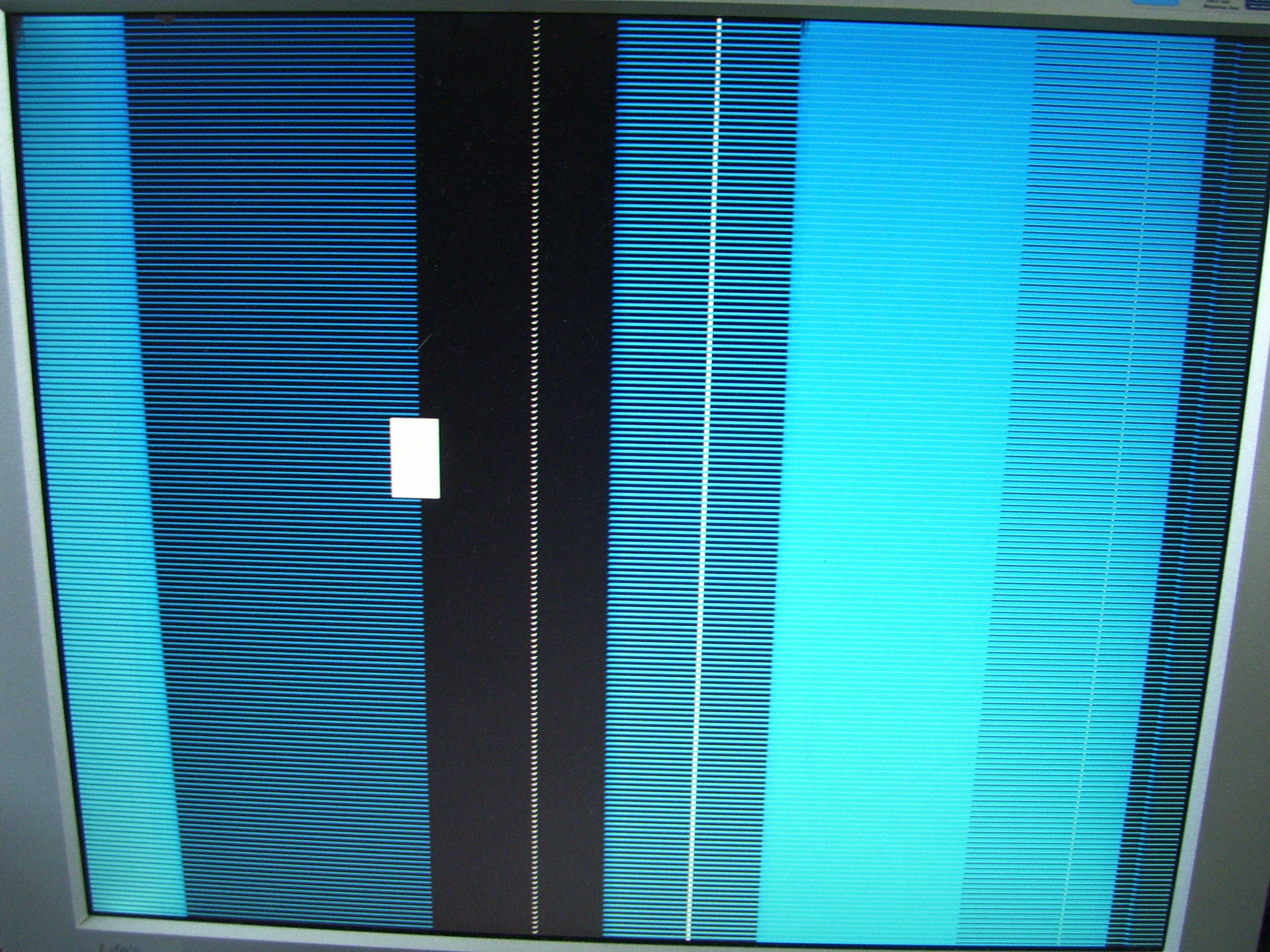

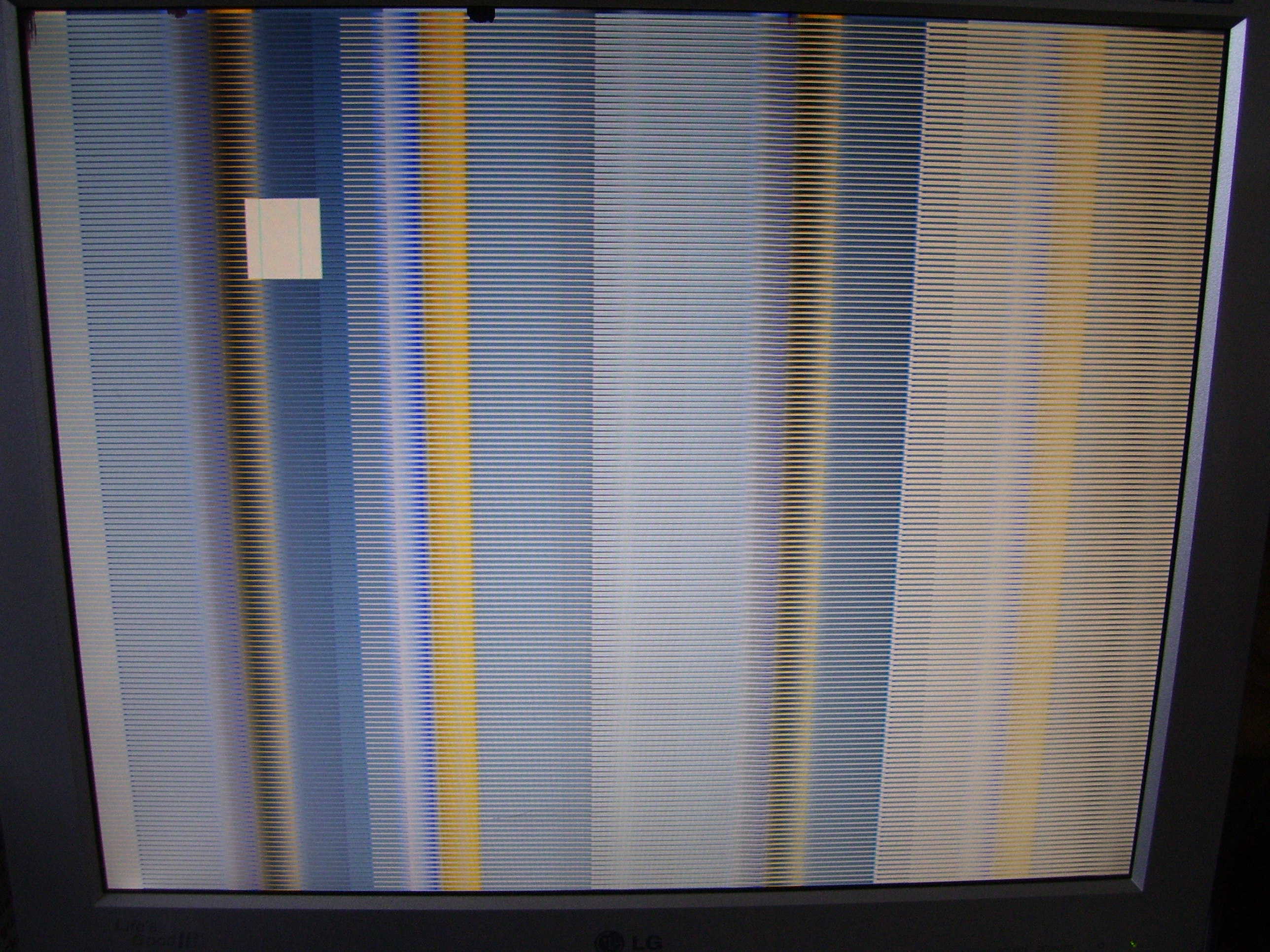

                      Also, i was trying to think what would cause that pattern on the screen - it's like some video data stream is abruptly cut off, and then some other process continues using the video data that is not being updated in memory, and continues to fill the screen, by recycling what it's reading from the now static (non-updated) area of memory.
                      The image that appears on the screen is dependent upon what was showing on the screen beforehand - So the colours and number of vertical bands can be vary considerably, but there is always evenly-spaced horizontal lines through all of them.
                      And the pointer consistently turning into a larger square must give some clue as to what is happening.
                      The pattern of moveable pointer square, is not affected by the background.
                      i searched the internet for images of the similar screenshots as in photos attached here, but couldn't find any.

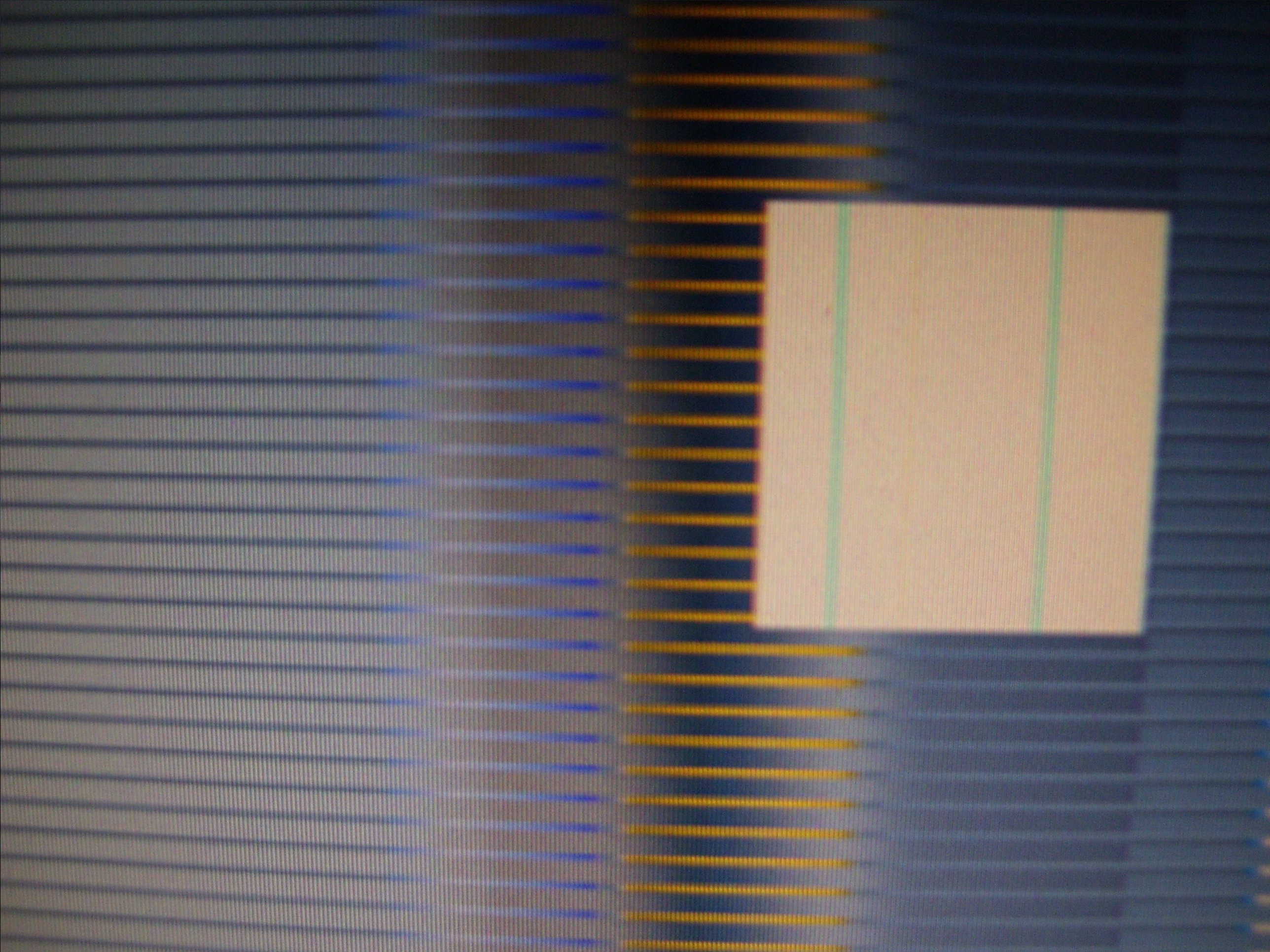

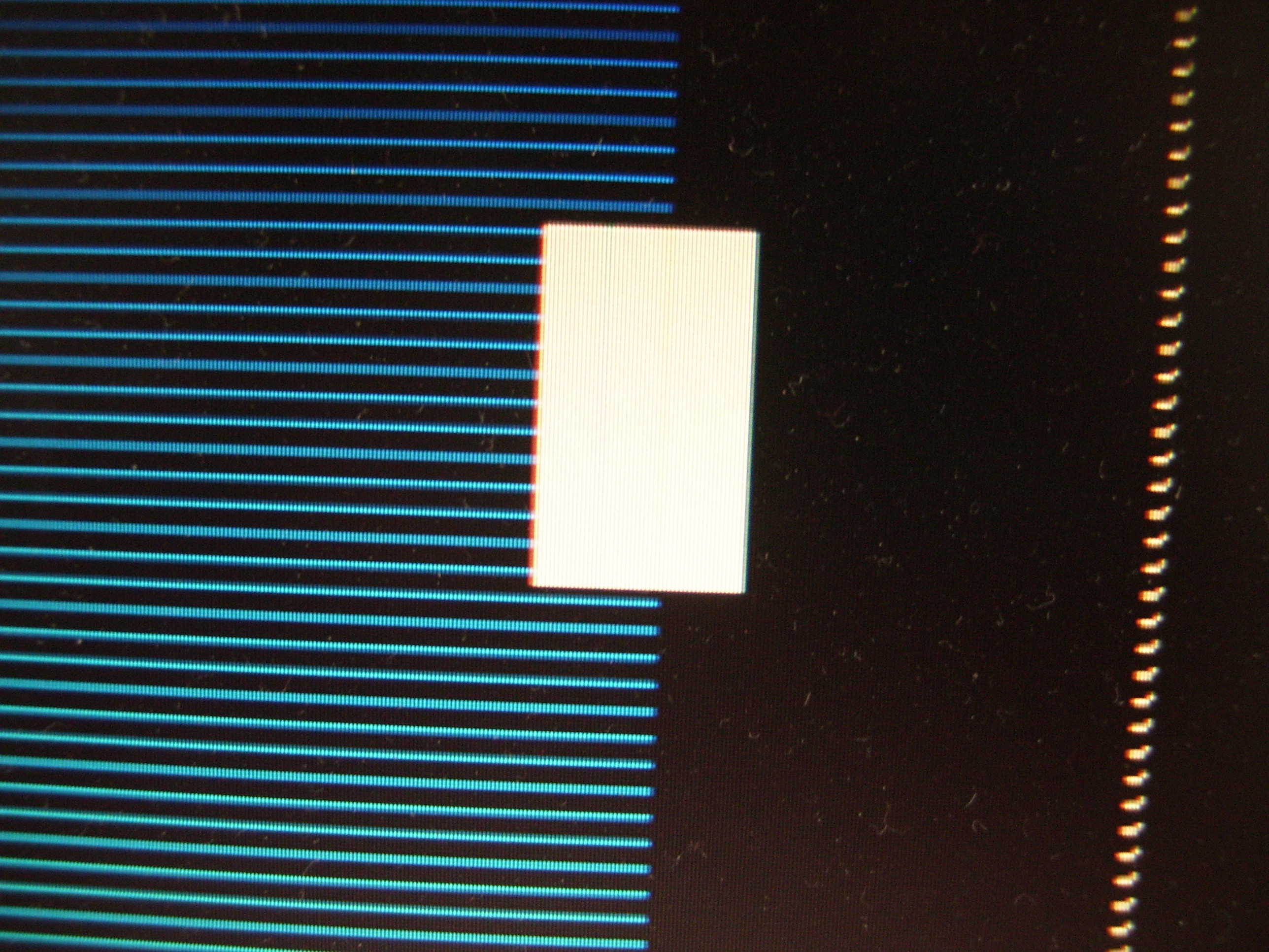

                        Then i set the desktop background to black, with the desktop icons moved to the bottom of the screen.
                        And after the fault reoccurred - the screen was completely black all over
                        The mouse pointer square was not visible - perhaps that went black also.
                        So then moved the blue internet explorer icon (with file name below it) to the top right-hand corner, still with the other desktop icons placed at the bottom and the background wallpaper set to Black.
                        i've attached the photos here of what happened.
                        Also the previous mouse pointer square, is now a rectangle
