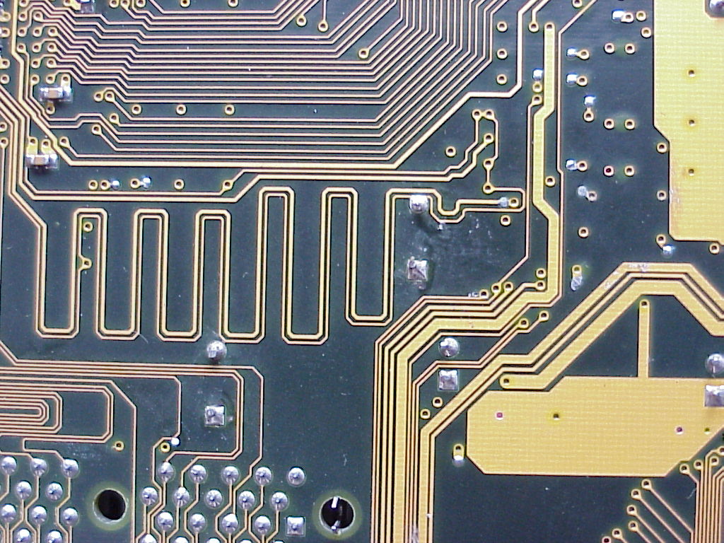

          Re: HELP - Can't resurrect VP6 - Warning 56k beware
          As promised, the photos. Forgot to mention as well that I have tried re-inserting the battery as well as clearing the bios w/ the jumper.
            first it looks like you need a hotter iron.
            the problem could be the cold joints i see.
            a good joint wont be ragged looking or balled up.
            it will fully wet the hole and lead.
            time to rework those joints.
              Do you have any flux? That will help with getting the joints to flow properly. Also, don't get frustrated and leave the iron on a joint for too long - you can end up burning the pad that way. A chisel tip is better at transmitting heat than the pointed/conical type. Use a damp rag or sponge to wipe your tip when it gets dirty.
              1GHz/133 processors are definitely on the stressful side for a P3 board, so even with only 1 processor installed it's not the lightest test. If you happen to have something older like a mendocino celeron then I'd try it - those would be a lot easier to run, and if that works you'd at least know the board is alive. Marginal stability like that could definitely be explained by the bad joints.
              Unfortunately, it's also possible the board has something else wrong with it. A port 80h card (POST card) can reveal if the board is even attempting to POST, but I'm not sure it's worth buying one of those just for 1 repair job. If it's just bad joints, I'd expect it to at least show some activity on port 80h before freezing up.
                crap soldering. looks like some mild scratches on the pcb also. iron slipping?
                hope you succeed with a better iron.
                  That soldering is not good... your iron is probably not hot enough, I suspect you may be have been pushing it to melt the solder when you removed the old caps and then you got it slipping? if it's hot enough you don't need any force, the solder will just melt itself (helps if you add your own solder first and then try to desolder)
                  What iron do you have? have you read the tutorial elsewhere in the forums?
                  Could be something is shorted/not connected properly due to the bad joints...
                  It can be easier to get a good joint when the leads are pointing straight up and perpendicular to the board, especially with the tiny holes and pads on motherboards. To stop the cap falling out I use a small bit of soft cloth balled up and put between the bench and the cap to hold it up while soldering
                    Actually I think I do have a hot enough iron, maybe the exception is that I wasn't using a chisel tip. The iron that I was using for the job was a 60W pencil tip, and trying to suck up the solder using solder wick. I couldn't find any chisel tips at my local electronics shops, so I figured I take a go at it, didn't think it would have made that big of a difference. But I guess it does.
                    Considering the state that it is in right now, would you guys recommend that I desolder and remove all the caps and solder. Or should I heat the joints so the solder melts and apply some new solder to it?

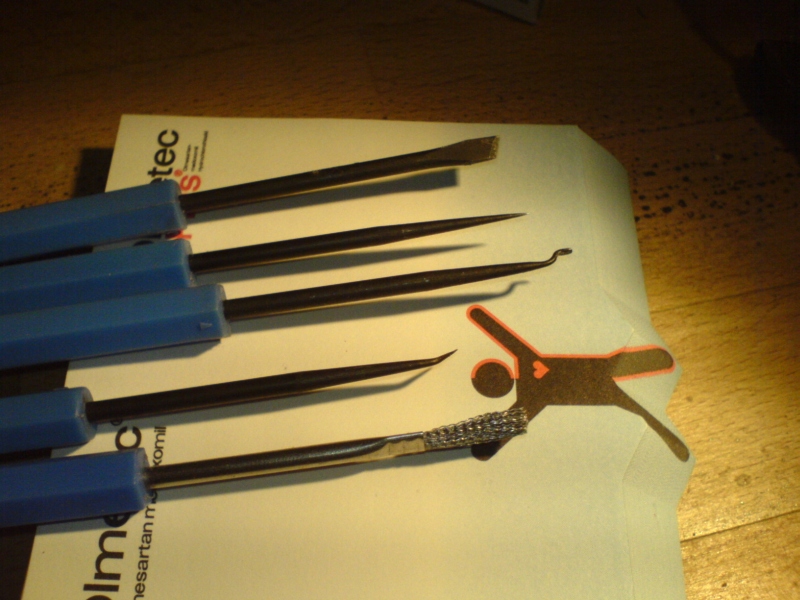

                            i haven't really found a way yet of reliably desoldering mobo caps with de-solder wick (and a 50W iron). it simply sucks too much heat, especially with newer boards that usually have large ground planes.
                            i don't care how the old caps come out, but once they are, cleaning the holes works fine with a needle, toothpick or whatever. even then wick doesn't really work (unless you have good access to both sides of the board, which doesn't occur too often).
                            i got this - cheap but extremely handy - kit from the local 0.99€ store:
                              since we dont know if this board was nfg before the recap all we can do is eliminate the stupid stuff.
                              start with a good iron and resolder your new caps.
                              if nothing then start by measuring vcore,vdimm,vagp.
                              lesson here is to test before recapping.
                              btw the joint in the attached pic is one to be careful around.
                              many boards sent to me after a failed attempt have damage at this part.
                              its ec28.note the trace connecting to the - lead.
                              easy to damage.
