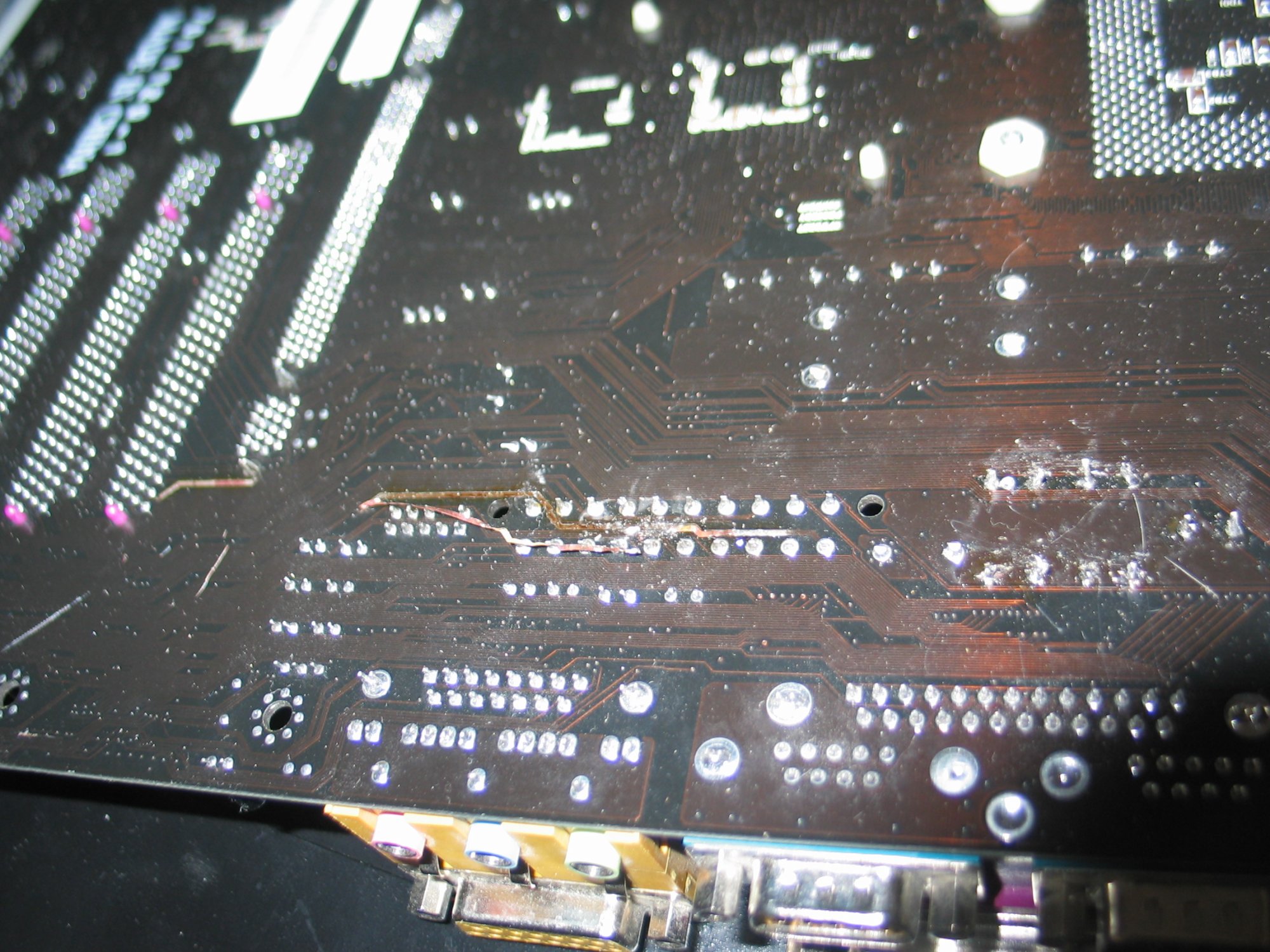

    Neither board POSTs or beeps. With the new board, I noticed too late that there was a broken trace on the backside from one of the power connector's terminals, but the power LED on the board still lights when power's on so I'm not sure what that trace was supposed to power.

    post pics of the damaged trace.

      Here's the picture from the Dragon Plus. Please ignore my feeble attempt to solder it back down to the board.
      I suppose there's a chance that both boards' CPUs were (separately) fried and this is why nothing's POSTing.

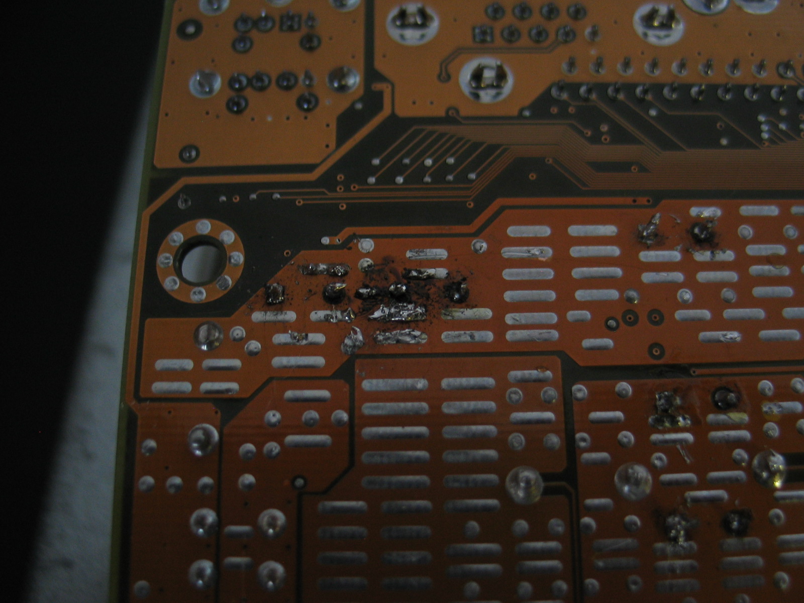

          This is the K7VME.

            looks like a shorted card in pci 1 did that.
            just solder jumpers and test again.
              Re: Problem recapping not one but TWO Soyos
              So it's safe to solder a jumper to the tiny thin strip of copper (I assume you're referring to the Dragon Plus pic). Would that actually be responsible for the board not POSTing?

                I don't get why the K7VME isn't working. How can I tell if I ruined something?

                  2. Clean up your soldering. One pic shows what looks like fine steaks of solder splattered on board. First get some methylated spirit and an old tooth brush (stiff bristles) and clean off all solder flux (looks horribly black, hope you used good quality solder) and dry it off. Then with a magnifying glass check for fine a minute solder pieces that may be causing a problem. Take a close look at your soldering and make sure the connections are good.

                    No idea how to tell if 60/40 rosin core solder is good or not. I will get methylated spirits tomorrow and clean the black stuff off.

                      That soldering doesn't look too cool. After soldering what you see shouldn't look any different from the factory soldering.
