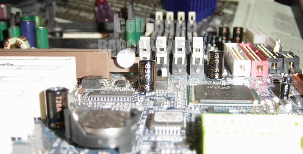

      I post about this 8IHXP board again, as it has popped another cap. (GSC 1000uf 6.3v, the one I was worried about previously, near the really hot mosfet)
      I hear you say "why has he not recapped this board completely yet?" - yes, I know, but I had urgent work to complete on it, which is now done. I was opening the case for preliminaries of the recap and saw a bulging GSC.

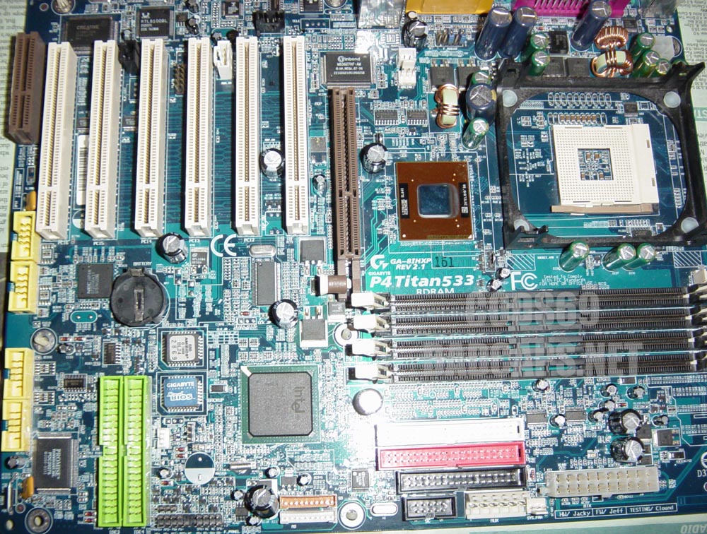

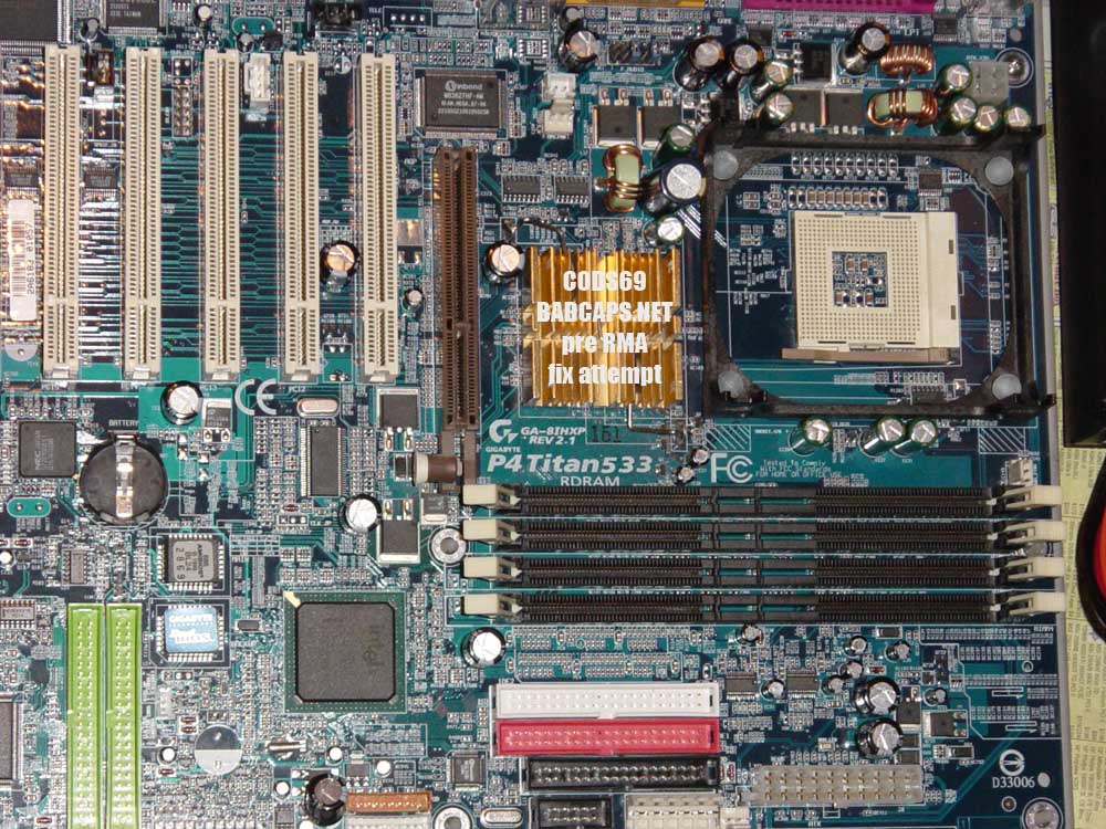

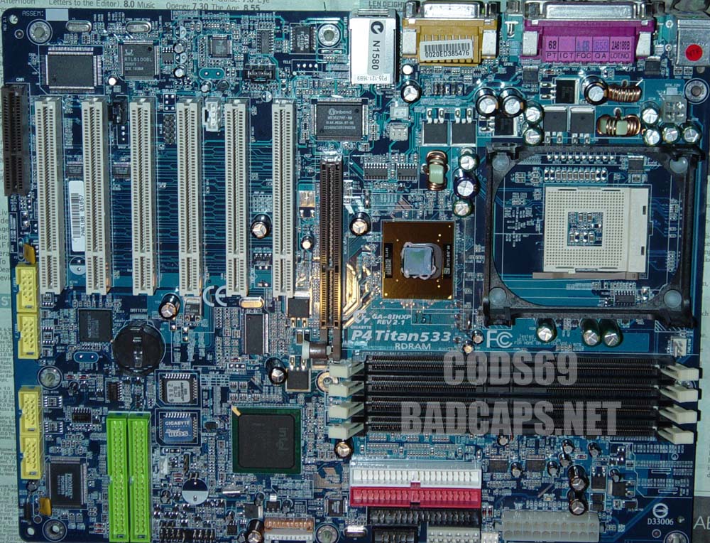

      No current pix yet, but here are some pix of when I recapped nearly the whole board previous to putting back all original caps for the RMA (including the now bulged GSC)
      Current pix of new bulger and full (yes, FULL) recap will be up when the board is out.

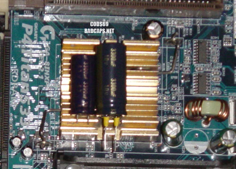

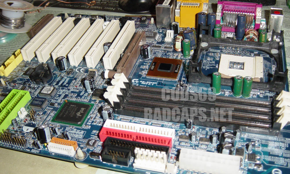

        Board operational.
        It's not a full recap, but the only originals that are left (above 470uF) is the Sanyo's.
        Some voltages seem a tad more stable as well (slightly less variance)
        Here is the bad GSC bulging top and bottom.....
        ...with an overall of the board, including the OST that Synnex (Gigabyte) replaced.
        Ruby's and FC's mounted....
        Different angle where you can see the little yellow heat shrunk extensions on 2 of the new caps....it was a bit tight.....
        Please let that be the end of it for this board.
        BTW, I let Gigabyte know about this new GSC that popped and they have again offered to RMA the board (again through Synnex), although as you can see, I will not be requiring that service I hope.
        2nd BTW, the board is beginning to show stresses of soldering now (after 4-8 replacements each)

            Originally posted by willawake
            great pics, good job!
            Thanks!
            Whats up with the northbridge heatsink? i guess you reattached it because you will definitely need it.
            Changed the stock one with fan for a Zalman passive job. (you can see it in the first of four pix, the blue thing in the background)
            did you find the solder difficult to melt on that board?
            The first time, absolutely. Plenty of heat in the iron was needed.
            I found adding a little solder first (as per badcaps suggestions) made it much easier soaking it up with the wick.
            I'm working on the machine now....ticking along very nicely.
