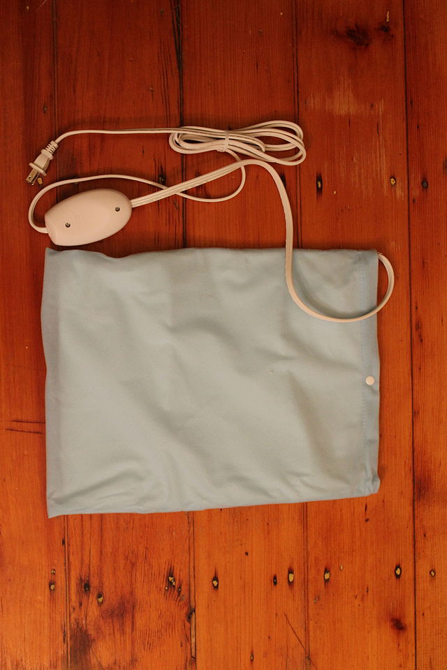

    My heating pad has a four position switch. The settings are as follows: Off, Low, Medium and High. Now off = off, Low = High, Medium = Low, and High = off. The control unit is screwed together so I can take it apart, All of my tools are over at my Linthicum house so I can't take the unit apart just yet. The A/C power cord from the control unit to the wall has two wires in it. The cord for the pad comes from the control unit to the pad. It has three wires in it. What do guys think may have died in the control unit?

    I repaired a simular one of these, (cant tell by your picture which is of the back of the control) The wires going to the blanket were shorted (a dog chewed the wires) There was a fuse and the triac was shorted in the control, replacing both repaired the unit. This one was a sunbeam control.

      The one in the jpeg isn't mine but it is like mine.
      Update: Mine is also a Sunbeam
