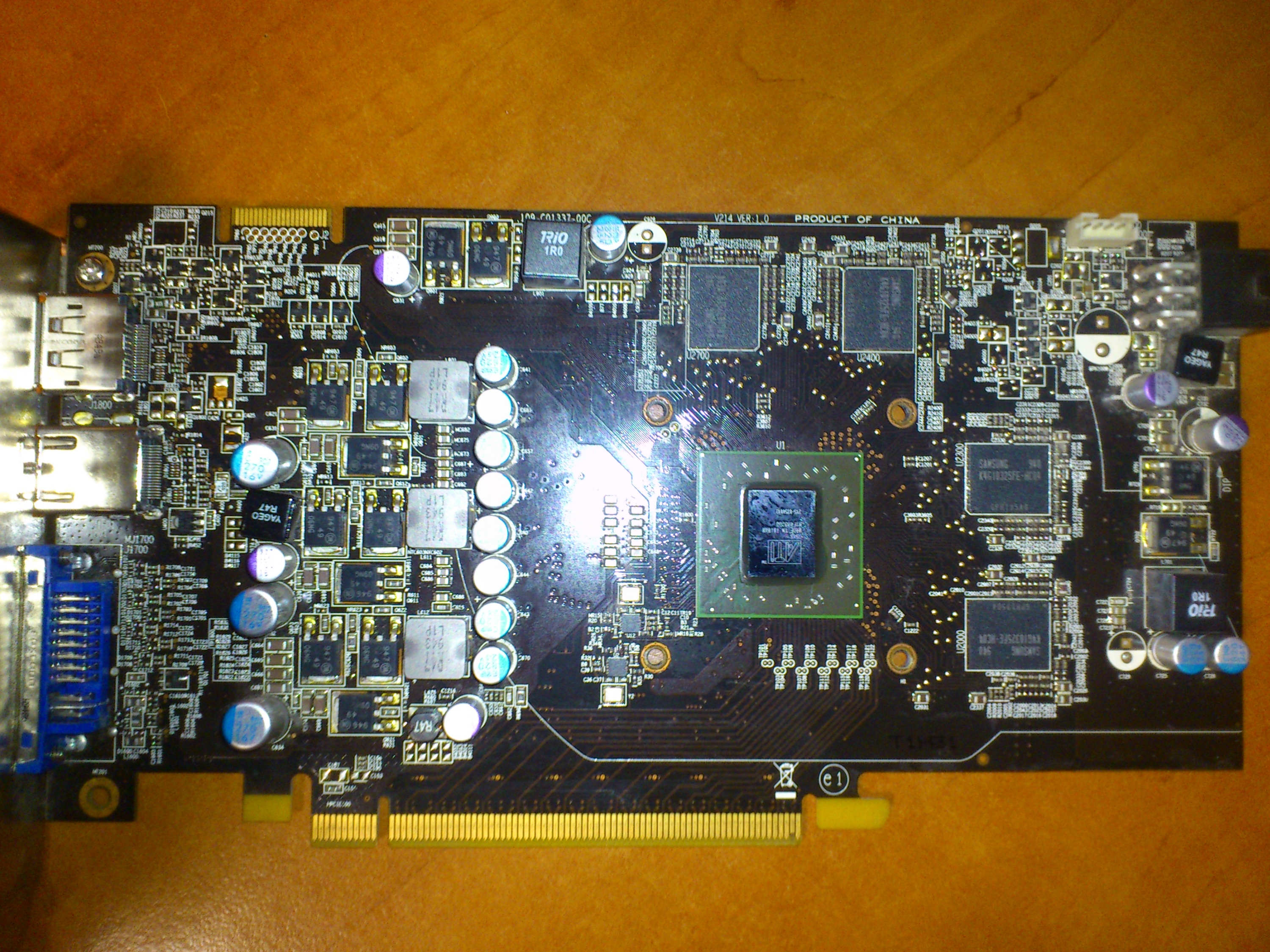

    I have on my hands possible short-circuited card.
    It has no video output and system doesn't detect it, but gpu gets hot and therefore I think it's not completely dead... YET
    What I should check first and how?
    I have very little experience in components testing(only capacitor re-soldering)
    Please help!
    Sorry for bad image quality

      There won't be infinite resistance between source and gate on the low side mosfets. More likely 10-20 ohms, because there are dozens of parts connected there.
      If you say the GPU gets hot but no video, i doubt it is a short circuit. Either the video BIOS is damaged or (more likely) some of the solder balls under the GPU have cracked and it requires reflow or better, reballing to work once again.

        There were no problems before aftermarket cooling solution was installed, so I guessed there were some touching involved between cooler mounts and vga

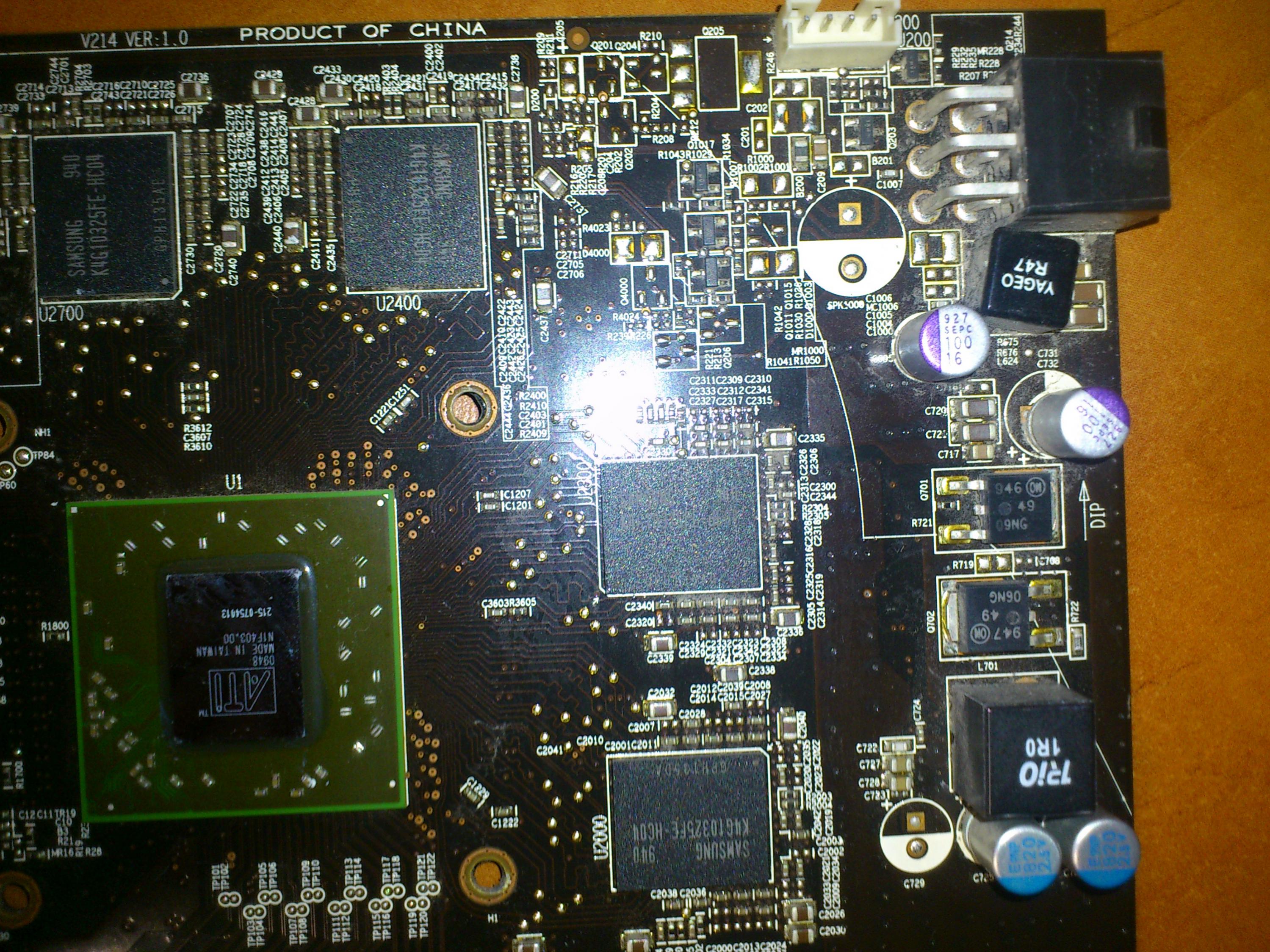

          is the part labelled with yageo r47 near the pcie power connector supposed to be at an angle like that?

            The cap under it also looks to be at a strange angle.. check to see if its supposed to be like that or not... looking at the back of the board where the cap is located will help u
