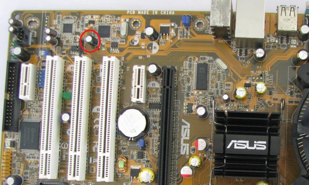

                      I'll bring this back to a motherboard thread, which cap in the picture is actually for the Ethernic NIC? Is it possible that a failing PSU can make a built-in Ethernet NIC perform badly and now after replacing the PSU without a -5VDC rail on a ASUS P4C-800E Deluxe, it seems the led's on the Intel Pro1000 jack are orange and windows claims the device fails to start up properly.

                          Read the previous post again. It only occurred after replacing the PSU with a different one with no -5V. It's more likely to be power related - either it needs the -5V (which I will stress again, is a ridiculously bad design, but knowing ASUS, is entirely possible), or the original PSU took the Ethernet controller out.
                          The cap in question is circled here. It wasn't installed from the factory, and so I added it.

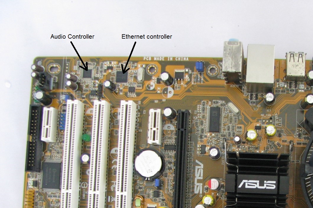

                                Basically, this is what happened. About a year ago, the built-in NIC would no longer do 1000Mbps as in Windows, it would think the network cable is unplugged and the only way to get it working is to force 100Mbps inside Windows. In April 2014, there was a weird smell from the computer and I thought it was the motherboard's capacitors and had been buying replacement capacitors to recap the board but due to the top of the case requiring lifting the table before I can get the full tower SuperMicro SC750 case out, I was postponing the recap of the mobo then of course on September 10, 2014 - I was using the system and it all of the sudden turned off but the status light on the motherboard remained on and only on the first push of the power button on the case after AC power is connected, would the front case panel lights blink once quickly. The PC Power & Cooling Turbo-Cool 450ATX has a -5vdc rail and basically is waiting to get recapped as soon as I order the capacitors. I am using a Corsair CX750m which does not have a -5vdc rail and the only thing not working is the on-board Ethernet so I want to see if it is the -5vdc rail causing it as I will know when I get the PCP&C recapped and working again just so I don't mess up two items and can't figure out which one is working and which isn't so better to do one at a time.
                                If that doesn't fix it, it can be the caps of the motherboard as it is at least 11 years of the system running 24x7x365. So I'm hoping that the ethernet NIC does actually go through caps in the circuit and replacing it will fix it since I am replacing all 34 caps on the board including the 5x 16v 100uF caps with the Rubycon ZLH that I have while the others will be replaced with the following:
                                Nichicon HZ 6.3v 1000uF 8X15mm
                                Nichicon HZ 10v 1500uF 8X20mm
                                Nichicon HZ 16v 1500uF 10X20mm

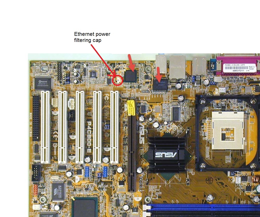

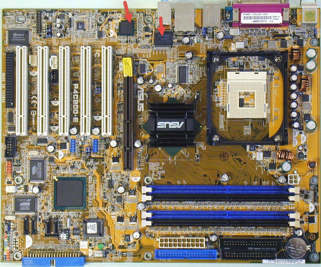

                                Is the chip right above the cap you added the NIC controller? I know on the motherboard I have, it's capped exactly like the one in the attached picture with all those spots for caps without installed caps from the factory. The chip with the Pulse on it is part of the NIC as well as the PCI Intel Pro1000 cards also has it. It's not a biggie as I can always replace it with a PCI Intel Pro1000 card if nothing else fixes it.
                                Not everything on the board is working because there has been a problem with a USB hub which was hanging the BIOS at the main POST screen before the PSU failed once and once after the current PSU is in there, basically I would need to unplug the DC Adapter to the USB hub to power cycle the USB hub before starting the system if it hangs at the BIOS start screen, the one with the big ASUS logo to get it to work normally.

                                  It's hard to say what the problem is. It might be the PSU, but it may very well be the Ethernet controller IC as well.
                                  The IC immediately above the cap I installed is indeed the Ethernet controller. Your board appears to have the same cap missing as mine did. You could add a 100uF or 220uF 16V cap there if you care to.

                                      No. I'm pretty sure there are no other caps to filter it. If your other power supply got bad caps, then that might explain why it was one of the first things to stop working.
