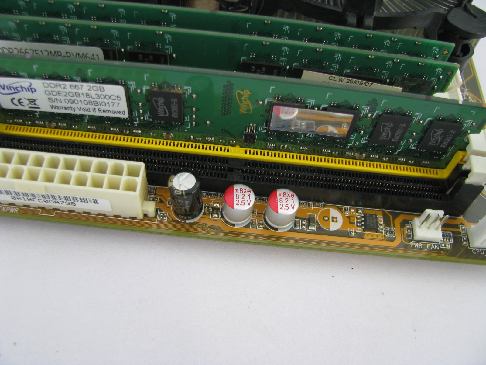

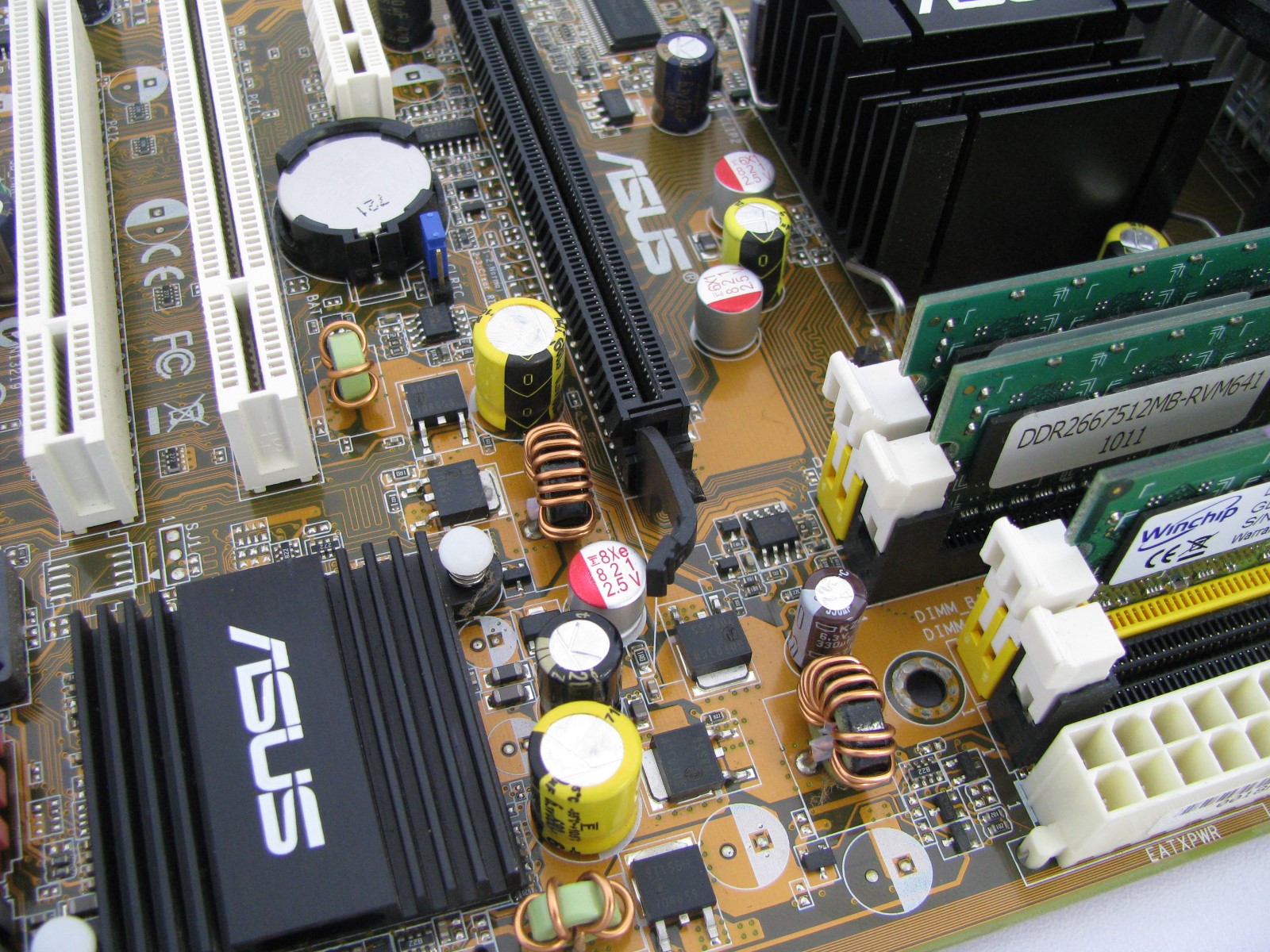

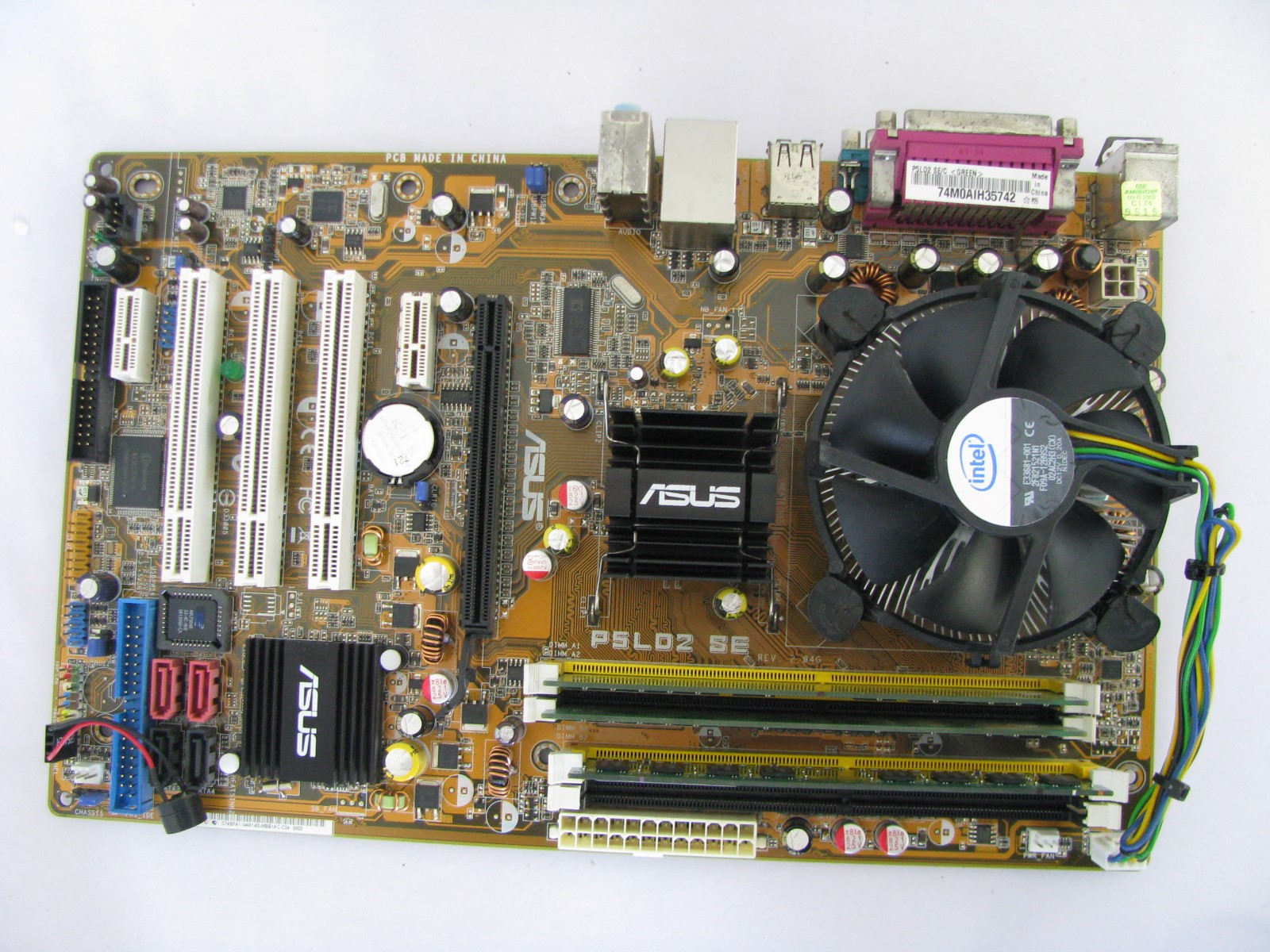

    ASUS P5LD2 SE Recap and partial Polymod
    I ended up with this board as a freebie, just because it had a bad cap in between the PCI slots (an 820uF 6.3V KZG to be specific). It appeared to be working fine, though in spite of the bad cap. I didn't have very many 820uF lytics on hand, but I have LOTS of 820uF 2.5V polies, most of which are scavenged from motherboards, plus a few new Fujitsu "bumble bee" polies from Topcat.
    So, after measuring the voltages on them, I found that only a few of them had 5 or 3.3V on them - most were on the low sides of RAM and Chipset VRMs, so here was my approach. For the 820uF parts which were on the high sides of VRMs, I used the few 820uF 6.3V Ruby MCZ and MBZ caps I had left. The VRM low side caps which had less than 2V on them, I used Fujitsu 820uF 2.5V polies, and for the USB and Audio filtering caps, I used 1000uF electrolytic caps. The Ethernet NIC controller was also missing the cap on its power supply from the factory ( goes to ASUS for that one). I added a 220uF 16V Panny FR there. The best part is, I managed to get all of them in the first time without reverse-polarising any of them.
    The board boots to the BIOS reliably still. I haven't installed an OS yet, but hopefully, it will work fine.
    EDIT: I didn't touch the CPU VRM on this board. It came with Panny FJs on the VRM high side and NCC PSC Polies on the low side.

    Re: ASUS P5LD2 SE Recap and partial Polymod
    great work! can't believe they would leave out a cap like that wonder if it affected network stability.
        Nice job! You probably saved the NIC from a sudden death in case of a bad P/S or something like that by adding the cap, I too measure the voltages to know whether I can get away with a lower voltage cap wish my freebies came in such a decent condition needing a recap or other quick fix but somehow I always get messed boards , anyways that's a nice board I like the layout, clean and simple except those misaligned DIMMS, hope it never shows the so dreaded Asus-Sudden-Death-Sindrome though.
          I just did a partial recap on (another) ASUS board 2 days ago. The patterns seems to be that caps close to the PCI slots are on the 12V, 5V, and 3.3V rails. These are usually general filters, so most of the time it's not critical if they go bad. There may also be a cap for 5VSB and the Southbrdige Vcc (normally 3.3V and always ON even with the board turned OFF), again close to the PCI slots, but not necessarily.
          Yup, I do the same as well, since my 1000 uF and 820 uF electrolytic cap stash is always low, whereas my 2.5V 820 uF poly cap supply isn't that bad (I have a pile of dead Xbox 360 motherboards). My general principle is, only use 6.3V and higher voltage electrolytics if they are needed due to voltage requirements.
          No surprise there. ASUS boards always come with a ton of caps not installed from the factory, hence many empty spots. The good thing about that, however, is that it allows you the flexibility to use mid-grade low-ESR caps in higher numbers (if that's all you have on hand, for example).
          ... or just add more crappy KZG caps to extend the board's life a tiny bit longer before they all bulge .
          Hehe, I've recapped ASUS boards more than any other brand, so I'm almost "used to" putting my caps in "backwards" .
          Nice recap, by the way.
