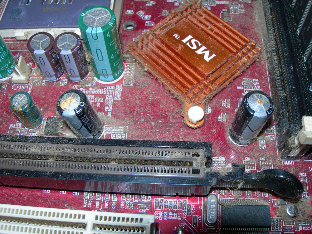

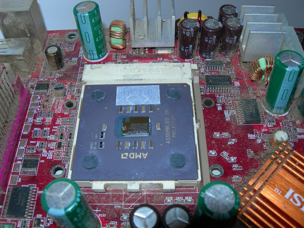

    Hey got a mobo with two visibly bad caps. (first pic). I've read on someone else's post the 4 big green ones around the cpu went out as well. These particular ones on my board don't look bad. (next pic) But should I replace them anyway?? They are KZE 4700uf 6.3v .
    Another Q, the two offending caps are G-Luxon 2700uf 6.3v I have some old caps that I took off a different board, they don't look bad but were part of a group of 9 that were bad around the CPU. They are a Nichicon 3300uf 6.3v My question is can I temporarily solder these in to see if they will make the board work? Or am I risking further damage to the board by them having a higher uf value or possibly being bad with no visible signs??

    I personally wouldn't bother replacing the KZE's at this point of the recap project, those Teapos & G-Luxons should be dealt with first (1000uF and up)
    Additionally FWIW that board is disgusting... how about hitting it with some compressed air!
    What series are your s/h Nichicon caps? HM/HN series were pretty bad IIRC, you could solder in those old reused caps but why not just use new and never have to worry about doing it ever again

      The Nichicon caps are HM(M) What about the different uf value? I know nothing about caps.

        The higher uF value is ok
        However if they where part of a series that went bad I would not use them.
        They are probably in very bad shape already...

          Different series Nichicon would be okay... as far as using higher uF values, personally I only do this as a last resort (when I'm unable to source replacements) though others do practice this method frequently without issue
