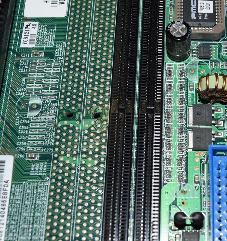

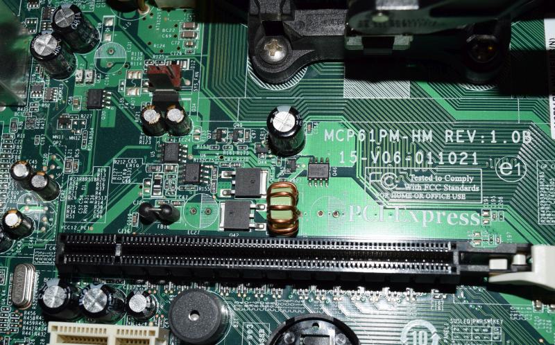

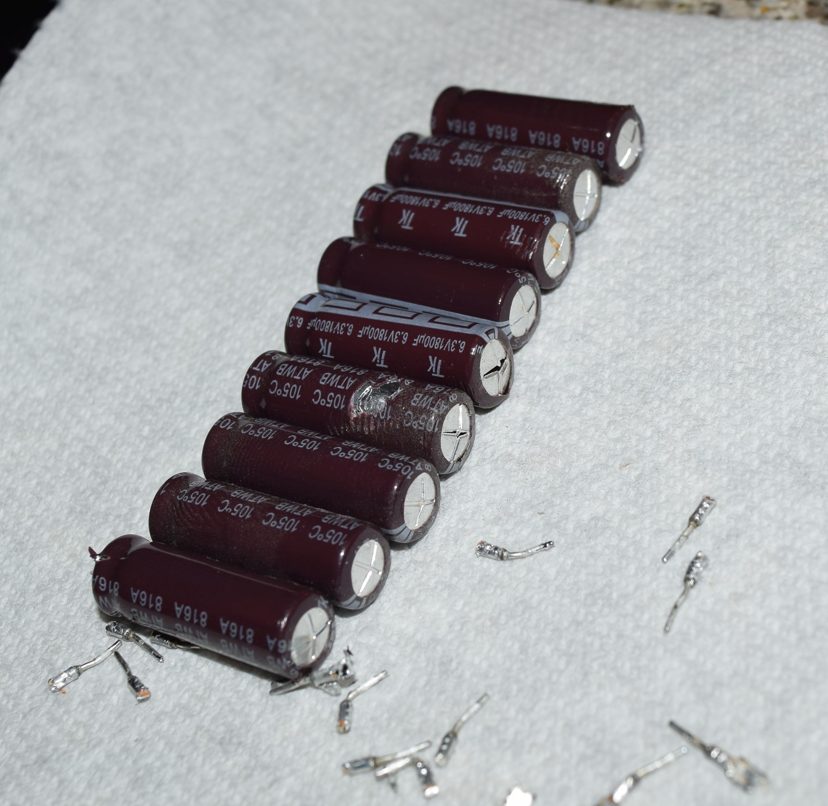

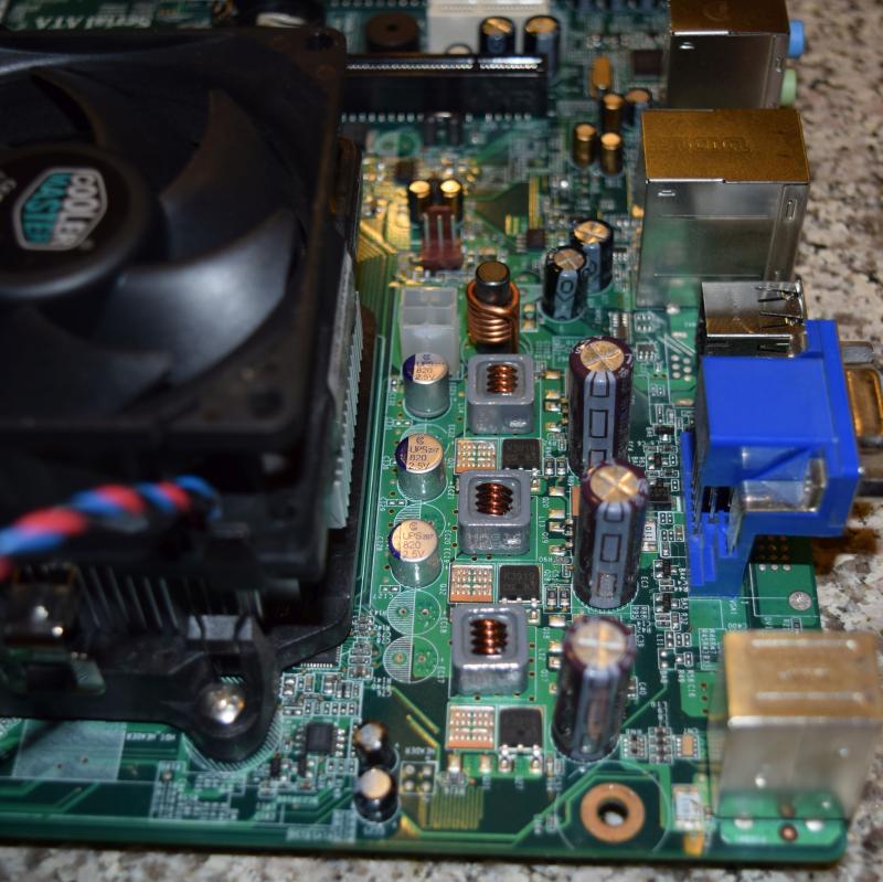

    I got a computer in recently and it had a bunch of bad caps so I decided to replace them. First pic is all the caps removed, I mostly pulled them off the board with needle nose then removed the legs after.
    Other three pics are to show the location of them, and to maybe see if I need to replace any more.
    I ordered these as a replacement:
    http://www.digikey.com/product-searc...s=UHZ0J182MPM6
    Did I get the right part? Should I do anything else like check the power supply caps

          Those caps will work fine. I'd recommend replacing at least the three bigger ones near the rear IO ports while you're at it. They are the same brand and series as the ones that failed.
