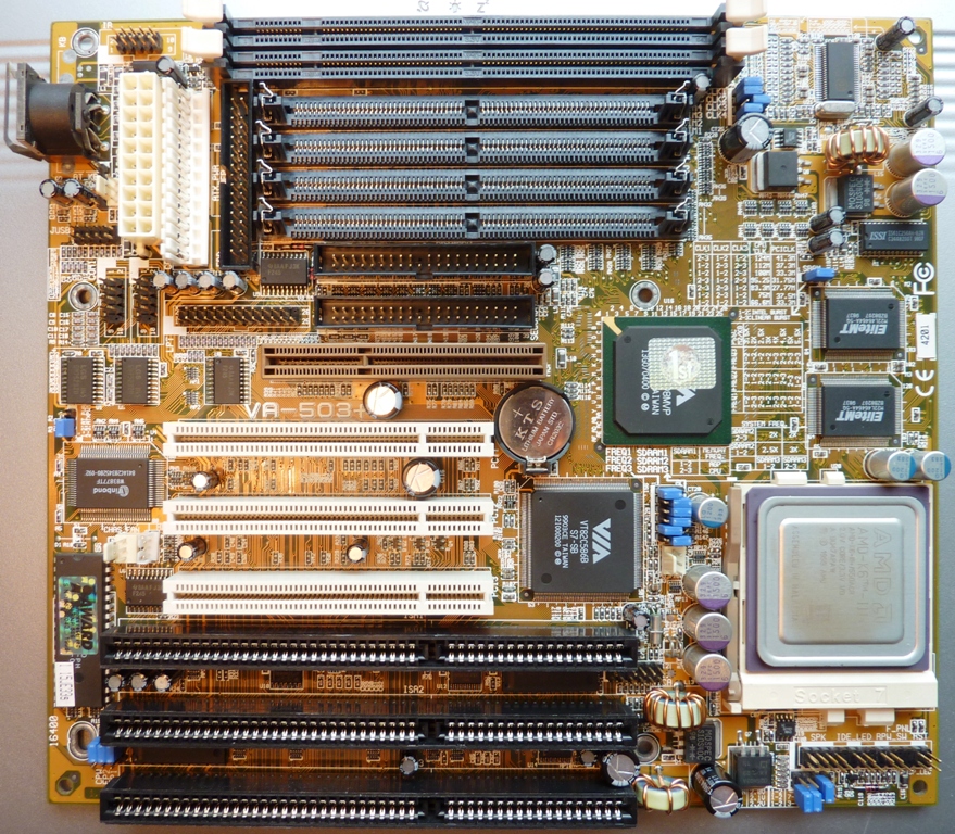

    I still have some old Socket 7 systems running for fun.
    One of them has a FIC VA-503+ Rev. 1.2 Baby ATX board working, which was quite popular back in the days (ca. 1998).
    The Vcore section has 6 "Canicon" 1500uF 6.3V which I don´t trust at all.
    So I´m going to replace them soon.
    The diameter of the Canicons is 8mm and the height is 16mm. I could use 10mm diameter but the hight is strictly limited since the CPU heatsink covers that area.
    What I found so far:
    1. Nichicon LG polymer 1200uF 6.3V 8mm x 12mm (would fit perfectly but only 1200uF)
    2. Panasonic OS-CON polymer 1500uF 6.3V 10mm x 13mm (are slightly too fat, height is perfectly o.k.)
    3. Rubycon ZLH 1500uF 10V 10mm x 17mm (slightly too fat, height at the upper limit, but would probably fit)
    Which capacitor is the best choice? Can someone suggest a better alternative?
    And please don´t mock me for using such an old legacy shit - it´s pure nostalgia...

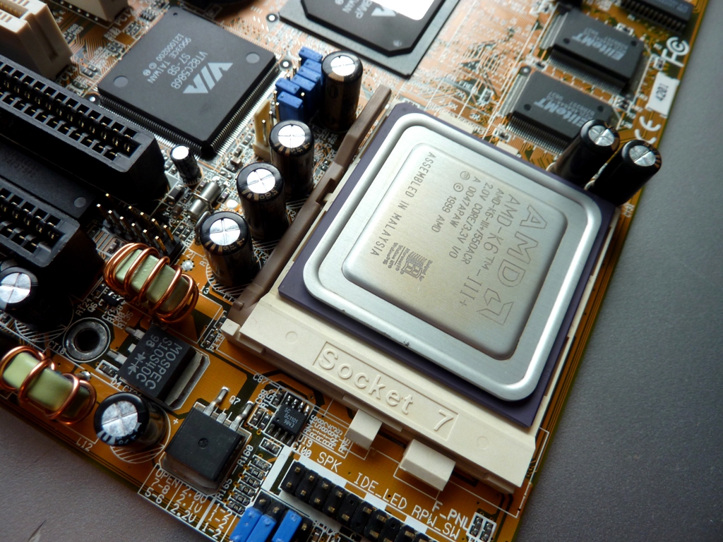

      The FIC VA-503+ and the EPOX MVP3G5 used to be my favourite boards back then since they were faster than the competitors´.
      And here´s a Picture of the CPU-area:

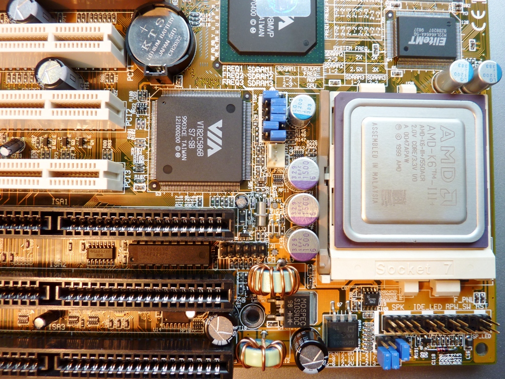

                  So, what I did is replace the 5 x 1000µ at the 5V rails with Rubycon ZLH 1000µ 16V, replace the two 1500µ 6.3V at the step-down converter for 3.3V (RAM / AGP) with Panasonic OS-CON Polymer caps and replace the Vcore caps (for stabilizing Vcore) with 1500uF OS-CON Polymer, where there is enough space (10mm) and 1200uF Nichicon LG Polymer whrere there´s only room for 8mm.
                  I think this is a workable compromise. It´s no use to force a 10mm in there when you cannot open the lever of the ZIF-Socket anymore...
                  Now there are about 20+ 10uF left that are spread over the board. I´m probably going to swap them as well.

                    That might be the only socket 7 motherboard with polymer caps. It should work pretty well.
                    My Compaq uses the same CPU voltage regulator circuit, but it only has four 1500uF caps on the output and it might have a larger output voltage range (2.0V to 3.5V).

                        Well I wouldn´t say cheap, but if you order a couple of hundreds as i do from time to time they are about 80 or 90 Eurocent each.
                        Here I "spoilt" 8 polymers, the rest is all ZLH Rubycons.
                        I also replaced the 20 10uF today so it´s "total recap" for this board...
                        Next week will show if it´s running stable.
