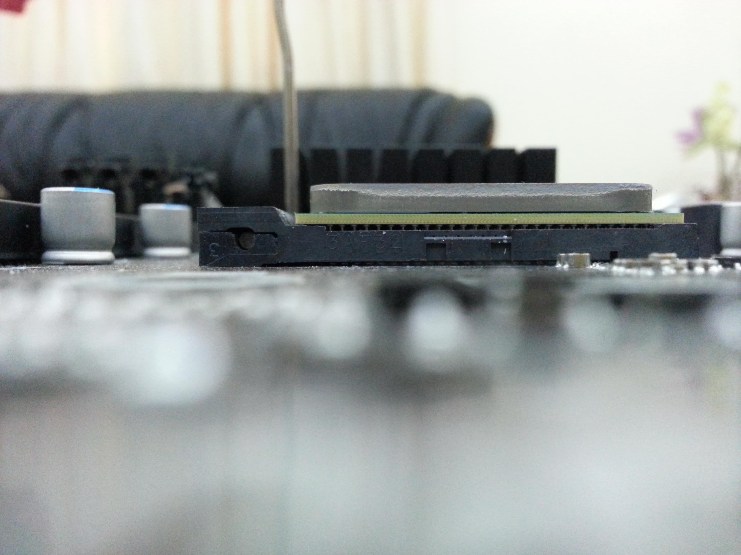

                    Re: How to: CPU Socket Reflow
                    In preparation of the reflow, I notice that the cpu does not sit flat in the socket of this motherboard. This is unlike the same replacement motherboard and an older generation asrock m3a770de.
                    Difficult to take a picture here because of the low height and obstructing caps around, but let me try to explain.
                    If you place the cpu in the socket, and apply pressure to one corner with your fingernail, there is movement, whereas on the good motherboards, there is no movement.
                    I guess all that tugging and pulling on the hsf owing to the un-cured TIM did something here.
                    Wondering if a reflow would fix such an issue or make it unfixable. Or if i should apply pressure to the socket once it reaches 230 degrees C.

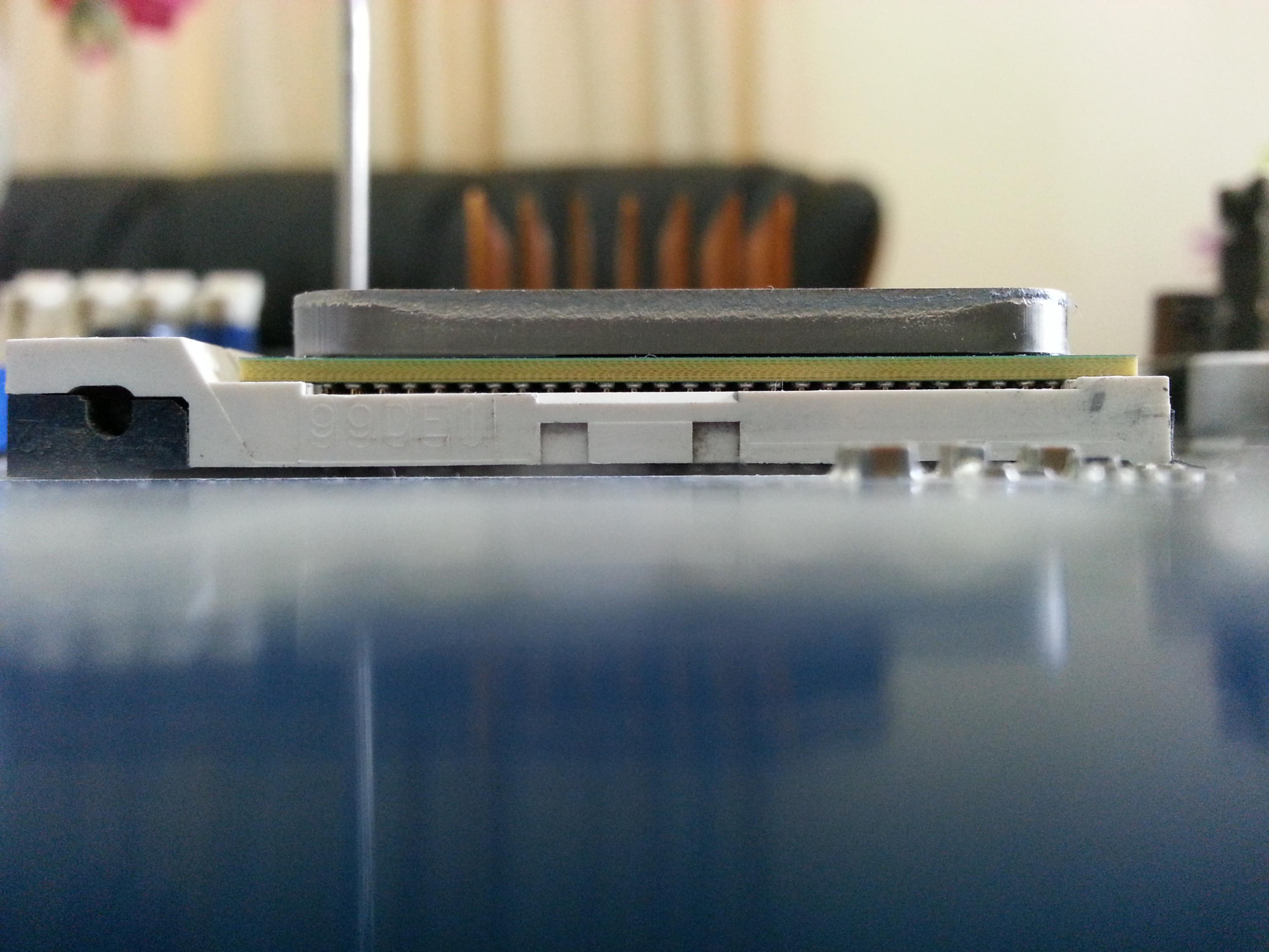

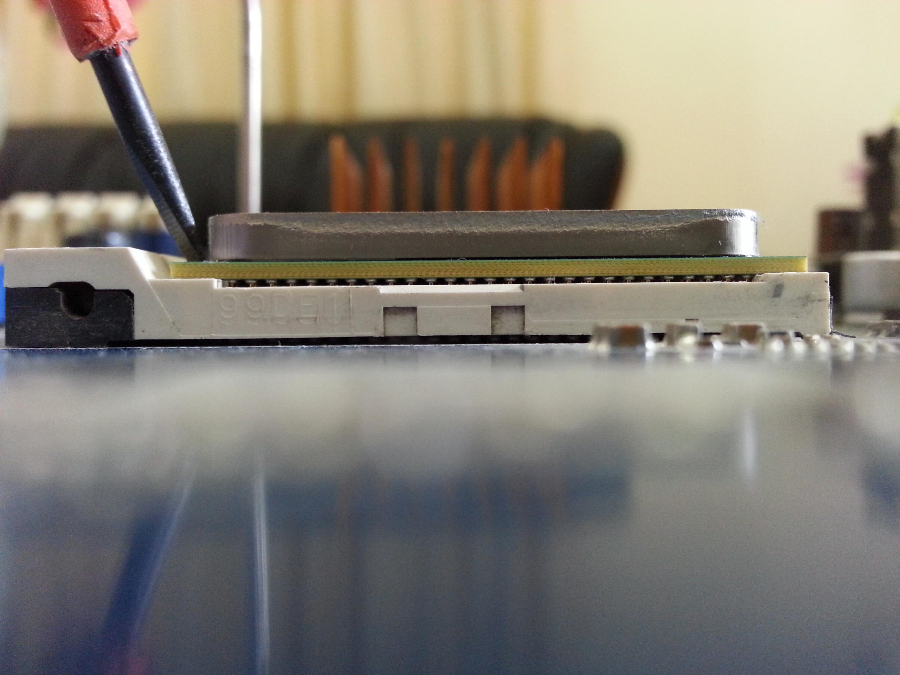

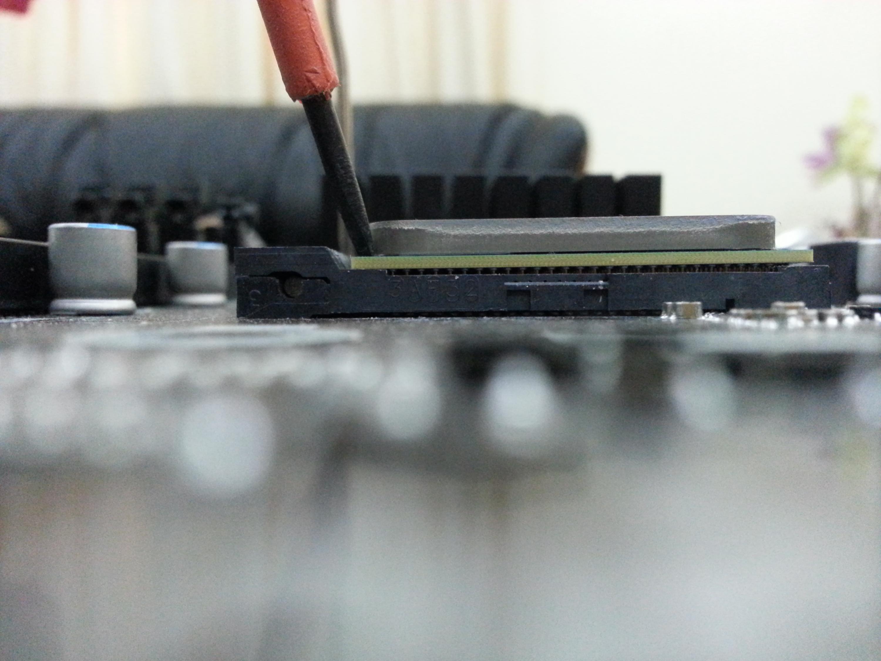

                      Alright. Took off the retention bracket and that gave me some room for pics. Apologies for the angle on the faulty mb but there is a cap bang in the middle of the line of sight.
                      You can still see the cpu lift when very little pressure is applied to one corner. On the good mb, there is NO movement whatsoever.
                      CPU in ASRock 970 Pro3 (faulty) normal and with pressure applied to one corner:
                      CPU in ASRock M3A770 (working) normal and with pressure applied to one corner:
                      This is after applying a vacuum cleaner to the socket...
                        No, never apply any pressure to the socket when it's hot. You'll either crush the balls and bridge them or move the socket. At 230C or above, the solder will melt and the socket should drop to where it needs to from its own weight.
                        As for the CPU not sitting even on the socket - I can't sure if that's the problem or not. All I can say is that I've seen this a few times on older AMD socket A motherboards, and it has never been an issue. In fact, I think one of my S939 boards did this too, but I don't remember too well.
