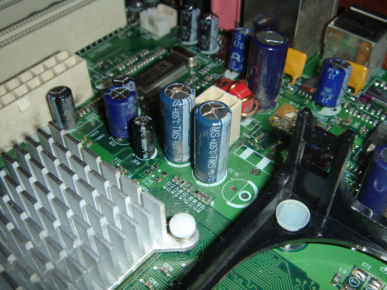

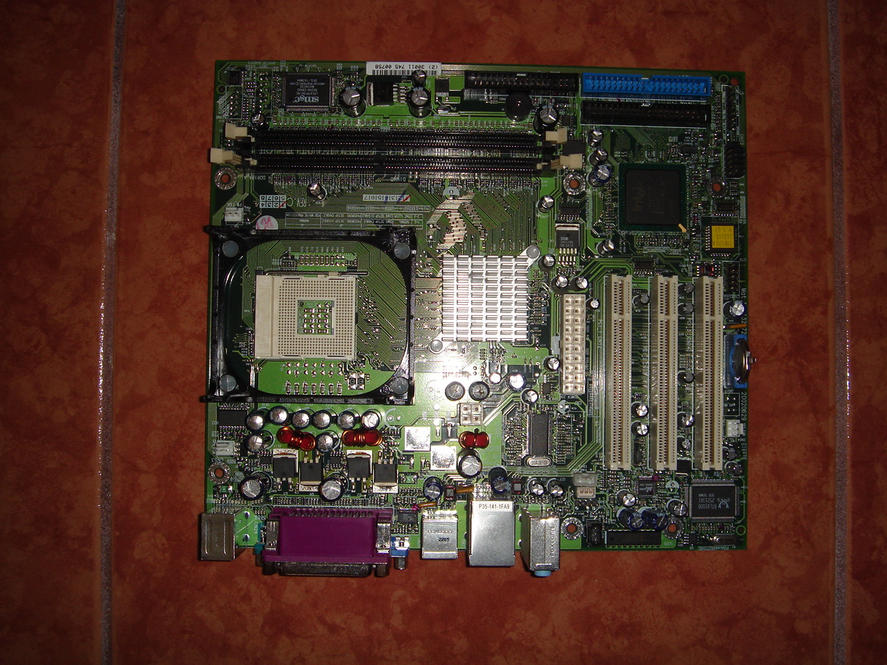

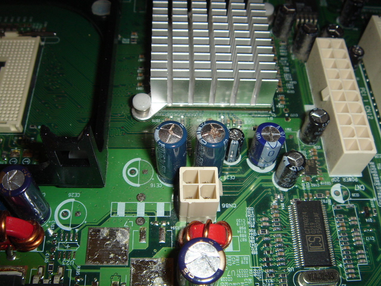

    Hello Everyone,
    I went out shopping today at my local computer shop and I purchased a motherboard with badcaps. The owner of the store decided to sell the motherboard to me for $10 which was a pretty good deal for a socket 478 motherboard with an Intel 845GV chipset.... even though it was working properly.
    On the motherboard it says Imperial_GL_VE 20020629 and it still posts with my Celeron 2GHz CPU. Upon bootup, it comes up with the HP Boot image and it actually finishes POST process so that means the MOSFETs are still OK and other components (apart from caps) are still OK.
    I only have one problem now and that is the recapping process. Right now I have a lot of Hitano 1500uf 10V 10mm LOW ESR caps, the caps are a little big but i guess they will fit because theres a 1.5mm gap in between each cap. The caps currently on the board are TMS 1500uf 6.3V 8mm. There are also some Sam Young and RM caps on the board.... Do I need to replace them also even though they havent bulged or leaked .... yet. There are also a few Rubycon MBZ caps on the board and they all appear good.
    Is there any way that I can find out what HP computer system this motherboard came out of??.
    Thanks.

    Re: Installing new caps on a HP motherboard
    its probably from a pavilion 522 or 533, who knows. why you would need to know i dunno. motherboard is made by trigem korea which is an oem only manufacturer. its a trigem imperial GL
    https://www.badcaps.net/forum/showthread.php?t=990&
    https://www.badcaps.net/forum/showthread.php?t=463&
    you need to replace all the TMS for sure they are super crap. what are the values of the samyoung and rm? you can leave the MBZ for sure.

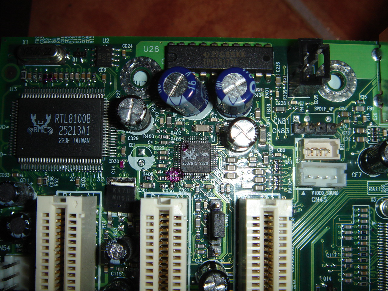

        good point. i usually disable all that crap
        for sound its got a realtek RTL81008 so you can use the reference driver
        http://www.realtek.com.tw/downloads/...&GetDown=false
        what is the chip to the right of that one. (at the left of PCI 1 and 2) maybe thats the lan
        there is also a smsc chip which i guess is temperature monitoring etc

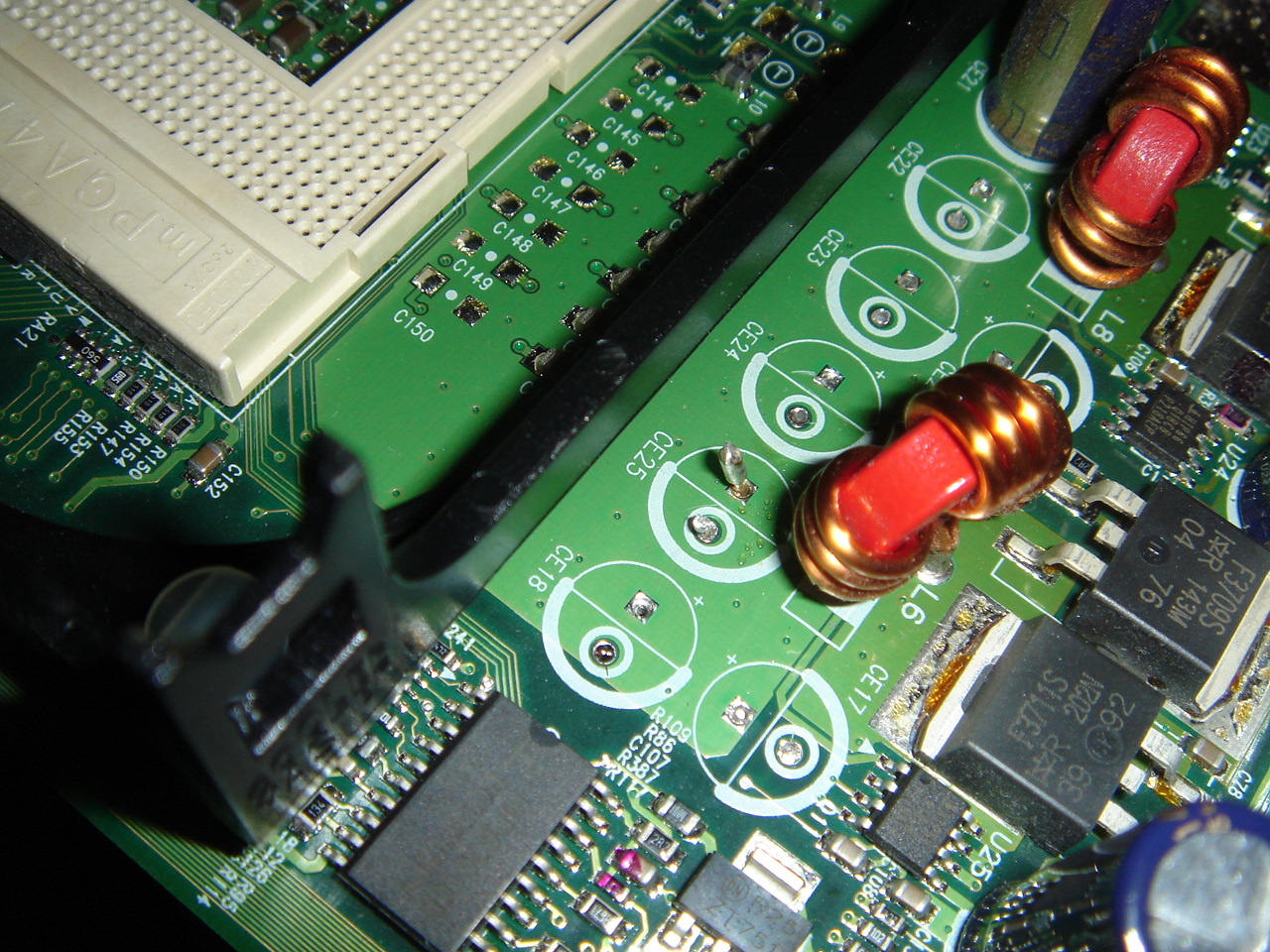

          Thanks Willawake, I guess i'll try the Realtek website for audio drivers then. As for LAN drivers.... I'll look into that one day when i'm not busy.

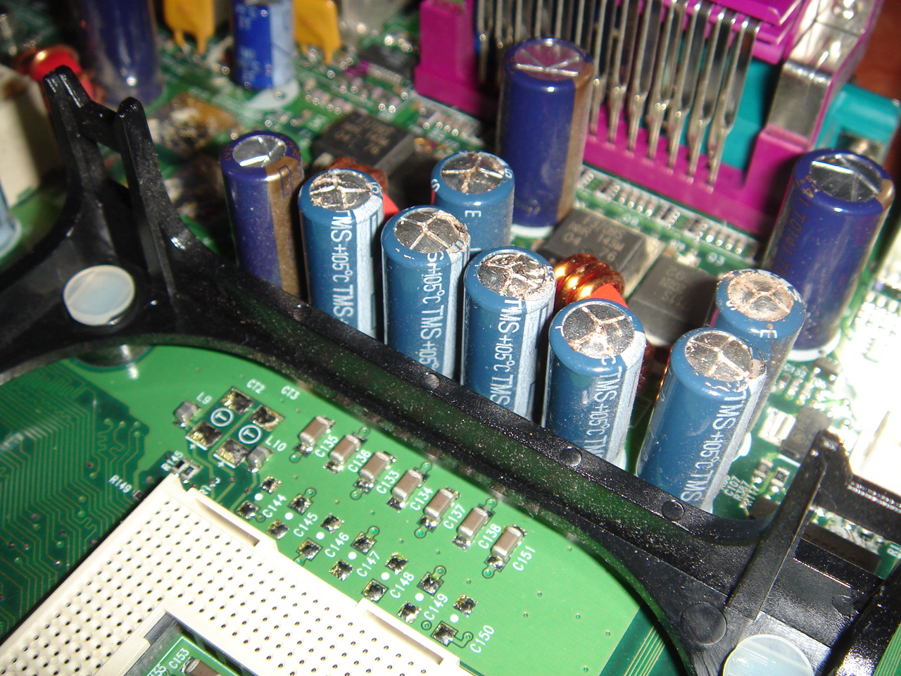

          Now I have a problem. In the process of removing the TMS caps, there was one cap that didn't want to come out so I think pulled it too hard (while heating the leads of course). The cap itself started sizzling and electrolyte came out of it.... then I discovered that I snapped the cap off the board?!
          Now I'm left with two leads.
          Does anyone have ideas on how to pull these leads off?? I tried pliers but it didn't work either even though I got someone else to pull it while I heated the cap but it still didn't come off.... I'm afraid that if I pull it too hard I may damage the motherboard itself.
            add solder to both sides (important). use pliers, dont pull, wiggle it. if it seems impossible then try heating from the front
            if in the end you cant do it then leave it and use double uf value in one of the next caps in the same row

              Thanks Willawake, I added some solder and wiggled the leads then after a while it eventually came out.
              I've attached a picture of the chip to the left of PCI 1 & 2.

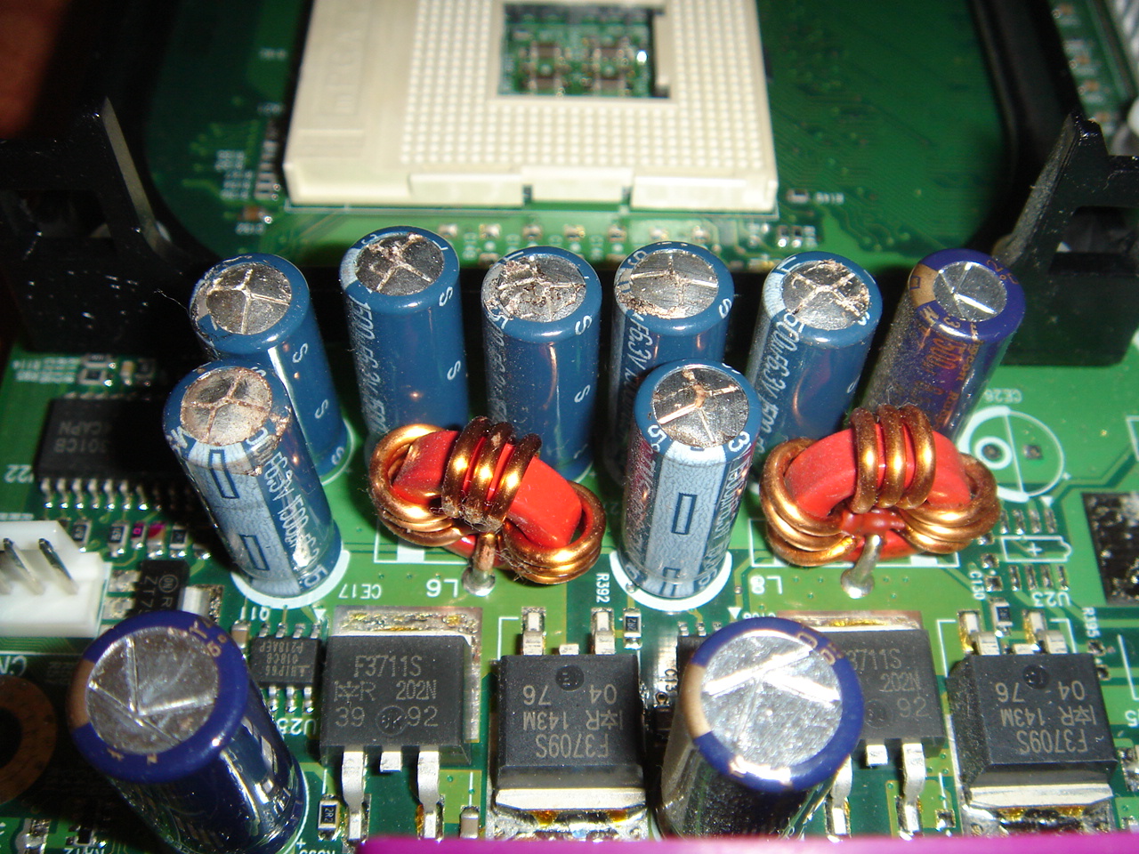

              So far I've cleaned every lead hole around the CPU all I have to do is add the caps in. The single Rubycon MBZ is still there since it is still good.
                Here is the driver for your NIC (Realtek 8100B)
                If you are heating the lead and it wont come out you have too little heat... Add more solder, that will help the heat spread out more
                  oops i got them the wrong way round. Per is right, that one is the lan. The audio is the little one realtek alc202a . drivers should still be ok or use the ones on intel site.

                    I have recapped the whole motherboard now and it works fine.
                    Amazingly all of those 10mm Hitano 1500uf caps actually fit the area where the old 8mm caps were.... I only had to put 1 cap on its side for a little more space .... but in the end, everything worked fine.

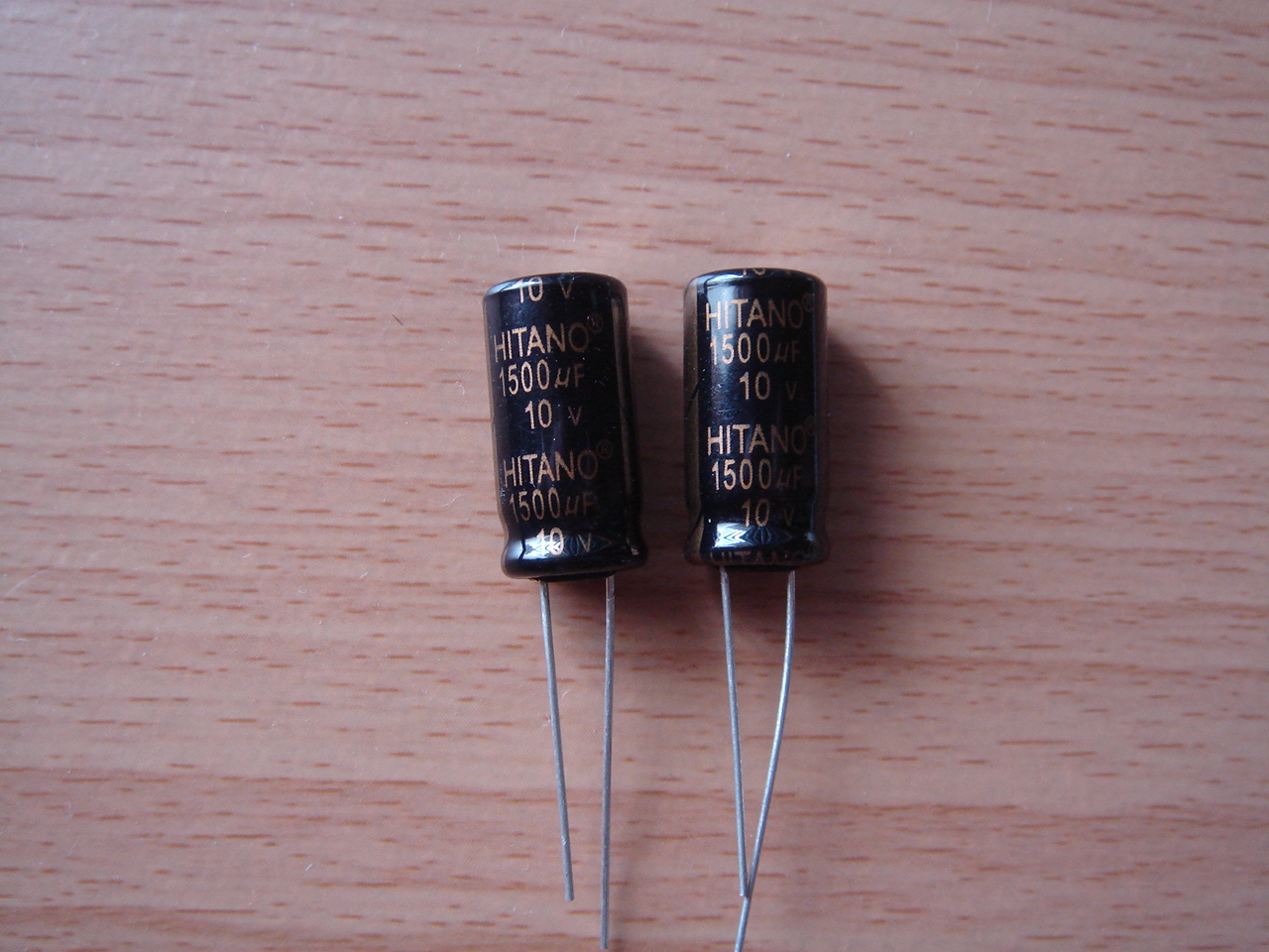

                        BTW if you don't mind me asking, how much are you shelling out (approx.) for those EXR series Hitanos? locally they're charging $1.50 ~ $2.10 per unit (depending on rated value)
                          The Hitano EXR 1500uf 10V caps costed me $1.30-ish (AUD) in November 2006. The 3300uf 10V ones are the really expensive ones.... the shop charged me $2.20 AUD for each of them.... the higher the capacitance or voltage, the more expensive it gets.

                              I was curious about the Hitano caps and checked their spec sheet ( ). Their "low ESR" impedance figures are about 3-4 times as high as (for example) a Panasonic FM of the same voltage & capacitance.
                              I think you have "low ESR" but would ideally have "very low ESR" capacitors for these types of uses. Possibly having gone with the larger 10mm x sized part and 10V, you have improved specs enough to offset this, but I'd be weary of some uses that called for 10mm parts originally, and check their temps while running (CPU) at full load with the idea being not just to keep them under 105C but that they shouldn't feel overly warm for longest life.

                                Correct 999999999 Hitano LowESR caps are not in the same game as Rubycon, Panasonic, Samxon etc.etc.all having Ultra Low ESR caps.
