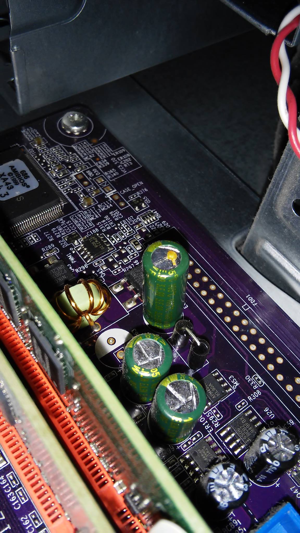

                                    A bit of an old thread, but I've seen problems on a board with an E5800 (dual core) working fine, but an E8500 (Core 2 Duo) not, despite being compatible. In that case it was down to bent pins on the socket, in case any one else is struggling with a similar issue. All it took was a couple of hours of swearing, a magnifying glass, and a very fine sewing needle
                                    • magtec
                                      • Sep 2016
                                      • usa
                                      Re: ECS MCP73VT-PM - works fine until Windows boots : BSOD
                                      found on an MCP73VT-PM v2.1 from an emachine ET1831.
                                      • Dan81
                                        SNES-powered
                                        • Oct 2013
                                        • 1866
                                        • Romania
                                        Could be fake,as I know Sanyo SE don't bulge. It could be a Sanyo WF cap though,in which case my statement will be invalid.
