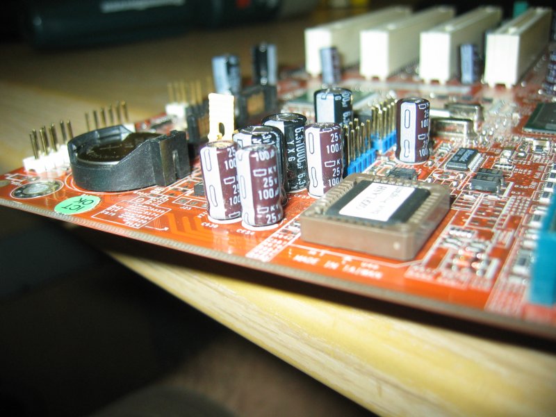

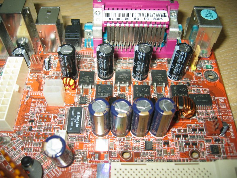

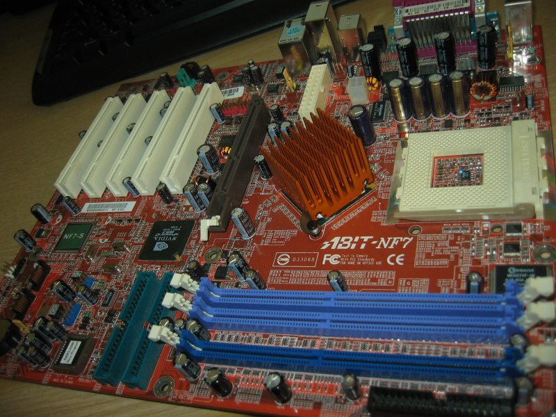

    I am pretty sure this board has bad caps, the symptoms are what is described on this website, it slowly crashed/rebooted/BSOD more and more, but always different error, I have spent the last 2months checking bits a pieces and it everything else checks out, this morning I checked the last thing, which is a brand new PSU(Antec 430W Neo HE), this didn't help either.
    So, I have attached some pictures for you all to look at. I have determined that these capacitors are good quality all over, but I experience bad caps symptoms. So they must be bad, they certainly look fine though. Each one is either Rubycon MBZ, ZL, YXG or United Chemicon KZG.
    What do you guys think? This board is 2yrs old. I do live in Australia so it does get quite hot, especially lately. Actually it started getting worse and worse towards summer so heat is suspect. But do you guys really think these good quality caps can be bad? which look most suspect to you? Was there a bad batch about 2yrs ago? I read that these brands should last 7yrs... so..
    Also, is it true that I only want to replace the 1000uF and higher caps? If so, why is this? can't they go bad as well.
    The reason I really want this working again is because otherwise I will have to buy a completely new system, I have a AGP card, DDR mem, and SocketA. These Abit NF7-S are really great, so I would love to have it stable again.
    Thanks alot guys, much appreciated in advance.

      Same board as you, the NF7-S V2.0 and have been running at main computer for years now after I got it used. I have zero bad caps.....because they are all Rubycon or United Chemicon like yours. I doubt that is the problem, the NF7-S boards are solid cap wise, look elsewhere maybe.

              1. Possibility of having bad DDR RAMs. Please run memtest86 and see...
              2. Is the DRAM supply stable ? I ever encountered a NF7 mobo with spoilt MOSFET in the DRAM regulator circuit.

                The possibility of your capacitors being bad are very small, replacing them is really not a good idea, that mainboard uses as you have seen excellent capacitor brands

                      I don't suggest to recap this mothbaord if withotu any problem, becasue it have good caps already. EXCEPT, you want to overclock and improve the perforemance.
                      I have an experience that i have fully recapped my Samxon Caps with this mothbaord, SuperPi 1M from 48s to 44s at same speed (2.2GHz) and config. It is true. I will do more testing like this for others boards in future, we see.

                                        That fan twitch syndrome does indicate that the PSU is overloaded and shutting off to protect itself. That could be a PSU problem, but if it happens with 2 different PSU's that used to be able to handle this board, then it's probably a board short.
                                        I'd check the legs on your mosfets with a multimeter and try to find a short. It could even be a bad cap - nothing is impossible.
