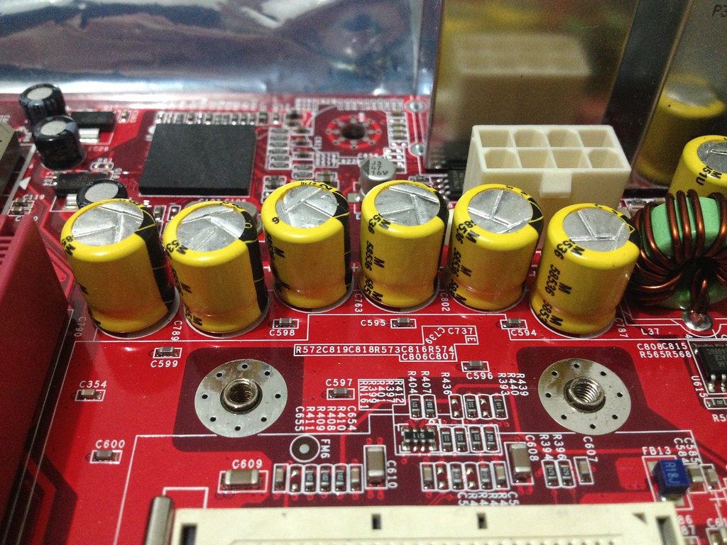

    Here are some photos of the caps. It's not all of them, just to show most of the different ones used. I didn't take the tiny surface mounted ones. I think the fat yellow ones might look a bit questionable, but all the rest have very flat tops and no stains on the board. So there aren't any obvious visual signs, unless those yellow ones are clearly bad (?).
    From what I've briefly read, those KZGs are very troublesome, correct?

    The pictures are tiny for some reason
    Do you have an ESR meter? Sometimes caps go bad without bulging.
    And yes, KZG are defective, and so are KZE.

      Oops sorry about the pics, I thought they would link through to flickr. I'll try fixing that now..

        Here are the photos a little larger, with links to flickr if you want to see them in full resolution. Sorry the thumbnails are a little large..

          with the exception of the KZG's in IMG_3089, they're all good caps. I actually have this exact same motherboard /w 2 opteron 240's, still in working order
          still not sure if its the caps though, have you tried a different video card? PSU? Taking everything out but the bare minimum and seeing if it works from there?

            Is this a single VRM for both CPU-s (all FPCAP in parallel) ?

                          Yeah, 18 Amps is enough, but CPU-vrm on this MOBO is POS, as on all mobo's which have more than ONE distinct group of capacitors for VRM-out. They draw more Amps than needed...
                          Long story short: on that mobo some caps are cooked, and for that CPU-vrm is to blame (probably in combination with not so good PSU, second hand mobo). Maybe, it's time to start changing poly caps :-)) (this, on mobo, are not so 'hi-tech' for this 190W consumer)...
                          Probably time for new system, some savings on electricity bill are in sight :-))...
                                No, not quite.
                                Only KZG and KZJ are know to be problematic. KZE, on the other hand, are excellent!
                                That said, it may be worthwhile to change those KZG caps. However, I would suggest trying a few other things first...
                                #1: try some known good RAM from another computer and try like the bare minimum (i.e. try booting with only a single 256 MB or 512 MB module - though I don't think that would be possible with Windows 7... may need to try Windows XP on another hard drive). Also try down-clocking the RAM.
                                #2: try booting with only 1 CPU. If you still get the same problems, swap the CPU with the other one.
                                The problem may also be BGA-related with one or both of the CPU sockets, but I somehow doubt that's the case since you have 2 motherboards experiencing very similar problems.
                                I'd say, try suggestions #1 and 2 above, and if they don't resolve anything, then send the motherboard(s) for repair to change the those KZG caps.

                                    Hi
                                    I calibrated my ERSMicro4.0s and measured the caps all around the board.
                                    Let me know what you think, especially if they seem incorrect - maybe I need to calibrate again and redo them.
                                    Original PSD map of the board available here (23MB):
                                    Download: "Capacitor_ratings.psd"
                                    Here is a JPEG:
                                    Here is the original photo:
                                    • Hadakajime
                                      • Jul 2013
                                      • 13
                                      Re: MSI Master2-FAR7 (MS9617) multiple problems
                                      Here is a reference list of the measured ESR ratings against each type of cap
                                      16V 1000uf:
                                      • 0.04 (Rubycon MBZ)
                                      16v 330uf:
                                      • 0.03
                                      • 0.02
                                      • 0.02
                                      16v 100uf:
                                      • 0.58
                                      • 0.53
                                      • 0.49
                                      • 0.43
                                      • 0.34
                                      • 0.27
                                      • 0.19
                                      • 0.16
                                      • 0.11
                                      • 0.06
                                      16v 47uf (surface mount):
                                      • 0.15
                                      16v 10uf (surface mount):
                                      • 7.9
                                      • 7.8
                                      • 7.8
                                      • 7.7
                                      • 7.6
                                      • 7.6
                                      • 6.5
                                      • 0.06 (calibration error?)
                                      10v 470uf:
                                      • 0.09
                                      • 0.07
                                      6.3v 1500uf:
                                      • 0.04 (Rubycon)
                                      6.3v 1000uf:
                                      • 0.10 (FJZ)
                                      • 0.09 (FJZ)
                                      • 0.08 (FJZ)
                                      • 0.07 (FJZ)
                                      • 0.07 (FJZ)
                                      • 0.06 (FJZ)
                                      • 0.05 (FJZ)
                                      • 0.05 (FJZ)
                                      • 0.04 (FJZ)
                                      • 0.04 (FJZ)
                                      • 0.04 (FJZ)
                                      • 0.03 (FJZ)
                                      • 0.03 (FJZ)
                                      • 0.03 (KZG)
                                      • 0.03 (KZG)
                                      • 0.02 (KZG)
                                      • 0.02 (FJZ)
                                      • 0.02 (FJZ)
                                      • 0.01 (FJZ)
                                      4v 820uf:
                                      • 0.04
                                      • 0.03
                                      • 0.03
                                      • 0.03
                                      • 0.02
                                      • 0.02
                                      • 0.02
                                      • 0.02
                                      • 0.02
                                      • 0.02
                                      • 0.01
                                      • 0.01
                                      • 0.01
                                      • 0.01
                                      • 0.01
                                      4v 560uf:
                                      • 0.01 (OSCON)
                                      • Hadakajime
                                        • Jul 2013
                                        • 13
                                        Forgot to mention that these readings are for board #1 only, which was pretty stable compared to board #2
