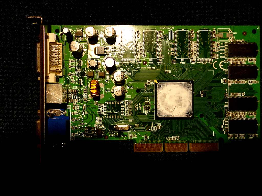

This videocard uses these fake polymers. The vent is a "K" suggesting Rubycon, but I doubt it. These are SMT but there are two holes on the back of the card for through-hole mounting as well. How do you get them off without tearing the foil traces? What is an appropriate replacement? Thanks for this.
Please identify these caps

That is a poor picture - cant really see a card manufacturer using fake caps
anyway a decent close up of one or two of the caps will enable better identification.Please upload pictures using attachment function when ask for help on the repair

This videocard uses these fake polymers. The vent is a "K" suggesting Rubycon, but I doubt it. These are SMT but there are two holes on the back of the card for through-hole mounting as well. How do you get them off without tearing the foil traces? What is an appropriate replacement? Thanks for this.Comment

As far as removing them, just heat one side with a soldering iron, tilt the cap up a bit, then do the same on the other -- don't over do it, you may have to go back and forth a couple of times; then remove the excess solder carefully off the pads with flux and wick.
Retake the pic at an angle next time so the glare doesn't obscure the lettering.Comment

Those aren't fakes, those capacitors are made by Tecate Group. They're actually polymers, and although I can't tell you which series exactly, here are their polymer datasheets.Comment
