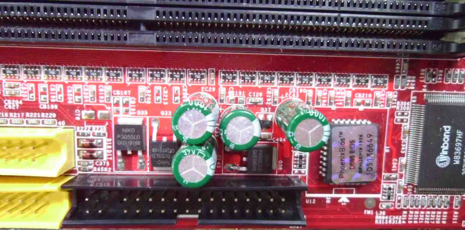

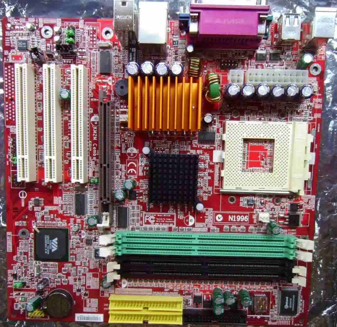

    Thought I'd show the build quality of this MSI KM2M Combo before selling it

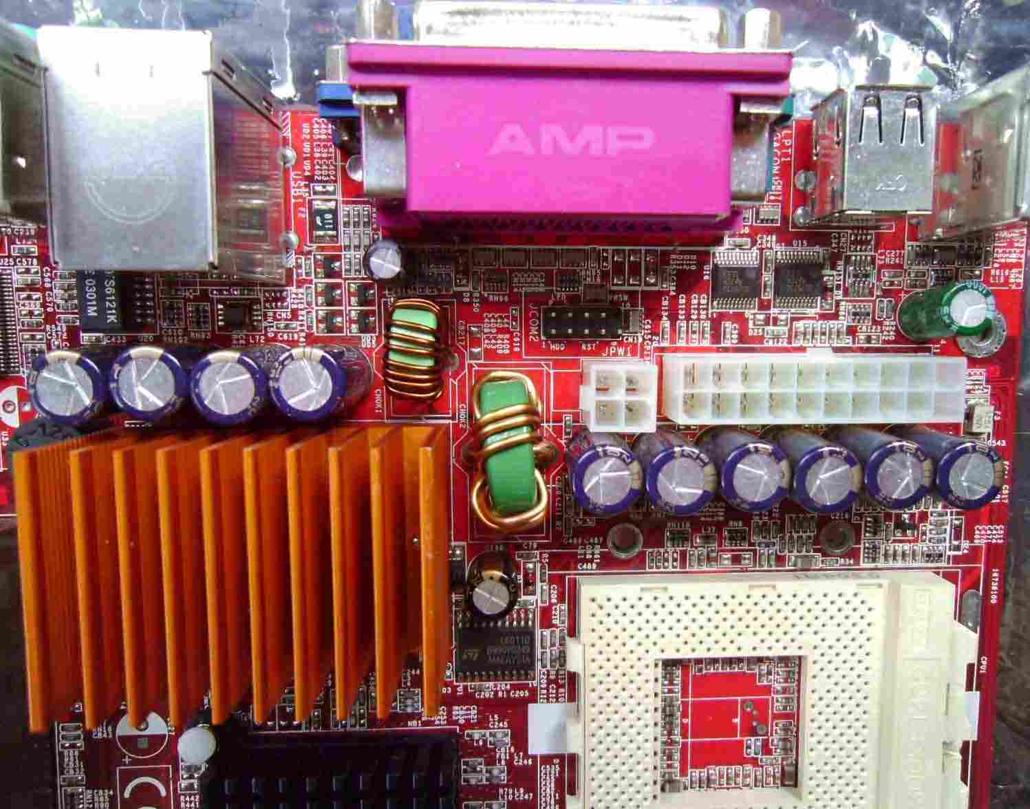

    Rubycon MBZ in the VRM, with heatsink on MOSFETs
    Chemicon KZE elsewhere, just three Teapo in lesser roles
    I got this a while ago, used, although everything looks original including soldering for all caps
    Drawback of the board is being extremely finicky about DDR
    I found if any double-sided DDR was used, whether as a pair or in conjunction with a single-sided one, there would be errors from Memtest which didn't necessarily show up in the first pass
    Wasted a lot of time testing memory, and other debugging - first XP build would consistently get windows\system32\config\system missing or corrupt on a cold start, even though it'd had one successful pass of Memtest, and disk etc. tested fine beforehand
    Was about to try SDRAM instead (it's a dual memory board) when I stumbled across its dislike of double-sided DDR

        Originally posted by larrymoencurly
        What RAM have you tried?
        Double-sided 512MB DDR400 PQI in conjunction with a single-sided 256MB DDR400 PQI
        Double-sided 512MB DDR400 Veritech in conjunction with a single-sided 256MB DDR400 Veritech
        Pair of double-sided 512MB DDR400 Kingston with Hynix chips
        Pair of double-sided 512MB DDR400 Kingmax
        Pair of double-sided 256MB DDR266 generic with Hynix chips
        All of the above have been extensively tested in other boards, without an issue
        No problems with a single-sided 512MB DDR400 Kingston in conjunction with a single-sided 512MB DDR400 Elixir, and a pair of single-sided 512MB DDR400 Starmax

            I would try a VDIMM increase. I wouldn't be surprised if it's undervolting.
