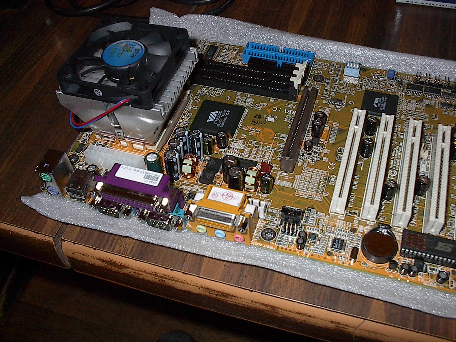

    I just bought a DFI CA64-TC Socket 370 board from Newegg, I'm pretty sure it was old stock since they don't make S370 boards anymore, do they? I needed an old board because I wanted to use an old PIII 550E and some PC133 ram I had laying around.
    Anyway, I was horrified to see that it has mostly OST caps and a few Nichicon HM's, along with a couple others I can't quite read.
    I was expecting the cheap caps, but there was still hope in my mind that they would be better than this... I'll probably be recapping the board in a few months since it runs 24/7 as a server.
    How worried should I be about the caps on this board?

    For a PIII Coppermine, it should be OK. OST are middle-of-the road, and Nichicon HMM only fails at a combination of high temp and high ripple current. However, if you're going to run it 24/7, it pays to recap it pre-emptively before putting it into service.
    On DFI boards, recap the caps next to the DIMM slots and the Northbridge first. That alone is often sufficient to restore stability.

      Thanks for the info. I'll keep a close eye on the caps for the first few months before I really trust it with important data. Ironically I'm as worried about the hard drives and power supply as I am the board.
      The system is actually running NASLite+ and is being used as a media server and also a backup device for my desktop PC's. It sits idle most of the time, and is on a shelf in a cooled and dry basement, and the case has 2 80MM fans pulling air through it. Hopefully this will extend the life of it some. Hard drive temp is about 30 degrees.
      The old system (Pentium Pro 200) kept crashing to a kernel panic after about 3 days of on-time, hopefully this one will be better. Kind of bums me out because I bought RAM and a beefier CPU with 1MB cache for the old system, and it turned out not to be reliable anyway. It was an HP Netserver E40, and I miss that big heavy case. Only thing I didn't like was it only had 2 hard drive bays.
      Here's a pic of the new board. I recognise the OST caps, I think I've seen them in pictures on this site...
