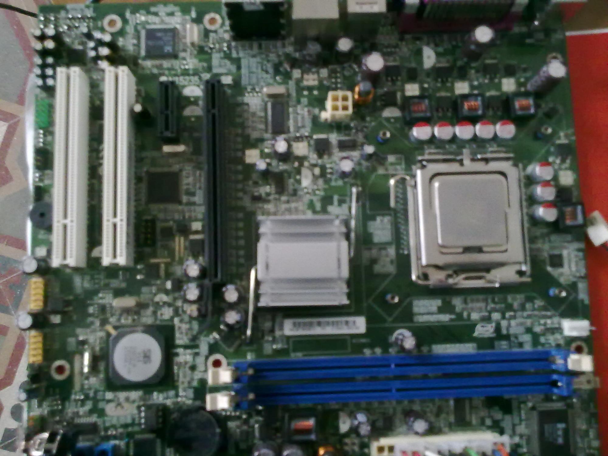

    I was given a bare bones mother board the other day and recognizing the CPU as a Intel Duo Core 4500 I decided to try and get it to boot up, I managed to get the CPU fan ruining and AGp card fan running but no post or video signal whats so ever, the key board and usb slots also seem dead. I checked all the fuses and caps on the board and all seem OK. some of the LDO's in the CPU area do not have 12 volt power going in or out!
    The attached photos are not very clear due to the weather at present, the only service manual I've found for this board was on a Chinese web site, acer only give the owner manual which is as good as tits on a bull!
    Anyhow the in the service manual they have the board hooked up to a 20 pin PSU although the board has a 24 pin slot, at present I've got it connected on 20pin but I do have a 24 pin PSU, if I connect the 4 pin 12 volt power near the CPU the board give the alarm, I think it was 4-5 long beeps and shuts down. Is it possible that he CPU is burnt or the onboard chip???

          Yes it should post with no problem using a 20 pin socket, I think there might be a short on the 12 volt rail or the video chip is fried!

            Re: Acer A90 or A290
            If the CPU or onboard chipset was dead, the board would be dead as well (i.e. fans spin and nothing else). The fact that the board beeps suggests that it's working fine but it's encountering an error during POST.
            Make sure:
            - To reset CMOS settings before doing anything else (remove battery for 20 seconds or more or use onboard jumper)
            - There's at least 1 stick of RAM in the RAM slots.
            - There's no wires or other metal objects shorting anything on the board
            - 1 or more USB ports aren't broken and the pins inside shorted
            - CPU has a heatsink on it and that the CPU fan is connected (some motherboards will shut down without a CPU fan connected or if the CPU overheats)
            - There's no bad caps or at least check if there are any caps from a brand/series known to go bad (probably best to post here what caps are on the board)
            Lastly, try a PCI video card. Also make sure your PSU is adequate to run the machine. No-name cheap PSUs can cause all sorts of random issues.
              Yes Sir, a stick of RAM made it post and identify the mobo as a Acer Aspire M1610 on the internal graphics, I tried to use a ATI Sapphire X1550 card that I've had laying around for awhile since it fits this board but it did not see it, possibly because the mobo is not grounded in a box yet. Unfortunately the mobo also came without a heat sink! for the test I have a spare P-4 sitting on the cpu.

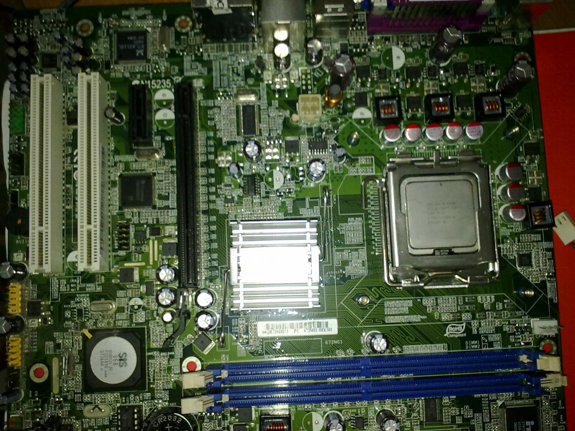

                  Well its been an interesting few days, got every thing in an ATX box and installed win 7 pro and the board runs well, did some diagnostic tests with intel which went well however this sapphire card is not detected at all, found this site on badcaps which is full of good info http://www.invisiblerobot.com/pcie_x1/ where you can cut the board or the sockett of the PCIe, I cut the socket with a soldering iron and it works, well the fan spins but the board is still not detected, I guess there a fault on the board itself. The power supply shoud be adequate 450W 24pin connector and I did update the bios to the latest version, any ideas what could be wrong with board??
                    This PCIe board is still invisible even to win xp, the caps and solder look good and GPU does not look as if it was over heated, the heat sink assembly still has the original Arctic silver coolant. I was considering reflow of the GPU but hate to destroy the board although its useless to me if the operating system does not detect it! Any thoughts out there appreciated.
                      Try that graphics card on another computer if possible. If it doesn't get detected, then you know that's the problem.

                                      I was having a random shut downs with this mobo and found the System board header connections were wrong, the shut downs are fixed but I also noticed this
                                      Pull-up(330 ohm) to 5V_SB_SYS to SIO GPIO so I connected a jumper to J4 and reinstalled the PSIe card, still no luck though! The manual is located http://www.manualowl.com/m/Acer%20Co.../Manual/114168
