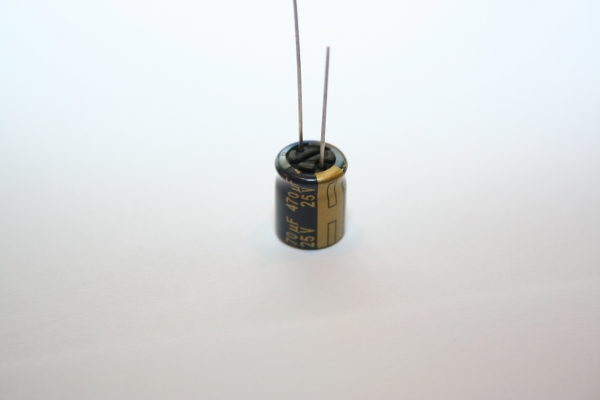

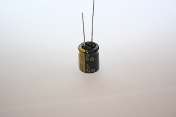

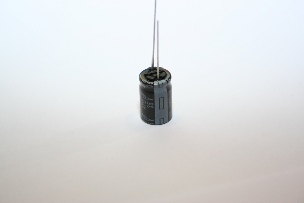

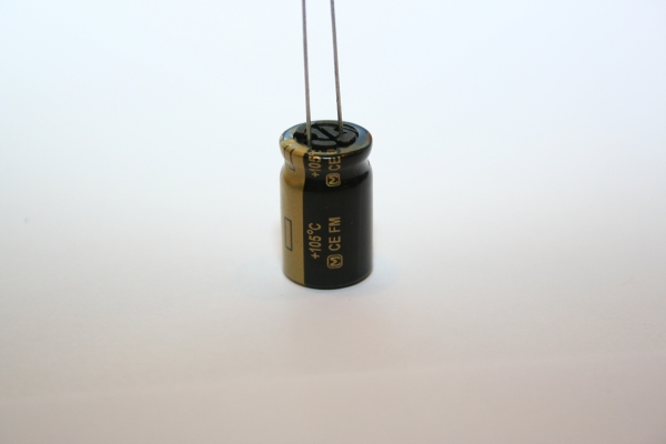

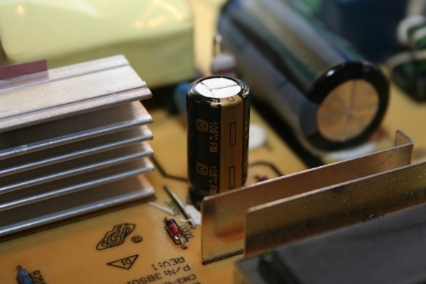

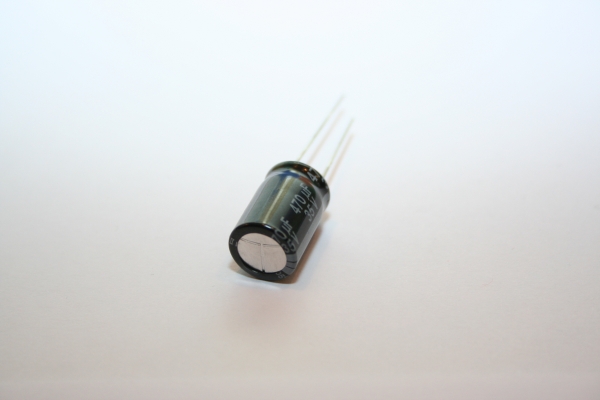

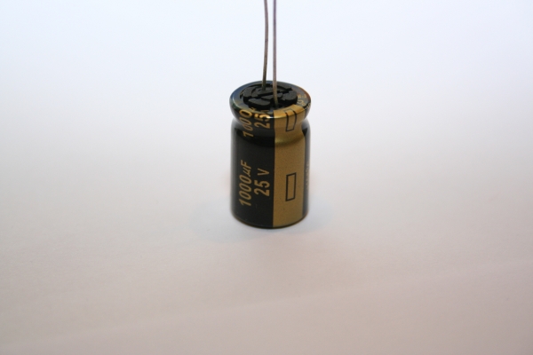

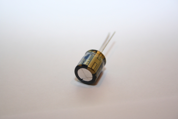

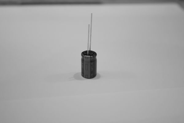

        Okay, here are the pics as promised. The last one is a pic of a capacitor that I replaced last week, I think it's a decent Panasonic version, and if so, I take it that one should be fine and not need replaced with this batch?
        Thanks again and I hope the pics are ok.
        • retiredcaps
          • Apr 2010
          • 9271
          Re: Will these capacitors be ok, or is the size difference a problem?
          White are probably FR series. Gold is FM series. Both look authentic and not counterfeit.

            The capacitors look ok. The last picture... if the top doesn't touch the metal lid when you close it, it's Ok.
            Maybe it's the camera lens or the angle, but it looks to me the main capacitor (the large one) is a bit swollen.
            These usually don't go bad and the whole board isn't very sensitive about it, but still, if it's swollen you should consider replacing it.

              Thanks again guys, put my mind at rest. So can I assume these should be ok to use? Oh by the way that is the lens playing tricks, the large capacitor is perfectly flat - I just checked it.
              EDIT - caps replaced, seems to be fine, but still have the 2 seconds to black issue, so just need to wait for the new transformer and see if it gets me back in business.
