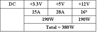

            • wij the king
              • May 2006
              • 17
              Re: Gigabyte GA-7VAXP voltage issues
              well on the one i have u can read (if i remember well):
              ______________________________
              | +3.3V | +5V | +12V |
              |_______ |__________|_________|
              | 10A | 20A | 18A |
              |_______ |_________ |_________ |
              | 190W | 190W |
              |__________________|__________|
              | 380W Total |
              |_____________________________|
              i'm sorry but amperage are probably false, but i'm sure that i've seen the two 190W and the 380W under this exact schema, i'll repost tomorrow for exact infos
              EDIT : sorry about the graph, wouldn't come out as i drawn it!!!
              • gonzo0815
                • Feb 2006
                • 1600
                Well, if that are the correct amperage rating, then you have picked a ver very old psu or an ATX 2.0 psu. Both are in no way suited for an 5v powered amd Athlon xp rig. You could be lucky that it even posts. For that kind of systems, you ned at least 25A@3.3v 25 to 30A@5v and a combined wattage on the 5&3.3v of at least 160w, better 180w to 220w if it should last long and reliable. This numbers are only for proven good brand named psu`s.
                And pls state the moddel and brand of that unit too.

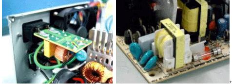

                      • hkivan
                        • Mar 2006
                        • 122
                        #31
                        How old are your PSUs?
                        Many non-brand PSUs deteriorate faster. They usually have
                        shorter life span. My delta GPS-420BA-102A has a MTBF of
                        10 0000 hrs @25C.
                        You can check your PSUs rails by a DMM, during system start up,
                        idle & full loading. If it drops below 5% , I suggest you to buy a now one.
                        The attached pictures are some normal & poor psu internals for
                        your reference.
