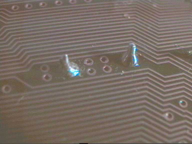

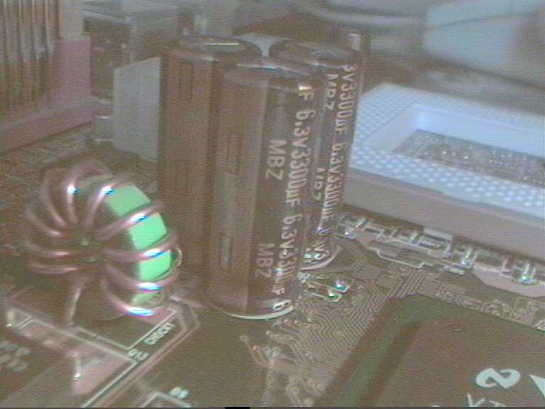

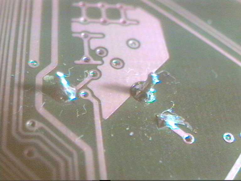

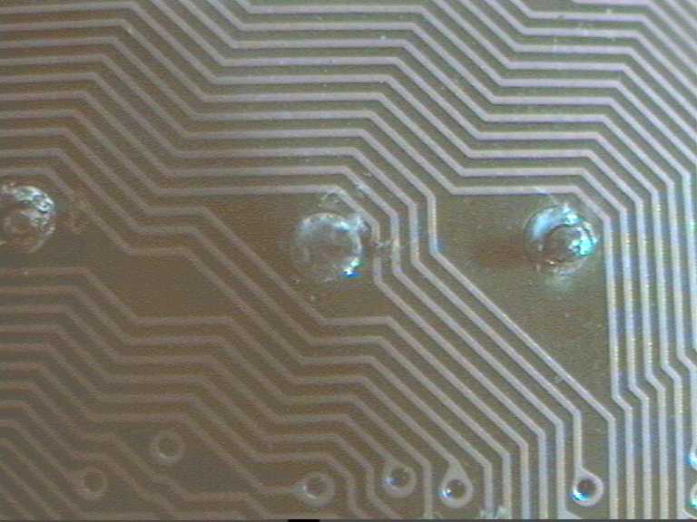

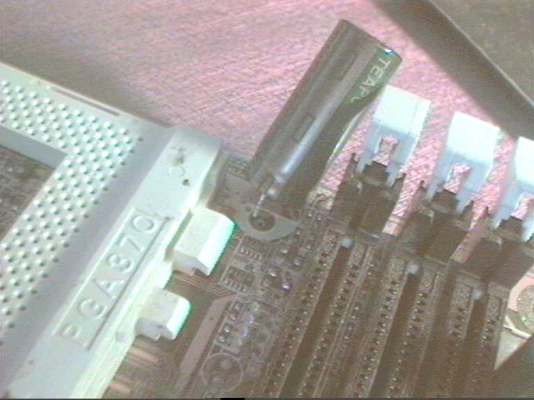

    This is MSI MS-6309. The caps were probably bad and someone did really great job replacing them...
    Two Tayeh and one Teapo - they're angled because of bad soldering (see below).

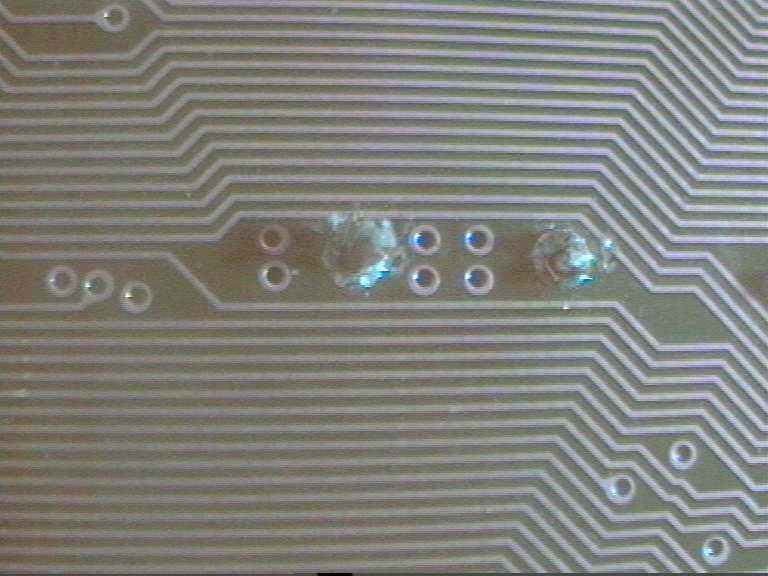

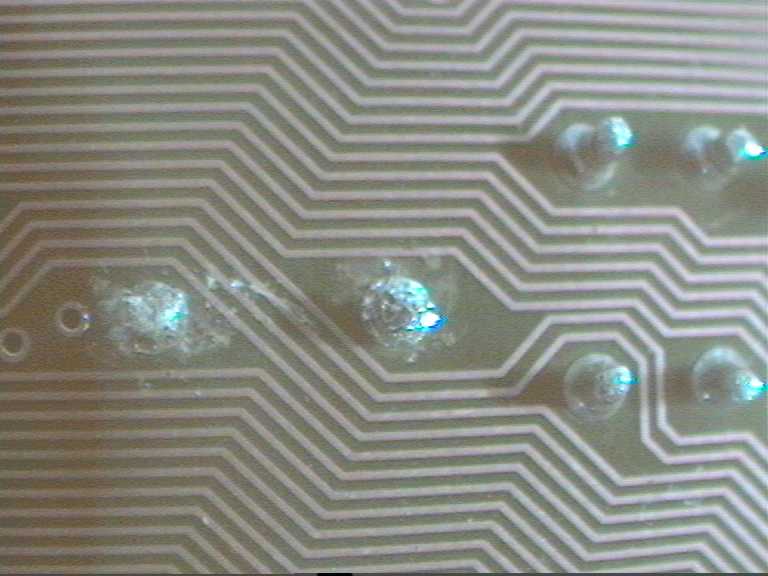

    Another Teapo, great soldering...
    Great soldering...
    Great soldering...
    More great soldering...
    And even more...
    Simply wonderful job

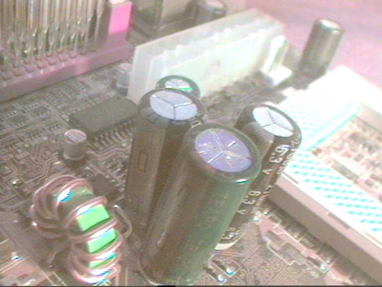

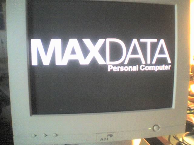

    Looks much better with Rubycons
    And soldering too.
    And it even works - oh, it's MAXDATA OEM board
    My testing CPU, RAM, HDD and CD-ROM drive

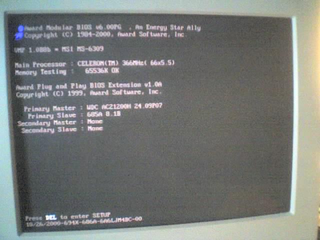

    It needs some more work - the CPU fan does not spin and I'll also try original MSI BIOS.

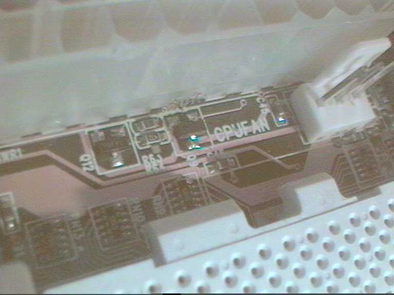

      This small SMD transistor (marked 2F which means MMBT2907A) was bad. Great place for soldering

        Interesting find Rainbow,
        Inglorious soldering aside - you're saying that someone used Tayeh to recap the board?
        Judging from personal experience and what I've seen/read, those are caps that make OST look top-notch.

          Someone probably used Tayeh and Teapo caps probably from another board. Soldering was so bad that they came out when pulled by hand. I used caps from another board too - but Rubycons Original caps were probably 2700uF.

            I'm surprised it even works at all, after that incredibly fucked-up recap. Maybe the bad SMT transistor is causing the CPUfan to not spin?

              Luckily, no traces were destroyed. CPU fan works after replacing that transistor (that black mark on the ATX connector is from soldering, not from burning transistor - it was visibly OK, just half-shorted). I also flashed original MSI BIOS and it works fine. The PCB is same as MSI original boards, only some pin connectors are missing (like additional USB).
