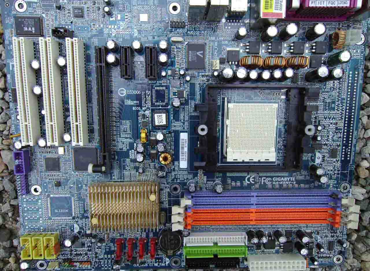

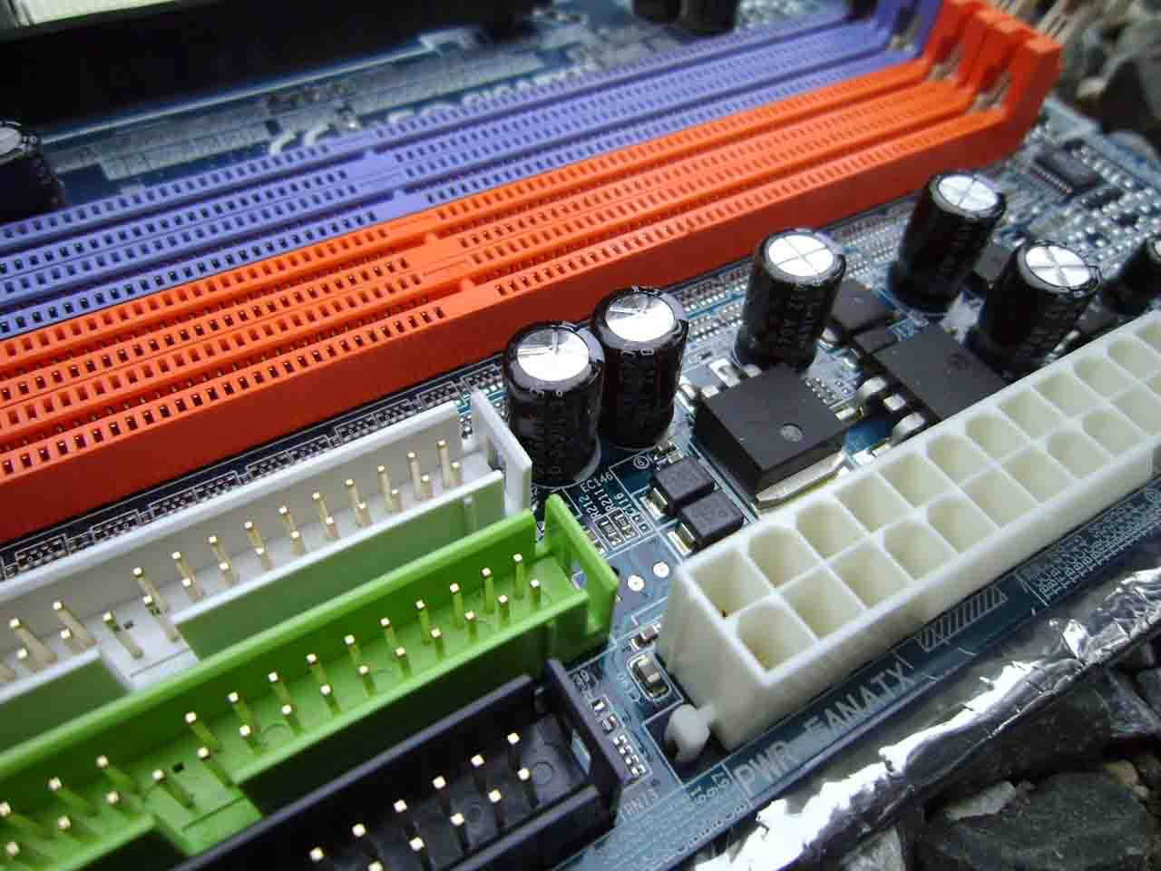

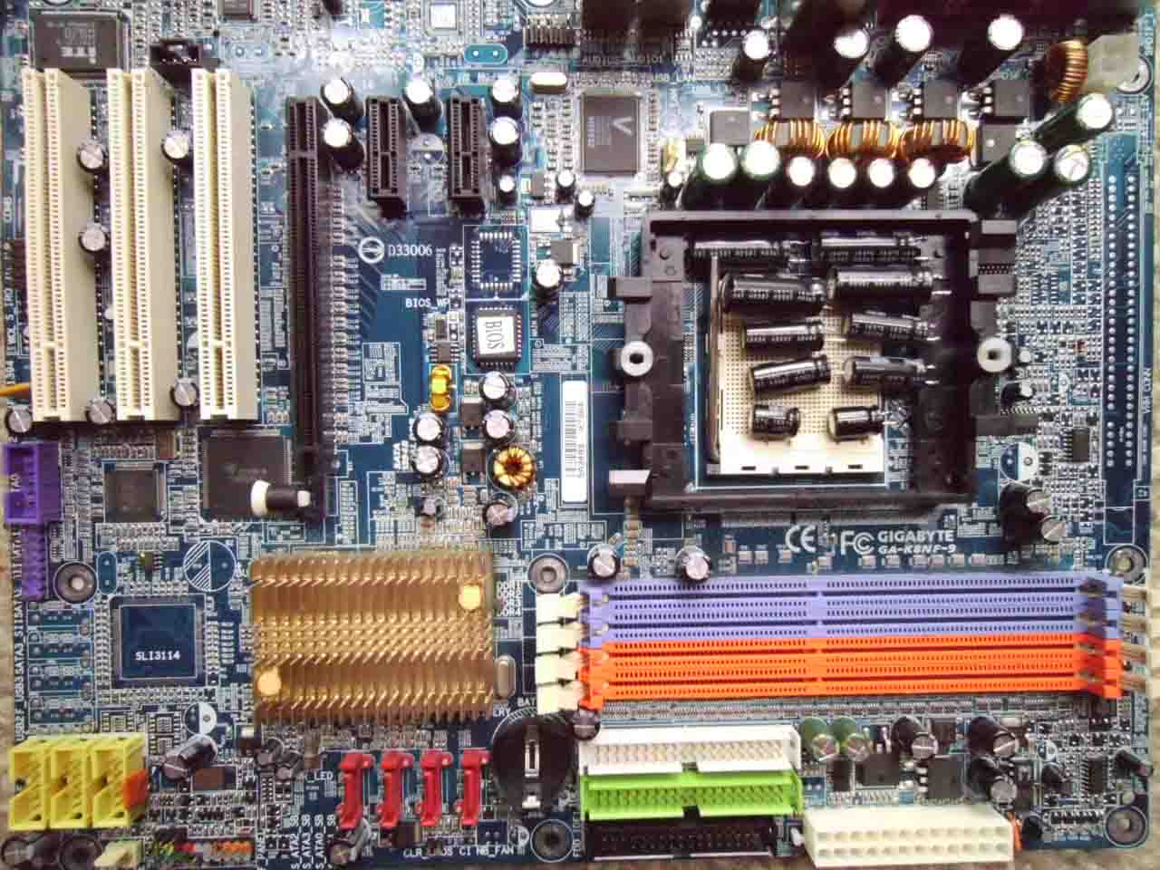

Was given this GA-K8NF-9 because of the swollen capacitors - three of four 3300uf HM in the VRM, and both 1000uf HM beside the white IDE connector
GA-K8NF-9 with bad 2005 HMs
Re: GA-K8NF-9 with bad 2005 HMs

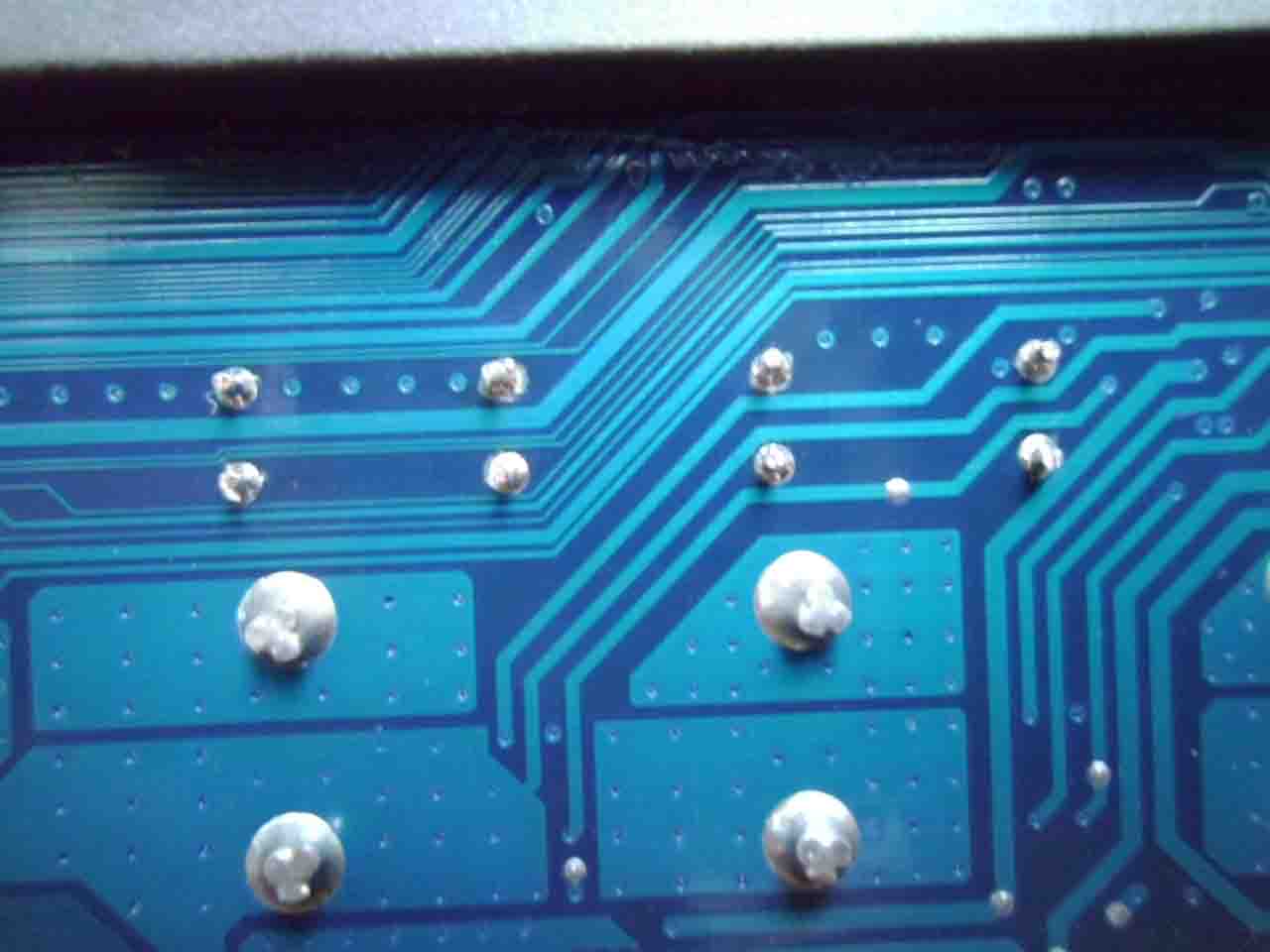

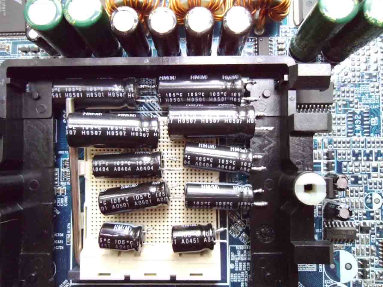

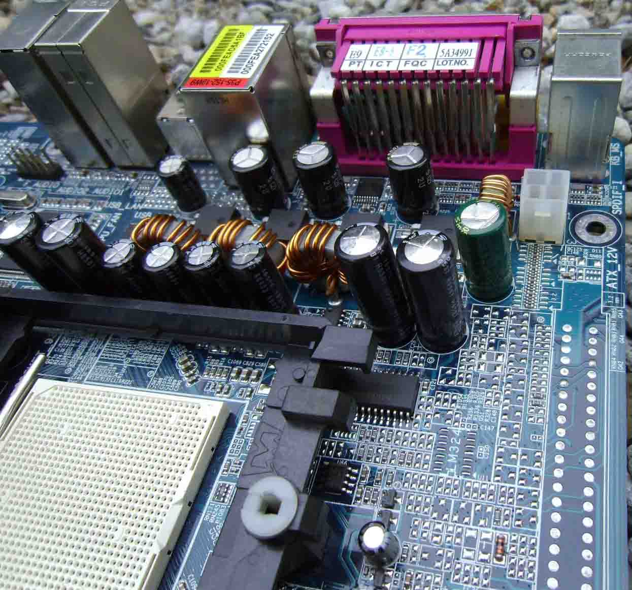

3300uf replaced by Sanyo WG - also replaced four 1500uf HM in the VRM with Panasonic FJ
The two 1000uf replaced by Suncon 1000uf
First pic shows originals sitting on the processor socket, last pic is underneath the 1500ufAttached Filesif you find these attachements useful please consider making a small donation to the site
