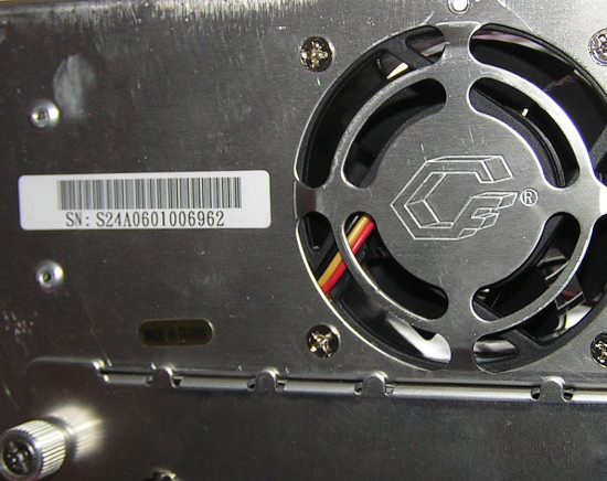

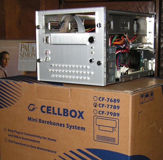

    I post this here because the case is similair to Shuttle SV24.
    I came across this site by accident but you guys are scaring me.
    Last week i was looking for something small to fit some old stuff i had lying around and bought this thing new for 100 euro's, it's a Chyang Fun CF-7789.
    The motherboard is a FV24 and it's identical to a Shuttle SV24, the housing is identical too except for the plexiglass front.
    Bought here: http://www.nowthatsit.nl/categorie.asp?categorie_id=188
    The picture is different so i took my own:

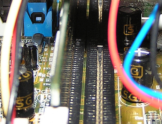

    So this thing should be new it came all wrapped and everything sealed but a few caps loop suspicious.
    Should i worry?

    is that board an official shuttle or oem for chyang fun?
    looks like the caps might have reacted in long storage. are there any more like that?

        its either used or those caps are gonna blow their tops real quick if they bulged that much with the short test.
        the bad caps are likely the cause of the "strange characters "
        recap it before it blows up.

            It's by no means unheard of for caps to go bad just by sitting in a box...
            https://www.badcaps.net/forum/showpo...88&postcount=7
            You need to recap that board to use it, contact the place you bought it from and ask them what your options are, but whatever you do do not accept a replacement, it will in all likeleyhood come with bad caps too...
            Your only option is to ask them to send you another type of board, with caps of good makes... Or recap it yourself or have someone do it for you...

                                    1) I don't think the FV24 ever supported Tualatins, only the FV25 did. AFAIK, It required a newer Northbridge revision.
                                    2) The VRM on most FV24s uses flaky 'Gloria' or similar crap-caps. It's best to recap them immediately on acquisition. If you send it back for warranty replacement, you'll most probably get another box with crap caps in it.
                                    3) Check the Channel Well PSU in these boxes for bad caps - they're usually Fuhjjyus, and the caps are physically small and installed in inaccessible places (under heat-sinks, etc.). It almost always pays to recap the PSU pre-emptively.
