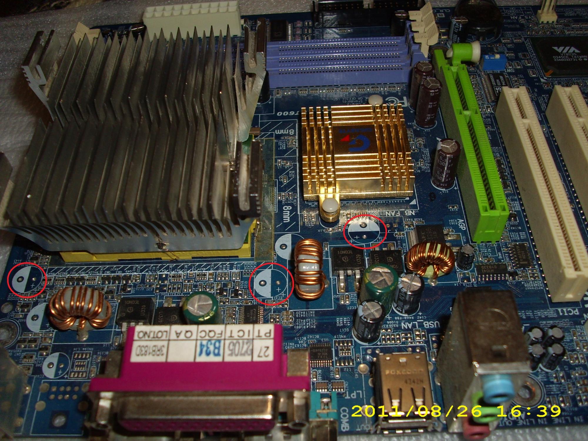

    Found this forum just a week back and it`s awesome, lots of useful stuff here and the community is just outstanding. Thanks for existing!
    I got a Gigabyte GA-7VT600 MB, salvaged from recycle bin, because I thought it was faulty.

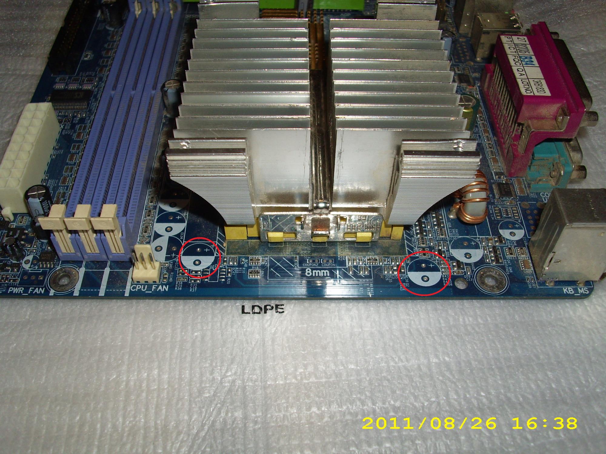

    One day I decided to test it once again and to my surprise it worked well at first glance. I`ve installed an OS, drivers and even some games. But then for unknown reason I removed it from the case to discover that it has about 4 caps(EC31,EC33,EC36,EC38) missing (didn`t noticed this when putting it in). I must admit that I didn`t stress test it, but it seems to work just fine.
    So here are my questions to you guys:
    1. How is it possible to work fine under those circumstances? You can see that those caps missing are around CPU.
    2. What caps are needed since I believe that it won`t last long before it dies without those caps?
    3. The only problem I encountered when installing drivers was that there was no sound was coming from speaker out hole (green one) but oddly enough the driver "sense" when a jack is plugged in. If set to emulated 5.1 speakers, there is still no sound on the green hole, but the blue one (line out) which acts as the back speakers has. Could the missing caps cause this problem too ?
    On another note, I suspect that there are another two caps missing(see pic #2, rectangle shape) but I can`t be sure since there is no resin left like the other 4.
    Any feedback will be appreciated, guys! Thanks!

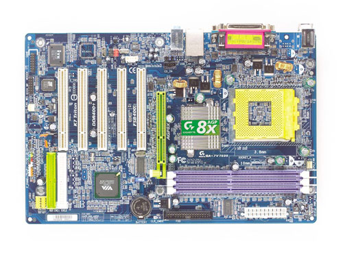

    See this: https://www.badcaps.net/forum/showthread.php?t=11645
    See the original mb picture, with caps missing by default: http://www.gigabyte.com/fileupload/p...2/1666/301.jpg
    This article shows more pics with the caps missing by default: http://www.neoseeker.com/Articles/Ha...-7VT600/3.html
    You can get a clue about the values from this article - zoom the picture and do a negative or something: http://www.pcstats.com/articleview.cfm?articleID=1597
    I can read from that OST RLX 105C and on the left there's 2300uF (or 2200/3300?) 6.3v and the ones on the right are about the same height and diameter, so if i were to guess i'd say the same values.
    This article for the -L variant which should be about the same in the cpu area ( http://www.mbreview.com/mbr-reviews/...l.html?start=2 ) says 3300uF near the heatsink:

      Those are all 3300Uf 6.3v 105C caps. You probably used them to repair another board.

          I have that same motherboard in my hands right now, I got it working but later it stopped. I did replace one cap with a ruby, and actually took one off for another board. I'm thinking the KZG's next to the northbridge to to blame here
          those are 6.3 3300

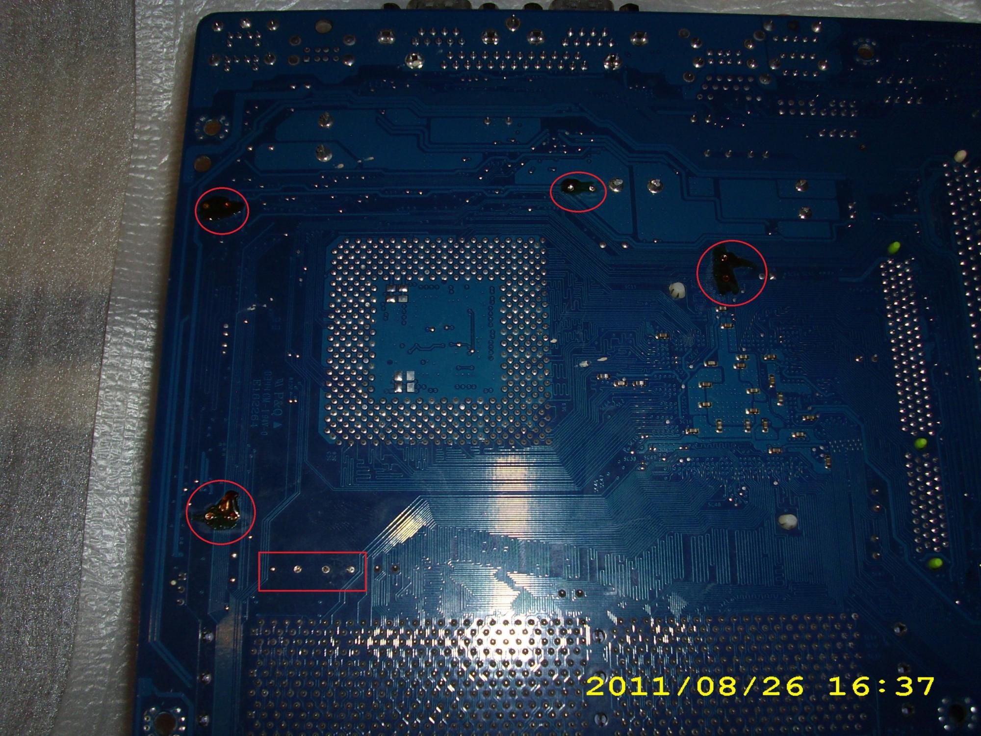

                PCBONEZ-did you look at all the pictures? flux in place of missing caps pretty much indicates they were taken out
                come to think of it, not having those caps might burn your vrm/cpu, so that might be why its
                those questionable ones without flux and have soft solder do have one cap, but one shows as a blank spot with no cap
                EC32 is another 3300 6.3. EC37/EC34 have no caps. EC2 (in the same line) has a 6.3 1500.
                dont' run this motherboard without replacing these caps, it might work right now, but eventually kill your power regs
                I replaced the KGZ's with rubys, and the 3300's with pannys, still does not post. this board is dead.
