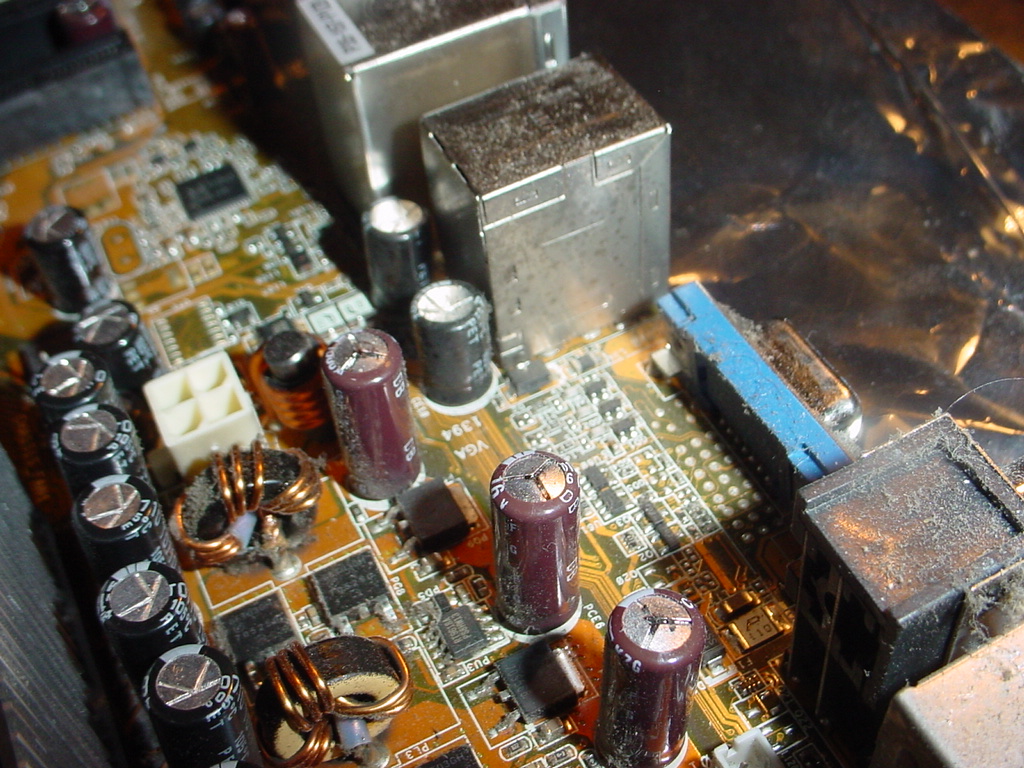

    so, I got this HP 4400+ am2 to fix. It overheats, and turns off. cpuid shows volts at 1.68, I think this isn't accurate...
    anyways, I run prime95 and the temp skyrockets, 70..80, fan spins up high, temp raises, and it finally turns off a second or so later. Arctic silver'd by another one of her friends, so I know it isn't a thermal transfer issue
    had bad KGZ's, which I replaced with pannys, still does the same thing, put good PSU in it, still does the same thing. Put a 4200+ in there I had lying around and the temp regulates properly, maximum 74c under prime95 highest stress load
    sooo, did the caps cause the thermal diode or a thermal regulator on the chip to...die? but other then overheating, the there is no other signs of instability, even with the bad caps
    bad caps attached

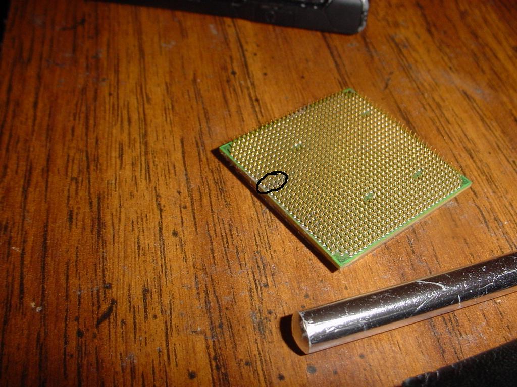

    here is a pic of the CPU. there are some brown pins

      I cannot find the datasheets with the relevant information on AMD's site (unlike Intel) but 1.68V is very high! Specification for vcore is ~1.4V. Use a voltmeter on the VRM output to determine the true voltage. 74c is also very high for that processor (again, AMD documentation is somewhat lacking in terms of "absolute maximum ratings" and the like). The 4200+ runs at a slightly lower frequency so it may still be getting overvolted but is not heating up as much.

              so, do you think the voltage regs on the motherboard have gone south?
              • PCBONEZ
                Grumpy Old Fart
                • Aug 2005
                • 10661
                Re: Athlon X2 AM2 volt/cap damage = overheat?
                Either that or you've lost a VID signal or the controller is bad or the voltage reading is bogus.
                VID signal is something like 5 or 7 'lines' that latch high or low to tell the controller what voltage to set Vcore at.
                A blown or missing SMD resistor would be enough to muck that up.
                Check the voltages with a meter.
                The on-board sensors are usually cheap parts.

                      Try it in another motherboard, preferably one you can live without if it is damaged further (one with a blown network interface or similar not relevant for this test damage). Get straight into the BIOS and watch the temperature. If it rises as before then the chip is fried, if not, there is a problem with the other motherboard. I have never seen a CPU break so that it overheats, but it is certainly within the realm of possibility. The brown spot would be consistent with a regional CPU failure. But not definitive, look at the first motherboard and see if there are any smoked components underneath that part of the chip. (Not sure if that is possible with this CPU, it was with the Athlon XP).
