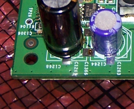

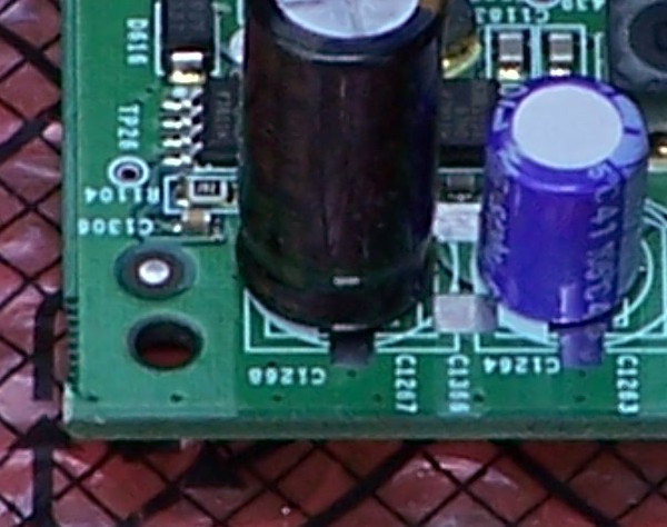

Leadtek Winfast A250 with bulging caps

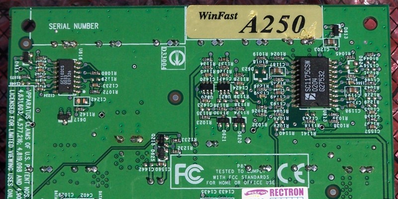

    I agrree, if you fell better you can easily remove that flux with any alcohol and a thootbrush. If yióu can do ne pic`s with flux removed we can better se how the soldering is done. The flux makes this on digital photos nearly imposssible, as it is looking similar to bad solder joints.
    But again for 50 bux i think they should have at least replaced all caps with good ones. But anyway, if i compared it with Germans profesionals, most won`t do that fo that price and if i wouldn`t expect better work. In fact, as far as i have the time and the information i try to repair as mutch as possible for my self. The average cost for one labor h for an wasching maschine repair service are usually at 60 to 70€ here in Germany. So you se there are not mutch about profesionall cap replacement wich needs far more skills in Germay.
      Re: Leadtek Winfast A250 with bulging caps

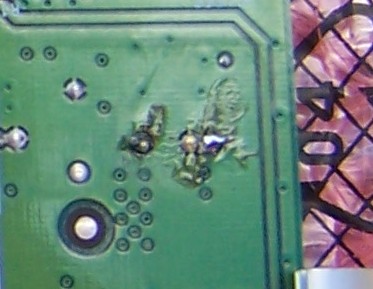

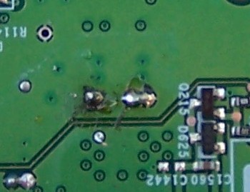

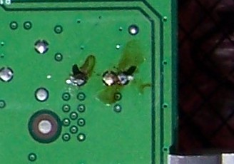

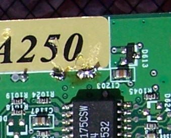

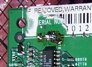

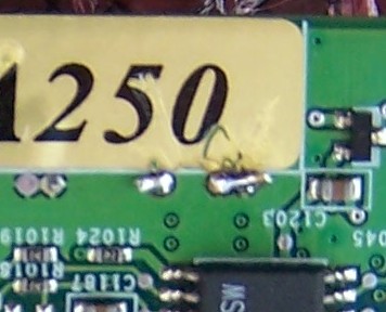

      Good calls guys, the camera flash is intent on reflecting off everything so my previous pic isn't really representative of what the card actually looks like to hold in your hand. The areas davmax identified as splattered, they are not covered with silver material but a glossy dark matter that I'm guessing is the flux. The biggest area of this, near/under the warranty sticker, is lumpy as well, I thought initially the board might be charred but it's probably just trapped dirt.

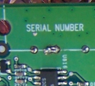

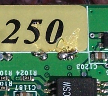

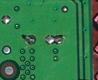

      I tried some more photography; the following pairs of images are cropped from the two best pics (which were outdoors under full sunlight and shade respectively). I hope these can give a clearer idea.
      1a | 1b
      2a | 2b
      3a | 3b
      4a | 4b
        Solder job sucks period. Pic 1b looks like green coat is blistered and burnt. I would be worried if it was 4 layer board. It will look much better after you clean off the flux, though. I use isopropyl and q tips, then blow off fuzzy left by the q tips.

          I think this gay had have some Power problems with his normal Soldering station and used an normal cheapo 80w Iron to get the job done.
          looking at that soldering i think the typo is perhaps not a typo

            I didn't want to say anything about it to avoid 'hijacking' the thread - but you have had some atrocious luck, spaced-out. I'm hardly a professional electronician (not a real word, NB) myself, but even my younger kid has been able to do cleaner soldering jobs than that. Factor in the $50, and the fact that he successfully used your card to 'blow something up'...

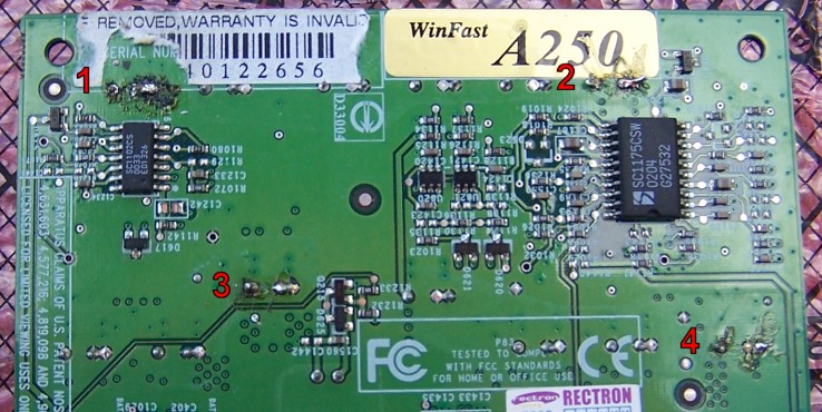

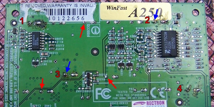

              Thanks for detail pics. Yes the soldering is real bad. Yes the board surface looks burnt. The real concern is that who ever did the job has risked a short circuit. I have marked up your picture with arrows. The red arrows point out the vias(solder points) that are surrounded by a copper plane, there is a small insulating ring around each via that must be maintained. The blue arrows point to the bad soldering that appears to place the insulating ring at risk, 2 and 3 do not appear to have any insulating ring left. If the ring is bridged there will be a short circuit.
              Check it out.

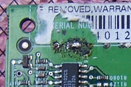

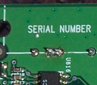

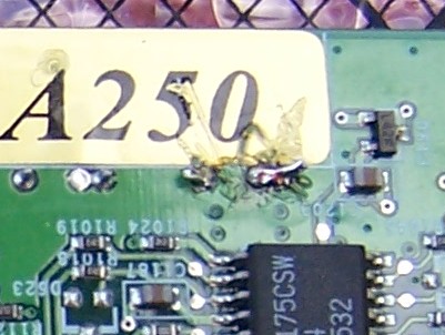

                  Well the good news is that it scrubbed up a treat, and revealed that there seems to be no scorching of the actual board.
                  I used Isocol 70% isopropyl rubbing alcohol (it smelled "friendlier" than methylated spirits, lol ) and cleaned the board using paper towel, cotton buds, and tissue gripped in and wrapped around needlenose pliers where I needed more precision. All up it took me some 90+ minutes of patient effort to finish.
                  Detail "after" pics:
                  1a | 1b
                  2a | 2b
                  3a | 3b
                  4a | 4b
                  Spots on top of the board by the "1" capacitor as well: before | after
                  The 2, 3, and 4 solder point pairs cleaned fairly easily, and the same for peeling off the warranty sticker (seems a bit redundant now ) and cleaning off the sticky residue. The soldering looks clean, I can only make out some silver flecks nearby the single via of 4.
                  That first soldered cap was clearly a complete disaster though, the mess adhered to the board was coming off in black lumps and particles. It was a bit like cleaning road tar off a car... ended up resorting to gently scraping with the back of a scapel blade to encourage it to dislodge.
                  ...2 and 3 do not appear to have any insulating ring left. If the ring is bridged there will be a short circuit.
                  Mate, you're doing well to pick that out without being able to inspect the board first-hand. Looking at it myself I think you are right but at least they seem to be just within tolerance. I'm sure I would've struggled if I'd elected to do it myself.

                      Huh, I wonder how I managed to do that. Thanks for pointing that out.
                      1a | 1b | flipside before | flipside after
                      2a | 2b
                      3a | 3b
                      4a | 4b
