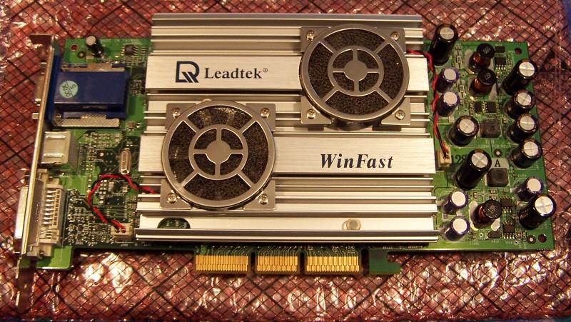

    Leadtek Winfast A250 with bulging caps
    Hi, excellent site you have here. I read an article about the "great capacitor caper" in Australian PC User magazine a few months ago, they included a reference to this site and here I now am.

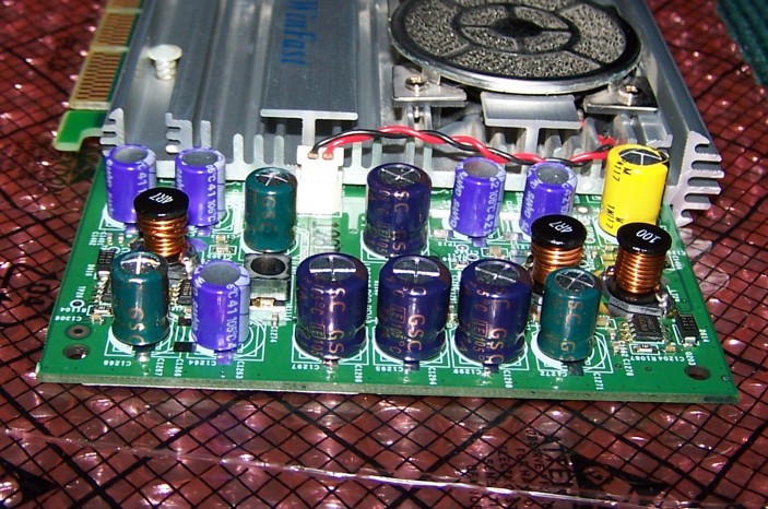

    As subject line, I have a Leadtek Winfast A250 TD (GeForce Ti4400) AGP card with visibly bulging caps. Have had the card for going on four years now and it's never given any trouble operationally, but just pulled it out recently when I upgraded to 6800GT (which is itself not running 100% right but that's another story) and saw this.
    Check out the three green guys (yep... GSCs ), they are all bulging to different extents but the one front and left is most pronounced and has a bit of orange-brown, what I suppose is leakage, on the top as well.
    Now stupid question time: most of what I've read on this site takes the approach of: computer not running right -> see failed capacitors = you have a problem. Now this card was running absolutely fine at last notice... but if the caps are showing physical signs like this, then they are definitely going to fail? I should get them replaced I want to continue using this card for the long haul? I've already spoken to a local guy who I use for servicing and repairs to see if he could replace them for me, and it sounded like he could, but he basically said it wasn't worthwhile and that the expansion is only caused by heat, they would still be sealed (this was only on the phone though, he hasn't seen it). Should I really keep using the card in this state, and only worry about it when/if it starts showing operating problems (or blows up)?
    The card was/is destined to go in a PC I'm putting together using other contemporary components I had spare, which I otherwise intended to run till the end of time... goodness knows I still have a 200MHz Windows 95 PC going here

    Yeah, the GSCs will definitely fail sooner or later, even if they're not bulging. It's not too much effort to replace all seven of the GSCs - you'll get a card that's good for another 5 years at least, after a recap with good brands.

        you could do the job yourself, it will not be difficult at all. If you do decide to use the services of the repair guy make sure he uses good quality low esr caps.
        he basically said it wasn't worthwhile and that the expansion is only caused by heat they would still be sealed
        thats just plain wrong. they will degrade further and burst in time. on the card you have oscons and a fujitsu. so if you replace the GSC caps with good quality ones the card should be fine until it is obsolete.
        as to why the card is still working fine, who knows the real reason, perhaps one or several of the following :
        - the card is reasonably tolerant of bad power
        - the mobo is supplying good power via the agp
        - the other caps on the card are doing their job
        is that the original fan on the card still working fine? leadtek must use quality fans.

              For edification I measured and noted down all the details printed on the GSC caps.
              3x Green: 8mm dia.
              GSC | [RF] 105°C | T23A
              1000uF | 6.3V
              4x Purple: 10mm dia.
              GSC | [LE] 105°C | T21A
              470uF | 16V
              There is also one more little one at the bracket end of the card (not shown in my photo), it has no X crease on top... I read somewhere here the little ones don't die, so this one would not be a candidate for replacing?
              1x Black: 6mm dia.
              GSC | 105°C | T1NA
              330uF | 6.3V
              Pending getting the parts, I'm about 50-50 whether I'll attempt recapping it myself... I don't think I have the right tools for it. The scale of the electronics on the card look far too small for the soldering iron we've got here.

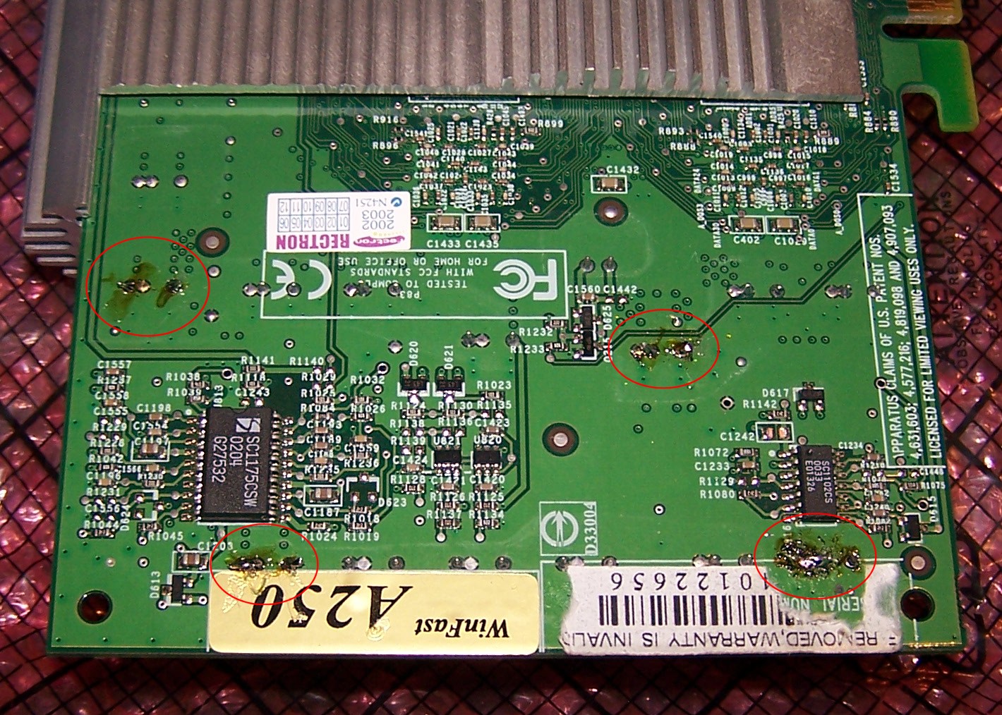

                      Hi guys, posting an update, having just got the board back from having those bad caps replaced. (Sorry davmax, you're a bit late )
                      Last week I took it to my local Jaycar outlet (Westend Electronics) and asked them if they had the components and could service the board, they said they could... although none of the staff I talked to handled that kind of thing themselves, it had to go to their 'technician'. I explained the board was working fine at last blush, but the visible signs were that it was on the way out, and left instructions to "replace all GSC caps and any bulging ones" (as the staff guy transcribed it on the job sheet) with high-quality components. The guy who served me could not give me a quote on how much it might cost but reckoned it would "probably" not be much.
                      Well... he lied, I was told on picking it up it was a "double-soldered board" that made removing and replacing the caps much more difficult than expected, which made the labour cost over AU$50! That being case made me think it was probably a good thing I didn't try it myself, but still I didn't expect to spend that much. Maybe someone here can shed light on what a double-soldered board means for me?
                      Now, what can anyone tell me about "Hitano" caps?
                      He has used three 10V/1000uF Hitano in place of the green 6.3V/1000uF GSC caps that were showing physical failure.
                      He has also replaced the yellow Fujitsu cap that was on there with a 16V/820uF Hitano, and left the four purple 16V/470uF GSCs in place; neither of which was what I asked for, but oh well. Maybe the Fujitsu was failing and I didn't notice; maybe the remaining GSCs are going to hold out. At any rate if it's going to cost so much I'll wait and see how it goes first.
                      Unfortunately they also told me they couldn't test the card: the technician didn't have anything powerful enough (in fact apparently he tried to test with something and blew it up). So they couldn't say that it works, but they're fairly sure it should. At least if I have any trouble I can bring it back to them.
                      Anyway at the end of that, for Jeff my advice would be that it's worth at least checking out if you can get any replacements, the caps are really cheap... it's just getting them on there that's the problem. Based on my experience be careful about paying someone else to do it, but as long as you can live without the card in case you mess up, it's only going to die anyway so you can't do any harm in trying...

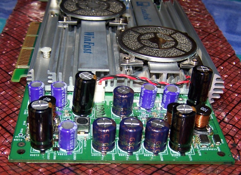

                          Yes, I got the card into the comp the other day and it ran splendidly. So out of pocket regardless, I'm happy.
                          Pics of the recapped board are attached. The replacement caps are almost twice as tall as the originals, but I have plenty of space in my case so it's not a problem for crowding. I wonder what you guys think of the soldering work though, as it does not appear very tidy to me - not that I can attest I might've done any better at it myself. As for the something blowing up comment, that was just what the woman said and she didn't give me any details but it looks like things are a-ok...

                            Yes the soldering work on the board is bad. You are lucky it works. That whole exercise gives eveidence of an unskilled tech who repaired it.

                              This is what it should look like.

                                If they don`t short the card, this soldering is ok. Clearly, an Profesionall should do better especially for 50 bucks, but anyway, most of that loking bad is the flux. And Elektronic flux is alway non korosive. So you can leave it. I think this gay had have some Power problems with his normal Soldering station and used an normal cheapo 80w Iron to get the job done. With such an iron you can`t do it better. I had the same problems and used an cheap 80w iron too. If you can solder, you can do it with almost every iron. Just the result isn`t that loking fine as with more adequat equipment. And the flux is needed to avoid shorting the lands.

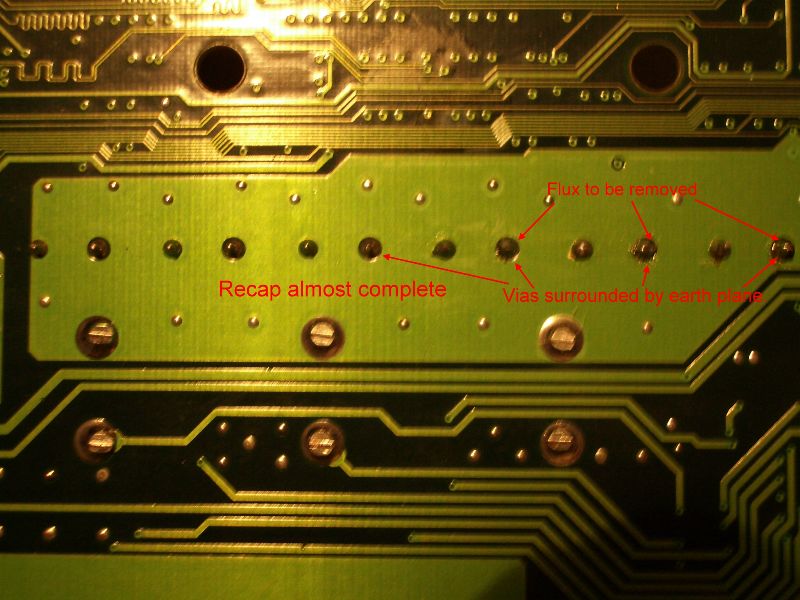

                                  So you think it is right to leave it? I was looking at the cleaning directions with a view to tackling it (toothbrush and methylated spirits I can do) but if it's doing no more harm than just looking unsightly...
                                  So I'm clear on this. Flux is that dark translucent, kind of glazed-appearance matter splashed around the solder points? Sorry to drag on, but I'm learning as I go here...

                                    You can remove all the flux with a piece of absorbent paper towel and some isopropyl (rubbing) alcohol. You can also use 409 household cleaner, if it is greasy flux mixed with salty residue. For difficult cases, use Carburettor cleaner - it's volatile and can cause headaches, so you need to use it outdoors.

                                      BTW, the soldering *is* messy - the beads should be much smoother and more compact for professional hand-soldering. But if it works, leave it alone for now - you can clean up the soldering if it fails again later. That's still a possibility, since there are still 4 GSCs left on the board.

                                        The main issue is that the card works.
                                        The two soldering jobs to the right of the picture look as though the solder is splattered. Are you able to select these areas as pictures so that there is more resolution for us to inspect?
                                        Or can you see solder splattering that you can confirm?
                                        If more caps need replacing seeking a better repairer.
