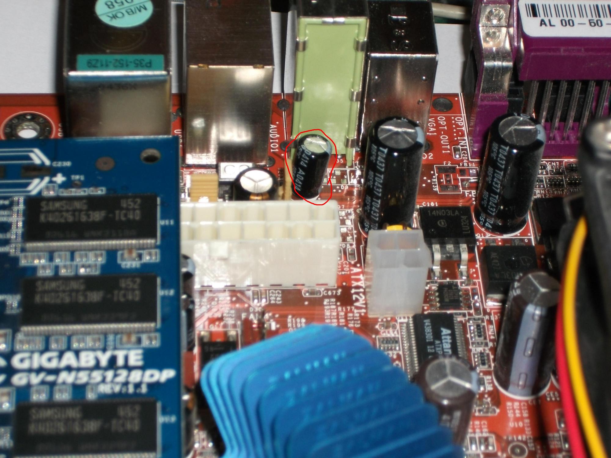

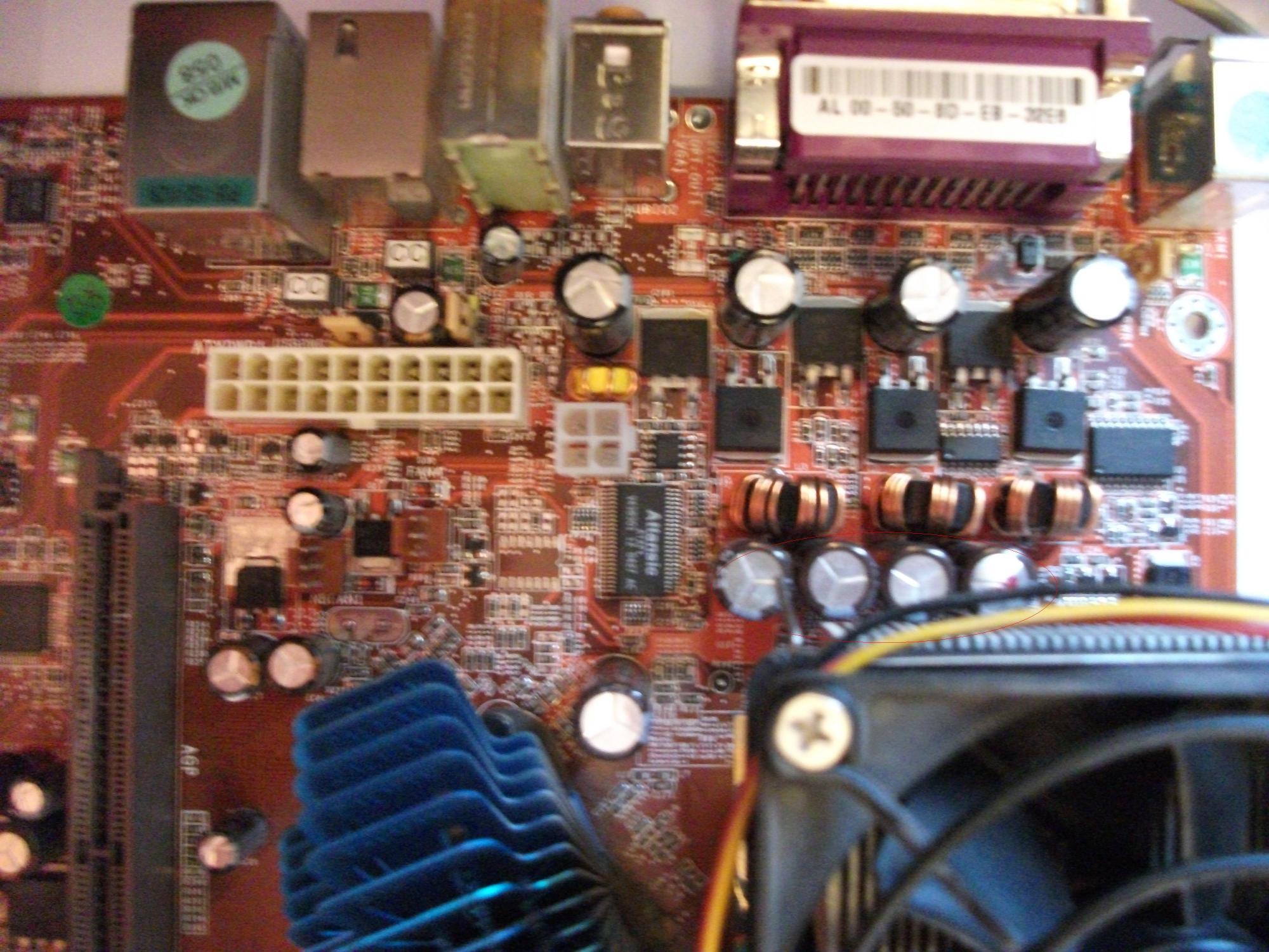

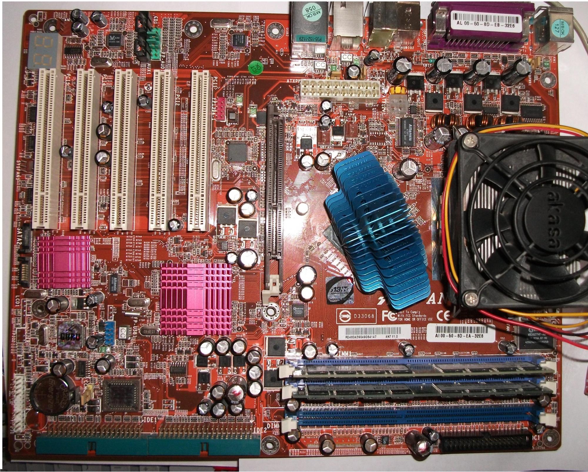

    Hi, I have a Abit AN7 with badcaps. I am not sure if I should do a full recap or just recap the bulging and the same make/series as the bulging ones or as well recap the 1000uf and above?
    One beside IDE2 port (6.3v 3300uF KZG) and another beside floppy port (6.3v 2200uF KZG).
    One Bulging beside cpu. (6.3v 3300uF KZG)
    Not sure if its a badcap or its been knocked?
    Its a Rubycon YXG.
    Caps on Motherboard
    Volts uF
    6.3 3300 KZG
    6.3 2200 KZG
    6.3 1000 TMZ
    6.3 1800 MBZ RUBY
    25 100 YXG RUBY
    16 1200 ZL RUBY
    Thankyou

    Replace all but the rubycons. Chemi-con KZG, KZJ and TM_ series are unreliable and will often fail with no visible signs.
      Re: Abit AN7 Badcaps
      To add to that, replace them with something other than KZG, which will just fail again. I'm not sure what all is available in the UK, perhaps someone else can chime in with that info.
      As for the crooked Rubycon, it was either knocked or soldered in crooked from the factory. If it was knocked, replace it. If it was soldered in crooked, there's no cause for concern.

        Unless I was really stuck I wouldn't be wasting money buying more KZG. Where the rubycon is, its in a place where i think it would be hard to knock. One way it could of been knock is changing a jumper for I think keeping the power to usb ports when system is off. I could change it to be safe.
        The caps I can get is Rubycon ZL and Panasonic FC/FM.
        Thankyou
