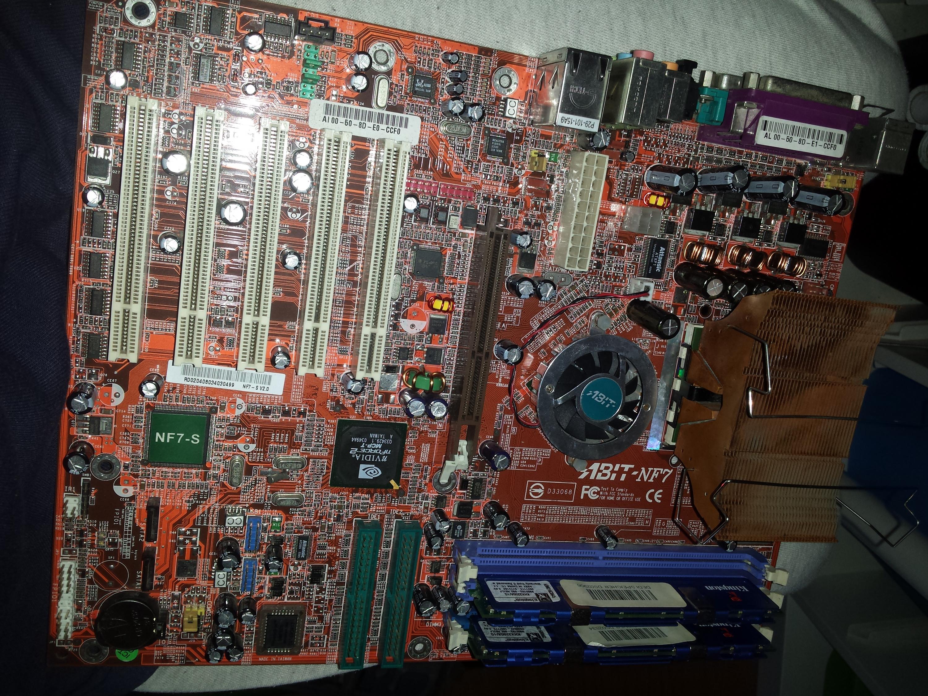

    Hy everyone,
    New around here but I've been reading a lot from several threads around here.
    I have between hands an old Abit mobo, the NF7-S v2. It was working until a few years ago, but then started to start-up only sometimes and now doesnt start up at all.
    The red light comes on with the PSU connected and the green light comes on too when i turn it on but no joy, it doesnt POST, no beeps, just the green led comes ON.
    I've tried changing 5 capacitors so far, 5x Rubycoon 6.3V 3300uF that are around the CPU, no joy, same thing, no POST and green light comeing ON, no BEEPs
    Now I don't mind to spend a few more $$ in capacitors but I really don't know where to go now, the board have lots of capacitors around.
    Is there any other that i should replace? I was thinking in the Nichcon that lays near the AGP port, 6.3V 1800uF, but what else? Thanks!

    Re: Abit NF7-S v2 Recap - Not posting
    im afraid u need to show us pics of the board so we know whats bad and whats not. or else we may end up fixing things that arent really broken like the rubycon caps around the cpu and it doesnt solve or change the problem and becomes a waste of time, effort and energy.
    the nichicon cap at the agp slot may also be problematic if it has 2002-2005 datecodes and its a hm, hn or hz series capacitor. also check to make sure the psu is working on another machine. could also be a bad psu not starting up the motherboard properly and we need to rule that out.
      Hy ChaosLegionnaire!
      Thanks for the inputs.
      Unfortunally I already started doing the recap work, I already swapped those 5 capacitors.
      I've attached the nichicon cap photo, is a HM(M) series and the top of it doesnt seem to be as flat as it should be.
      Should I give it a go just for this one or should I try another one?
      The PSU is okay, I've tried it on an old PC I have around but i cant test the DRAM power port because the old board where Ive tested the PSU doesnt need this extra power supply to the memory.
      Ive attached an actual photo of my MOBO. (the nichicon is not there, Ive desolder it because it doesnt seem ok on the top as shown in the photo).
      Thanks!
        yeah that nichicon hm is bad. replace it with a panasonic fr 1800uF 6.3v 10x16mm. im ass-u-ming that nichicon hm is 10x16 in size?
        also what caps did u use as replacements for the cpu vrm? they look dodgy. make sure they are the ultra-low or very low esr type or they wont work!
        it could also be that the nvidia shitset is on its way out. nvidia boards are known for dying slowly after a while which is what u experienced. but nf2 chips are known to be slightly more robust unless... did the chipset fan fail? i know abit sometimes put shitty chipset fans on their boards. my abit ic7-g p4 board is one example!
              u used jackcon?! do note that jackcon is considered a bad cap brand here according to the bad caps list so u just replaced bad stuff with more bad stuff.
              regarding the rubycon mbz around the cpu, i strongly suggest u solder them back on since that wasnt the problem. the jackcon wont last and will fail even without use and they may kill the motherboard when they go. u have been warned regarding the use of bad caps on motherboards!
                    Originally posted by tomalamix View Post
                    Do you think with those capacitors, even if I use this PC from time to time it's worth to take all out and change those again? And swap the AGP one with the suggested Panasonic? It will take hours doing all that again...
                    Yes, you should swap out those Junk-con caps regardless of how often the board is used. Many cheap caps can fail even if they are just sitting on the shelf. A lot of them simply have unstable electrolyte or impure aluminum that eventually leads to breakdown leakage.
                    If you still haven't thrown away the old Rubycon caps from around the CPU, you should put those back in as they are still probably good. I think Abit used Rubycon for the CPU VRM almost exclusively on most of their boards, so you're unlikely to find those fail.
                    Really probably only that Nichicon HM cap needed replacing. And perhaps the chipset fan/heatsink too. Rather than replace the fan only, I think it may be cheaper to just replace the whole cooler. Here's one option:
