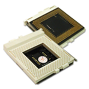

                                    Re: BF6 Mosfets
                                    http://www.hardwarecooling.com/produ...ket_370_FC-PGA
                                    Thanks for the replies guys. Here is the type of adptor I am talking about.
                                    Adapts Socket 370 motherboards made for FC-PGA processors for use with FC-PGA2 (Tualatin) processors
                                    http://hardware.mcse.ms/message195198.html
                                    In reference to the D815EEA:
                                    the Tualatin adaptor (Upgradeware and Powerleap) have both been tested to work on this motherboard using BIOS P10, which I have.
                                    (I have yet to verify this experimnetally)
                                    The adaptors do have some circuitry so I think that they must adjust the voltage down for the Tualatin core - otherwise what possible use are they?
                                    My general concern is with Rainbows statement:
                                    It's easy - that board is not designed for Tualatin CPUs, there are only two MOSFETs for CPU power so they get hot when the current draw is high.
                                    After reading this, my concern is not that the motherboard bus voltages may stress the processor, rather the opposite: that the demands of the processor might stress the motherboard. Shoud I be comncerned about this and how can I determine whether the D815 has the necessary hardware to supply the Tualatin? Do Tualatin boards have more FETs than copermine boards?
                                    P.S.
                                    Asus P2B is not a piece of crap, I'm running Celeron Tualatin on that too. At 1.8V as mine can't do less (the latest versions can, however).
                                    From memory you can mod the older boards to deliver the correct voltage. If you are interested, I will see if i can dig up the web reference.
